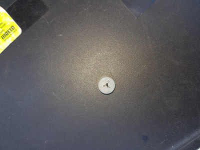

Hí, me again.
Can someone tell me what this "thing" is for?

Brake Vacuum Pump possibly????

It looks to me like a gearbox breather (vent).

Re: C5 2010 1,6 THP aut. deceleration noise
Can you please tell me what its function is?

It allows a small flow of air into and out of the transmission case so that the case is not pressurised when it gets hot. The vent hole is small (and may be convoluted) so that minimal oil vapour is lost with the air. The flow through the vent is normally very small.
On some transmissions, the plastic vent cap is removed and the hole used for refilling the transmission fluid.

Wow, thank you

Well spotted Mike.
