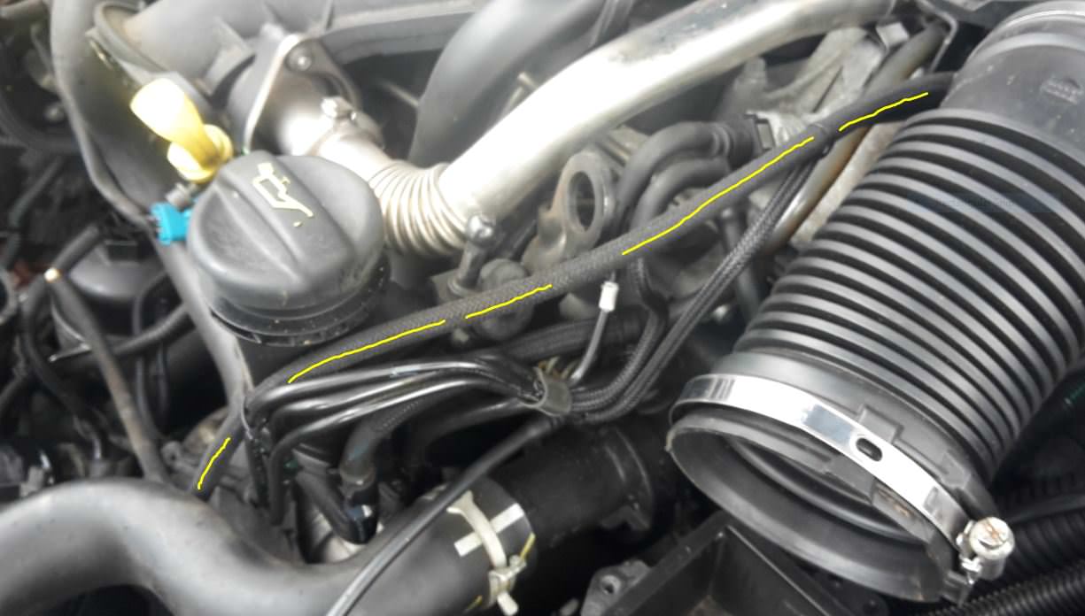

early day for a change so here goes....spanners out

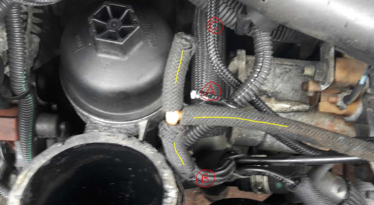

turns out this pipe has been added and was connected to small alloy pipe at rear of rocker cover
it terminates at front of engine, the horizontal one from the right
A B and C are original pipes
C pushes onto a valve/thingy just above and right which leaves A and B?
A i'm assuming is the one that runs to Vac pump to provide vacuum?
which leaves A and B, are they connected together normally?

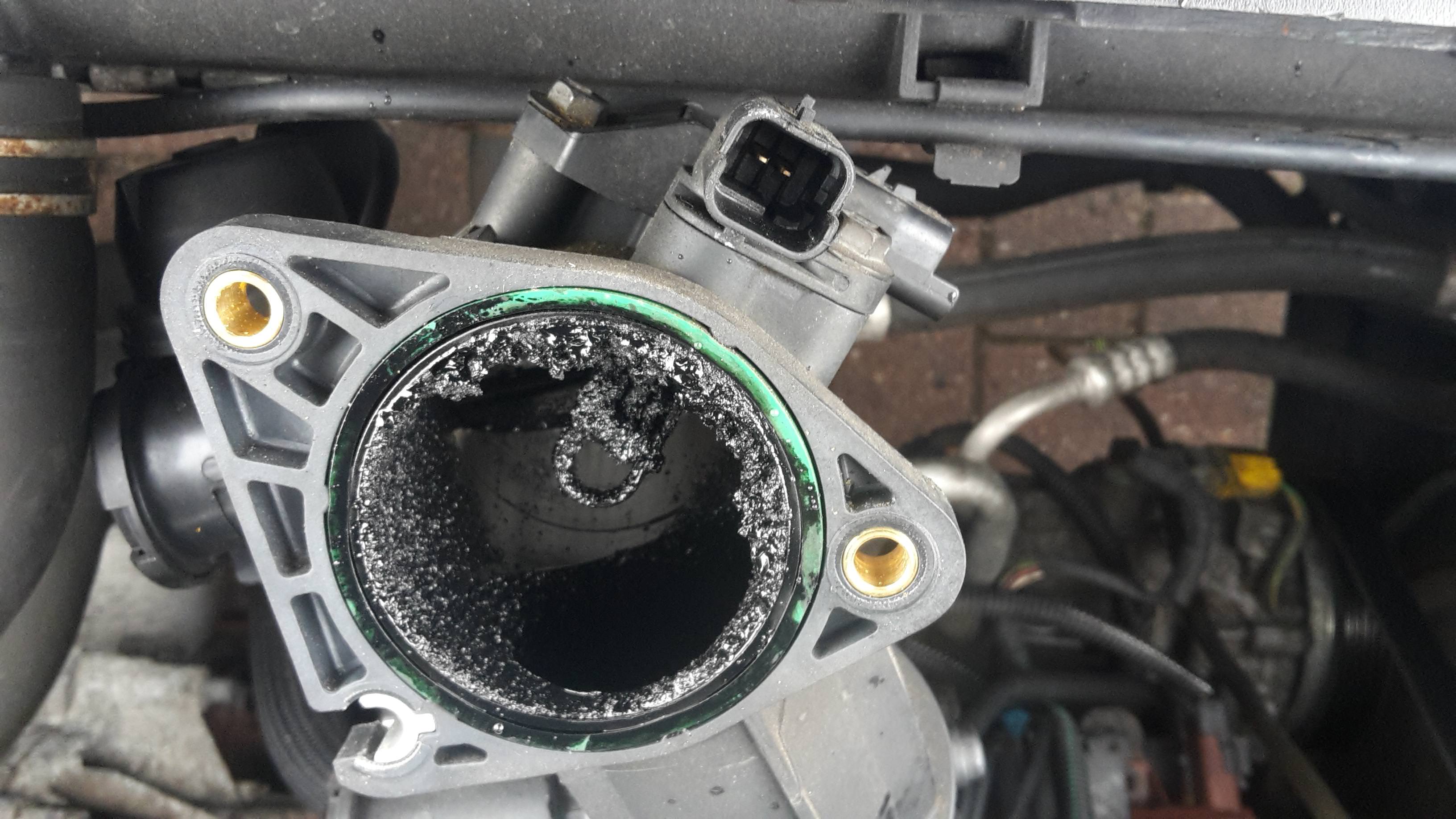

inlet is just as bad
i dont want to break any more vac pipes so have had to give it a spray and quick clean in situ as best as i can.
is this the temp sensor?

inlet is just as bad![]()
Oh wow! that's horrendous!
It might even be worse than mine was.
Yes, that sorry looking thing dangling in the path of the air is the manifold temp sensor. You'll also notice another sensor slightly further back; this is the manifold pressure sensor. Perhaps this is blocked with crap.... certainly won't be helping the boost situation.
This thread documents my efforts to clean the inlet tract: viewtopic.php?f=3&t=60717

On you're second photo showing A, B and C, I take it that they refer to the yellow traced pipes? If that's the case, C on mine goes into something, behind, to the right and up a bit also. A would be the one that is similarly routed with a cable tie next the oil filler ( first pic) then goes back and C goes down to the vacuum solenoids mounted on top of the AC compressor. Good luck tomorrow an actuator test will show whether the previous repair was done well. While you're in the actuator test check the turbo vacuum, it's below the other three.

looking back at the diagrams earlier in the thread, am i right in thinking that the pipe marked C in my 2nd pic goes to the Vac reserve thats under the inlet piece? if so should there be a second pipe also?
pipe B on that pic runs to AC compressor?
pipe A is the original pipe that was bypassed which i've now reconnected at one end, rear engine area across the back

All I can say is..C for goes into a rubber pipe, hidden, (not taking the bits off before a trip to Wales next week) B doesn't run to the AC compressor, but runs to the vacuum solenoids above it. You can see one that is is red on your pic on the previous page.A goes to the back via the clip on the oil filler. Actuator test will tell all.
