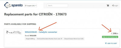

CATS 2 U £i49.41 inc postage Walker 20640
CATS 2 U do not say there cat is made by Walker, just giving a list of makes at least that is how we read it ?
Spareto £298.85 not sure if delivery is extra Walk20640
£149.44 difference ?
Unless I have got something wrong it is the same part ?
Have just ordered from I will leave you to make a guess : )
Thank you all again for your help : )

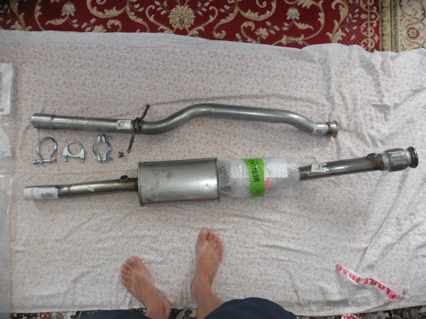

Good afternoon gentlemen, a day of rain yesterday but now the sun is out again : )
The new Cat arrived today, not a bad service considering how far down the country we are.
Tomorrow is fitting day, the good Lord willing.
I intend driving it up on ramps at the front, then jacking the rear up and sliding a second set of ramps under the rear wheels.
Pictures to include my feet : )
God Bless Spiff

Good evening gentleman.
The replacement part will not fit because the extra section of pipe they supply after the cat finishes in a flange connector, this was made to fit a similar flange on the pipe just before the back box.
There is no flange connection just before my back box, the whole system was made in one piece.
On the new system there is a joint shortly after the cat that fits into the rear section of pipe they supply.
I may cut the old rear section to meet this point and make a sleeve joint from the old front part of the cat to engine section, according to callipers it is a suitable diameter to sleeve the two pipes I wish to join : )
I do have a Mig welder but not the skill yet to weld this kind of joint.
From looking at the diagrams Marc kindly supplied, there is a sleeve joint made for some versions, if the section of pipe I cut out from the old cat to engine does not do the job, one of those should.
Is fire cement different from exhaust paste ?
I know not to use it before the cat : )
I have left it for today with WD40 on the two sensors and the front clamp.
Also noticed one side of the hanger is missing, including the bracket to the under body.

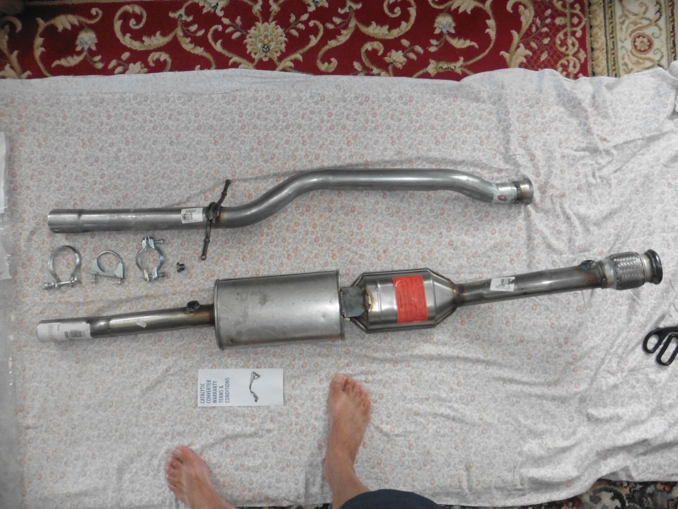

Good evening Marc,
On the diagram below that you kindly supplied, it shows no 12 exhaust pipe bracket left.
The left bracket is present on my car, but the right or drivers side is missing.
There is a blank or plastic washer in the end of the right hand part from the pipe that would push into the rubber.
Is there a different part number for the right hand side bracket, or is it perhaps not fitted ?
Or would you just quote the same part number with right hand side ?
There is another fixing just before the rear box and another just after it.
It looked perfectly secure with the one fitting, but the three bolts are there for a second bracket on the right hand side.

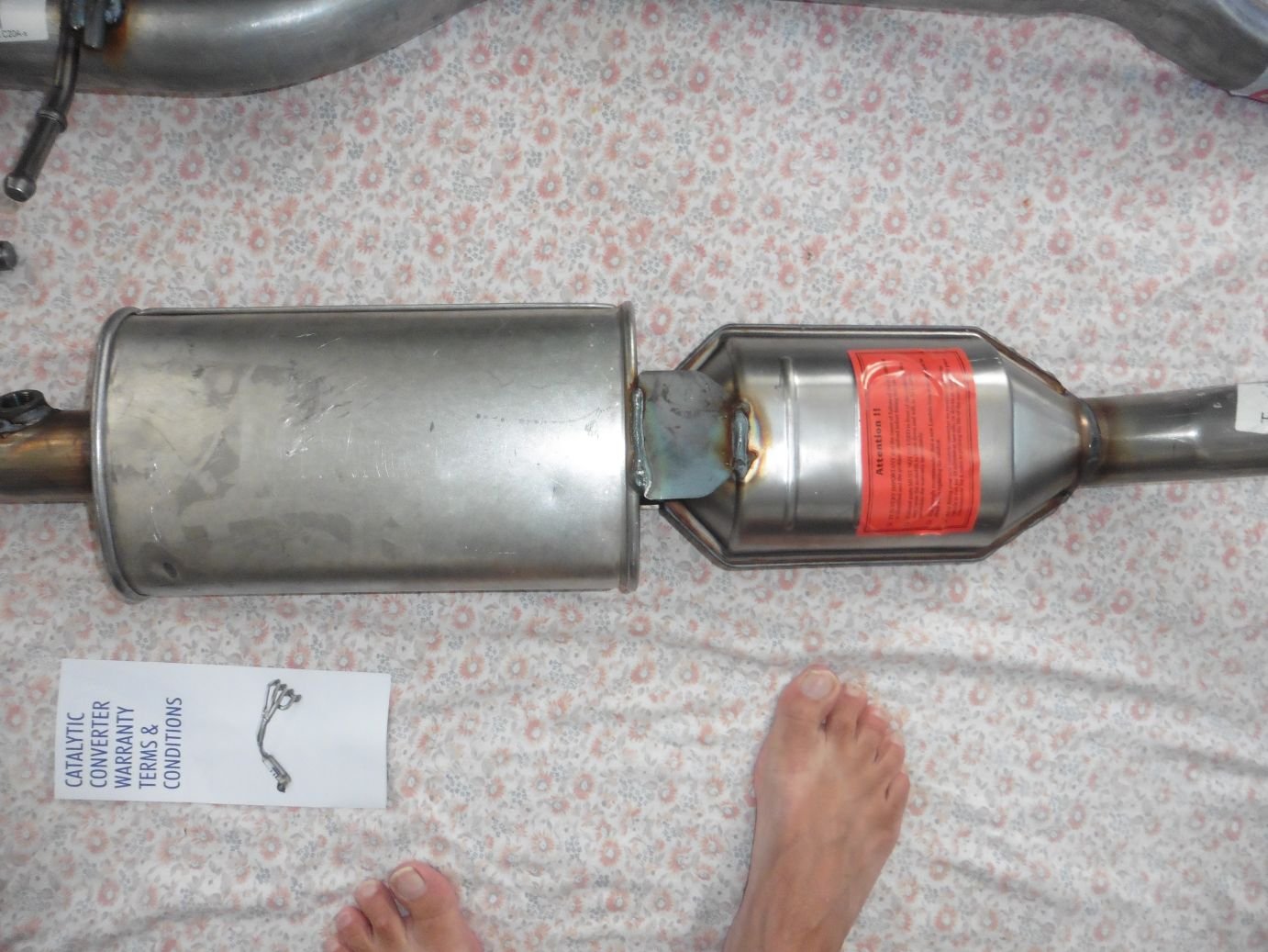

We have the new cat fitted and have cut the original rear section pipe to mate up to it.
I cut the pipe roughly to remove the old cat, then fitted the new one and marked the correct place to cut the rear pipe.
We had to then remove the rear pipe and back box so that we could make a nice straight cut : )
Also made a sleeve to join the two pipes from part of the old cat engine side pipe.
It is a good fit over the join, not sure whether to cut a slit to allow the clamps to compress it, or if there will be enough give in the sleeve as it is.
God Bless Spiff
