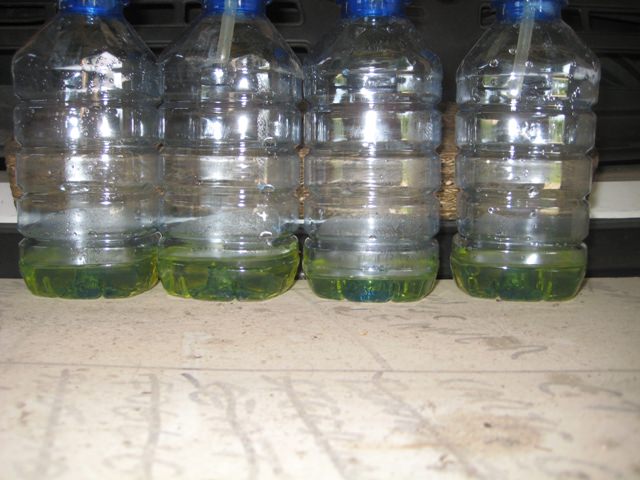

We suspect its an injector, though its a pig to do a leak-off test as the injectors are at the back under lots of gubbins - not easily accessible.
OK - big guilt here - we opened and closed an injector when we had the head off - we kept it as clean as humanely possible but maybe the spray pattern is screwed ?

Leak off isn't that hard if it's the same as the 206 version of the engine, just remove the cosmetic cover and air filter box and the leak off connectors are readily accessible ;) (be careful not to break the plastic nipples off when pulling at the pipework, during the recent head-off GP work on our 206 I managed to break one. The pipes themselves were still very flexible but the plastic T's are brittle and expensive to replace!)
FWIW I would suggest replacing the MAF if you noticed little difference or even slight improvement, disconnecting a healthy MAF yields a noticeable drop in performance in my experience. Since you do have a suspect injector I would suggest looking at the injector correction values in Lexia, with the engine running, to see if any are way different. Oh and I will keep a hawk eye on the cam and vac pump seals on ours now it's running again, lest it dirties the nice clean cam carrier. Cheers.

Here is the result of the injector text. These are small 33cl bottles and we ran the car on idle for 5 MINUTES.
Not a lot of diesel coming back through.
The car starts really easily and when standing it revs up and down cleanly through the rev range.
But show it a hill and it says "no way - get out and push"
Keep the revs around 2300 and it flies along.
