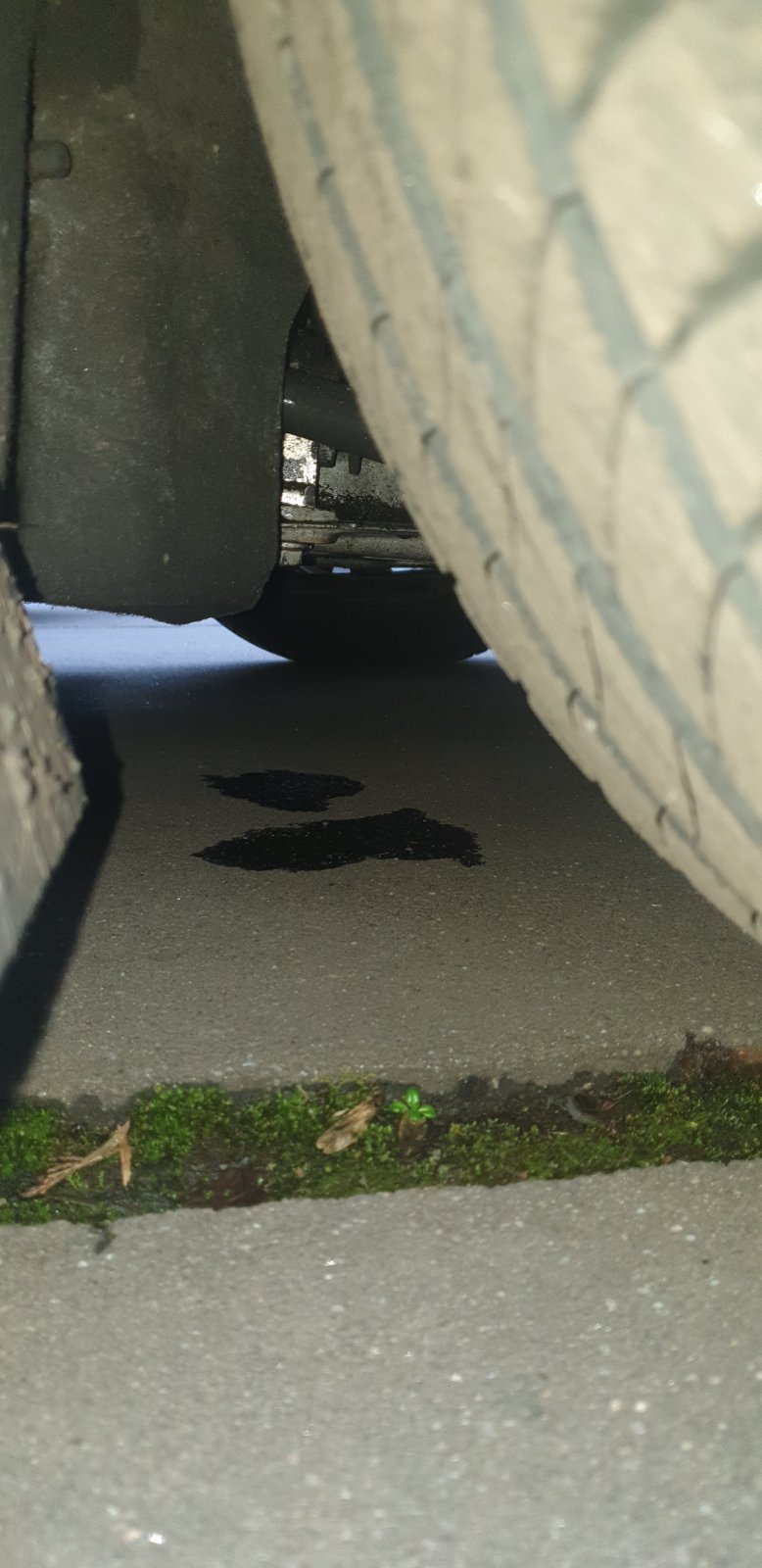

aerodynamica
Donor 2023
Posts: 1290
Joined: 26 Dec 2007, 19:10
x 94
Re: C5 X7 Steering Rack - Again!
Post by aerodynamica »
This is the overnight leak size. I think it might be more that 3" mind you that's overnight not 5 minutes

Posts: 11533
Joined: 02 Apr 2005, 16:11
x 807
Post by Peter.N. »
Doesn't look too bad. I carry a litre of LDS with me but have never had to top it up when out or away, just check it now and again at home.

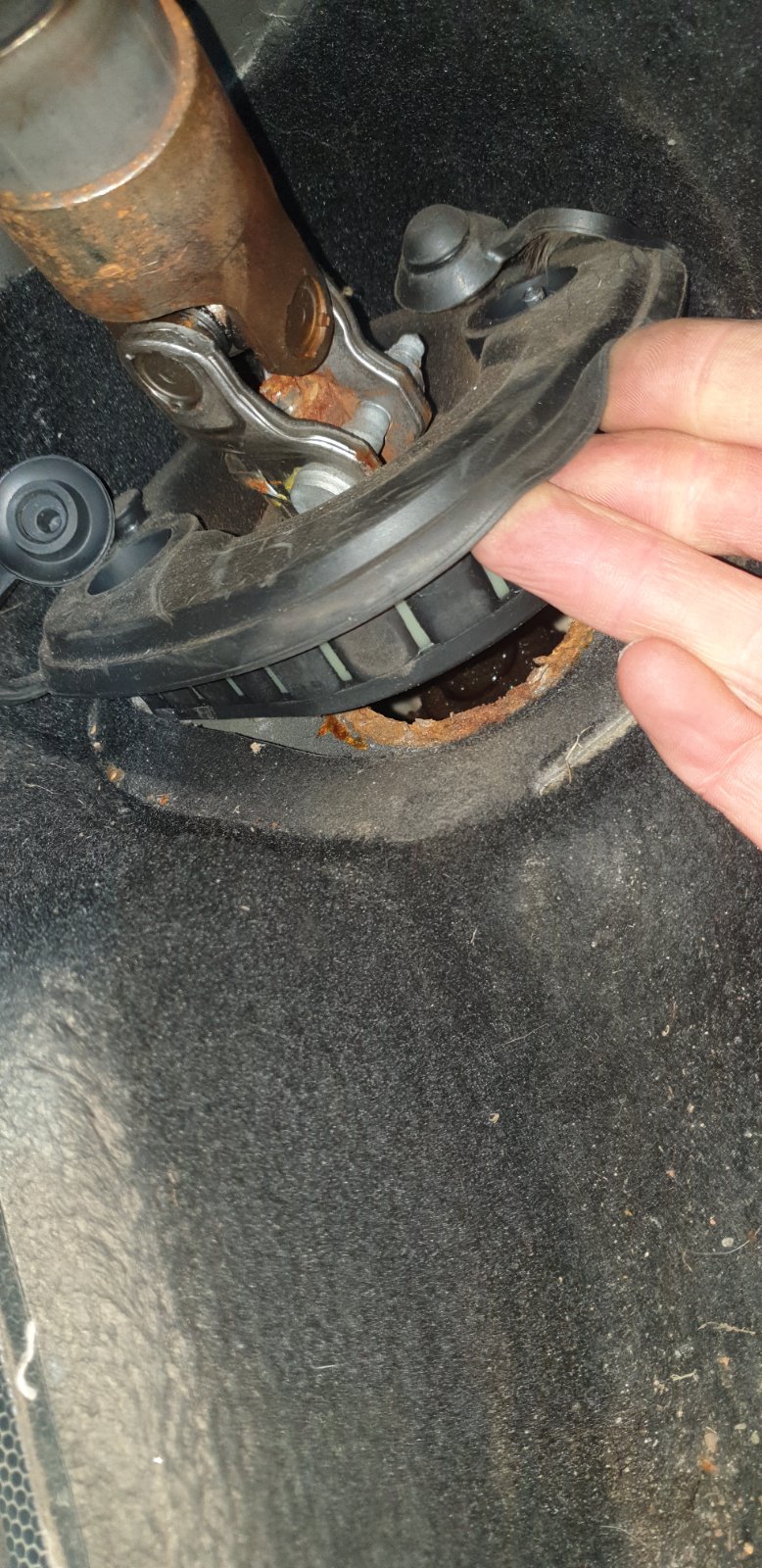

aerodynamica
Donor 2023
Posts: 1290
x 94
Looks like I'm officially in the club.
A little peak through the rubber bung and an oozing is seen....
Posts: 11533
x 807
Post by Peter.N. »
Mine has springs so only use it for steering. Just keep topping it up Graeme, I have only used a couple of litres in 2 years
