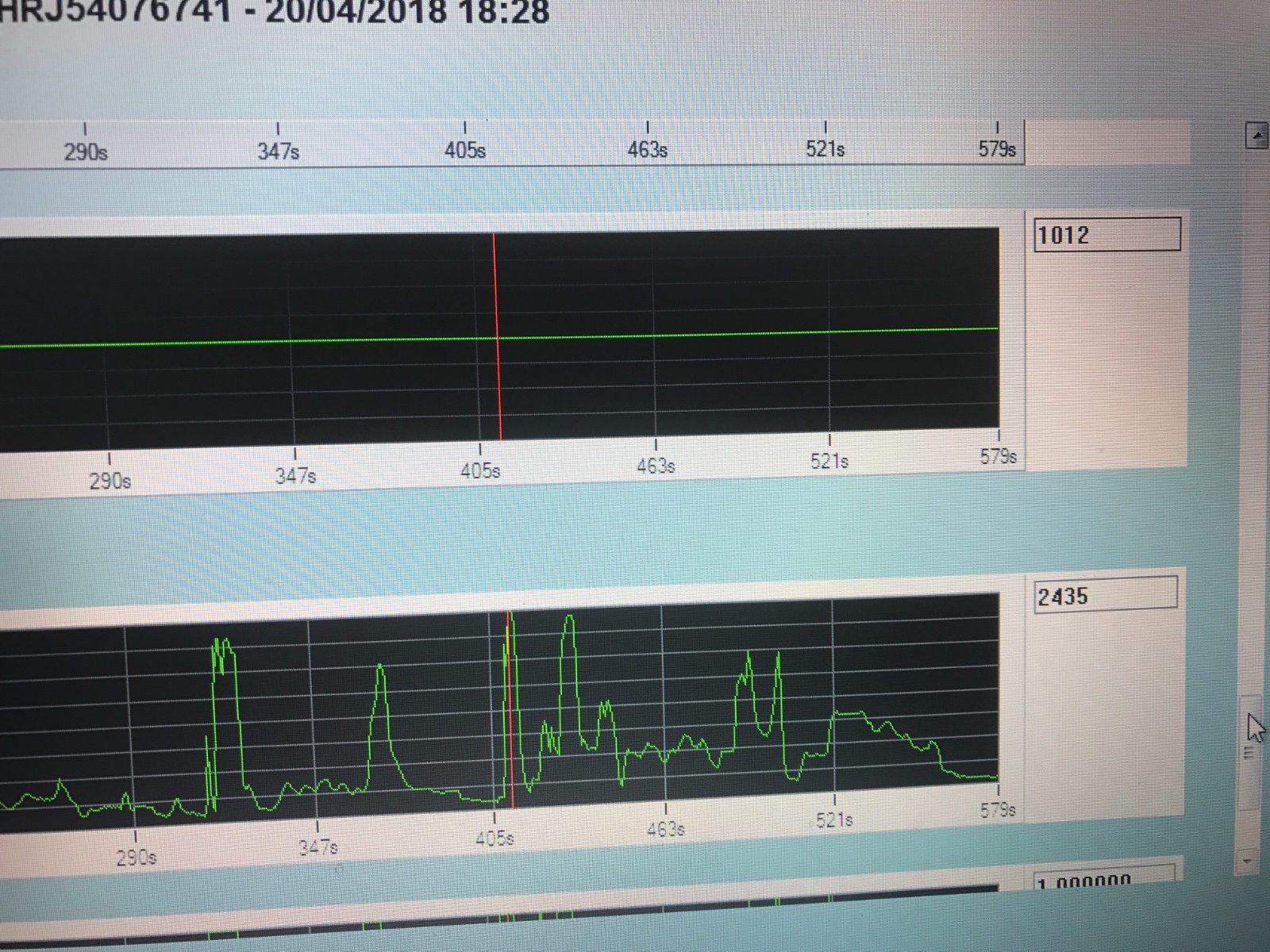

Here is a pic of the Turbo pressure of my RHR during acceleration.
The peak measured pressure was 2435 mbar (I assume) so when we subtract the atmospheric reading, 1012, the boost pressure is 1423 mbar or 20.5 PSI
So it looks like yours is a little low.

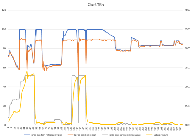

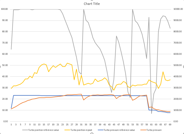

This is before the change - the lack of response of the repeat sensor is clear, and the ecu is dramatically modifying the turbo position signal, which is reflected in the pressure. This is felt as a series of hesitations on full throttle. After the change its clear that the repeat value is tracking the request position as well as it can. Turbo pressure request tops out at 2300, and the actual takes a little while to build to that.
This all makes sense. I need to now check why the repeat value from the EGR is constantly pretty much zero. I didn't think I'd even unplugged it during the work, as even though the peugeot procedure advises removing the EGR and cooler to do the exhaust cam change I didnt think it was necessary to disturb it and didn't ! But maybe I did unplug for access and moving wiring etc to get at stuff and have missed plugging it back in......
Live data is clearly showing that the turbo repeat is now working as it should ! 12% at key on and engine off.

That first graph is really interesting, it suggests that the ECU is trying to 'unstick' the vanes in the turbo by repeatedly applying full vacuum. Very clever.
It appears to have done the trick regardless by looking at the second graph with everything tracking correctly.
