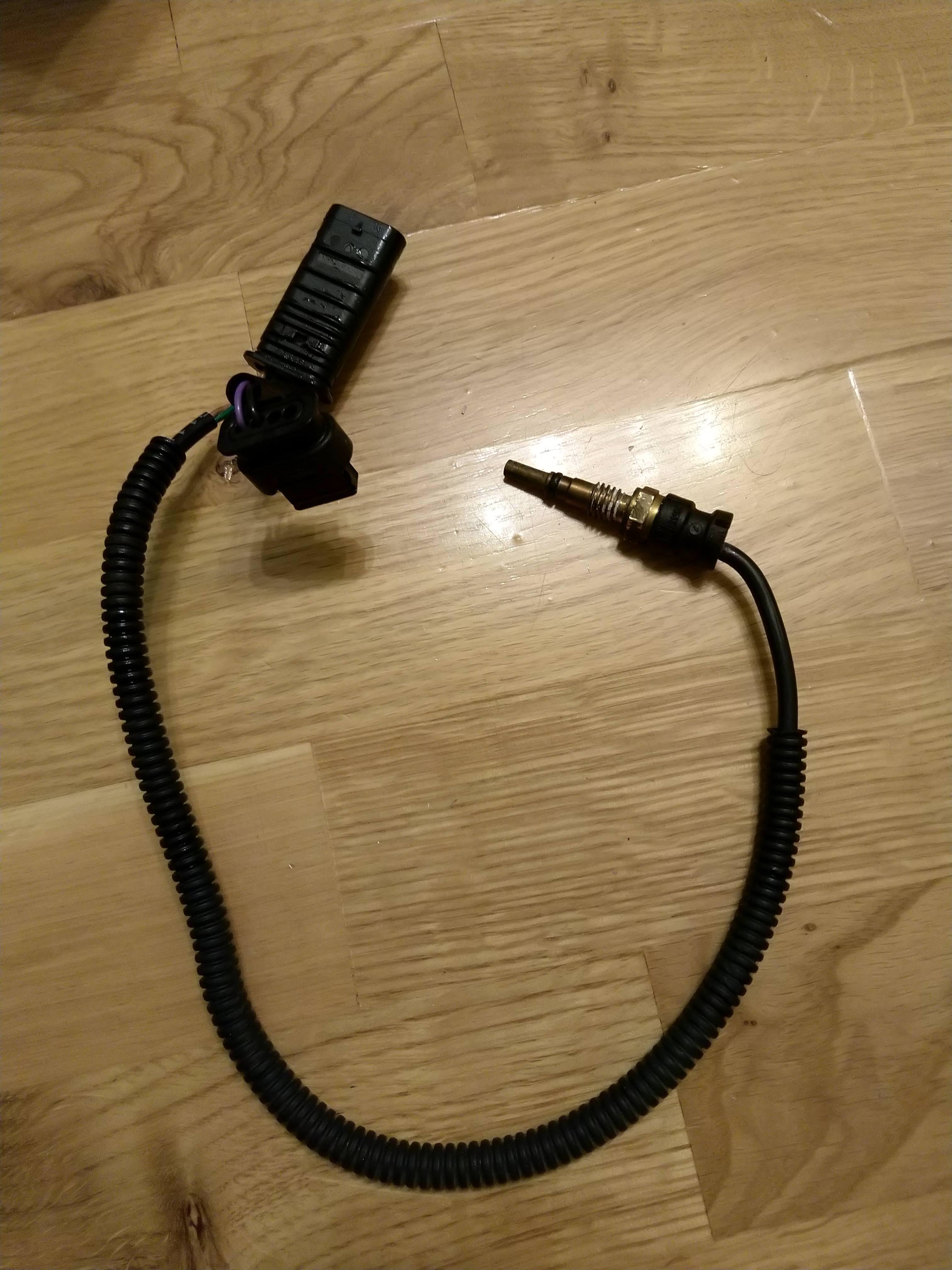

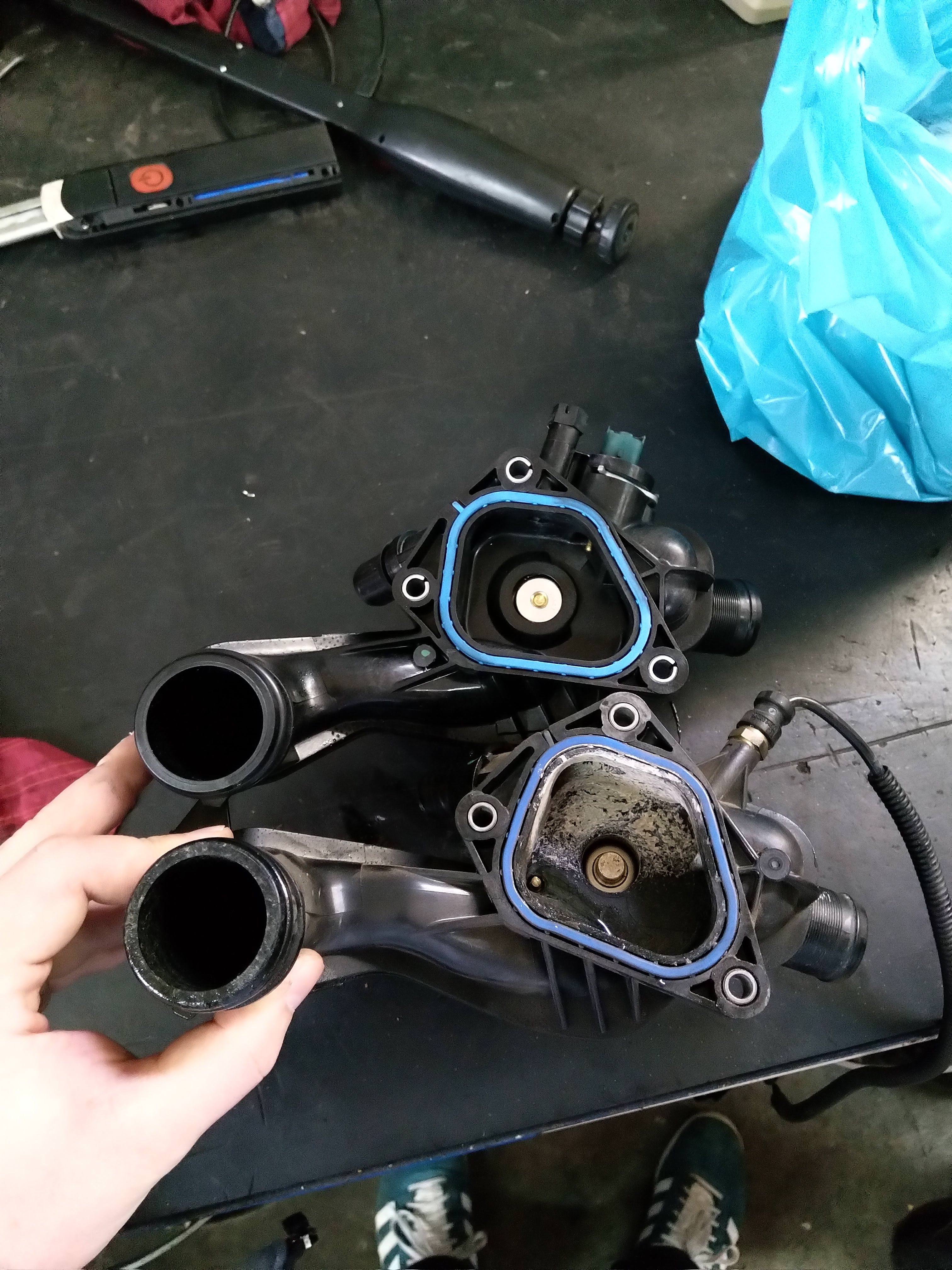

I hope the antifreeze/thermostat saga is finished
There's quite a bit of work needed to replace the ts. It took my mechanic(and me) an hour and a half. Whole intake has to go down(except the manifold), the battery, some wiring harnesses but the biggest problem is a clip on the rearmost hose. It's a metal securing clip which has to be taken off at a certain angle, but PSA being PSA, they've made it quite hard to reach.
Anyway, I've flushed the system, now Shell G12+ is inside(couldn't find Total Glacelf AS anywhere).
Coolant now takes 2 kilometers to get to 105°C, as it should be.
Fun fact, there was no heating in the cabin after the job, even though the temperature was at 105-106°C. First thing I did? Floor it! Did it help? Yes it did :mrgreen:
Here are some photos

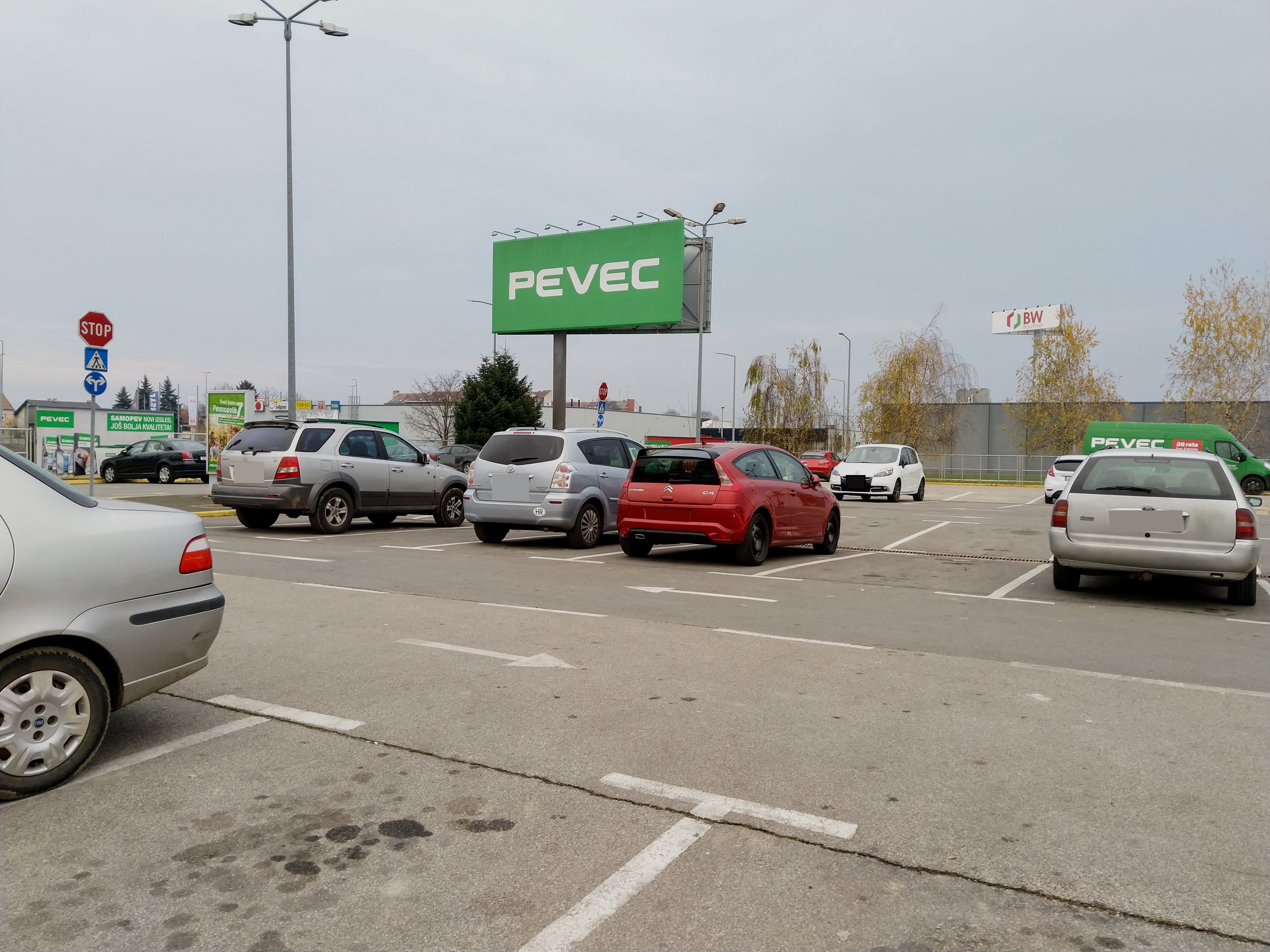

Coolant puddle on the gearbox
New ts and the old ts
Wiring that was installed, with the temp. sensor built into it

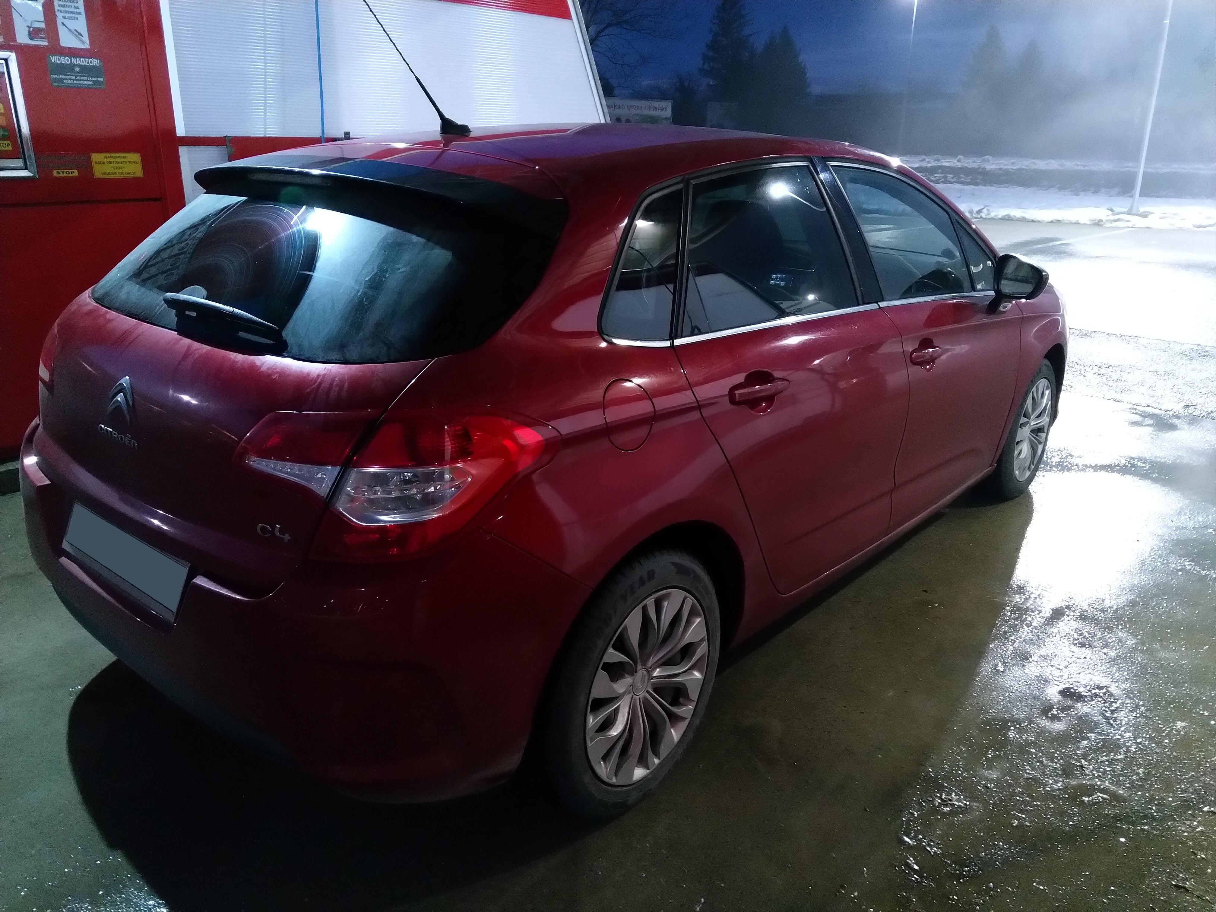

And the car, before and after a wash :)

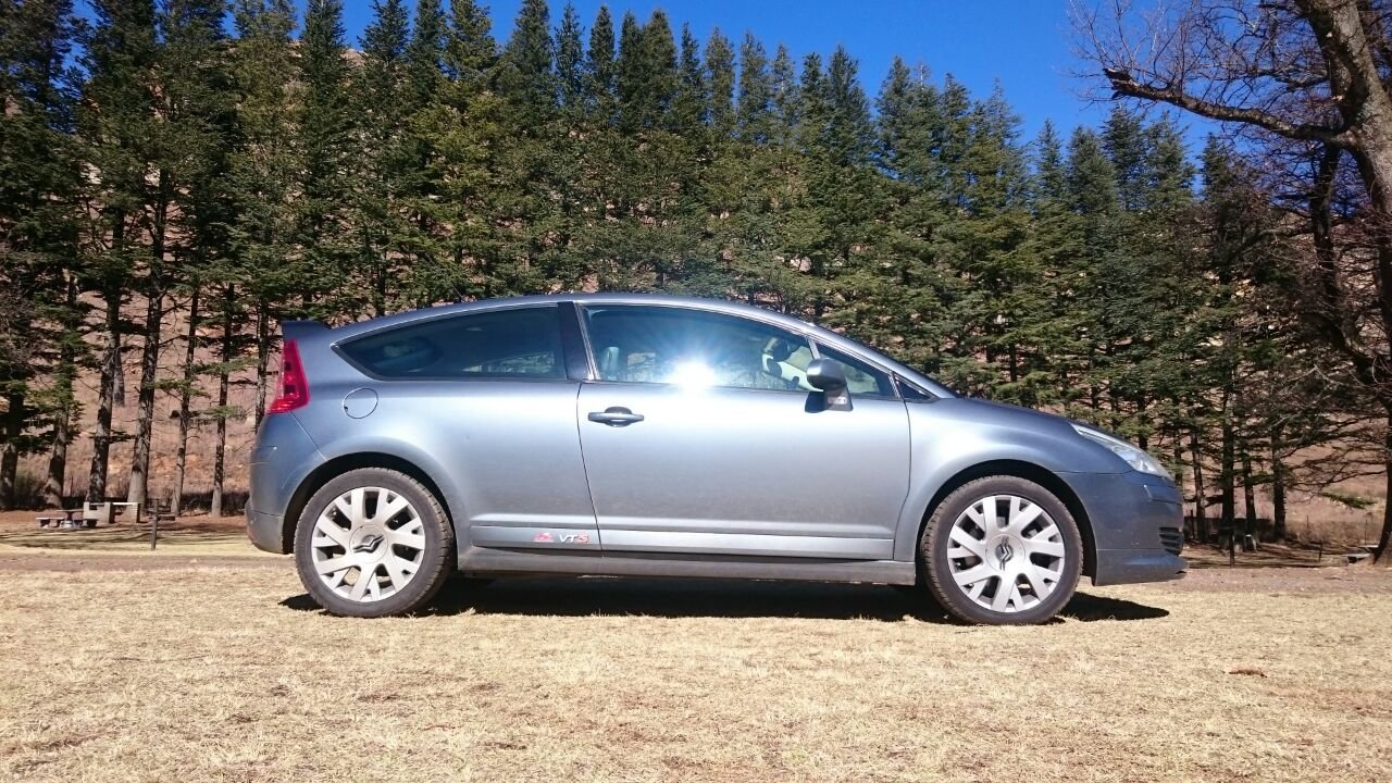

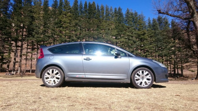

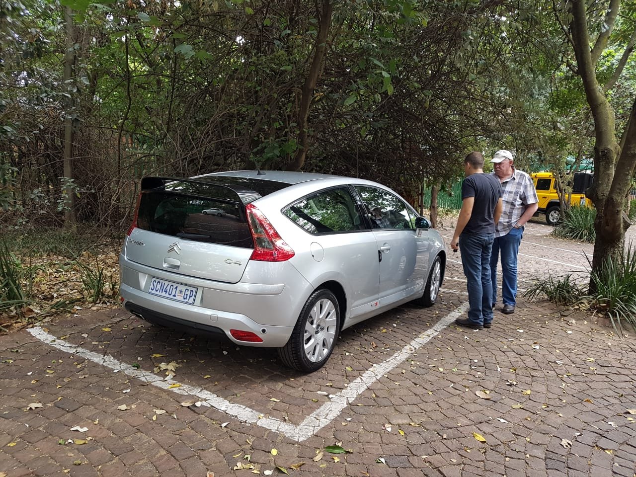

The Charcoal/blue metallic one was my first VTS. Got her at 72000 km and lost her at 140xxxkm.
The rear silencer wasn't any performance type silencer, rather just an average replacement unit at an exhaust shop.

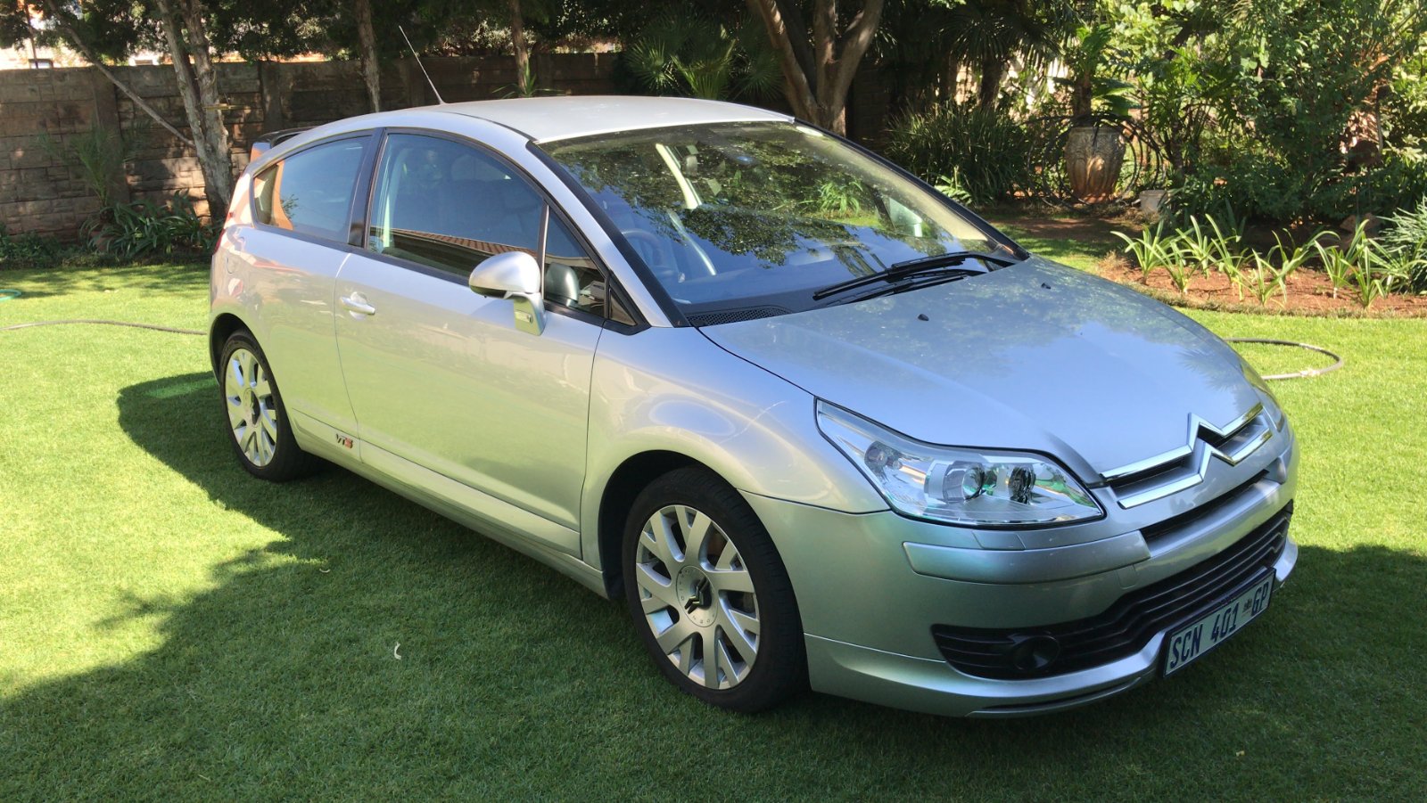

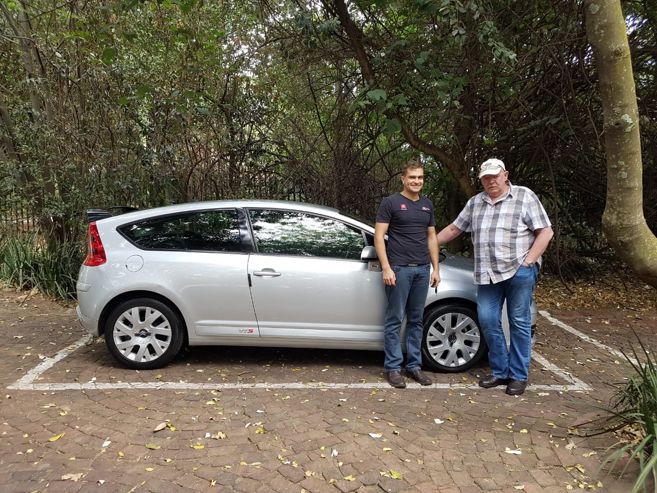

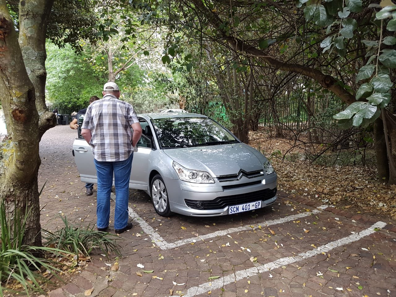

The metallic silver VTS is what I have now. with 61500km on the clock. even got the standard rear silencer still intact. hope it lasts as I don't think I'd get one again....
My silver VTS needs the conversion kit for the Aircon flap motor. Unavailable in South Africa and got a very very snotty response from a Local Citroen peugeot garage, utterly pathetic service. Shows again why I just import all the spares I need....

I really do like the rear of those C4s - a nice bit of design there - was that rear spoiler OEM or an aftermarket addition Corne?

Hi Marc
In South Africa the 2.0 16 v 180 VTS came standard with the spoiler, one of the distinction on the VTS apart from the tailpipe. The VTR coupe never had the spoiler as an option so atleast for our market it was very unique
