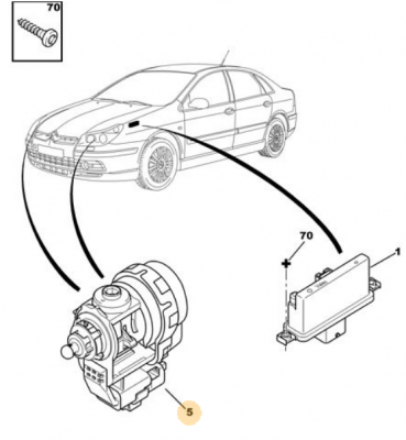

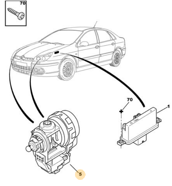

So it would appear that your right hand headlamp motor is not centring properly and that is causing your intermittent fault.
So here is the diagram of the 2 main components:
Item (5) is the headlamp motor - one on each lamp. They are part number: 6224G9, but are no longer available from Citroen. But at least you can use this part to search for a spare.
Item (1) is the Automatic Headlight Adjustment unit and this is part: 6224R6 which is available (just in case you need it).
So I think the right hand motor is faulty or wearing out and probably needs replacing. So do a google on 'Citroen 6224G9' and see what's available in your area.
