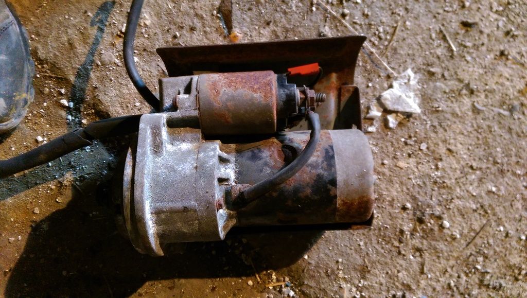

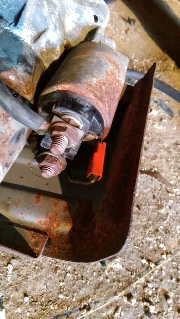

Offending starter motor;
The red terminal was the cause of the fault - nothing more than slight build up of corrosion cured simply by unplugging and plugging it back in!

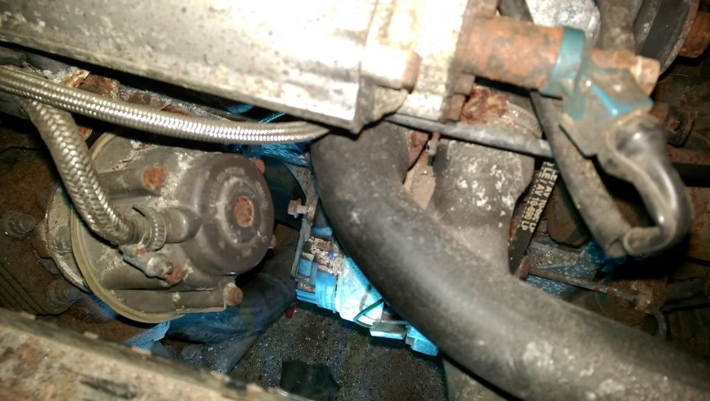

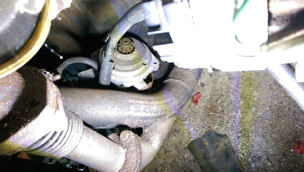

For those not familiar with CX's, this is where the starter lives;
On the front of the block, behind the manifold and under the alternator (visible through the tiny gap between the wastegate and the alternator)

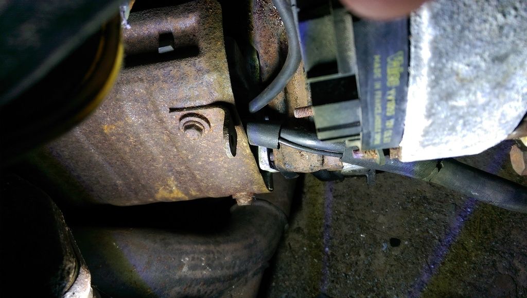

Closer up pic taken with the camera down at the alternator;

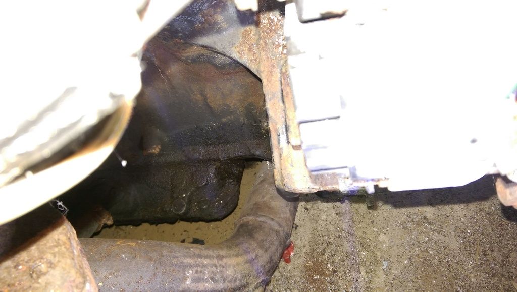

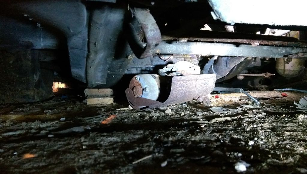

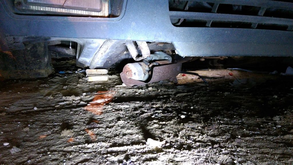

The only way in/out for it is out the bottom of the car. And when you can't start a CX, this is how much room you have to do it
It looks like there's loads when it's up near the sump, but it only just clears under the cross-member on the way in.
Working from underneath, you then have to angle it upwards to get it over the downpipe and in the space between the manifold and block;

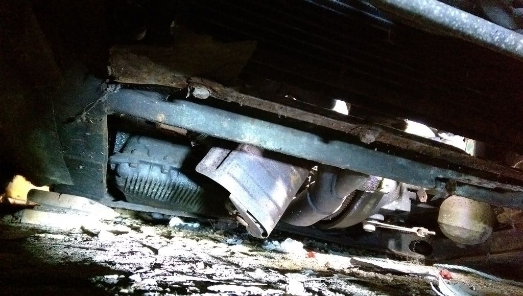

View from above (camera poked down level with the alternator)
You then have to pull the alternator level again, which is not easy because you can't get on the back of it to lift, only the front to pull (with limited space to fit your hand).
Then it's a matter of trying to get it into position in the bellhousing. A simple job made a nightmare through lack of being able to teleport hands into place;
You can just see in the pic one of the three bolts that then has to be lined up (blind) and screwed in from the gearbox side of the bellhousing;

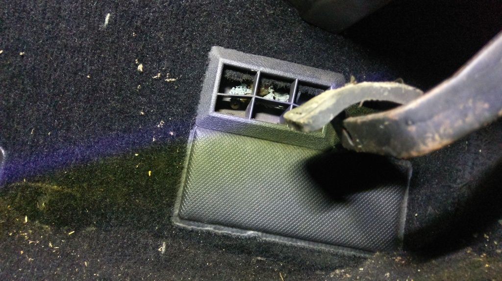

Set about cleaning out the blue one, which had been used (all over, every seat, every footwell and the rear parcel shelf) as a toilet by rats at some point...
Easily one of the most disgusting jobs I have ever had to do on a car
(the pics don't actually do justice to just how much s**t there was everywhere). Fortunately no permanent damage done and it was so long ago, no smell either.
Little bastards have been through the heating ducts carrying nest material by the looks;
It took ages, at least it's now safe to get in the thing (and I seem to have avoided coming down with anything nasty afterwards!)
