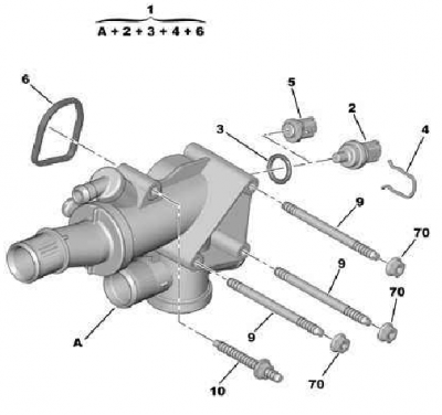

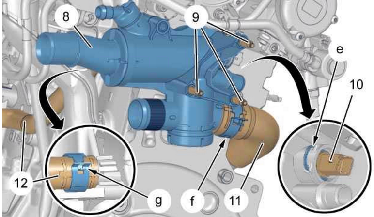

This is for the DW10BTED4 engine - so what I said about the ensuring the right part number is obtained for the Engine Outlet Water Tank would be relevant Pete, given how the engine ECU manages the system depending on these values, although I appreciate it says "Above 83 °C the thermostat starts to open". So over to you, :-D but don't forget you'll need new gaskets at 8 & 10 on refitting, as per the top diagram Pete.

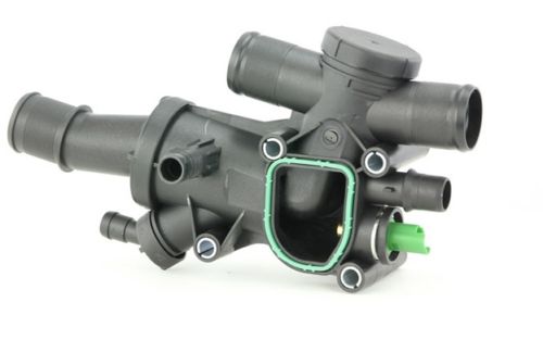

The complete housing that I've already bought is part no. 1336Y9, with an 83deg thermostat inside it, so that's good! It comes with the sensor (no. 10 in the diagram) already fitted. Re the gasket at 8 Marc, the housing is complete with that stub pipe that a hose goes onto, so I'm assuming I'll not need one. My mate's hopefully doing it for me this weekend - I'll report back! :)
This is the part I've bought -
Pete

Fingers crossed! No gasket needed if it has a new sensor included, that's a bonus and as for Gasket at 8 - it isn't actually shown on the parts diagram, so may be part of the joining hose.... I'll be interested to see if this fixes the issue.

The instructions posted on my other thread refer to item 8 as the 'coolant outlet housing' when dismantling, and say to remove it......and then call it the 'thermostat with its new seal' when refitting! :? I wonder if there's a traditional-type thermostat behind item 8......with it having the 4 'ribs' on it, it does look as if a turn anticlockwise will give access to the main body of the unit. Intriguing! :)

That rectangular gasket seal in your picture is referred to as Part 6: Engine Water Housing Seal.... so hopefully that is what they mean Pete! :-D
