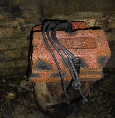

Never got round to engineering a summer MOT for the original 6 bottles of wine Clio so its end of February, always a decent bet for inclement weather.
Bit of prep work needed before it goes in for a test, including an inopportune throwing up of misfiring and the emissions warning light just the other day. Of all the threads on all the car forums, those which have "misfire" in the title are the ones which more often than not, turn into sagas without the problem being "solved".
Well, after a bit of amateur investigation this 20 year old part was replaced with a brand new one and for now at least the previous misfiring problem showed no signs of recurring on a decent 10 miles of dual carriageway at speeds up to 70mph and round town stop start driving.

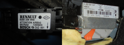

Not a triumphant success story yet on the "airbag" light on front.
Unfortunately, the wiring from the SRS ECU to the side impact sensors, air-bags, and pre-tensioners has proved to be sound.
The most likely culprit (s) now, just on general clio known behaviour, are the side impact sensors. If you have a sunroof in a Clio 2, it will leak, and the passenger footwell in particular will be a soggy carpet and soggy yellow under-carpet foam reservoir. The low down sensors mounted on the inner sill are prone to a bit of moisture laden existence.
Could be the ECU itself of course, both items are readily available on the used marketplace on the internet. The days a few years ago when one old-style scrapyard I visited had a row of 4 Clio 2's are gone, they are now a rarity so a couple of side-impact sensors for a tenner are unlikely to be easily found.

Thanks, it is a usual suspects driven process on the Clio and 95% of the time it is due to poor wiring connections under the seats. Would have been nice if that had been the case, but the wiring I found to test out OK.
Paddling around on you tube, and taking its wisdom with a pinch of salt, one vid showed testing a two pin impact sensor across the pins for resistance, the "bad" sensor was off the scale, while the "good" sensor had a resistance of 500 ish Ohms. May be absolute rubbish of course.
The precise sensor is a BOSCH 007632 120503 (Renault Part Number 8200 239 994) Can't find any horses mouth details of resistance values of the sensor. I'm guessing this is what the ECU self-test will be measuring every time the ignition is switched on.

These look remarkably similar, and may be more commonplace now, and maybe some use in testing. Indeed I have them in the Micra.
I expect the same sort of side-impact sensor was used across many vehicles within the Renault stable, and also across other manufacturers.
Absolute paucity of information and cross referencing though.
I think a scrapyard expedition may be on the cards.
