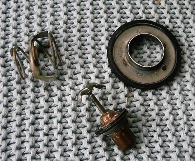

Here's an easy job, to solve a problem of a thermostat stuck shut, and a over-rapidly heating up cooling system.
No real difficult access problem, 3 little bolts retaining the plastic thermostat housing specified at 7 NM, barely more than finger tight. New thermostat purchased, just pop it in with its rubber sealing ring, and bolt the housing back up. Followed all the appropriate draining and refilling and installation stuff as per the official tech manual for the 2005 K12 which I have courtesy of the net.
First attempt.....thermostat housing leak. There is the temptation to just tighten up the bolts a little more...totally ineffective and very probably damaging (didn't stop me gently doing it!)
Second and third attempts followed on using first sparing application of first the instant gasket, then the cavalry of the blue hylomar. The hylomar worked nicely at tick over but at 3000 revs spurting coolant from the housing. Back to square 1.
At this point I began to lose confidence in the new thermostat, and its rubber seal, and the plastic thermostat housing in general. So a plan came together. The original thermostat was a genuine Nissan article, maybe it just fitted better, but of course it wasn't working. Does anyone ever "repair" a thermostat
I definitely got it to open with a bit of heat...the sort of heat that a gas ring outputs! but couldn't put up with a sea of frustration "freeing" it off (even if that was possible), reinstalling it and hoping it would work, and returning to square 1.

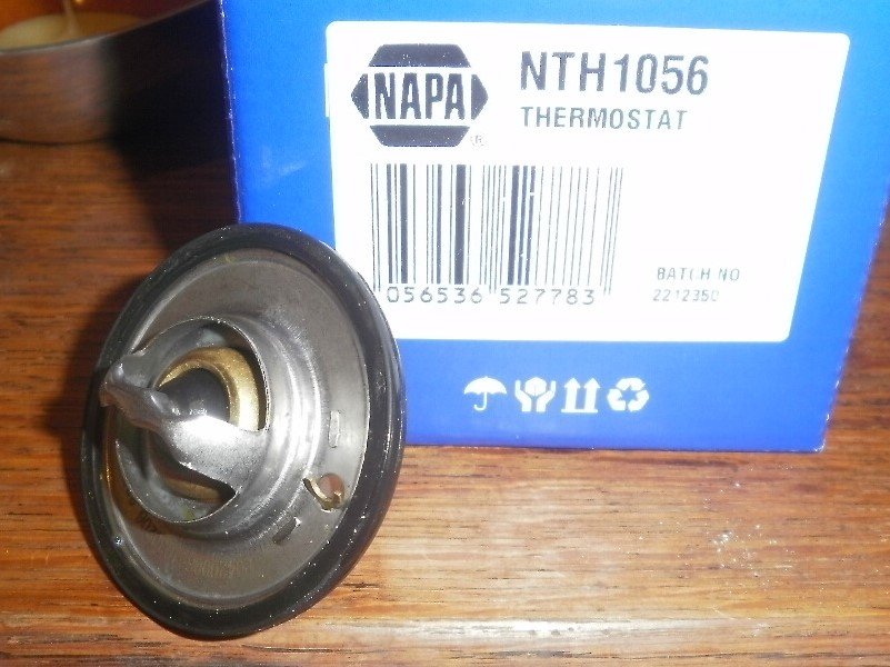

So what have I done....this, and the cause of the previous failed leaking thermostat housing...
...the new thermostat. Compared to the original which was tight in its recess, the new one was noticeably slack. Looks the same, even took the original in to compare them at the factors, but subtlety different.
This was the new part...does look identical but didn't fit properly. Neil

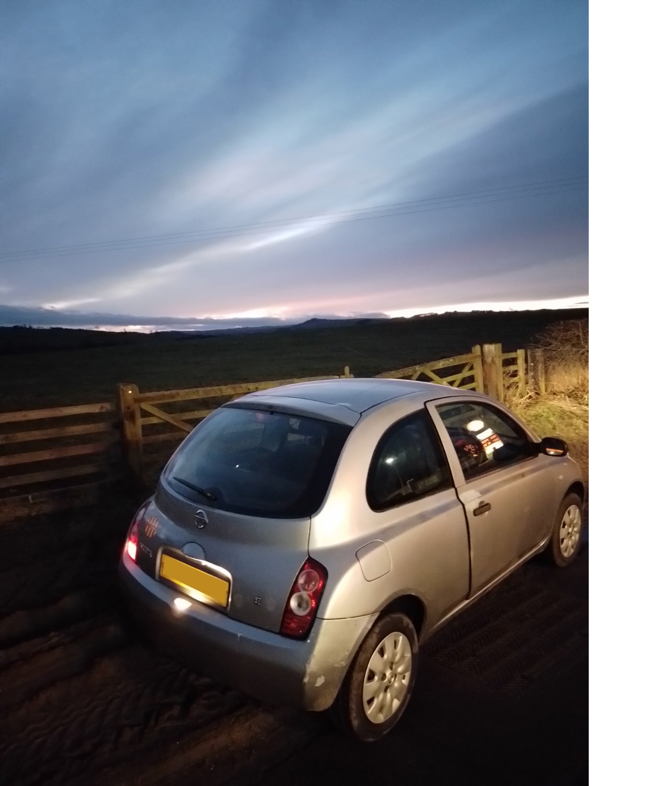

BB Micra was the horse for the course on the trivia trail today. Did a bit of a running repair en route. After traversing a particularly rough and potholed section of the Northumberland Highway, on came the ABS light. I knew what it would be, the rather imprecise slot in the hub carrier and the femmer retaining clip rusting away down there occasionally result in the ABS sensor wire popping out of its intended home. Sure enough that was it. tried to fiddle it back with the wheel on but couldn't see what I was doing so took the wheel off. Part of the clip was broken so I just used what I had lying around the boot of the car. Yes a tube of exhaust assembly paste. Slotted the ABS wire and end into the slot and clagged a bit of the assembly paste on the plastic side butting against the hub carrier to stick it in. So far so good 60 miles later light still off.
- Posts: 53141
- x 7374
Re: Bargain Basement Motoring
Love the 'get you home' bit of maintenance Neil
And a great photo too!
