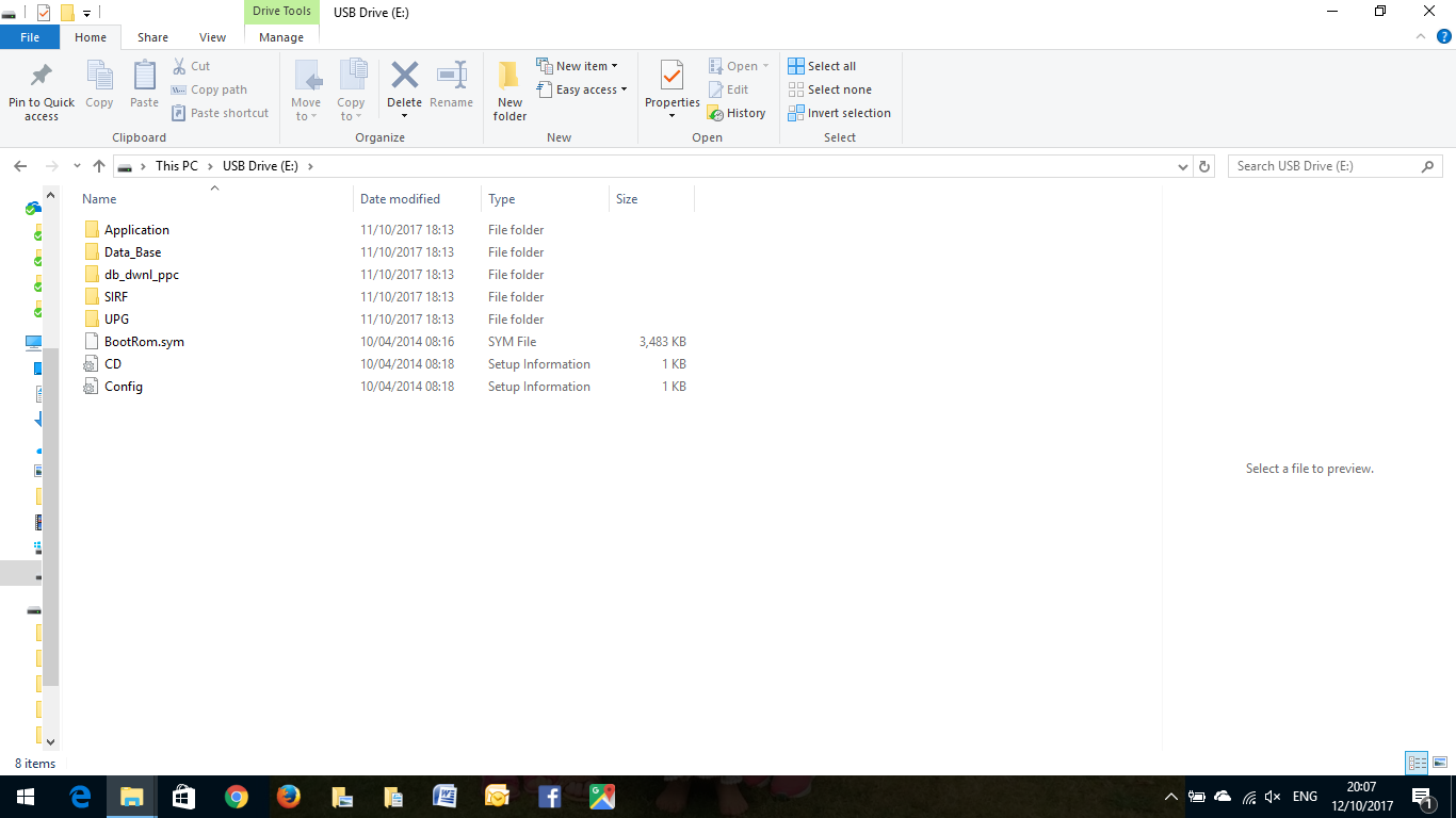

Seems to be the same files?
I formatted the USB stick again and downloaded the files again, then extracted them to my E/drive
I'm just going to give it another try.for future use.

Still the same result. "Checking media data "appears for approximately 6 minutes, then " Media incomplete or damaged"
Think I might have to let the dealer have a go next month.
Rick.
