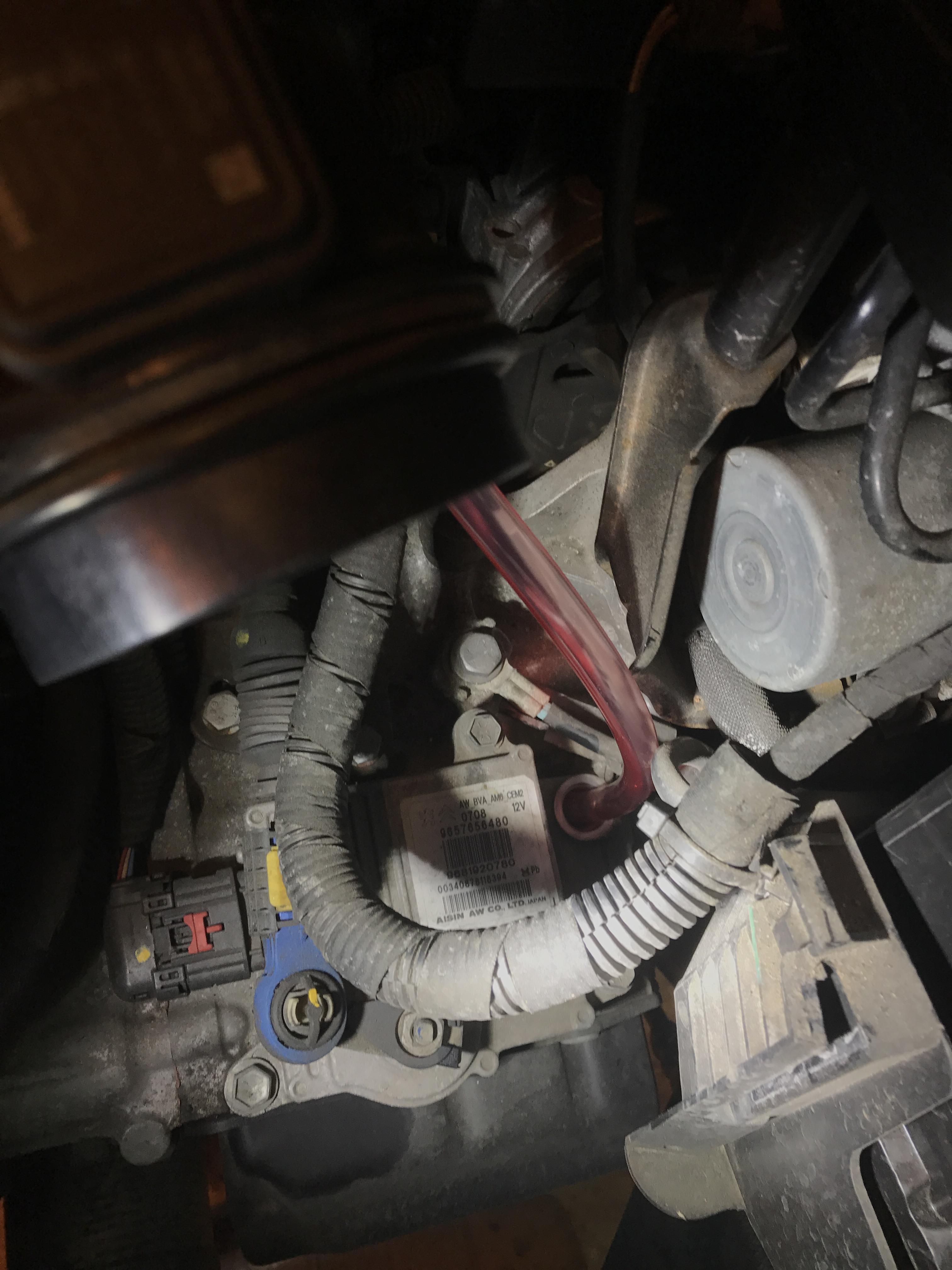

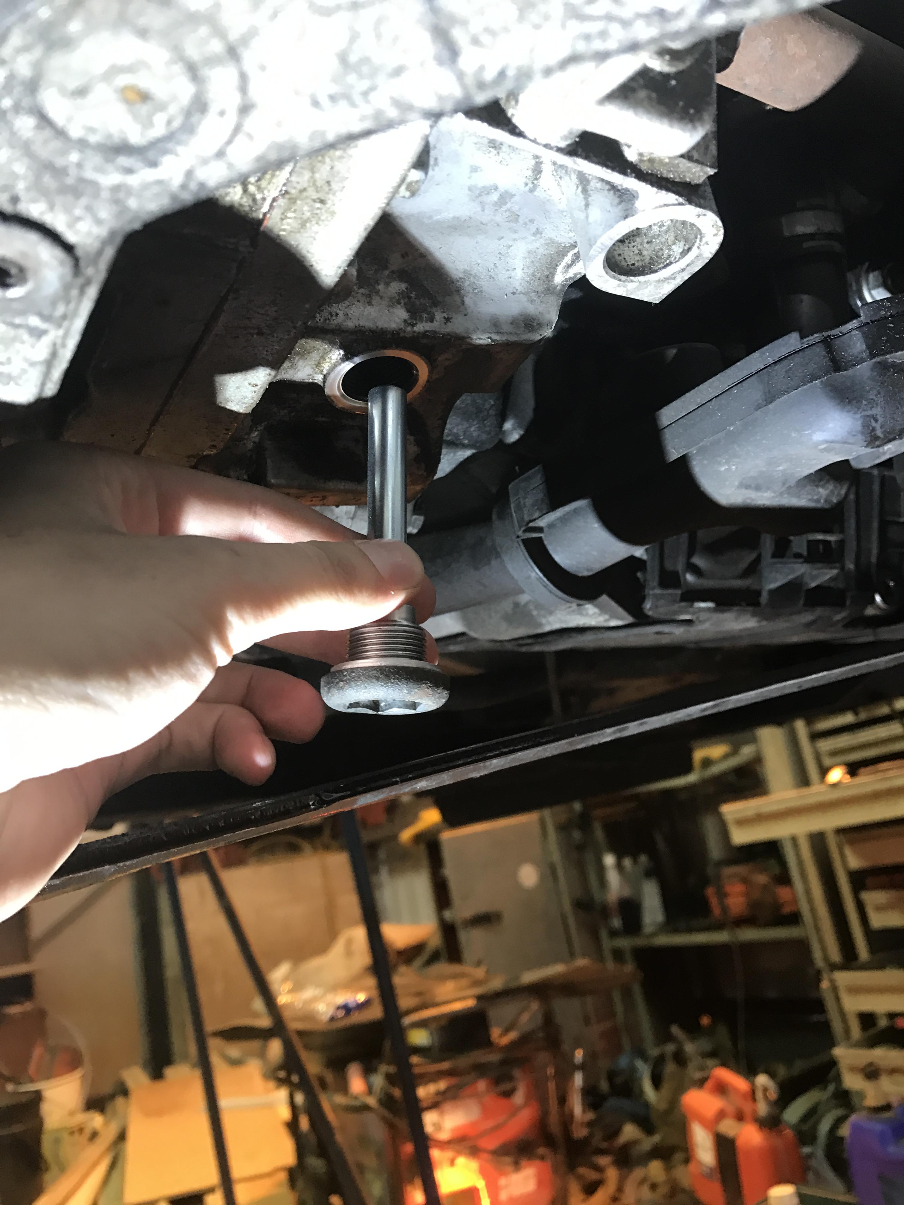

Right, here's how it went.

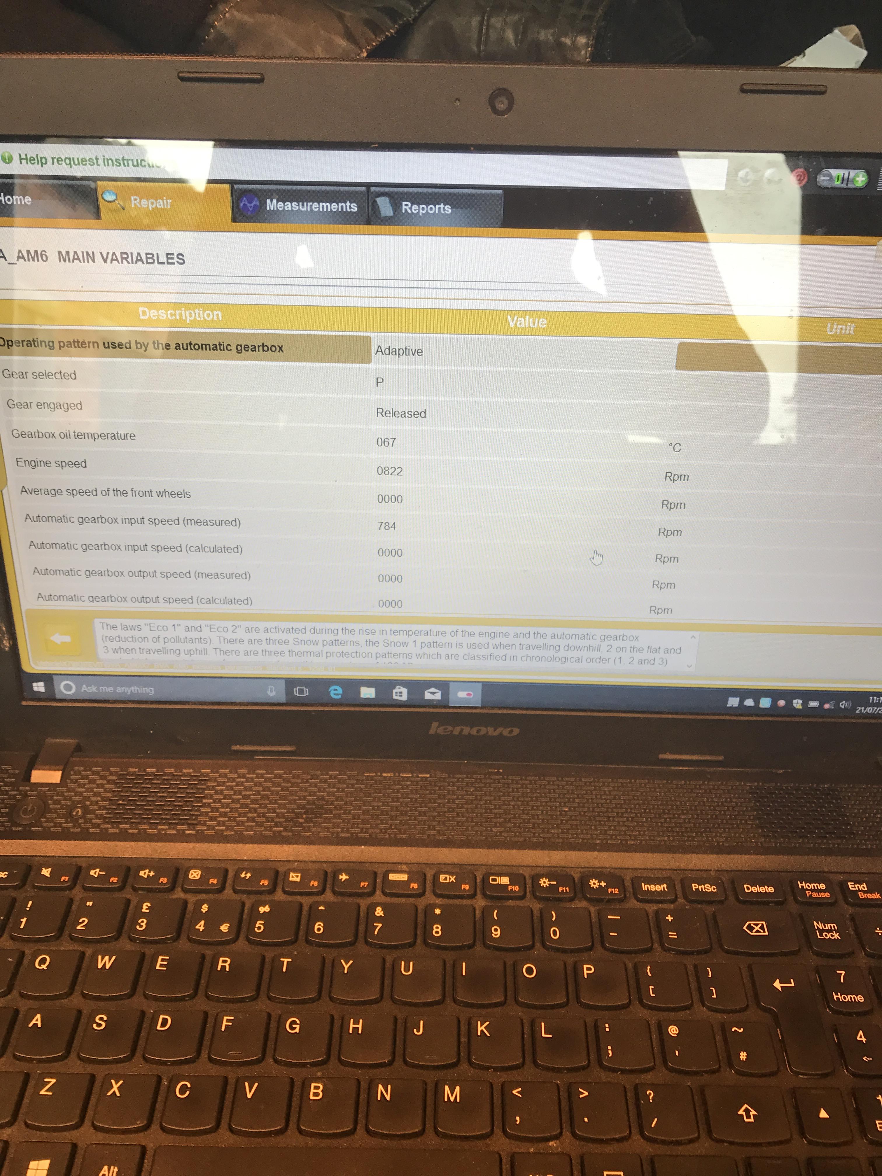

First off, took car for a run to get the gearbox oil hot, checked with Diagbox. 67 degrees is plenty hot enough.

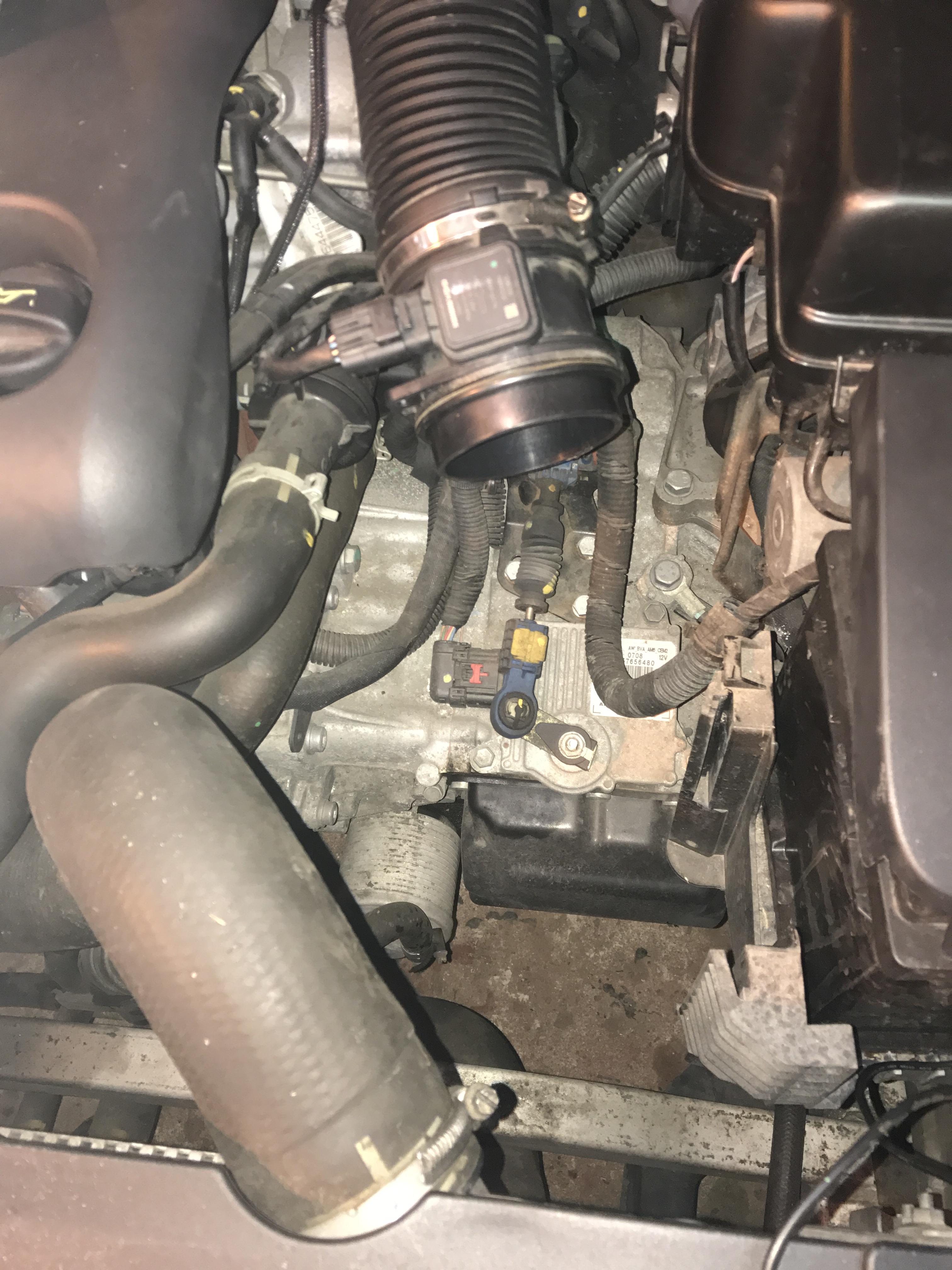

Removed air filter. Easy, filter housing lifts straight up after releasing clip between filter housing and battery tray:

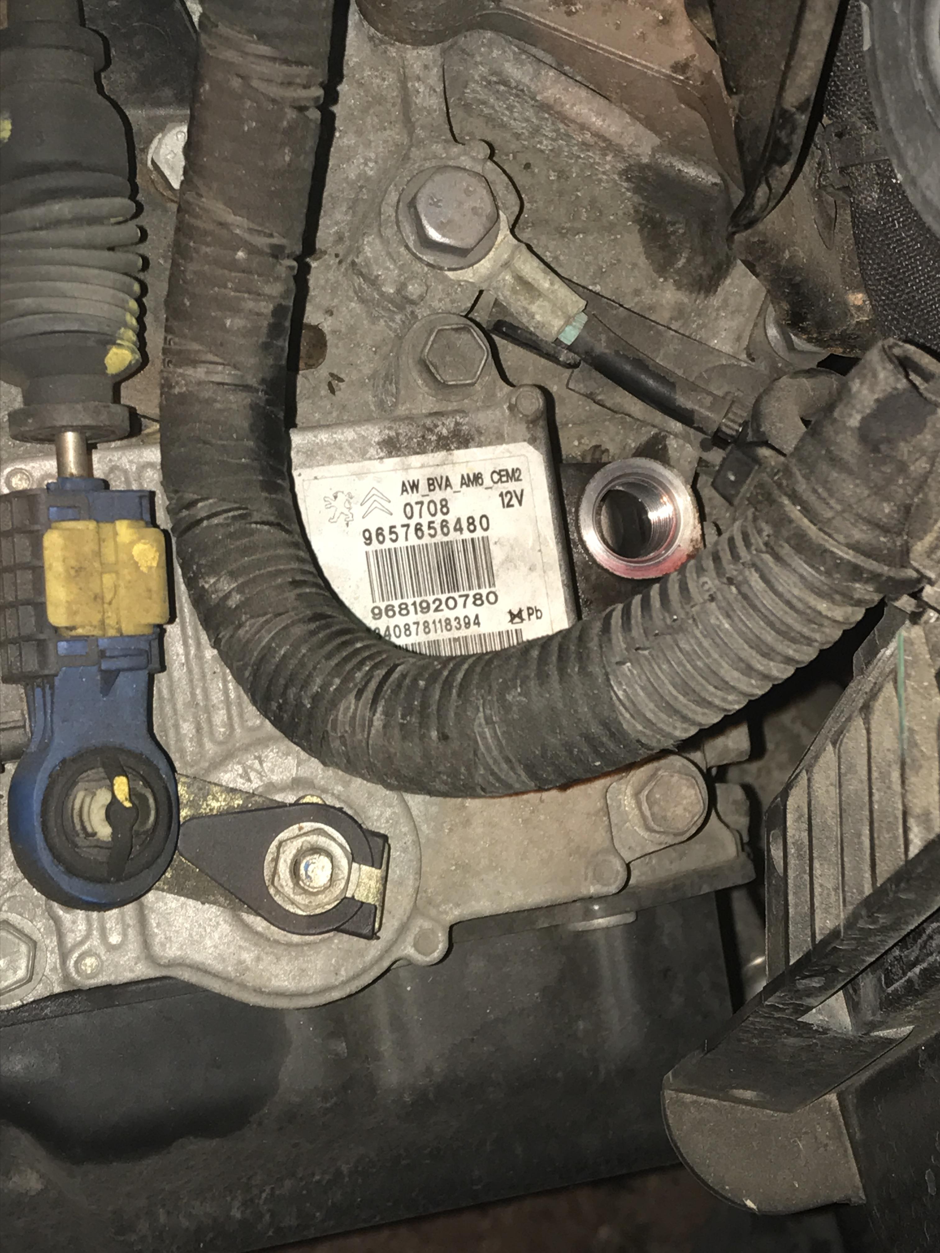

Located filling nut, on right near earth strap. Was done up quite tight, (T55 Bit)

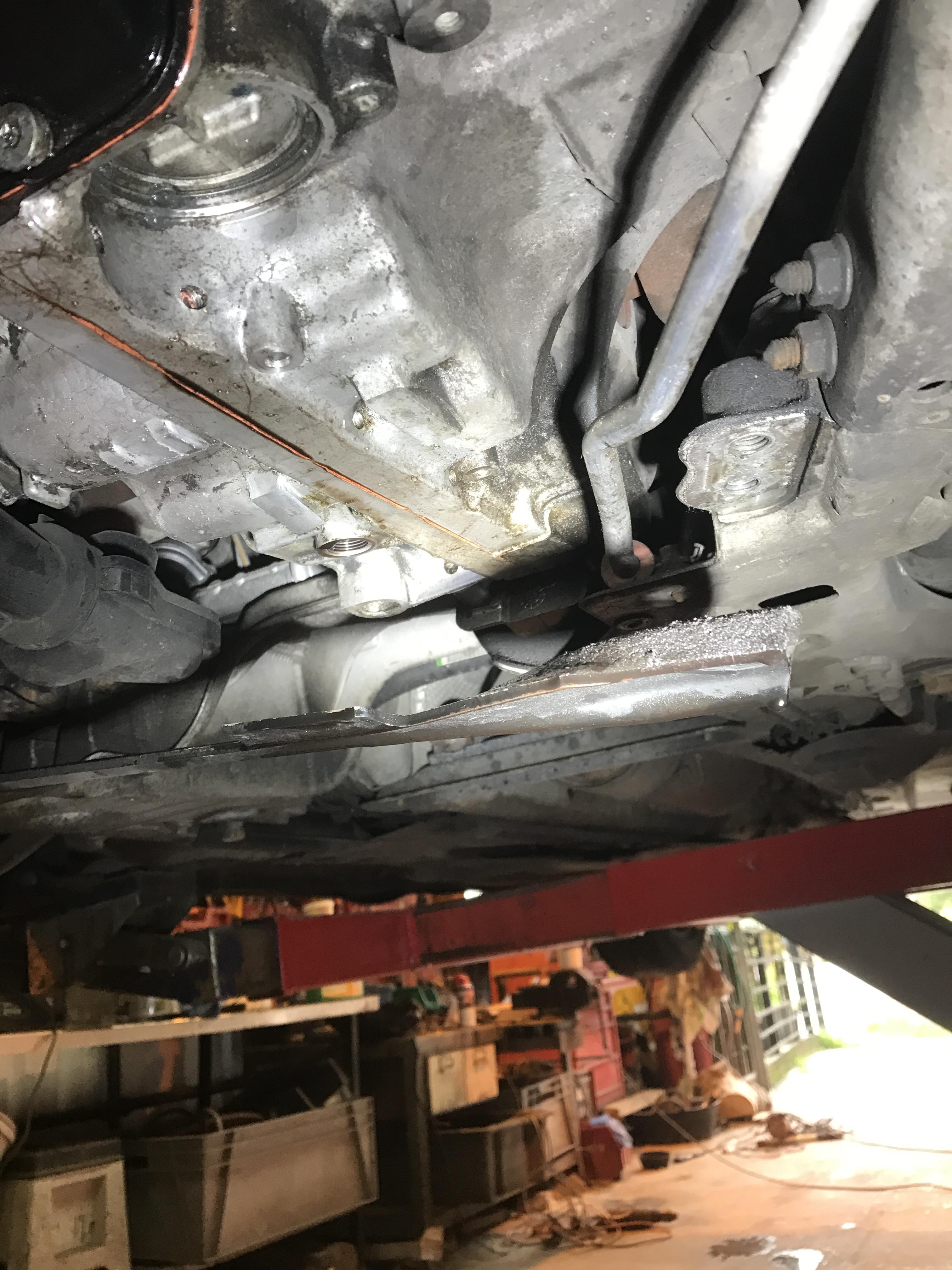

Jacked the car up, enough to get underneath.... Had to remove a crossmember that Citroen decided to fix right in the way of the drain plug
Crossmember is difficult to see here, but it has 2x18mm bolts each side, I managed to loosen it enough to push out of the way.

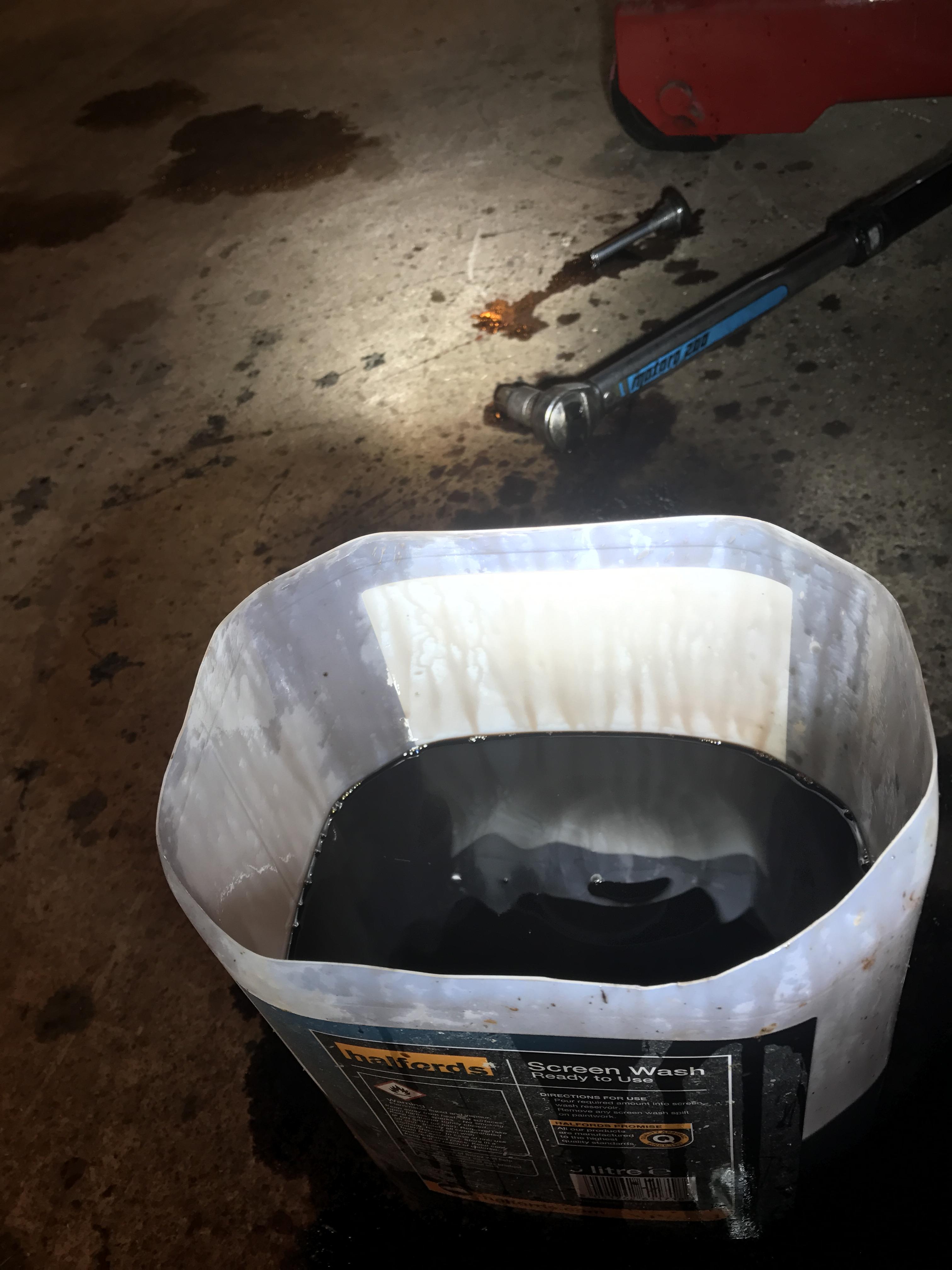

Let the drain begin!
As you can see, it's pretty black, just like that other pic of the oil at 60k miles. Mine has just turned over 58k.
About 3 litres of oil came out.

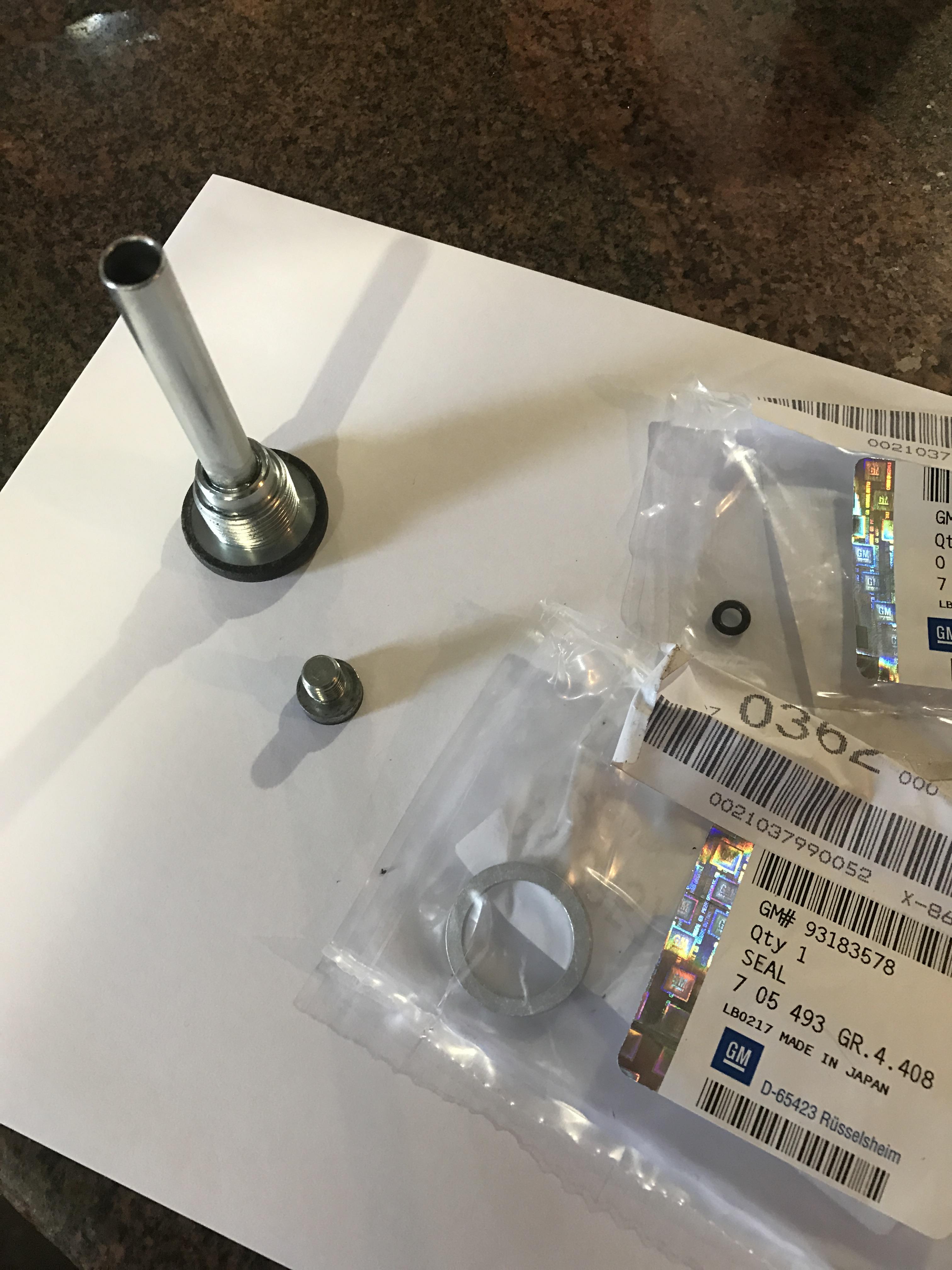

Next step was changing the crush washer and O-ring (Thanks Vauxhall)
Then back with the outer drain plug

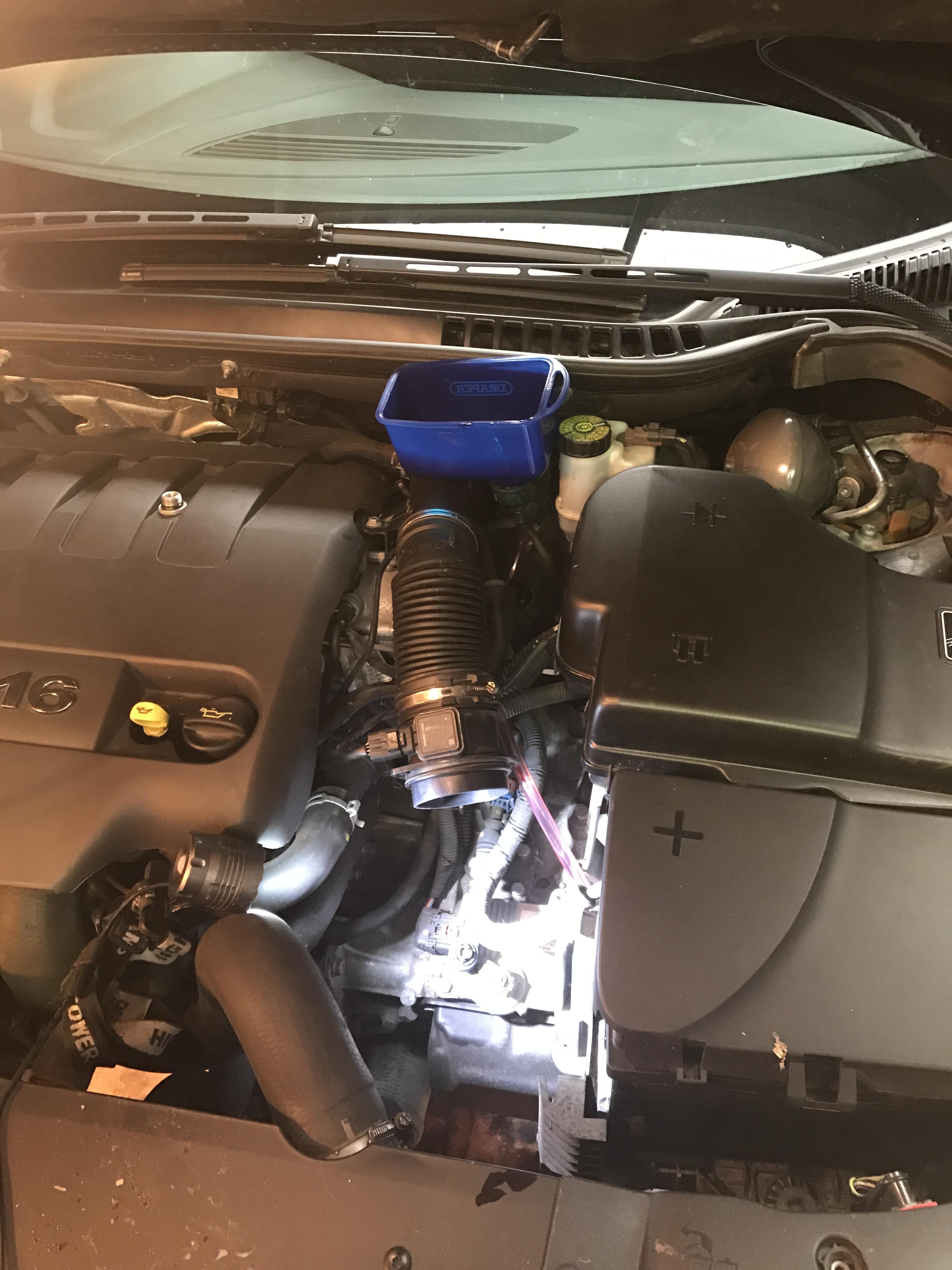

Next comes the filling, using the handy draper funnel.
So far so good
Here was the problem that I wasted a lot of time on: after putting only 2 litres of fresh fluid into the box it began to overflow.... not good... I was still a litre short of what drained out and I thought that a cold box would take a lot more fluid than a hot one so this was very unexpected.
Que about an hour of pissing about with the car lift trying to get it dead level.... and failing.
This was a red herring, I don't think the horizontality... is crucial and sensitive to plus or minus 0.5 degrees
I then decided to sod it and jack up each corner of the car and put a concrete block under each wheel.. sorry, no pics of that.
After running the engine and cycling through the gears I added a touch more oil and still it came straight out of the gearbox... not happy.
I consulted the notes and decided to just follow them and not think too much, I fitted the inner level plug, added 500ml of oil and ran the engine until the gearbox got to 60 degrees.
I then got under and took the level plug out again and to my surprise not a drop came out... Excellent!
So, following the instructions I am told to add another 500ml, heat up the box again and check the level.
This time a thin stream of oil poured out for about 5 seconds then it slowed to a "drip-drip"... Bingo!
This is what I'm looking for, I sealed up the level plug and stopped the engine.

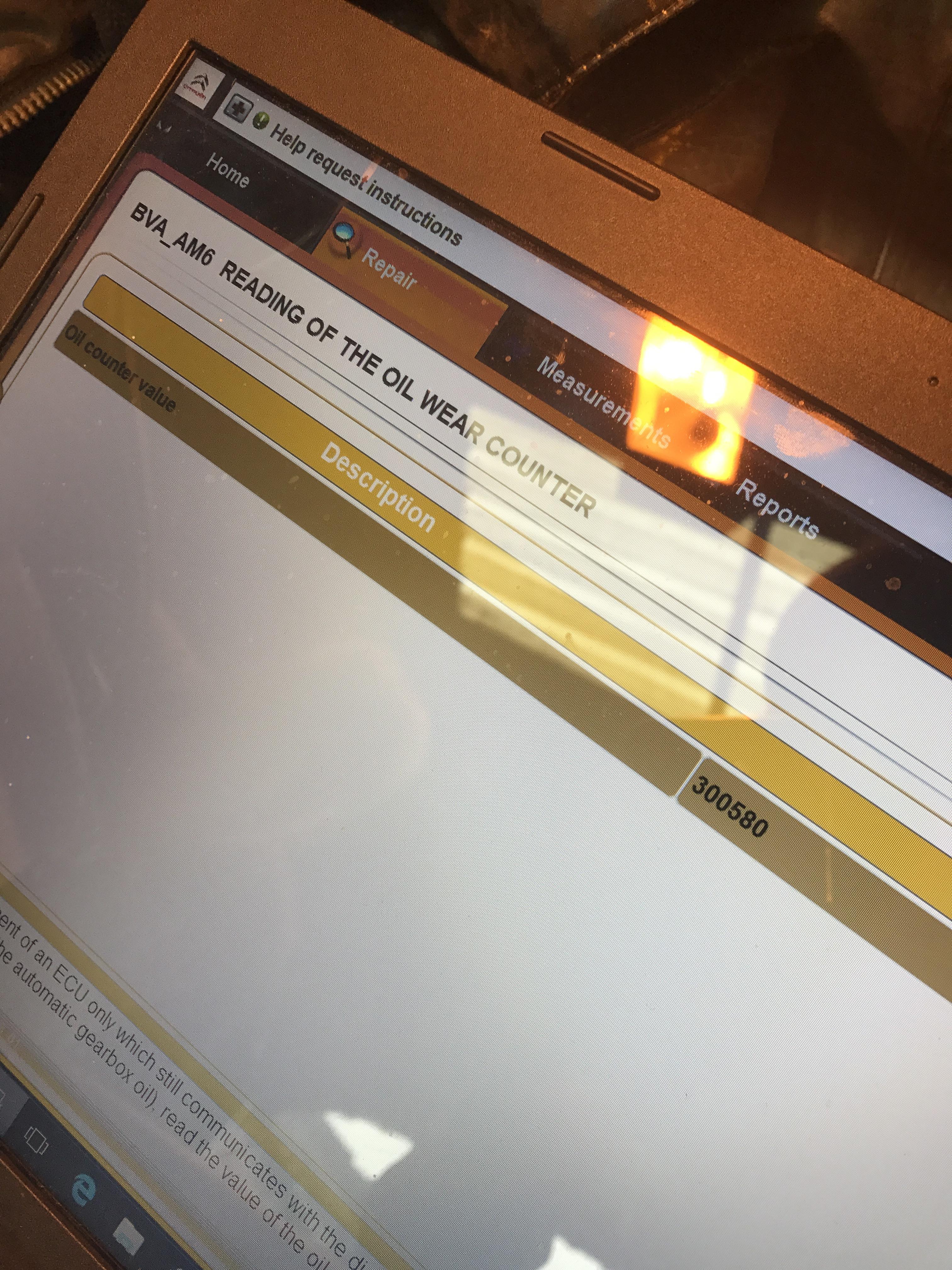

Then it was time to reset the Oil wear counter on Diagbox
Then it was just a case of putting the fill plug back in and putting the filter and housing back.
So, one test drive later and it seems better, smoother and faster to change gears.
The most important thing that I realised was that the oil level must be checked with the engine running as with the engine off the capacity of the box is a lot lower and it overflows after only 2 litres of new fluid.... I'll know for next time

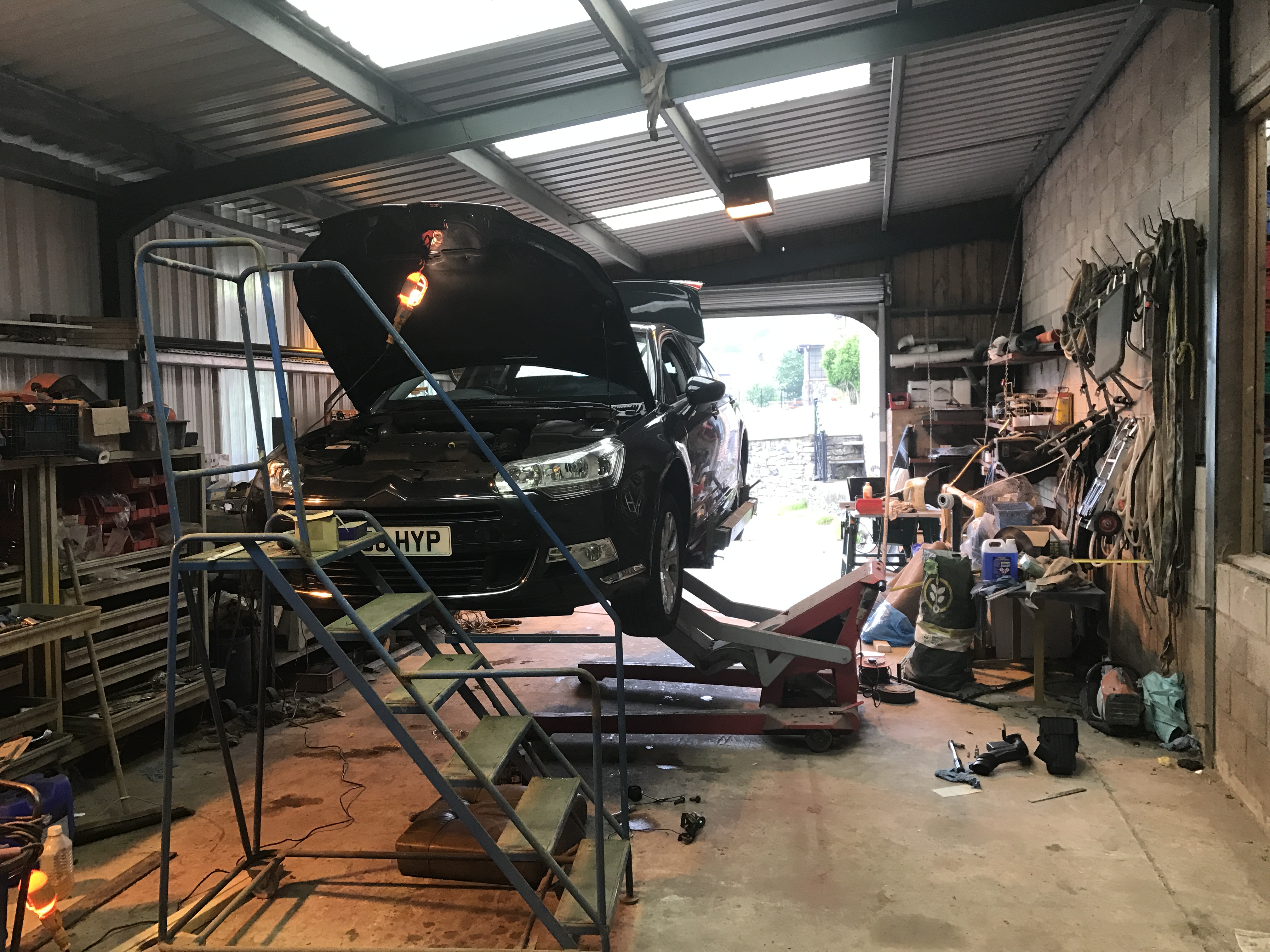

Nice clear pictures there so much better than the usual diy photos and your under-bonnet looks a hell of a lot cleaner than the one I'm doing.
After years off the road it has ally corrosion growth and cobwebs everywhere.
Your workshop is the height of luxury, I'm working on the paving slabs out on the drive, keep getting rained off, but I'm pacing myself.

I thought his workshop was somewhat disfunctional - there's still clearly loads of storage space left on the floor and you can move around it freely without tripping over things. That's just plain wrong

Haha, it is uncharacteristically clean on account of moving the car lift around.
One of the perks of living on a farm is needing a big workshop I hate doing anything to the car when I'm at Uni and have no tools and have to park on the street

Pet
I can understand the worry as the AM6 seems to be shrouded in mystery and contradictory info. If I'd have filled the new oil with the drain level plug in and only measured the level with the engine running the first time it would have been a breeze! But once I got confused it was a bit worrying, never mind, next time will be a lot easier
I'd say if my oil was black at ~60k then at 80k it would be definitely due a change in my view.
To be honest, it might be worth you buying a Diagbox/Lexia as it will come in handy, I got mine for about £120, definitely worth it. I wouldn't chance it myself by guessing the temperature as it takes a while to warm up before you check the level.
