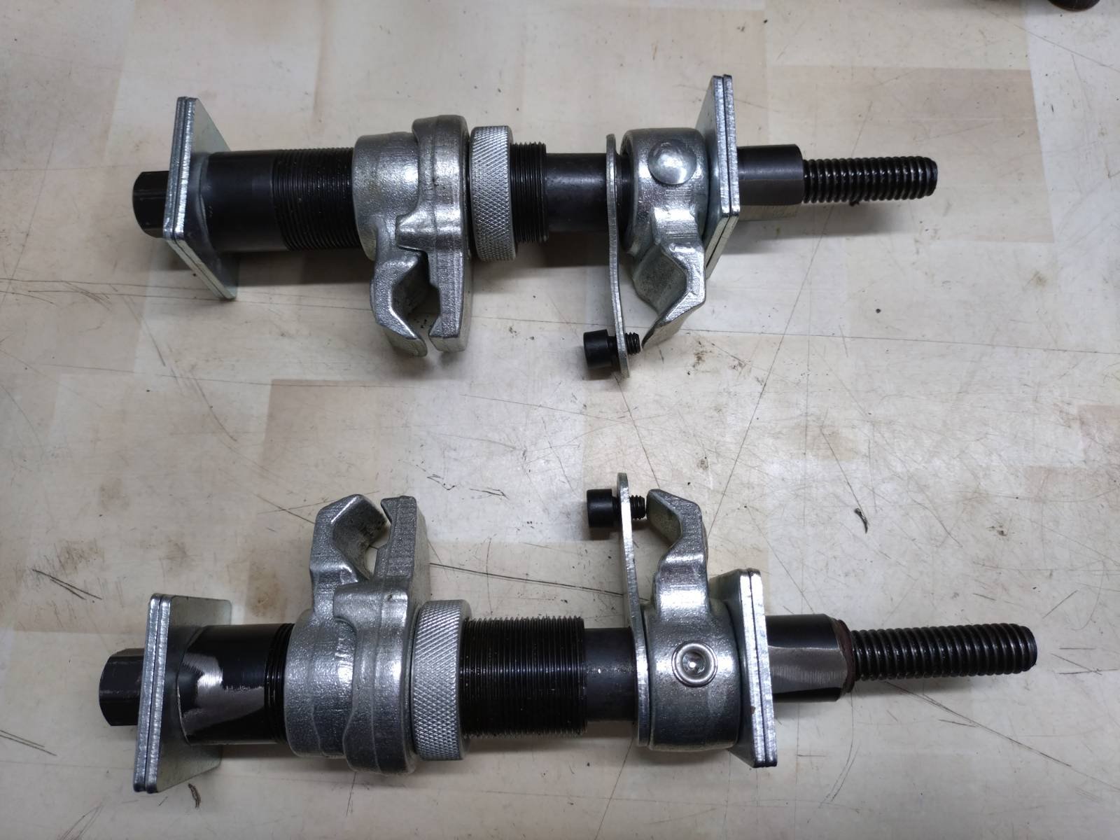

Anyone foolish enough to follow my antics on the DIY Motoring thread will remember my plan to overcome the problem with the dangerous 'push fit' joint in the spring compressor. I posted a sketch of my plan to remake them with a far safer design.
Today after completing my headlight polishing I set about the necessary work. First job was to erect a safe grinding bench using my welding blanket to catch all the sparks:
The bench and vice in my safe zone
Firstly I cut the handle off the lower hook bar to give me more bolt length at the top.
The hanle removed
The hanle removed
Then I had to cut the upper tube as I was moving the failed receptor boss from the bottom end to the top. I actually cut too short a piece the first time so I made a second cut which gives the two waste tubes in the picture further down:
The first cut of the upper tube
The next job was to grind 21mm flats onto the boss that had pulled out to be used as the captive nut at the end:
The boss with the flats ground on
The last task was to cut out the top hook retaining pin to allow the bolt to pass through the end to the repositioned nut and newly sourced bearing washers:
The pin in question
The pin in question
Then it was a matter of cleaning up the edges and assembling the unit in its new arrangement:
Note the two sections from the upper tube
Laid alongside the original so the lack of inset tension joints is clear:
Comparison of original and revamped version
Having completed the job on the failed unit I repeated the procedure, but cutting the upper pipe just once, on the other unit to eliminate any chance of a similar failure in the future:
The finished job
The finished job
