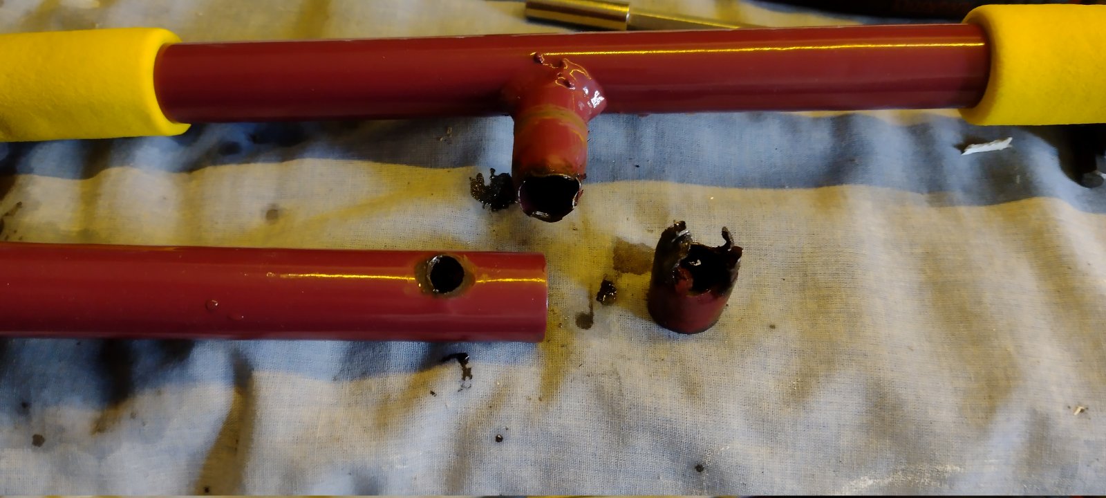

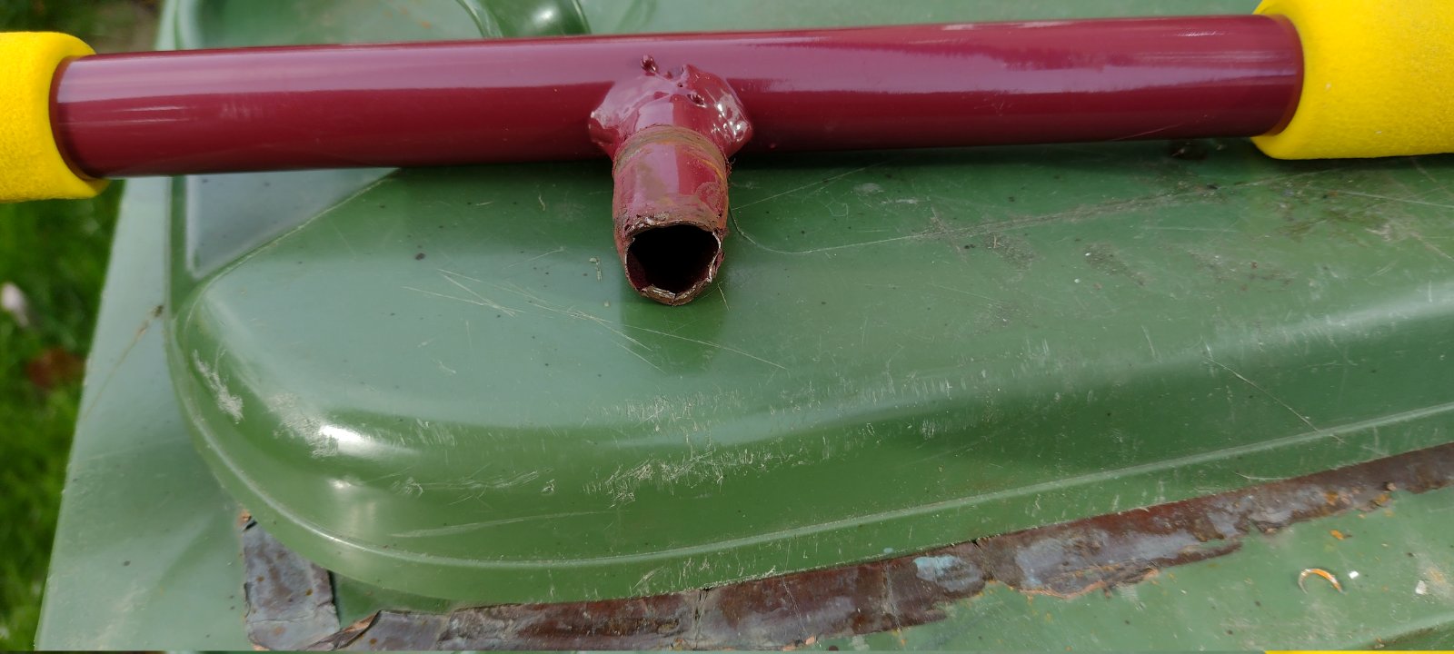

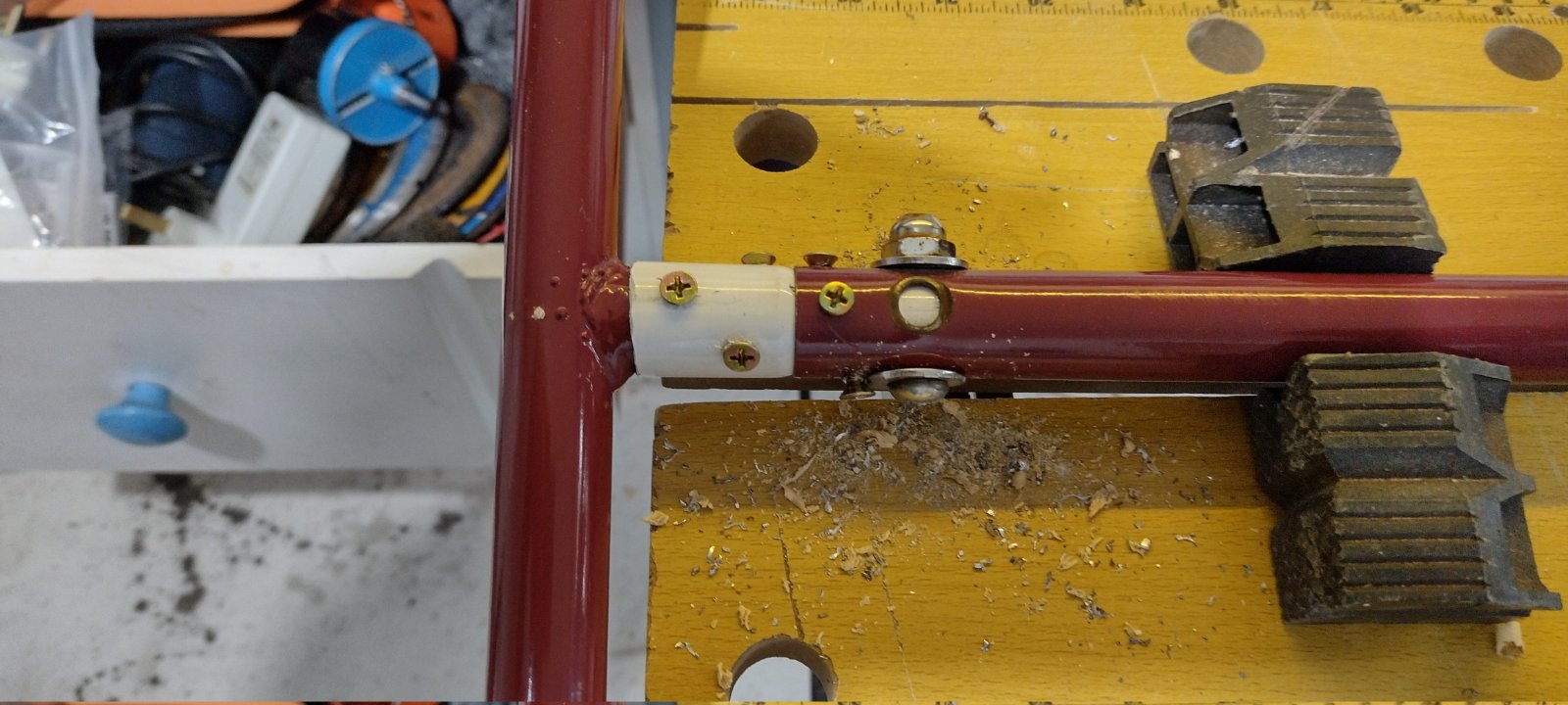

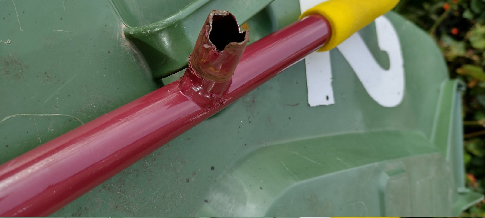

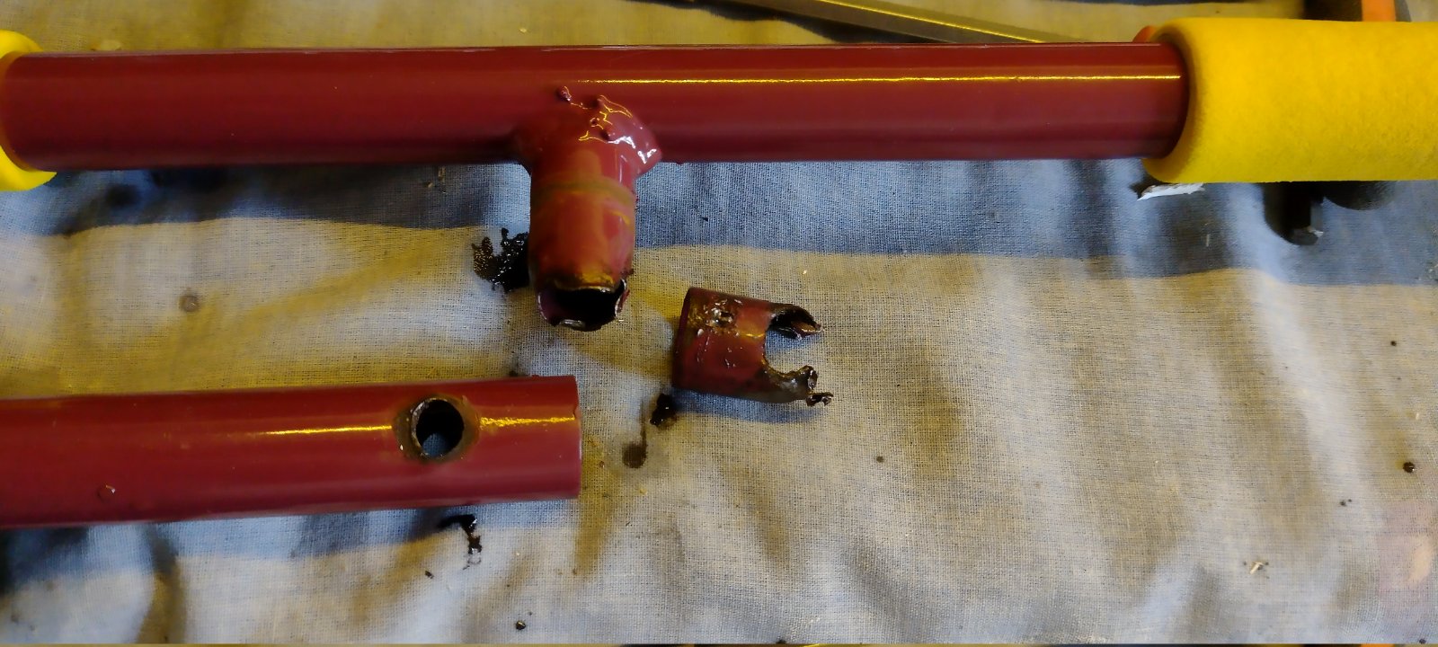

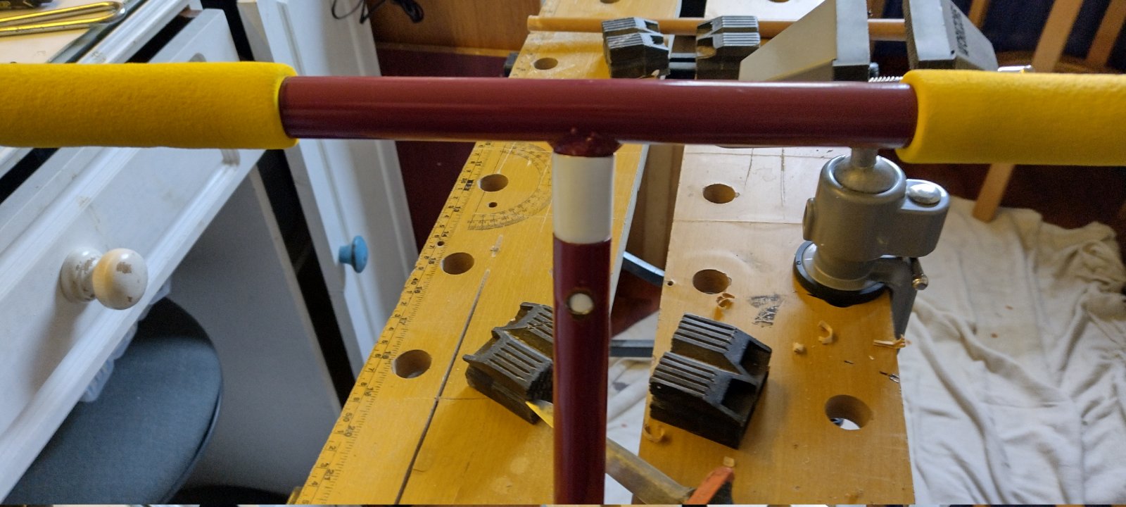

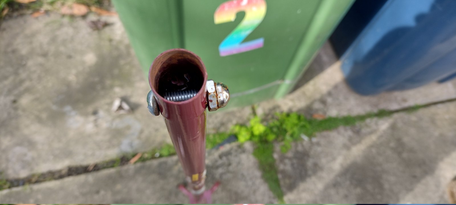

A recently purchased cultivator (thingy for churning soil up with).
It had a bit of slogger from new, the bolt securing the handle to the shaft was smaller than the holes it had to pass through. I knew it would fail eventually but not as soon as it has.
A bit of artisan bodging and we are back in business. A bit of some sort of tubing, perfectly stepped at one end to fit both inner and outer tubing, a chair leg rammed inside as a bit of additional strengthening, new correctly sized holes for the through bolt and a handful of self- drilling screws placed with random precision. Fixerizated as our American brethren would be likely to say.
Not pretty by any means and I will probably replace some or all of the screws with smaller through bolts.
Won't be keeping it outside any more as when I tipped it up half a pint of black and smelly water poured out.
The first photo's before the bodgering took place was to send to the seller for a bit of a moan and to demonstrate the inherent weakness of the design and construction.

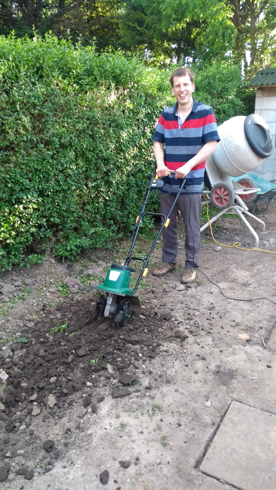

Gosh that's terrible quality/ poor design on the cultivator/ manual rotovator! I'd be having a go at welding that back together, though looks very thin wall tube so perhaps an exercise in frustration.
I wholeheartedly recommend the electric equivalent, this is £30 second hand Facebook marketplace bargain I use: Please excuse the cheesy grin - rather pleased with my purchase!

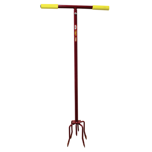

That is far too industrial, mine is only needed in very small areas and that would be too much.
I did consider welding but don't have the necessary so would mean a trip to the car mechanics. Bodgery will suffice.
It is one of these:
It is one of these:

Ah yes, know the type. Have used one previously. Good for compost heap churning.
