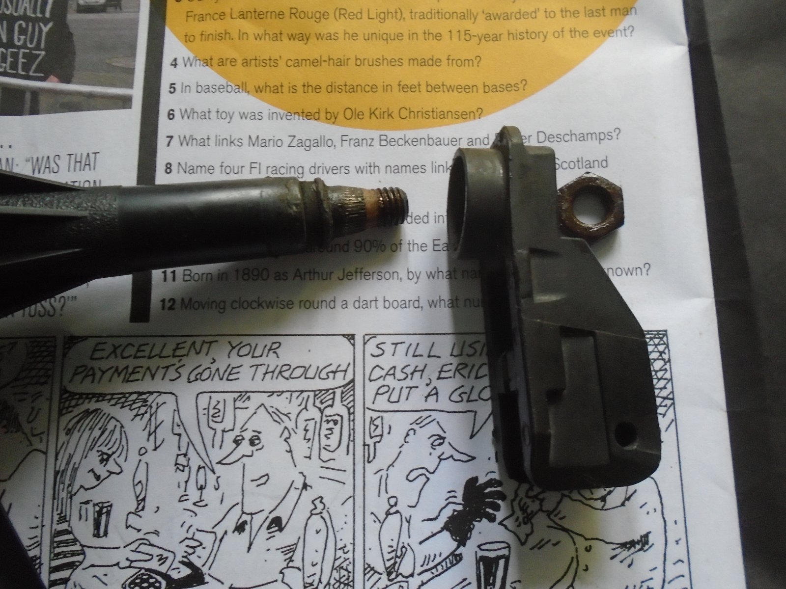

I haven't made up any tools for a long time until about a week ago, couldn't get the drivers side wiper arm off a 406, tried everything, had a rummage round in the garage and found an extractor that I had made for something else, couldn't remember what it was so thought I would modify it and it did the job perfectly.
I used a section of about 1 1/2" square tube, drilled a hole in one face and welded a nut onto it with a bolt that would screw into the tube, on the opposite face I cut a grove so it would fit over something, as I say, cant remember what it was, so I took the grinder to it and made the slot wide enough to fit under the wiper arm and tightened the screw, came off in seconds, I had previously wasted a couple of hours trying to remove it.

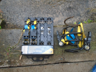

Bit of duplication but my "spring compressors" are worth a mention here too
Obviously a compressed spring can be lethal if your spring compressors break, but if the rachet or webbing gives way, particularly if you have 3 others in place, and several turns of webbing around the coils for each the likelyhood of a total catestrophic failure is reduced.
Anyway worked for me.
