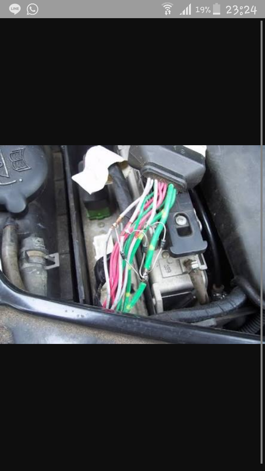

Re: Xantia fall down then open the door help me
What is the process done in this picture? And the diode used is there anyone who knows what?
