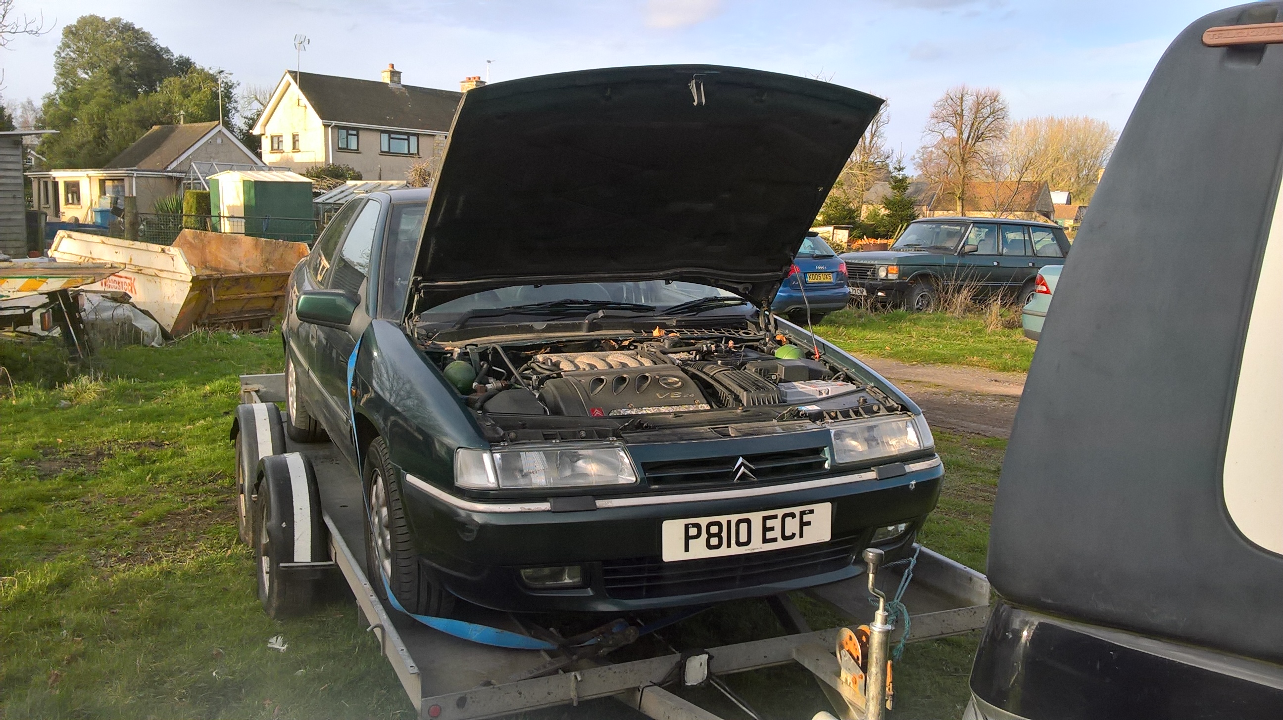

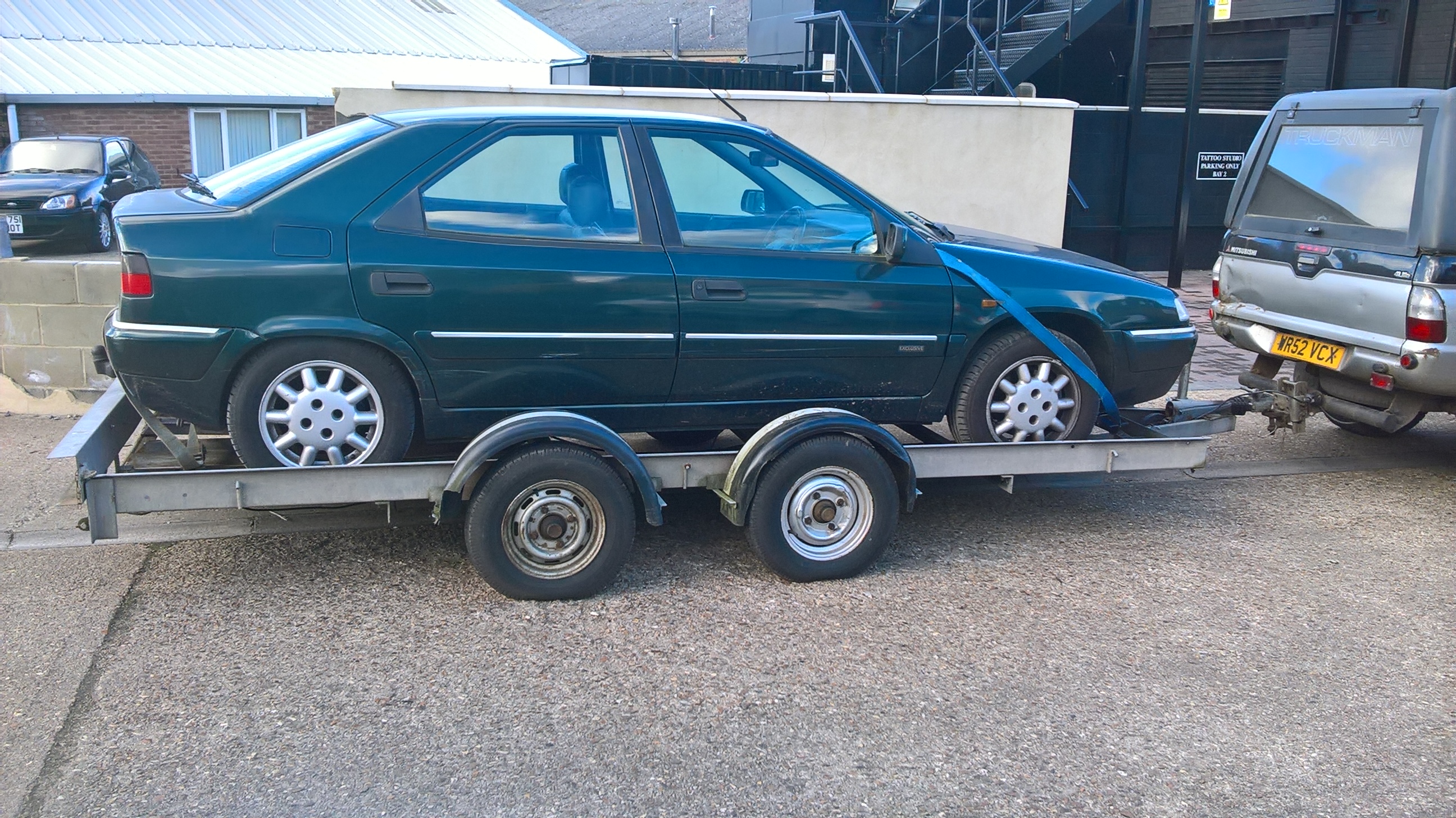

Picked up this little gem yesterday. I was very excited. :-D :-D
Not had a chance to look at it properly as its still on the trailer, but looks to be be in reasonable condition. Didnt get home till 10pm due to a lorry fire on the M4.

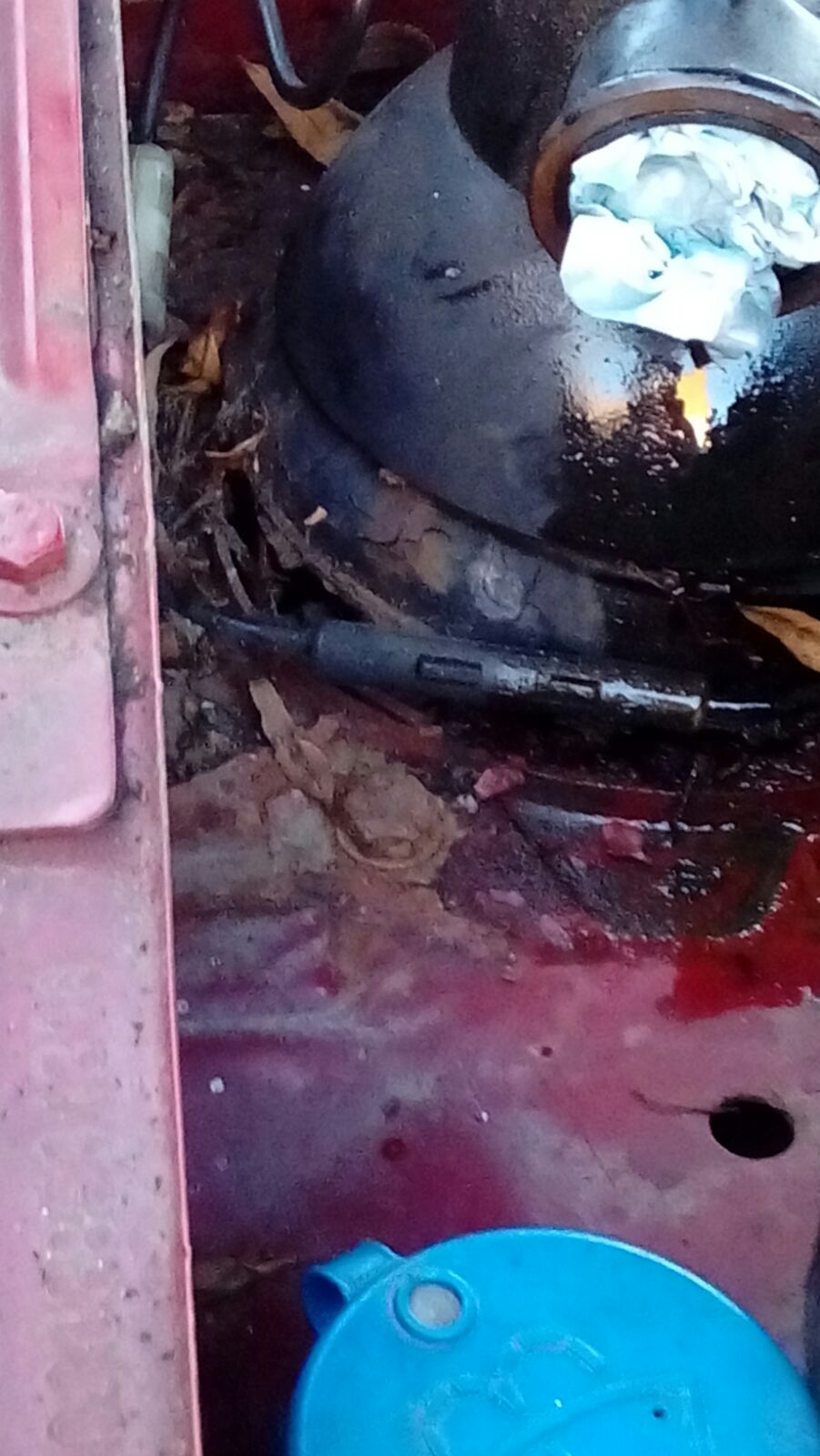

Will hopefully get to look at it over the weekend. Has some rust at the rear of the sills and a leaking height corrector but not as bad as I was expecting.

Ohh, sweet :D
A very early S1 V6, the most desirable of the lot 8-)
Looking forward to hearing all about your adventurs with this car ;)

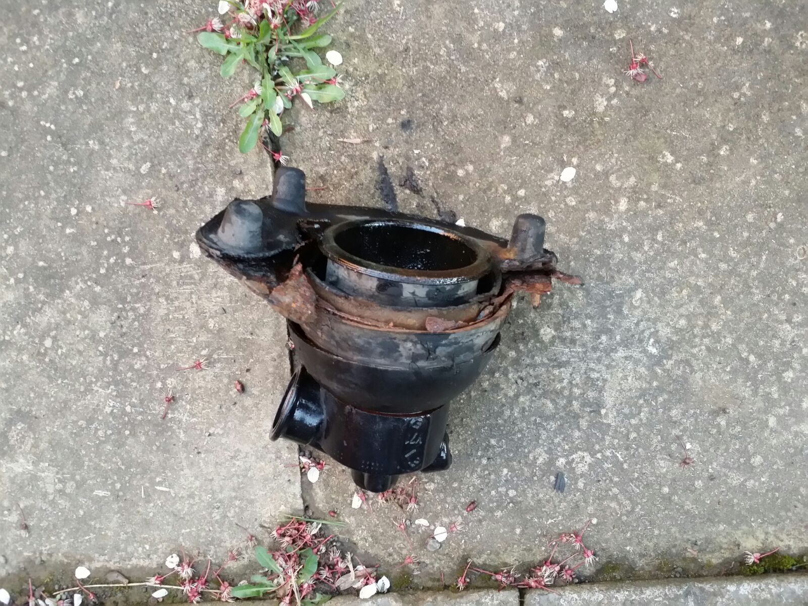

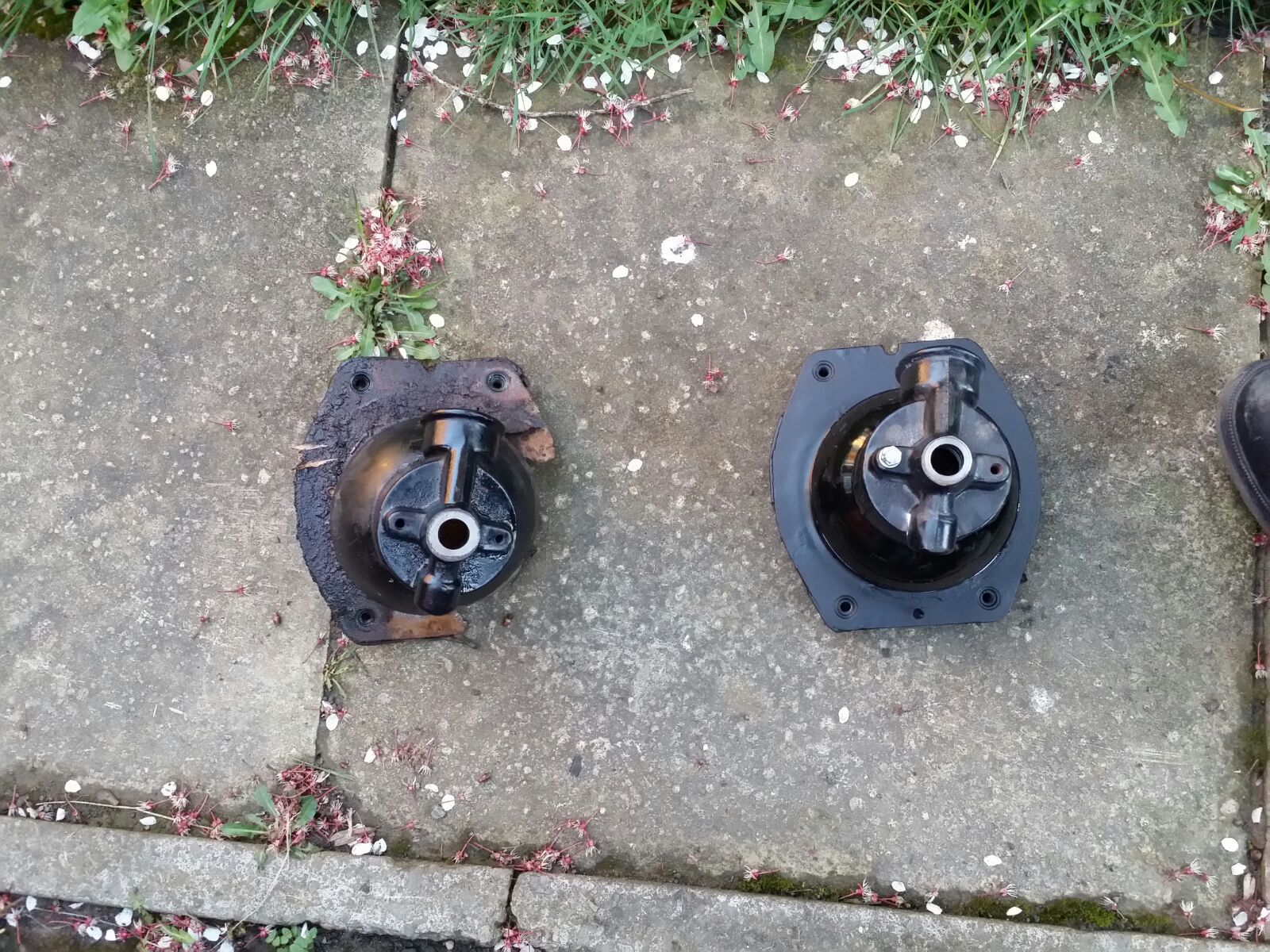

Not been able to get at the V6 yet. Family life keeps getting in the way ! I have had to replace the strut top on the TD as it was in imminent danger of collapse. I knew there was some rust in it, but I had no idea it was this bad. After hitting quite a brutal pothole it tried to make a break for freedom.
As i removed the defective one it was literaly crumbling in my hands.
I used the one from the old white TD to replace it. Thankfully this is in much better condition.
I,m sure they were checked last time I got the car MOT'd. Cannot believe it would get that bad in a year. Although she is the daily driver and out in all weathers.
