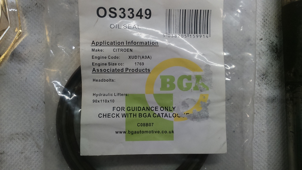

RichardW wrote:service.citroen shows:
0127 28
01
CRANKSHAFT BEARING SEAL
90X110-7
SFCM -
This is the oil seal I've been sent. Haven't got the flywheel off yet to see if it's the same or not.

Post by RichardW »
Might be a bit thick as that one is 10mm rather than 7 speciified....

Post by Ianhw77k »
Just my luck if it's another wrong part.
At least this one was local.

Post by Ianhw77k »
Yep, wrong part. Story of my life!
Right part ordered, should be in Monday. I'm tempted to see if the thicker one will work but that just sounds too much like tempting fate.
