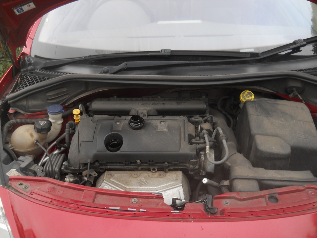

Ok I've changed the oil & all the filters, took me a while to find the oil filter as I was looking underneath! It was pretty easy & not that messy. We spent the afternoon vaxing the seats & carpets since the previous owner obviously had small kids & the dealers "valet clean" wasn't up to much. Came up a treat though!CitroJim wrote:I'd check the engine type:
If it looks like this...
You have the ET3 with a rubber cambelt!
The cambelts are so easy to do on this engine. I've recently done Robyn's and it was a stroll in the park on a summer's day...
The engine is most definitely the BMW Mini/Peugeot one though and as CitroJim says the BOL doesn't admit it exists. I thought it was nippy & now I see it has 95BHP so not too surprising!
