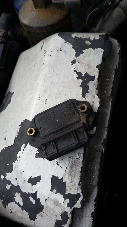

It may be the ignition amplifier Hans.. This is a standard Bosch job screwed to a flat alloy plate to act as a heat-sink. Generally they cause a misfire before failing though...

That really does sound like the ignition amplifier Hans!

Ok, thank you Jim. I will look into that tomorrow. If i can measure some juice to and not from the little thing I guess I will know .

Anyways. Since last time I've waited for the shipment from the UK containing the ignition module. Due to simpletons at the local post/grocery shop the shipment sat there for a week before I tracked it down. Anyways. Once in my hands it took 5 mins to swap and less than 1 min to realize that was not the fix. There just is no spark at all coming from one of four outs on the coilpack. Called the local Citroen dealership and they could order one to the healthy price of 200 pounds .. . Neh, I think I will source it from somewhere else.

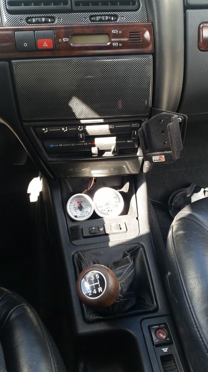

Picture time. Not much to add. I mocked up a center console thing from cardboard to see what would fit before I draw it out in autodesk inventor and 3D print it. Not a beauty - but I only needed location and dimension. Hopefully i will get it to look remotely stock once done.
The ignition module that was innocent after all.

A bit low for easy vision when driving maybe ?
Some guys mount them on the screen pillar

@Alistair, hopefully i won't need to watch boost and AF all the time. I agree it is low but they are angled in such a way that they are relatively easy to glimpse at. What I could do was to not have a headunit(use phone)/relocate headunit and stick the guages in its place and angle them a little from there.

ANY gauge you look at needs to be is "line of sight" IMHO and should not need head movement to view it if at all possible. A few milli seconds is all it takes to avoid that moose/kid/Euro pallet in the road
Radio can be done by feeling if it has buttons and knobs on it for "general" control.
Is there not space if you remove the AshTray to fit a head unit into that area ?
