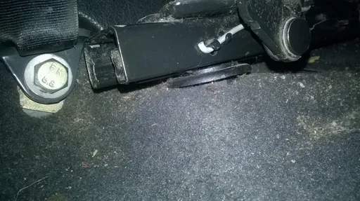

Hello from Finland.
How you can remove the front seats from Xsara PH2 Estate.
The front bolts are easily removed but the two in the back are under the frame.
Attached pics:

If it's like the Xantia, you remove one set (rear or front, can't recall) and then this allows the runners to move beyond the (now-removed) bolt heads giving access the other set.

rears first, then move seat back, then the two forward ones.
You have to stop the large black washers from turning as you undo the set screws
