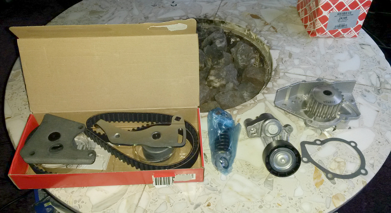

Today my aux belt tensioner finally arrived, so I should be pretty much set for the timing belt change at some point shortly (should I also change the eccentric tensioner down by the alternator or is that one usually reliable?). We've got the belt itself, it's pulleys etc, water pump and the spring loaded aux belt tensioner. Got a new aux belt on the way too, though the current one actually looks perfectly serviceable so it's less urgent at least.

try contacting Hella as maybe they make the hole thing,
with the aux belt tensioners i find its usually the auto tensioner arm pivot bearing that fails and cocks the pulley over, yhe best way to test the pulley bearings is with the belt off and spin them

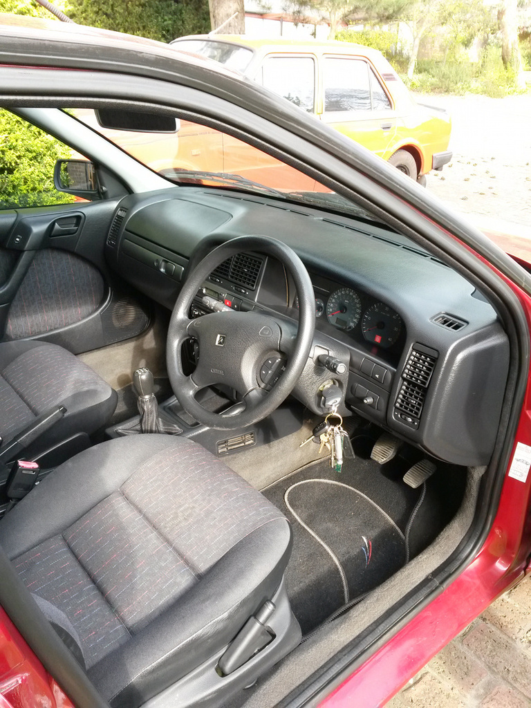

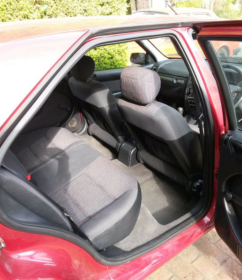

Today I ended up with a spare hour or so, so instead of doing something on the actual to do list, I dug out my cleaning supplies and attacked the interior of the Xantia. It had been full of dead leaves and dog hair for the last month and a half and it was doing my head in.
After about an hour, this is how things looked.
Never really appreciated until sitting in the back working on that area what a ridiculous amount of room there is in the back of the Xantia for a car its size.
Hopefully get this lot fitted soon (having finally managed to find the water pump and timing belt today that I got weeks ago and then tidied!). Will probably give Jim a shout and see when he would be available to be on hand to make sure I don't make a complete meal of it.

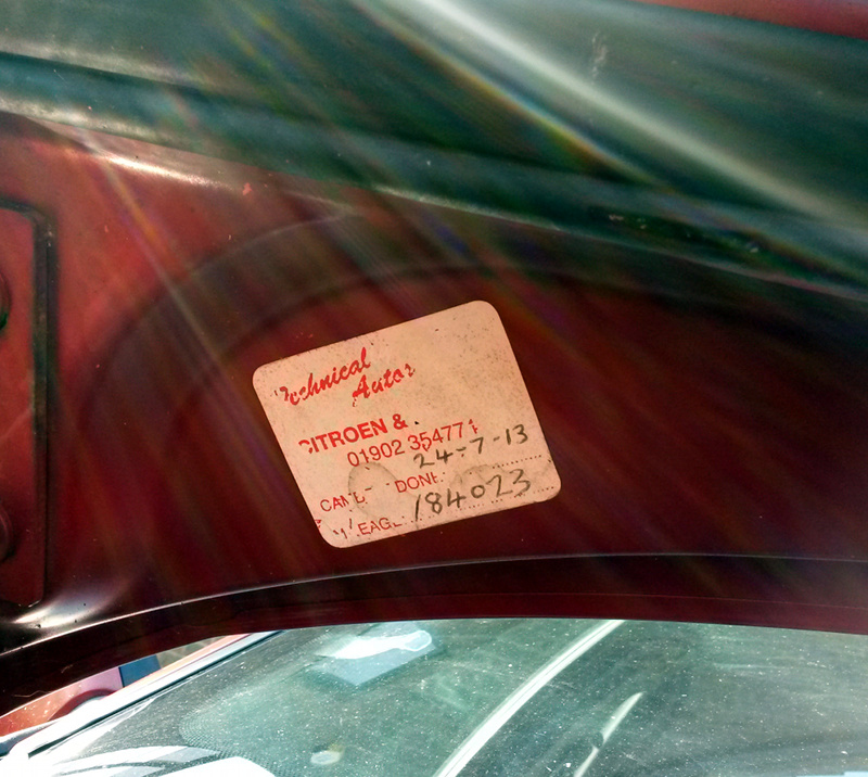

I did notice something though when sitting in front of the car looking up at it. A little white sticker hidden in the recess at the back corner of the bonnet for one.
What a stupid place to put it...Only places you can see it from are if you're sitting on the ground in front of the car or standing on your head by the washer bottle.
Hmmm...
Hmmm...

Well, at least you know the belt has be done relatively recently Zel
