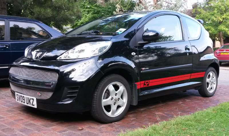

Yesterday afternoon the 107 actually got a bit of attention for a change. I *finally* got around to getting the side stripes put on - they've only been sitting on the shelf now for...about three years. I reckon they suit the character of the car quite well.

I like that. I was going to get white, as ours has white mirrors and the same wheels as yours. However I haven't been in it for 3 weeks now, and I'm not spending money on a car in not using.

I think either red or white were optional on the Sport XS trim (along with ones running over the bonnet/roof) which was essentially replaced by the Verve when the 2009 facelifted cars were introduced.
Red with black detailing is somewhat of a trademark for me though wherever I can get away with it though so the red stripes were an obvious choice for me!

My previous 107 was an 09 facelift urbanlite in red and it got black 15" alloys and black sidestripes, so red and black works. If I do take the 107 back in the future, as it is black with white mirrors and white trim inside it will get white stripes, and perhaps white wheels.

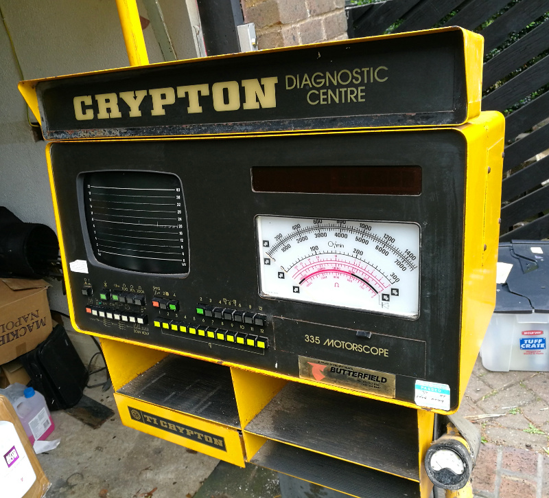

Picked up a little present for the fleet today...
Came complete with all the necessary test leads and documentation (including service data for all cars I'd likely be using it with).
Sadly I don't have the companion unit with allows this to show exhaust CO levels, though obviously once I find out the exact details of that I'll keep my eyes open for one.
Despite having been partly exposed to the elements for quite some time (last electrical test was done in 1999) the innards actually looked to be in astonishingly good order with no obvious signs of water damage. It's now safely tucked in a corner of the garage and will be properly investigated tomorrow I think.
For those playing along at home, date codes on the electronics inside all seem to suggest a late 1982 build date.
Also, yes, it did fit in the back of the Saab (albeit with the boom with the tester sockets detached of course).
