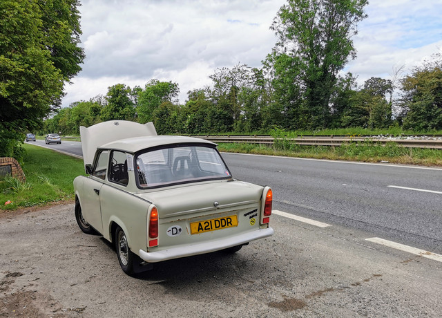

Well carp...
Expensive "Oh carp" as well.
Something major appears to have let loose in the bowels of the engine. Was running absolutely fine, bumbling along at about 45, there was a single cough, then about five seconds later it sounded like all hell broke loose. Immediately shut the engine off and coasted into this lay by. Engine now hits a hard spot when you try to turn it by hand.
Best case? A piston ring has broken up. Given this engine has always been a bit ratty though I think that's probably being optimistic.
Waiting for recovery. Then I'll need to leg it down to MK Central and find a train to Birmingham I guess!
Abby needs the Partner over the weekend, the Rover I don't trust to make it for a second as it's still having fuelling issues, and TPA sadly is still buried in the garage, and currently missing a fuel pump as that's just about making the Rover currently run.
First "there's no way we're fixing this at the side of the road" I think I've ever had in one of my own cars. We didn't try to sort the issue on the Saab as I was literally about a mile from home and I'd flagged down an RAC patrol so it was just easier to stick it on the recovery bar than faff about in the rain.
This ain't getting fixed here though!

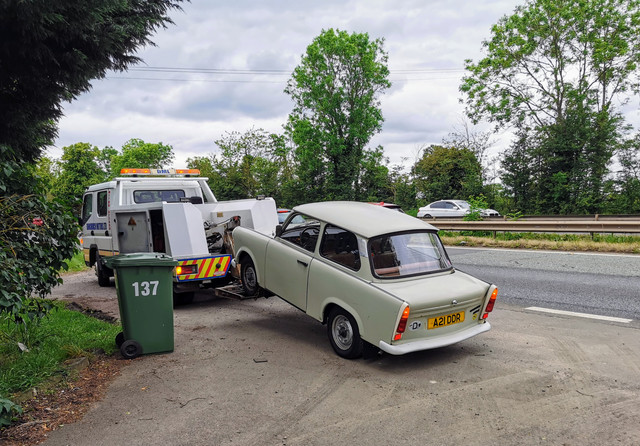

Recovery was on the scene in about half an hour. Can't really complain at that. Yes there's a £25 excess, but again absolutely can't complain about the service provided by AutoAid.
Soon enough we were bouncing our way back to MK.
Dear...God...that Mitsubishi thing has to be the worst riding vehicle I have ever been in. The reason you got no updates while en route was because it was so bouncy I literally couldn't read my phone for more than about ten seconds at a time.
Lovely driver as well, we had a great natter on the way back. Even if it did take for bloody ever because of an accident on the M1.
Car now deposited at home. Confirmed it is indeed still the same now cold. Rotates absolutely fine through about 2/3 of a rotation, then hits a hard stop. Will dig into it once back from ConFuzzled.

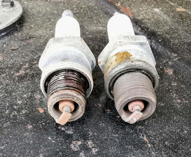

Plugs out and we have immediate evidence of some issues with the number two cylinder. There has clearly been something bouncing around in there.
There's definitely some impact marks on the plug and the gap has closed up a bit.
Both pistons are moving though, so it doesn't look like we have a broken rod. So something has made its way into the combustion chamber, and my guess based on how it's behaving has got itself wedged in the exhaust or induction ports. The question of course is *what?* Bit of a piston ring which has come apart (which is my current favourite theory), a needle roller from a bearing that's come apart, or some completely foreign matter from somewhere?
That's probably a decent starting point though. We might not need to completely dismantle the bottom end. Maybe, if we're lucky.

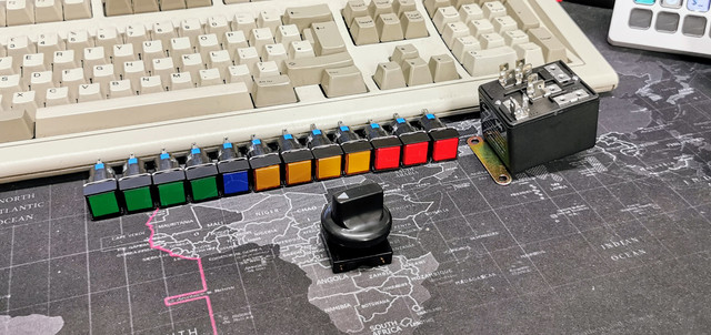

While I was away a few more bits for the AC control system project have arrived.
Fan speed switch, potential relay and a shedload of status indicators. Still waiting on two latching push buttons (which match the style of the status indicators), and a few reels of wire...then I think we'll be ready to make a start on actually ripping the old control board out and building our new massively over-engineered version. Sure I'll end up questioning my sanity once I start trying to put the resulting spaghetti together.

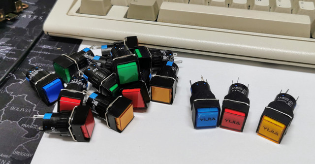

In better news, the last switches I'd been waiting for have now arrived. As hoped, they perfectly match the panel indicators I'd picked up.
Only two of these are actually going to be used (blue for cooling enable, red for heating enable), the orange one was originally going to be the power switch until I decided to use the Unimax one to combine the power switch and indicators for both standby and power on. None of these will be carrying any real power, that's all going to be handled by relays.
