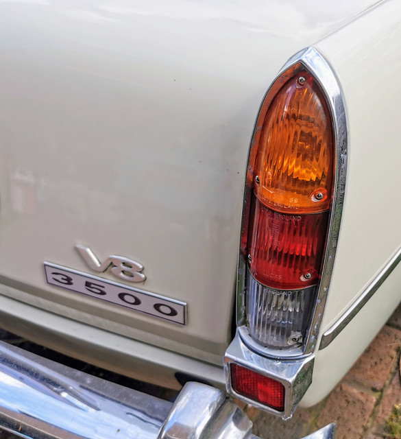

I'd noticed that the tail lights on the P6 were full of condensation again over the last couple of weeks. I'm not entirely sure if it's just got in since I changed the seals or if there was still moisture in when that was done. So I took them apart again, blew everything out with the air line, left them apart in the sun for a couple of hours before putting them back together.
Lenses need a really good clean, but that's a job for further down the to do list.

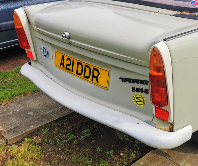

On the Trabant the patchy, rusty headlight surrounds have been tidied up.
This was bugging me as I could see the rusty bit from the driver's seat so I needed to do something about it.
I do need to do something about that hole in the wing, that sorted and a bit of paint on the front panel would make the car look a lot less scruffy at a quick glance.

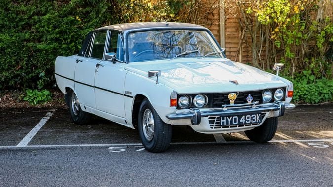

With more than a slight feeling of déjà vu, I found myself here again this afternoon.
Managed to end up with two cars with their MOT due within a couple of weeks. Not the best planning on my part.
I need not have worried.
Advisory for some rust on the offside outer sill, which is absolutely fair I reckon. It does need to be attended to now to prevent this becoming an actual problem.
Think there's a couple of nicks in the stone chip there which have let water get in behind it and lift the paint. There's nothing which seemed at all crunchy when I poked it today, so now the weather's (in theory) getting better I'll get it all sanded back, rust treated and repainted soon. Now we've got a clean MOT pass under our belt I feel a bit more free to throw some time and resources at the long term future of this vehicle. I've heard a few people speaking highly of Lanoguard for underbody protection recently, so might be time to give it a shot on this one.
As an immediate reward for the MOT pass I made the front end look at least 50% less shabby in less than ten minutes.

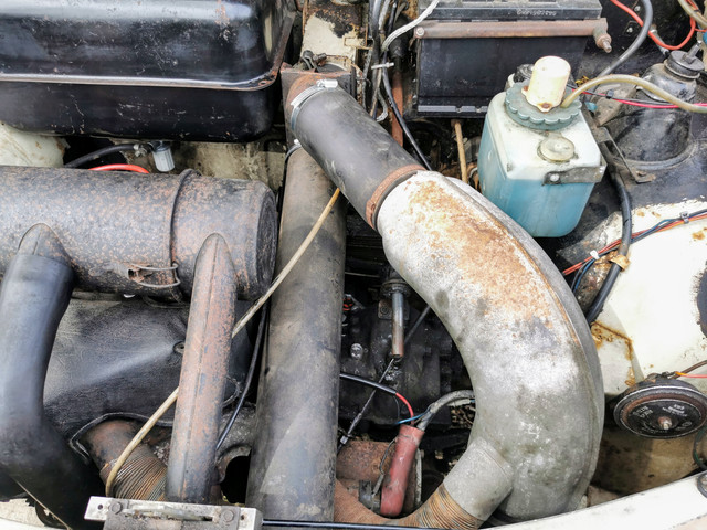

Actually had a bit of a hiccup in the Trabant couple of days back. Was about a mile from home, came to a stop at a junction and found it bogged down when I applied throttle. Was able to coax things back into motion by adding choke, suggesting to me a fuelling issue. I immediately headed for home (which thankfully was mostly downhill so little engine power was needed) with the revs and throttle kept as low as possible. Knowing how quickly a lean condition can become catastrophic in an air cooled two stroke, this wasn't something I was taking chances with. Car was parked up and I grabbed the Partner to continue the tasks I was heading out for. I was working around other appointments at the time so didn't have time to immediately investigate.
Later on I checked the screen in the fuel outlet at the tank (pretty clean), and confirmed there was good fuel flow to the carb. Next step was to pull the cover off the float bowl (which you can *just* do in situ), to confirm the needle and seat were working properly and to see if there was any crud in there.
There was a little bit of sediment in the bottom of the bowl but nothing particularly major. What I don't know (and this does make me kind of wish I'd pulled the carb) was whether there was possibly a bit of water in there as that could definitely have explained it prior to me cleaning it out.
With everything put back together normal service appears to have been resumed. I do need to actually look up a proper diagram for this carb anyway as I'd really like to turn the idle speed up a touch, it has always felt like it's a little on the slow side. Especially if you've got the lights on.

We suffered a major technical failure today.
Okay that might be overselling it a bit. We lost a tail light bulb.
Though admittedly on plenty of modern cars that is a pretty major headache! Takes much more than the five minutes and a flat blade screwdriver needed to replace both on the Trabant.
Really do need to get some paint on that rear panel.
