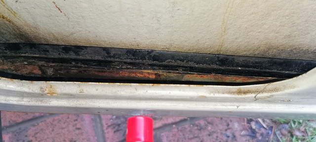

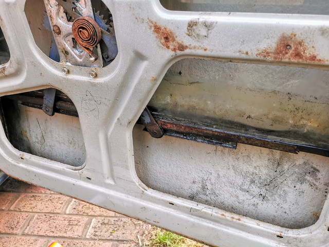

While the Trabant's water ingress issues have definitely been vastly reduced since I've been fettling it, but we definitely still have quite a bit getting in on the passenger side.
Quite a bit of that seemed to be coming in actually through the passenger door. The door card was always wet and I'd noted that the door pocket would actually fill up with water when it rained.
As soon as I pulled the door card off (3 screws and about 60 seconds) a likely candidate for this became apparent sitting in the bottom of the door cavity. Which also explained why that window rattled so badly.
That thing in the bottom of the door, that's the rail that the window should be sitting on. Also acting as a gutter to direct water running down the glass to drip off at either end, away from the door card etc.
The glass was essentially just balanced on the metal rollers that the rail should run on. How it hadn't fallen off or been damaged I've no idea. The rail is in pretty rough shape, but I wouldn't have condemned it. The very ends are a bit crispy, but I've seen far worse. The biggest issue (aside from the window glass having escaped) is that it's been bent quite substantially. I've straightened it as best I can, but it's still not right. A new one is €30 from Trabantwelt, so hardly the end of the world. While the glass isn't sitting as deeply in the channel as it ideally should be, I have managed to coerce everything more or less back to where it should be.
I suspect there would have been some sort of sealant to help bond the glass to the carrier originally as well.
I will need to pull a lot of this apart when I change the window rubbers anyway so I'm not worrying too much about it right now. I've just made a mental note not to open that window again if I don't have to until I've had a chance to get things properly fastened together. There's no chance of it actually falling apart on its own now though and the door doesn't rattle anywhere near as much. Will it help keep the rain out? Remains to be seen. I did look at the driver's side one before and everything looked okay.

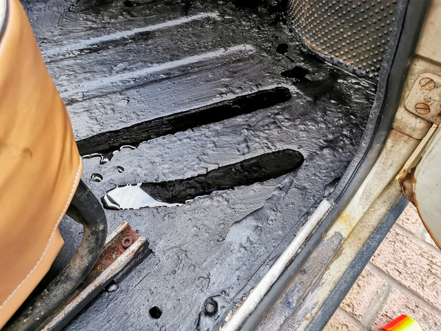

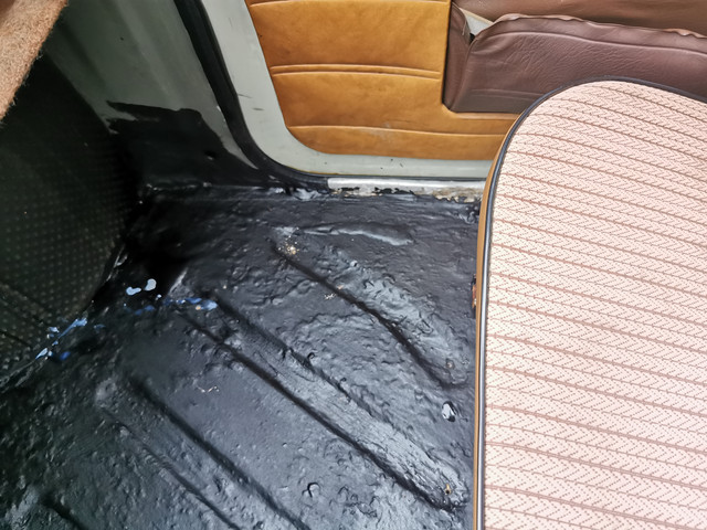

The amount of water in our conservatory tells me that it's been raining pretty heavily on and off most of the day today. So I'd usually expect there to be a lake in the passenger foot well (random thought, does it still count as a well if the floor is actually flat?) in the Trabant.
Well that's an improvement! The dark bit near the wheel tub is just a shadow rather than a puddle. No water! A little of the Cpt. Tolley's I dribbled around the suspect seams on the bulkhead has found it's way through, but the floors (and doors) are bone dry.
That definitely feels like we've made a few steps forward there now.

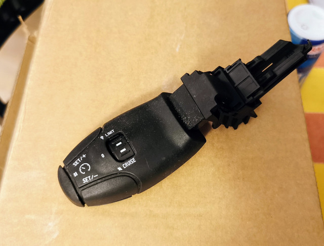

The first part in the puzzle of "what will it take to get cruise working" has now arrived.
Actually attached to a whole COM2000 unit we probably don't need, but it was no more expensive than just getting the stalk. I'll grab a note of the VIN when I next get a chance so we can find out exactly what variants of what systems we actually have fitted, and if we do need additional pedal switches/different throttle pedal assemblies hopefully we can then track down what part numbers I need to start hunting. We'll start with the easy version though - plug in the stalk, code it in and see if it works. Never know, we might be lucky.

There only seems to be one brake switch, and the clutch switch may well be fitted anyway for ECU purposes, so the only thing possibly missing is the throttle pedal.

As said, let me know when you're good next week and we'll have a look at the cruise in Diagbox...
