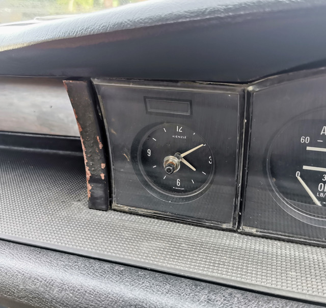

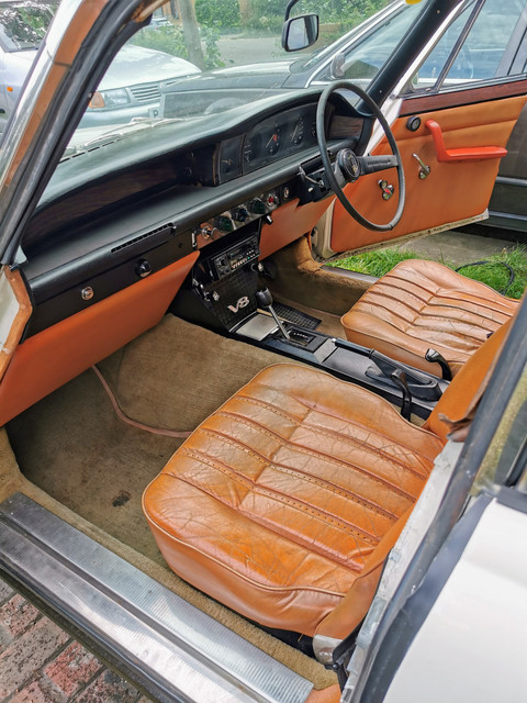

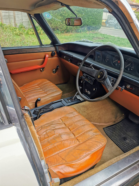

Wonder how much I added to the value today by giving the interior a quick clean? It wasn't really bad in terms of grime, but was really dusty and full of cobwebs, definitely looks better now.
I noticed while I was cleaning down by the radio that I could hear ticking - the clock has randomly decided to come back to life. I can't claim any credit for that whatsoever, it just decided to start working again.
Given that the environment in a car is about the worst case scenario for a mechanical clock to exist in I'm quite surprised it's going again to be honest.

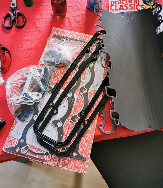

Some parts have arrived.
Head gasket set and fuel pump rebuild kit for the Rover.
Have established that the slightly worrying clacking from the top end at idle isn't actually worrying. The pulse back through the intake from our duff valve was making the metering piston in the right hand carb bounce. Refilling the dashpot has stopped it.
Probably be next week before I get a chance to start pulling things to bits as we've got family on holiday from work this week so have social obligations which are getting in the way of vanishing for hours to take cars to bits!

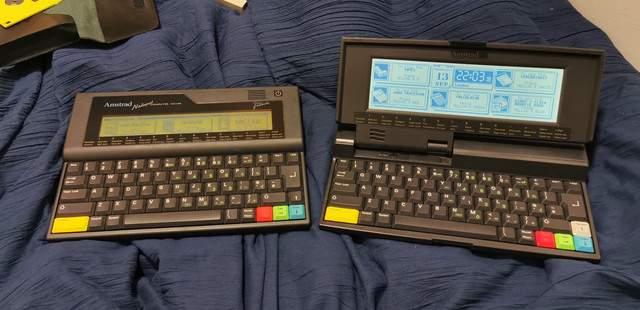

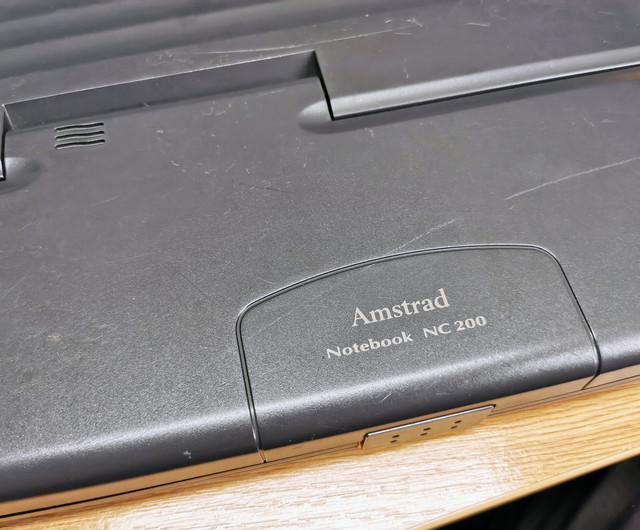

Another box arrived earlier today for the vintage computer collection.
Finally found one of these.
Okay...let's rephrase that. Found one that was at a price I was willing to pay, rather than the £150-200 these seem to regularly be going for on eBay these days. The £50 buy it now this was listed at was rather more my speed. I kind of expected the sale to be cancelled and it to be relisted with that as a starting price rather than buy it now, but no...it actually turned up. Colour me surprised.
Finding this catalogue cutting folded up in the battery compartment was a bonus.
£415 original purchase price, somewhere around £850 today. Not cheap, but a hell of a lot cheaper than a fully fledged laptop if the basic functionality did what you needed.

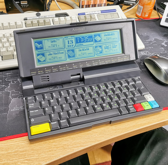

The larger and backlit display of the NC200 definitely gives it a head start over the NC100 in usability terms.
Quite impressive the functionality they managed to get out of a Z80, 128K of memory and a decently useful set of utilities crammed into ROM on these systems.

Never knew of the NC200 Zel! Quite a device and like the old PPC series, it had a decent keyboard, definitely a plus point!
I suppose it was a bit like my favoured device, the Chromebook. Does all I need from a small laptop at a very economical price...

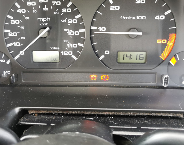

Had planned to get the Caddy valeted and up for sale properly on Monday. We needed to do an IKEA run this afternoon, and it was the obvious choice as it saved me having to put the seats in the Partner down (for all the three seconds it takes).
It rewarded me by halfway there dropping into limp home mode and flashing the glow plug light at me - which is this era of VW's equivalent of a flashing check engine light.
Great! Especially as the code readers I have won't talk to this.
I've seen this symptom twice before on SDI engines...and on both of those occasions the fault was found to be catastrophic failure of the high pressure fuel pump, which also wiped out the rest of the fuel system due to contamination with shrapnel. Very much hoping that's not the case here, or it will be the end of the road for the car most likely as the repair costs would be totally uneconomical.
It may well just get ignored for a week or two as I really want to get dug into the Rover's running issue this month. I also need to properly advertise the P4 more widely as I've not had much interest so far.
