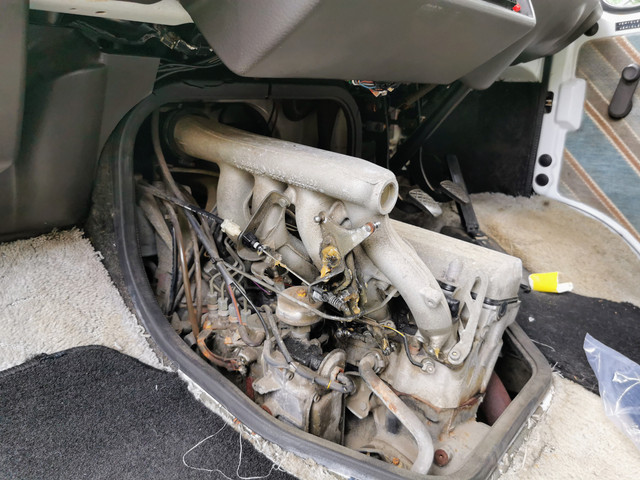

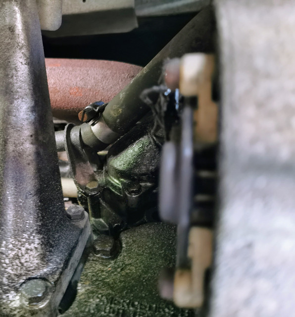

Been a while since I've had to wave any tools at the van.
Starting to get back into a functional state for my part again I figured that starting to tick off a few things on the to do list on it wasn't a bad idea. One of these has been changing the thermostat. Pretty certain it's never fully closed as long as I've had the vehicle.
I've generally found the van bits of this vehicle to be very easy to work on, though the coach built bits have tended to make up for it.
It appears that the thermostat however is the exception that proves the rule and is going to be a bit of a faff to change. Was a bit of a faff to *find* never mind change!
Conventional wisdom places it where the top radiator hose emerges from the head. That's not even visible from under the bonnet, so passenger seat and the engine cover were removed.
The top hose is just about visible buried under the fuel system here, though anything that looks removable that's big enough to contain the thermostat is conspicuously absent.
A bit of head scratching and standing on my head appears to have located it, rather oddly kit seems to be at the engine end of the *bottom* radiator hose.
Odd setup...and not exactly easy to get to. It's sandwiched between the exhaust manifold and offside engine mount, tucked behind the alternator which precludes any thoughts of access from the front.
Near as makes no odds the lowest point in the system too so definitely be a coolant drain as step one... inevitably I'm going to end up with several litres of coolant in the face doing this job though. The coolant is due a change anyway so I don't mind having to drain it...just don't particularly want to wear it.
May end up being a case of "screw this, a garage can do it!" depending on how awkward access ends up really being when I try to get tools onto it.
Need to clean the whole area up too as the timing cover gasket appears to be leaking to no small amount...again.
Will probably blast this area down with degreaser then hit it with the pressure washer first though as I'd like to confirm if this is coming from the timing cover or oil filler neck extension (bolted to the timing chain cover as in the van application the normal filler is inaccessible) before I go blowing £30 on another gasket for the timing cover.

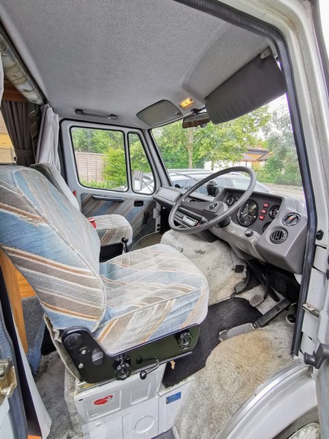

While I already had the vacuum cleaner out I figured I may as well treat the van to the same treatment, especially as the Caddy being on fleet now means it's no longer the main dog carrier so will likely stay fluff free for a bit longer this time.
Really need to get a wet vac in to clean that staining out of the carpet a bit - or more likely get some proper automotive carpet in and just re-lay it given that it's coming unthreaded in a bunch of places and disintegrates a little bit further every time I touch it. Plus pale beige carpet in the cab of a vehicle just isn't smart! It'll never stay looking clean. A neutral mid grey or blue to match the living area would make far more sense.
It's not bugging me any more.
Much better. Though the grubby hand print really is a reminder that I really, really, really need to give the poor thing a proper exterior clean. It's filthy, growing moss everywhere and needs a polish as badly as it needs a wash. That's several day's worth of work though!
The Caddy is being dropped off tomorrow morning to have the shoulder wear on the front tyres investigated. Hopefully it just needs the tracking set by someone who actually knows what they're doing. I figured though that it would be polite to hand it over in a condition where the interior isn't 50% dog hair by volume so gave it a quick clean.

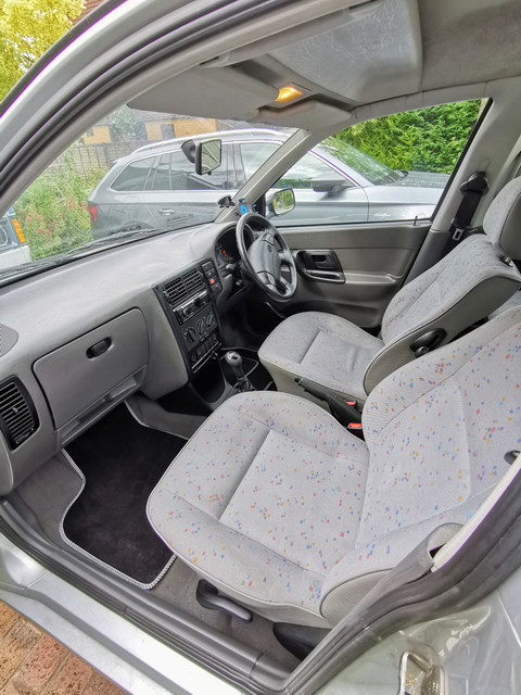

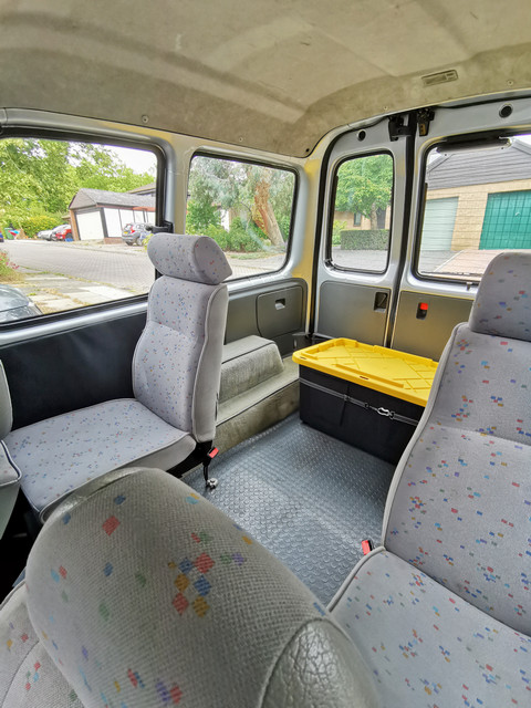

The interior really doesn't scrub up half bad for a 20 year old car.

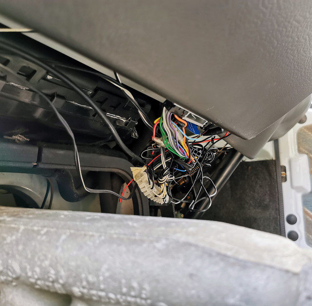

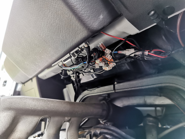

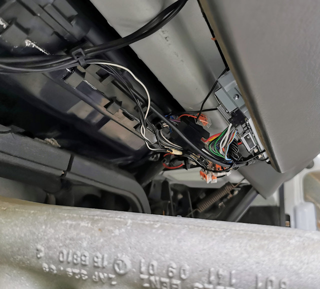

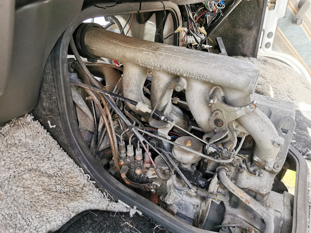

Out in the van today noted that I had lost the nearside front speaker.
From prior experience I knew this was almost certainly going to be down to the spaghetti associated with the stereo getting caught when reinstalling the engine cover as despite a couple of strategically positioned cable ties it still managed to get utterly in the way. Therefore there was roughly a 50% chance of something getting pulled out every time the cover went back in.
The cause of this isn't hard to see. Not helped by the fact that there really isn't much under there to anchor anything to.
This was a classic case of me looking at it and thinking "that will take me half an hour to tidy up" and then proceeding to lose about 80% of an afternoon.
The eventual result of a lot of swearing, dropping things through the floor and poking myself in the ribs on the driver's side seat runners.
If you look even vaguely closely you can see that calling it tidy would be a vast overstatement, but it's a huge amount better than it was and less likely to cause issues down the road.
Most notably that huge chunk of terminal strip has been ousted in favour of a bunch of Wago connectors. I know some people don't like them, but I've never had any problems with them, and nothing is going anywhere here. They're far less likely to vibrate loose than screw terminals, and I definitely didn't have the time to faff about soldering and heat shrinking things together today - as that would be the way to properly do this. If I go back in here one day to reroute the power feed (I'd ideally like the head unit to be powered from the leisure battery so I can run it without worrying about draining the vehicle one when stationary) I will probably go down that road then.
One of the other changes I made was to add a local ground...apparently whoever originally fitted the ISO harness never connected the ground pin! The head unit was grounded entirely through the antenna shield and/or the fitting cage (the dash moulding is actually metal under the vinyl finish). I ran that to a ring terminal I fitted under one of the dash retaining bolts.
The downside of the arrangement is that there is no longer enough slack to allow the head unit to be removed - you need to unplug it from the back first. Though given that is entirely doable with the dash layout in the van and will add about two minutes to the job, if that's the price to pay for getting the wiring out of the way of the engine cover, I'll gladly pay it. That cover comes off far more often than I have the head unit out of the dash.
While I had things in bits anyway I took the opportunity to fix a couple of issues where illumination was concerned. One was that there was no connection to the illumination circuit from the head unit. This meant that it was waaaaaaaaaaay too bright and lit the entire cab up when driving at night, even with the brightness manually turned down. Secondly was that I'd never wired up the illumination when I fitted the compass (read: Put it there to cover the hole in the dash top left when I removed the old alarm volumetric sensor). Thirdly the illumination for the cigarette lighter didn't work.
The first and second points were easy enough to sort. So the head unit now dims to a more sensible level automatically when the lights are turned on, and the compass now glows a night vision friendly deep red colour when the headlights are on.
The camera has of course decided to make it look far brighter than it really is.
Haven't been able to sort the lighting on the cigarette lighter though. Pretty sure it's just a blown bulb but there's no way to get to the back of it to replace it. I can just about touch the housing with the tips of my fingers if I pull the blower switch out - but the illumination bit is on the far side of it so that gains me absolutely nothing. Reckon it's something I would need to literally pull the whole front dash moulding out to get to. That will have to happen one day when I get the scuttle replaced...so it can be replaced with an LED then, until then it will just have to continue bugging my OCD after dark.
It doesn't really *look* like I've done anything here does it?
The only clue from the driver's seat is that the wiring being tidied up means you can no longer see any of it - several wires used to be visible down below the hazard light switch. Not any more.

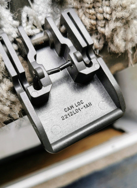

The difference is very apparent when refitting the engine cover though. It just slots into place now rather than requiring ten minutes of fighting to get it to sit right without snagging the wiring.

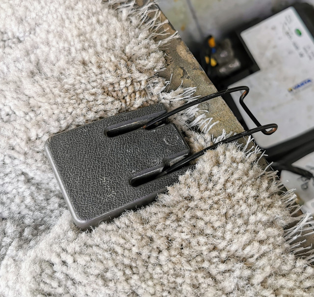

I'm pretty sure getting that trapped in the seal was the cause of the clip on the nearside having a broken handle. Someone tried to force it. If anyone knows of a spare one of these clamps sitting around somewhere, please let me know.
My nearside one is missing most of the handle so requires a screwdriver to lever it open/closed which is less than ideal. I have tried to buy them from a couple of breakers over the last couple of years, but they've apparently deemed it to be too low a value a part to be worth replying to me - well aside from the one guy who wanted £60 plus VAT and postage for one...which seemed a little...steep...to me!

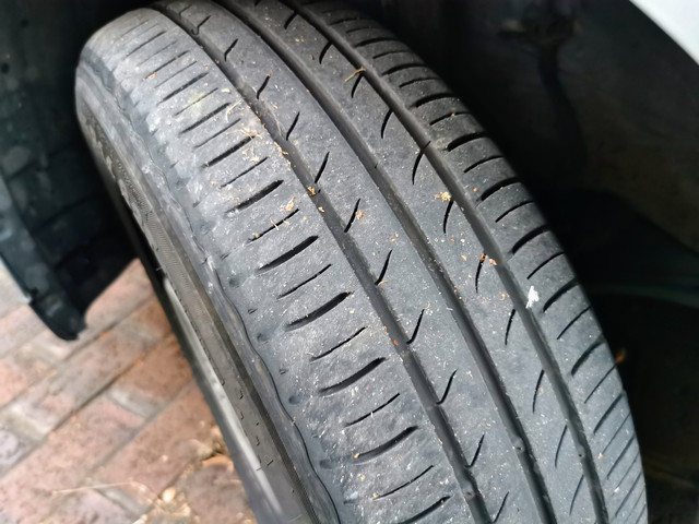

It turned out that the tracking on the Caddy was a long way out. The previous garage had set it pointing off to the left and with a little over 4mm of toe in. The book value is 1mm of toe out.
Suffice to say with it set properly the car...van...whatever you would call this vehicle drives massively better. The fidgety feeling to the handling has gone and it tracks absolutely perfectly straight now.

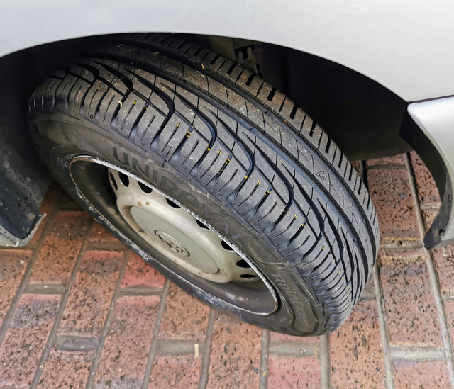

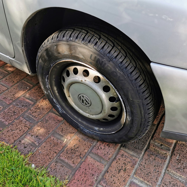

With that sorted it was time to get some decent tyres fitted.
Aside from the shoulder wear, these just weren't great.
They're Kumho Eco-Wings and seem to be a very hard compound. On a dry road they're okay, but on an even vaguely damp road they seem to have about as much grip as industrial grade teflon.
I figured it was time to improve this situation.
Much better.
The Uniroyal Rainexpert range have been my preferred tyre since I started driving 20 years ago, so that's what has gone on. I've just always found them to be good all round tyres for the price.
While they aren't great I figured that someone can probably still get some life out of the tyres that came off so I saved them from getting chucked on the recycling pile.

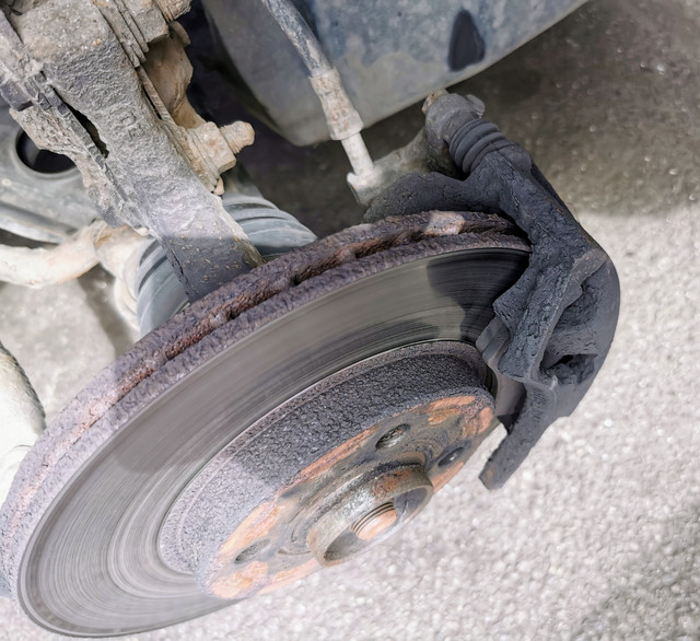

I've never actually had the wheels of this car before so used this as an opportunity to have a quick look around.
Plenty of life left in the brake pads and no horrors to be seen.
Bit surprised to see vented discs on it to be honest. I will probably be pulling these apart for a clean sooner than later as the pads in one of the front calipers do drag just enough to squeak now and then while driving which is really irritating when it does it.

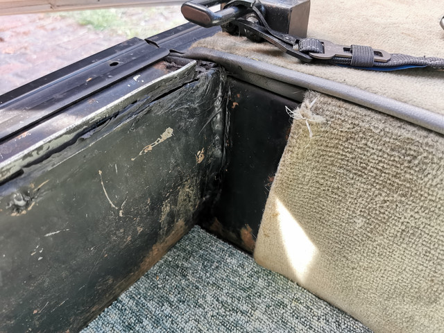

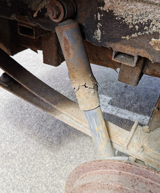

The rear shocks are a little on the crusty side though.
It's only the shield portion rather than the actual hydraulic portion, so not a huge issue really. In fairness they're probably the original ones, so after 20 years and 105K miles they've done their time. I would really like to try fitting some slightly softer shocks on this thing anyway as I think that would massively improve the ride. It's clearly been set up with a view to having a full cargo load in the back as a van - which is way more weight than this is ever going to see. I'd really rather take comfort over a bit of cargo capacity.

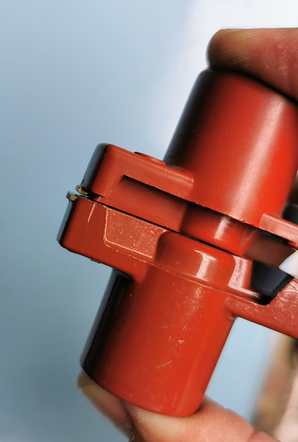

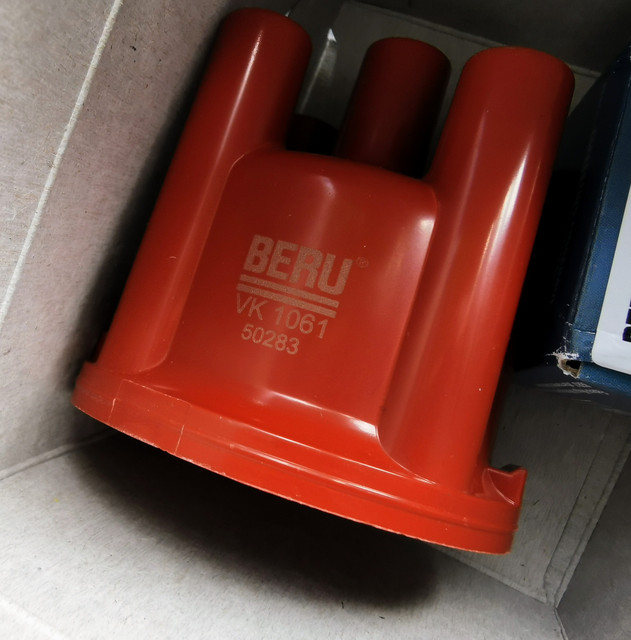

We have made some progress with the Trevi. Aside from just putting the battery on charge as it had gone flat again.
I was working on a bit of a hunch so grabbed some parts. That hunch was that the ignition system arrangement on this car is near enough identical to that used on the 8v injected version of the classic Saab 900. A cap and rotor for those are cheap, so I ordered a pair...worst case I'd throw them in the stores in the back of the garage as they might be handy in the future. Aside from anything else I'd absolutely not write off the possibility of owning another C900 one day in the future.
They turned up today so time to take a look.
The cap is identical to the one on the car as best I can tell. I've gone over it with my digital caliper and every measurement checks out. So that's useful to know for the future.
That wasn't really the issue though, the problem we had been having was tracking down the correct rotor arm - all the supposedly compatible ones seemed to be too short. The duration of the Saab one was a little longer, but I don't think that would likely actually cause us any issues.
What it did for us however was give us a known dimension for the rotor arm that was meant to work with this cap. The working but badly worn Bosch rotor measured as 25.28mm from the tip to the centre of the contact point. The *longest* of the third party ones had been 24.77mm. The new one today measures 25.41mm - which pretty much tied in with what I expected. My gut feeling was that the original one would have been 1" when new... that's pretty close!
Unfortunately I couldn't just use this one as while the top would fit, the bottom half not so much.
It was a useful experiment though in that it pretty conclusively showed us that the rotor arms we had before were indeed too short.
Short of ordering one of every third party equivilant listed for the Bosch 1234 332 215 rotor arm and seeing if we eventually get one which matches up properly I was really struggling to come up with a useful suggestion.
We have ordered two from sellers in Europe which said they were Bosch parts and indeed had a photograph of a Bosch rotor, and were delivered a third party one...with the same dimensional issues as the first one we bought.
Nowhere we can find in the UK lists an actual Bosch one in stock. Until I stumbled across an eBay seller this afternoon who had two NOS ones on the shelf. Needless to say they have both been ordered.
When they arrive...and they better be actually Bosch ones, and the right size...we will hopefully finally have this car running reasonably well again and it can be sent home at long last.
If it still has a miss with the new correct rotor arm fitted I will probably cry as that will basically mean the hall effect module in the distributor is bad. I've done everything I really can to test that though and it *seems* we have a solid continuous pulse from the king lead now, so fingers crossed it's just us trying to effectively fire through a plug gap that's more than twice the book value that's causing us issues. I hope.
No...hope doesn't quite cover it. Pray is more like it!

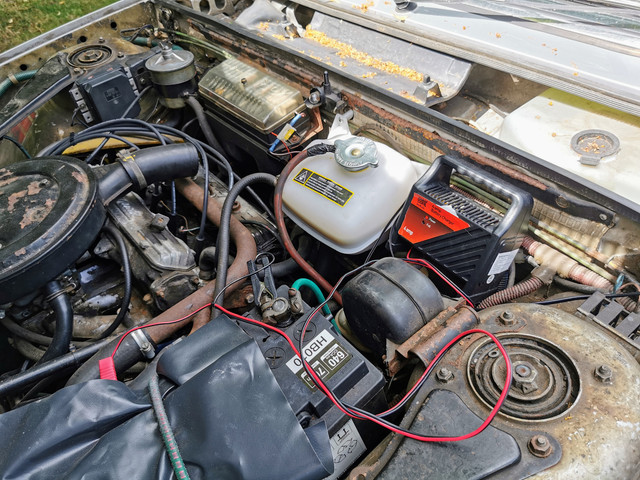

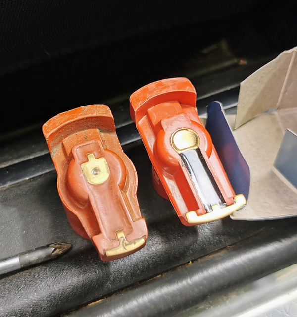

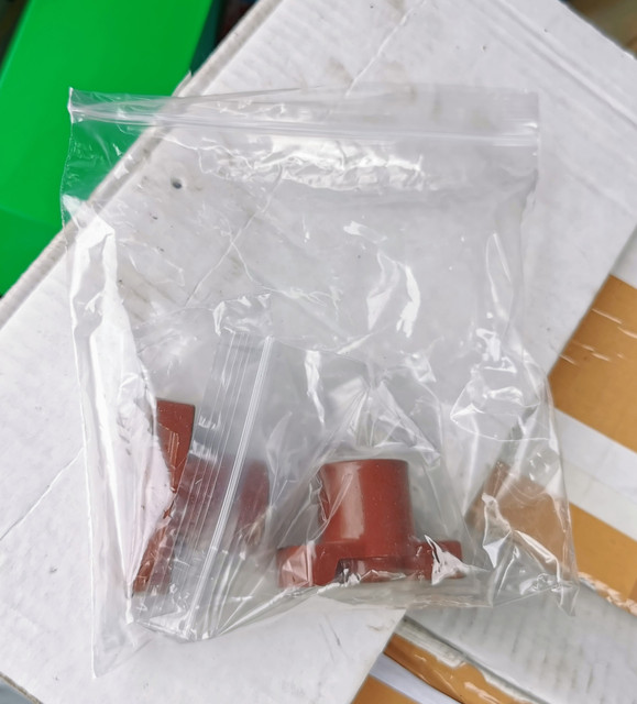

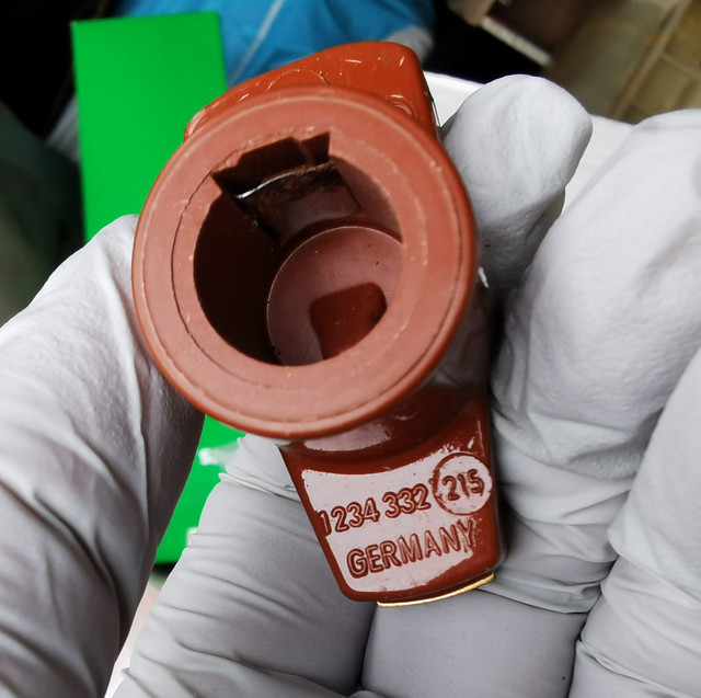

A package arrived this afternoon containing these.
Oh oh...No box, just two rotor arms in plastic bags. We've been here before.

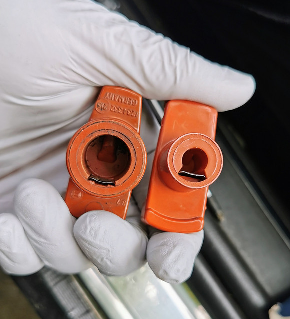

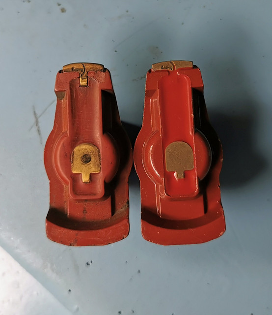

Or have we? Upon closer inspection, no they were in fact genuine Bosch parts.

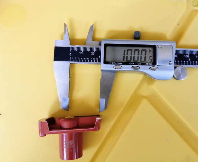

In case people wondered if there really was that much difference between the correct and pattern parts - here's the difference. The centre post contact point is lined up between these, the pattern parts are really that much shorter.
So you're adding the best part of a full millimetre to the plug gap effectively by using that.
The old one has definitely done its time!
Of course by the time I got a new one fitted to the car it was rush hour so I wasn't able to go for a proper test run. I did bumble around the block a bunch of times though more than long enough to get the car properly warmed up.
Usually this was when the issues became most apparent, with an erratic miss at idle. It now seems a good deal smoother.
That *seems* a lot better. It's not perfect, still the odd stumble here and there, but it's entirely passable. Especially as I'm pretty certain that the carb needs setting up properly and/or at least being treated to a proper service kit.
The throttle response is definitely miles better.
I will need to get out tomorrow afternoon so I can give the car a proper test run. I'm absolutely NOT saying it's fixed now. I've proclaimed the ignition issues sorted twice now, then about half an hour later ended up having on both occasions to push the cursed thing because it had cut out on me and refused to restart because the spark had disappeared again.
IF it behaves itself tomorrow when I take it out for a proper test run, it'll get a (careful) wash to get rid of the large amount of tree that is now adorning it and then be returned to its owner.
With a good spare rotor in the boot too so we won't need to play this game for a good number of years hopefully.

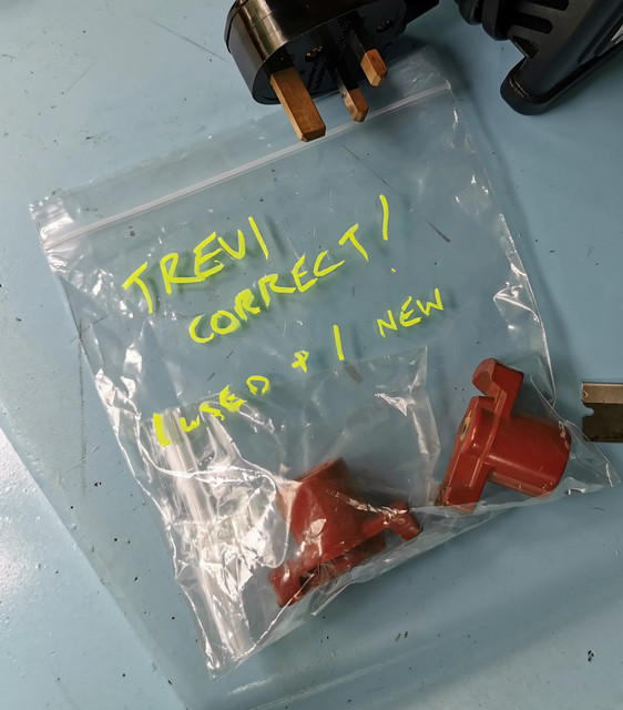

In case you wondered how many rotor arms had been involved - there were no less than five incorrect but supposedly compatible ones picked up before we finally managed to find an actual NOS example of the right part.
Hopefully we can get a line drawn under this episode shortly.

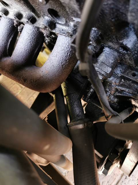

[] Investigate front end exhaust leak.

So it seems to be running reasonably well now. Do I trust it further than I can throw it? Not in the slightest! I'm pretty convinced by now that this car just doesn't like me and wants to see me suffer.
Will try to get it cleaned up tomorrow to remove all the tree gunk, give it a repeat of today's test and if all still seems to be good will arrange to drop it back with its owner. Before it has the opportunity to throw anything else at me!
Recommendations to the owner will be:
[] Carburettor needs serviced & Solenoids replaced.
[] Carb setup needs investigation - suspect jetting may be incorrect.
[] Replace or recore the radiator.
[] Check ignition timing.

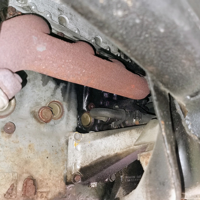

The Caddy has been working very well as dog transport, only real gripe is that the floor in the back is a very hard plasticy material and they slither around a bit. Star in particular doesn't like that so I've been meaning to put something in which will provide a little more friction.

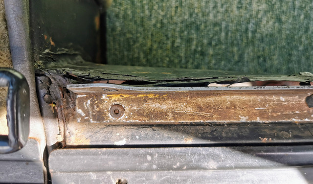

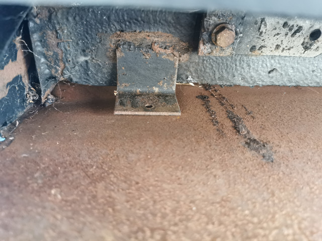

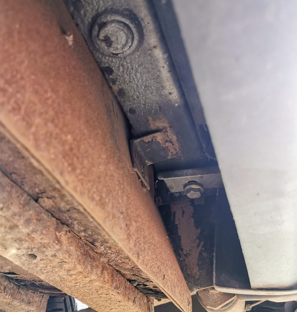

I had wanted to have a look at the area around where the ramp used to be. I know if you open the driver's window half way it tends to pull a bunch of exhaust fumes into the cab so there must be a fair sized gap somewhere.
Well that won't be helping.
This is the point at which I started looking more closely at the workmanship of the ramp delete...To call it shonky would be something of an understatement.
For a start, this Sikaflex appears to be structural.
Originally that rear section would have been part of a hinged ramp which was attached to a big hinge on the floor. That took up a bunch of space and would basically delete 70% of your rear visibility (and probably weighed about 100kg), so not surprised it was removed.
It would be nice if they had done a better job of it though!
Apart from the Sikaflex, the only thing that seems to be actually connecting the centre section of the bumper, lower door latches etc to the rest of the vehicle are these *quality* welds.
They hadn't even bothered to weld the other side!
Yeeeaaahh... quality workmanship.
The inner and outer panels there are "spot welded" together...in so far as someone has thrown some weld vaguely at the panel...however there's about a 1/8" gap between them and I don't think a single one has actually connected the two bits together.
I think the plan will be to pull the outer section off entirely, remove the currently structural Sikaflex, at which point I think the inner ramp delete panel will basically fall out.
I will then clean up and rust proof everything involved (there's no paint on the outside of the ramp delete bits at all). Then I think I will permanently attach the outer section to the inner off the car. Then I'll offer the whole assembly up, and bolt the whole lot into place using some hugely overkill 90 degree brackets and high tensile bolts and big washers. Then we'll seal up the joins with fresh Sikaflex. That should do a far better job of sealing things up and sort the wobbly bumper issue.
I did wonder about reinstating the ability to drop that section down as it would be nice for the dogs, but the latches and everything are long gone plus the hinges so it would be quite a bit of work, probably more trouble than it's worth.
The whole underside of the dropped floor is quite crispy and really wants going over with a wire brush, some rust converter and some underbody protection. It'll need some repair in that area at some point, especially to the floorpan itself - but the frame is about 1/8" thick box section and it's all just flat panels and right angles so wouldn't be difficult to rebuild if necessary. The actual VW metalwork under there is in good shape, especially by the standards of a 20 year van.
