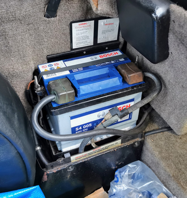

The first few web searches, including the lookup system on Tanya's website, suggested that a 096 battery is correct for the XJ-S, so is what I picked up.
Was no point comparing to the one in the car as I knew it was well under sized - hence my "creative" solution to getting enough travel in the tie down frame to actually make it fit.
Turns out they're speaking nonsense. No way will a 096 fit in here, it's the best part of an inch wider than the battery tray. D'oh!
Cue a bit of head scratching...before I nicked the battery I stuck in the BX about 8 months ago. That's a 027 which while still a little smaller than what I imagine Jag intended (which I'm thinking now is probably a 075), is a far better fit. It sits snugly in the tray and the tie down fits properly without needing to faff about with spacers. Meant I could actually get the lid fitted properly for the first time since I've had the car.
The battery tray in the BX is huge on account of the diesel variants so the 096 dropped in there just fine and looks like it was meant to be there - even if it's grossly overrated for a humble 1.4 petrol, but we're not going to complain. Especially with the car not being used regularly.
I put it on charge overnight on account of the BX sitting unused a lot, but even beforehand it span the engine over far faster than the one previously in the car ever did. Also while out for a run the voltmeter stayed pretty much smack in the middle the whole time without sagging anywhere near as much at idle...so I think that was half our problem. Dying battery took out a weak alternator regulator? Or dying alternator killed the battery? We will probably never know.
The battery that csme out definitely has a shorted cell. Sitting rock steady on 10.8V off charge but using the calibrated battery testing spanner is still sourcing a decent chunk of current - which suggests it can also still sink a decent charge rate, which given that with a lot of kit running I can easily account for about 80% of our old 55A alternator's output in vehicle systems alone isn't going to help anything.

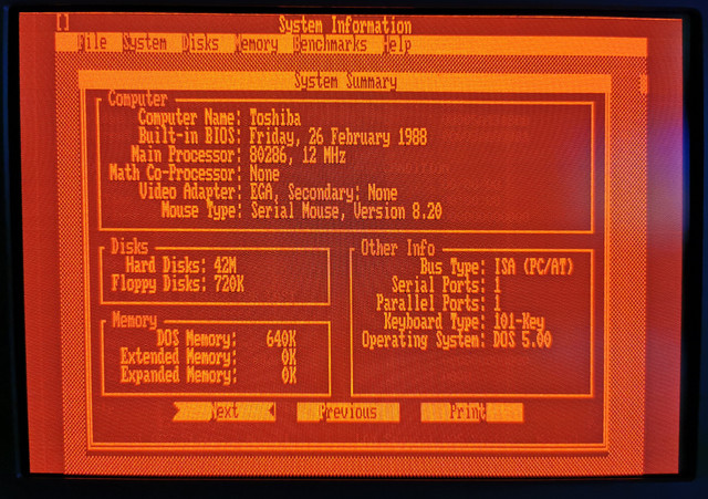

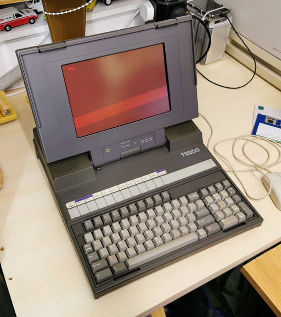

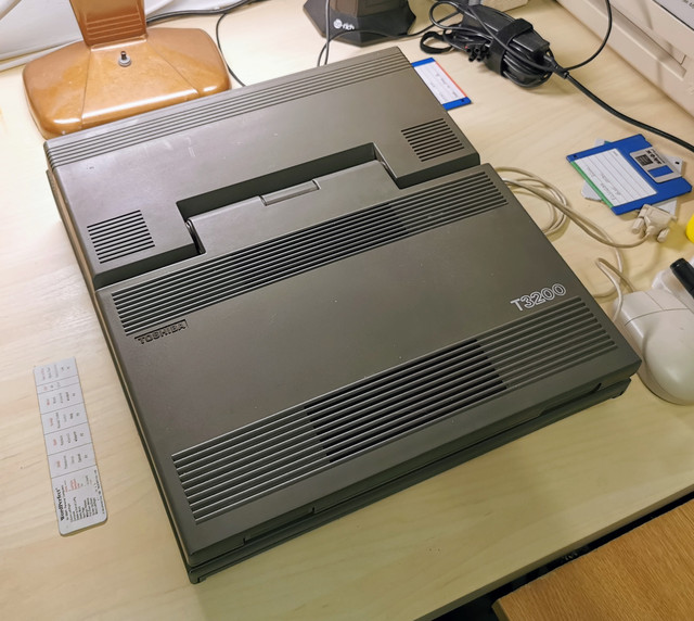

For those interested in such things, this is what I was picking up.
In 1987 this was pretty much the most powerful portable machine you could buy - with pretty much everything you would expect of a conventional desktop PC - including a full size ISA expansion slot. These "portable desktop" machines were something that Toshiba were very good at making, and were quite worthy of note in an era where desktops tended to do desktop things and portables were generally vastly more limited and did very different jobs. The desktop replacement concept became quite commonplace about 15 years later, but in the late 80s/early 90s was quite a novel idea.
Specs seem positively laughable by today's standards, but this was a powerful machine when it was launched.

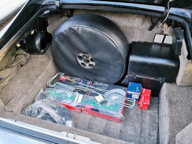

I gave the interior and windscreen a quick clean and loaded up the spares I had into the boot.
I had originally planned to give the whole car a wash and quick wax - but realised that given the state of the roads and that it had a 400+ mile motorway run coming up that it would be completely pointless.
Definitely a car I will miss. This is definitely one I'm selling because it's the sensible decision than because I want to.
While I would happily have made the trip myself, it's always a bit nerve wracking sending someone.off who's not familiar with the car on a journey that long - especially when it's not had a huge amount of use recently. However the worry was unnecessary as she made it to her new home in Aberdeenshire without incident - well aside from the interior light falling out of the headlining again. Economy on that run was 20.8mpg, which seems perfectly decent to me for a 1700kg 5.3 litre V12 car from the mid 80s.

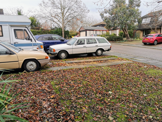

Having a gap out here just looks wrong!
No...it looks right. It's a step towards actually getting everything to fit on the driveway.
Short lived though given there's another (broken) project on the way soon...so much for thinning out the herd!

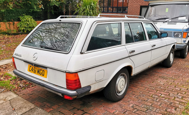

Okay...Mercedes is officially for sale.

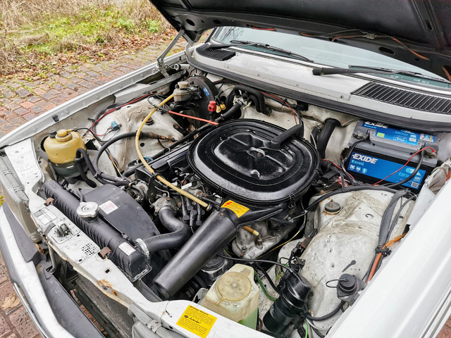

Photos as of a few days ago. Not prettied up, in her working clothes as she's still being used as the daily.
Offside rear arch is probably the most outwardly scruffy bit of bodywork. A repair panel for this is included with the car.

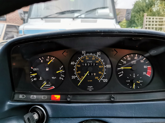

Current mileage, though this will go up a bit as the car is in regular use.
If you've followed this thread over the last few months you'll know the car.
I bought this car back in the summer with the intention of it being a practical daily which I could carry out a gradual rolling bit of tidying up on - not going to say restoration as that was never really the goal. A tidy working car was.
Sadly it became apparent a short time later that due to historic chronic neglect the top end of the engine had sustained a lot of damage due to oil contamination and/or starvation. The damage to the camshaft is probably the worst I've ever seen on a running engine. Aside from sounding like an 80s Fiesta needing a service she still ran just fine though!
As a spare head was supplied with the car I went ahead and fitted that.
My intention had been to drop the sump so I could inspect the crankshaft and potentially drop in a new set of bearing shells - however I quickly discovered that doing that involves you going about 80% of the way through pulling the engine as there's a huge chassis cross member in the way. So we were taking a gamble.
While the engine is a lot happier now (it's been a little over a thousand miles since the head swap), it's still a bit rattly at high revs and the oil pressure at hot idle is mediocre - though not in itself low enough to be a danger sign apparently.
I'm not convinced that this engine is going to be reliable long term without a bottom end rebuild...and that's something I just am not interested in getting involved in. Nor am I messing about swapping engines. If I could find one for a couple of hundred quid, maybe. Sadly the days of them being cheaply available appear to be in the past, and I'd need to do the work in the middle of my front lawn. My poor neighbors put up with enough as it is without that nonsense! I could be totally wrong and it will still be going strong, rattling away in another 50K miles...but I just don't trust it to not eject the number three con rod through the side of the block without warning halfway down the A5 in rush hour. Milton Keynes being such an aggressively unfriendly place to break down in does fuel that paranoia somewhat.
The bodywork is best described as scruffy but generally solid. Pretty much every panel has some form of dent, rust and or evidence of a prior respray done quickly. However it's not a total rot box and is perfectly respectable from ten paces. At least none of the trim is actually missing as that stuff is expensive to replace these days.
Interior is similarly a bit shabby. Worst parts are the driver's seat where the base has partly collapsed and the bit of trim above the sun visors which has peeled away from the backing at the edges. Aside from oddly the carpet from the offside rear footwell everything is there though.
