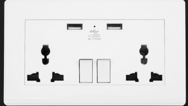

I will be using this style of socket throughout Pint Pot. The reasoning being that I should have a socket for just about all types of items like shavers, chargers and oddball power adapters as well as standard 13A - plus usb points in every socket.

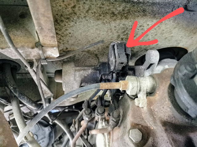

While crawling around I discovered that the reversing light switch (which doesn't work) is actually external to the gearbox, attached to the back of the gearchange linkage.
I'll need to have a poke around at that and see if it can be adjusted/repaired or if it needs replacing. Could even just be old grease that's dried up over time.

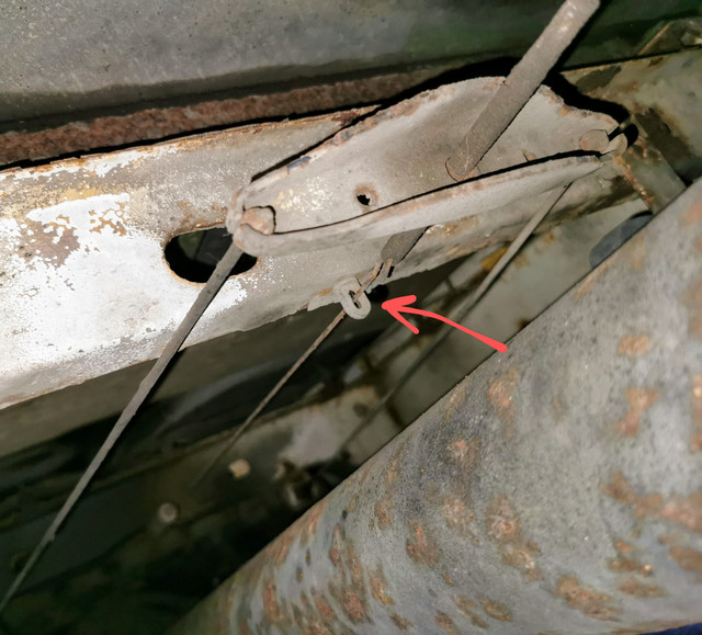

While crawling around I had a hunt for something which has been bugging the heck out of me since the day I bought the van - an extremely annoying rattly buzz (or buzzy rattle) which appears whenever the engine gets anywhere towards the top end of the rev band. Which equates to any road speed above about 55mph.
I was pretty confident this was something to do with the handbrake cable. I originally thought it was coming from here where the cable passes through a chassis member.
Turned out that wasn't the culprit as putting a rubber sheath over it made precisely zero difference. A little more digging tracked it down.
It's the cable return spring that's rattling against the little eye it passes through.
I'll need to see if I can find a parts diagram to see if there should be something else there - it feels like there should have been a rubber boot or something to prevent this being an issue - as it seems like it will always have done this. I know mechanical refinement was never really the top of the priority list for a vehicle like this, but a noise as maddening as this surely never would have been considered normal.
I note that there are two holes in the cable yoke with nothing on them, I do wonder if there should be a spring or something hooked on there.

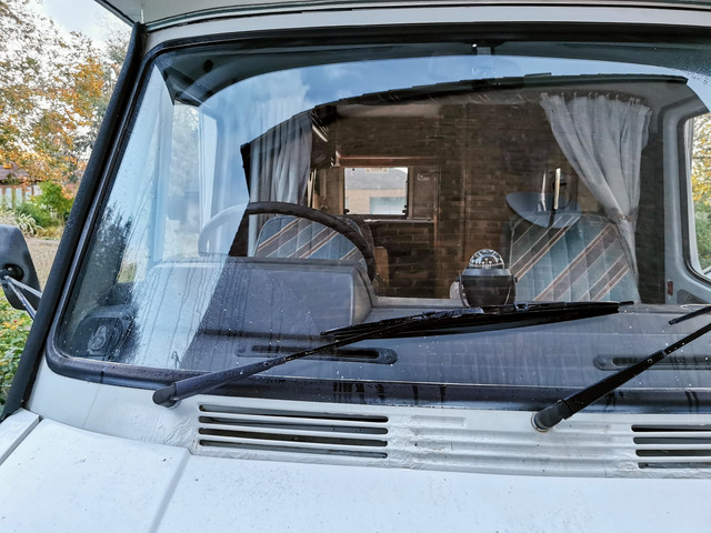

Last job before I downed tools was tweaking the offside wiper arm a little as I noted last time I was out in the rain that it was fouling the side of the windscreen.
Dropped it down by a couple of splines on the spindle and hopefully that will do it. There's no real way to get the wipers looking both tidy and have decent coverage. Not sure if this just something unique to the right hand drive vans or if they're all like that.

Something looks wrong to me. The bracket with the oval hole looks like it should be the anchor point for a shorter spring. Maybe a wrong component has been fitted somewhere?
- Joined: 21 Dec 2015, 13:46
- x 1758
Re: Zel's Fleet Blog - BX, Jag XJ-S, Sinclair C5, Mercedes 208D & 230TE, AC Model 70.
Agree. That yoke should be supported somehow, so it doesn't waggle on the long cables/rods.
How about a couple of grommeted brackets for the outer rods, attached to the chassis cross-member?
Not dissimilar to Citroen height control rod...

My gut feeling is that something is missing there.
I don't think any of the fitted components are wrong, the return spring is a pretty specific one, not the sort of thing you would just find floating around in a box. Though I agree...it looks wrong. I really need to chase down a proper parts diagram and see what should be there.
Easy fix to try for now is just sticking a bit of hose around the cable and seeing if the additional weight is enough to shift the resonance point sufficiently that it doesn't make a nuisance of itself.
If it wasn't the handbrake cable I'd probably never have even known about it - the noise however is transmitted straight up the cable into the floor of the cab, so is really irritating.
