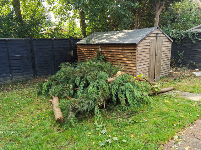

Well today has been spent generating this mess.
Last couple of trees that need to come down are going to require access from the other side of the fence to remove the bulk of the weight before we can bring them down.

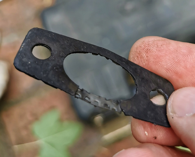

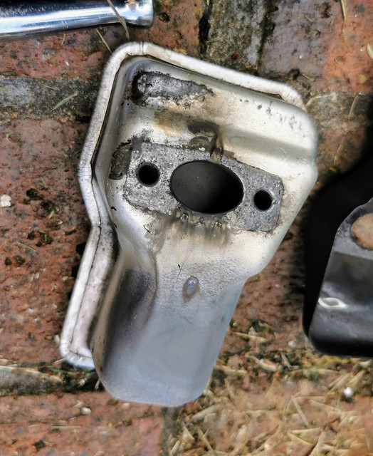

Have got a mechanical job out of it though, the exhaust decided to fall off the chain saw. Gaskets have had it, so possible it's been leaking for quite a while.
The marks on the back of the silencer and heat shield certainly suggest that theory is correct.
That silencer seems to have a lot more to it than I'd expect, it's really surprisingly heavy.
New gaskets and some locknuts on the studs this time so it can't unbolt itself again and we should be good to go. Doesn't look like the mating surfaces are damaged at least.
Now however I am utterly broken, and will probably be feeling that way for most of the next week!

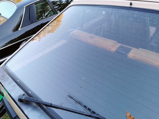

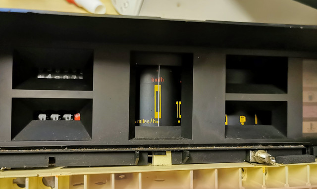

Really quick additional job on the instrument panel done today while I'm waiting for the transparency film to turn up.
Sanded back and repainted the speedometer pointer white.
Looks a good deal brighter back in the panel than it used to.
Another item on the "missing" list has been ticked off now too thanks to our Jim picking some hardware up for me while on his travels.
Yep, she now has a parcel shelf again. Yes it's black rather than brown/beige but being a neutral colour it's less obtrusive than something like blue would have been. I'll take the wrong colour over missing anyhow.
At least it hides all the junk in the boot now.
Small details yes. Though I still see it as important as the less things which are missing, the more likely my enthusiasm to keep pushing forward on getting the car sorted is to continue.
Has it helped take the rate the thing hurls itself open at? Nope...it still wants to smash my teeth out!

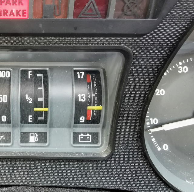

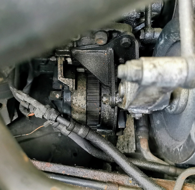

A while back I had intermittent issues with the alternator on the Jag not charging... though it has been behaving for a while and I made the mistake of mentioning that within earshot of the car the other day.
It heard me apparently and rewarded me with this on the voltmeter today.
*Sigh*
I'll need to see if I can get the brush pack out with the alternator in situ (as I *really* don't want to have to mess about with the belt tensioners again). It doesn't actually look too hard to get at by the standards I'm used to on this car.
I'm sure I'll end up swearing a lot at that pair of power steering lines a lot though...
From the symptoms I'm hoping it just needs a brush pack as I really could do without spending on a new alternator on this right now...
*Sigh*

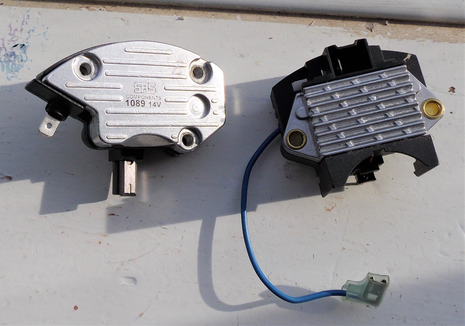

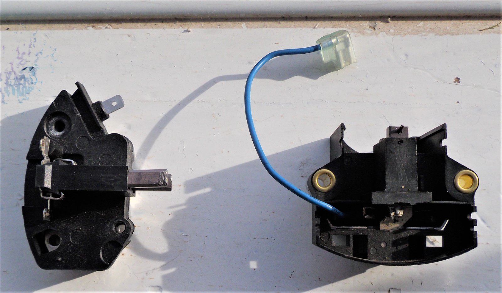

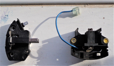

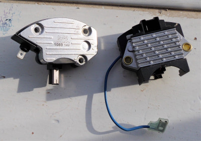

I've got these two new brush packs sitting on my shelf, if one will fit your alternator you can have it free-gratis.

I've just had one of the works' Mercs back from a specialist for recommissioning, service and MOT. Rather annoyingly they missed the duff alternator - I measured 25v AC across the battery terminals with the engine running. That'll be a fubar'd diode in the rectifier then

Need to get the old one out first to find out what type it is... apparently there are no less than four options for the alternator at this age... assuming it's not been replaced at some point as there are others which fit straight in and have higher output.
No nameplate on it I can see anywhere (probably on the underside which you can't see as there's a subframe in the way) which doesn't help!
