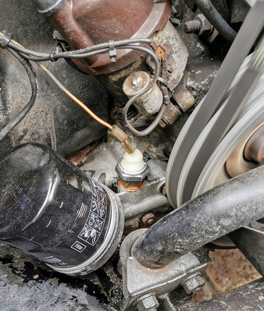

New oil pressure switch has been fitted to TPA.
Sadly this hasn't fixed the oil leak (well, it's helped) as precisely as I expected it seems to be coming from the crankshaft oil seal. It's not a major leak though so honestly I'm not worrying too much about it.

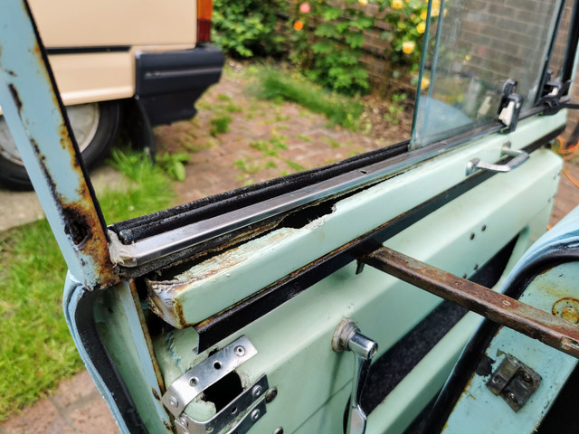

We did have the first failure of the year though - albeit a minor one. This happened when I pulled the door closed.
I think the solution to this is basically going to be to pull it out and smear a shedload of Sikaflex into the join between the inner and outer door skins where they overlap. This issue dates back to the stinking great hole in the inner door skin above the latch.
That panel takes quite a beating as it's the only thing the door pull is attached to and this door takes quite a slam to close.
Not going to complain really, as failures go this is a minor inconvenience. Held me up all of 30 seconds while I coerced the two bits of door back into their respective places.
