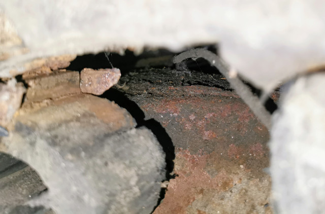

I had kind of hoped that I would be clearly able to see where the LHM leak was coming from once the wheel was off the BX, however it obviously wasn't going to be that easy. For a start, the wheel required the six foot breaker bar to shift the wheel bolts. That's always a fun start to a job.
I reckon this line has to be the culprit.
Though I can't actually SEE the leak - there's a finely atomised mist of LHM being blasted at the floor directly above here when the brake pedal is pressed - I'm not daft enough to stick my fingers in there when the system is pressurised to see if I can feel it. Fact is we know it's on the brake circuit and it definitely appears that the leak is on the axle line rather than the body side, so that tells me which line needs replacing. Access will be an absolute pig I can see.

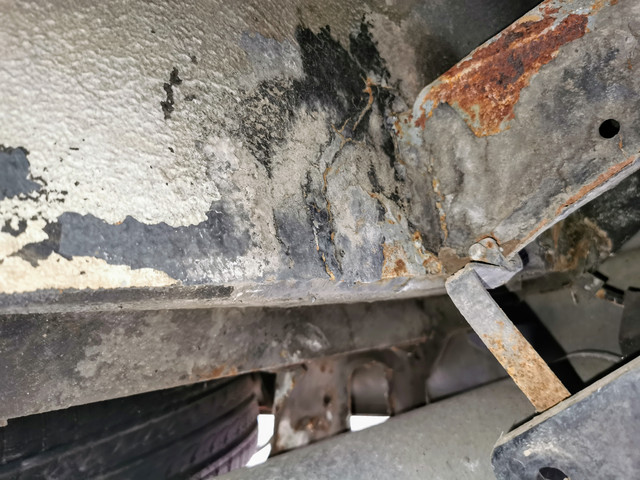

On the plus side, the rear of the sill looks to be in decent shape, and while there have clearly been repairs made to the rear of the boot floor I don't see anything which sends me running screaming.
No horrible crunching noises while I was jacking the car either which is always a plus!

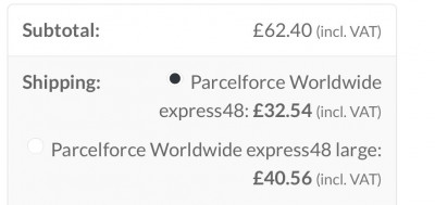

Nice. Had hoped they'd be available pre-made, just hadn't got as far as looking yet.
Will probably buy both sides as if one has failed most likely the companion on the opposite side won't be in the first flush of youth either.
Edit: Wait...they want HOW much for shipping?!?

Those are international postal prices - surely don't apply to orders within the UK??

That's kinda what I thought, but it's what the system spits out when entering our postcode. Might need to send an email.white exec wrote: 17 Mar 2021, 18:24 Those are international postal prices - surely don't apply to orders within the UK??
