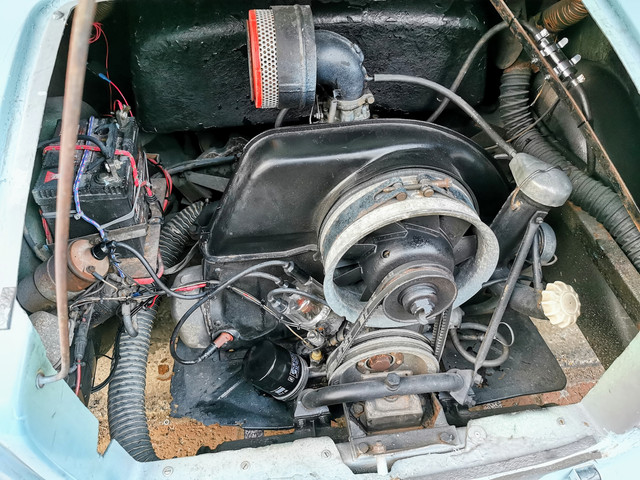

Today's unexciting update...TPA has had an engine oil & filter change.
I had another shot at a Slow-Mo video of the distributor working in daylight. Given we've got a clear cap on at the moment it seemed something worthy of playing around with the slow motion mode on my camera.
Got another angle where you can see the points opening and closing.
Quite interesting to actually see things working. Can see from the lack of sparking there that the replacement capacitor setup I put in place.
If we're not up and about when you drop stuff off Jim, should be fine to just leave things behind the gate by the van (you'll know you're in the right place by the huge mountain of scrap waiting for me to be able to take to the tip).

That slow mo is great Zel!! It really lets you see what's what. We need more, and more!!!

Excellent video through the transparent dist.cap, Zel.
Are those transparent caps still being made, and are they meant just for troubleshooting, or permanent use?
We had one for the '35 Rover Ten, but it wasn't in good enough condition to be left on the car.

They seem to be what about half the suppliers of parts for the Steyr-Puch engined stock. Several have both clear and black ones listed under the same part number. I *should* have a black one on the way which I think will look less out of place in there - if the package ever escapes customs, where it's been hung up for nearly a month now.white exec wrote: 07 Mar 2021, 08:38 Excellent video through the transparent dist.cap, Zel.

Gosh; I had thought they were just an old 'diagnostic' relic.
A V8 one at night would make an interesting sight — a V12 even more so!

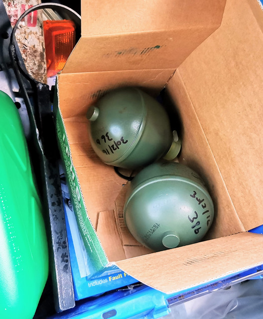

Hey look what was dropped off for the BX today...
These are actually rear spheres for a non-hydractive Xantia rather than BX ones, but they're pretty close spec wise. Will be absolutely fine for the purposes of getting the car into a driveable state. Once she's got an MOT and is driving reliably I'll look at getting the exact correct ones.
So tomorrow (if time permits) the battle to change the rear spheres will begin. I've been regularly dousing them in PlusGas since the car arrived and I've been loaned the right tool for the job but I'm still expecting this to be a royal battle.

Excellent
Delighted you're happy with them Zel
It was a real treat to see you at a distance and have a good look at the BX
When you come to remove the old ones remember percussion is your friend
And make sure the car is well supported at the rear to avoid the possibility of the suspension suddenly collapsing from upon high when the spheres finally come loose..
Remember to initially 'crack' them with full pressure in the system and the suspension on high...

On the two occasions where I had to remove seriously seized rear suspension spheres I found that knocking a 'divot' into the seam first gave the chisel a good purchase point when undoing the spheres. Then, every six months or so, loosening off the spheres by a 1/4 to 1/2 turn (and then doing them back up hand tight) prevented them from seizing again, making replacement a simple process. When I was at a dealership an elderly mechanic (who had a lot of personal Citroen experience) told me that this is what he did, making maintenance an easy job.
