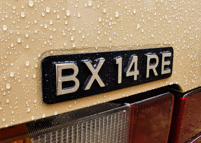

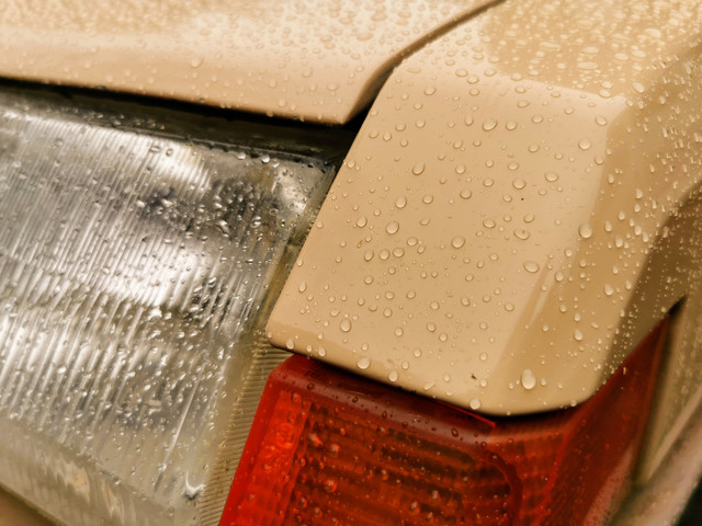

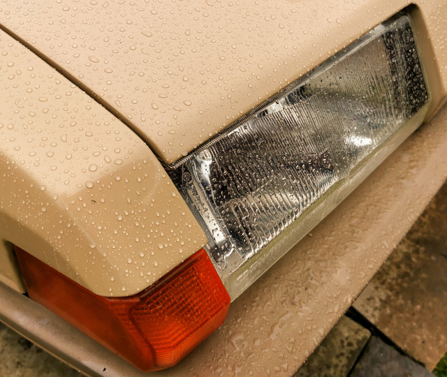

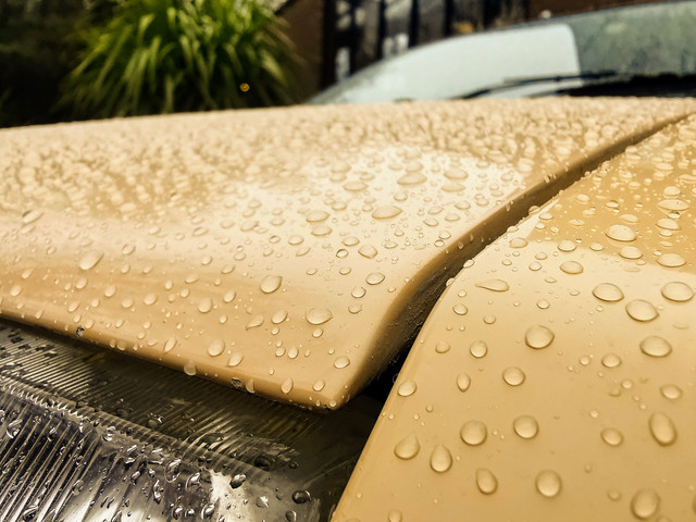

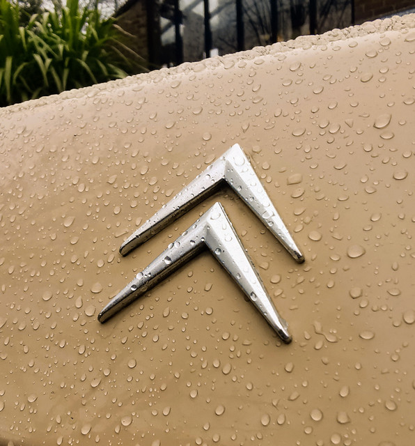

Nevertheless, it did give me an opportunity to get some gratuitous water beading photos on the freshly waxed paintwork...Imagine it's been a few years since this happened!
Feels like having the carb largely co-operating is quite a big step towards the car being actually drivable now. Rear spheres will be the next big step.

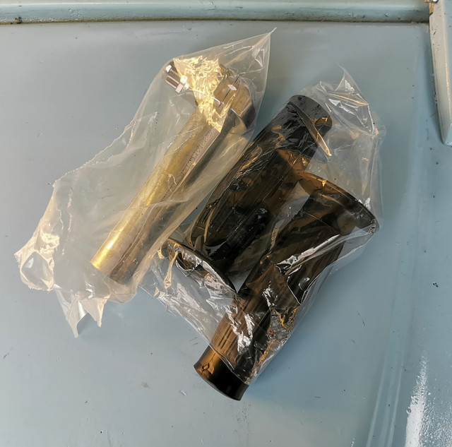

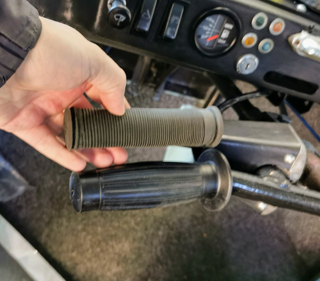

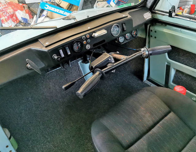

Package arrived this morning for TPA.
Installation was pretty straightforward...Though I still had to fabricate a cable end. I think I just need to go to Speedy Cables or similar and just order a proper cable. The issue seems to be that (unsurprisingly) the cable has a standard motorcycle type barrel connector at the handlebar end...but finding off the shelf motorbike throttle cables more than a couple of metres long is tricky - and this needs to be a touch over five metres long because of the routing. As it is having trimmed away the frayed bit of cable I'm now down to literally millimetres to spare, and it's a bit frilly at the handlebar end so will likely fail again in the not too distant future.
Nevertheless, it does mean that I've now got matching grips on the handlebars which looks SO much better.
The throttle action is also way better...It always felt very much as though it wasn't attached to anything before, so you were never quite sure how much throttle you were applying - and I'm not 100% certain that I was ever actually getting full throttle as the old twist grip was distorted and binding up at several points in its travel. New one is all metal so should hopefully fare better.
New grips are a good deal chunkier than the old ones which I think will be a good thing.
Will have to wait for a test drive to be certain, but just sitting in the garage the bars felt a lot more comfortable to hold.

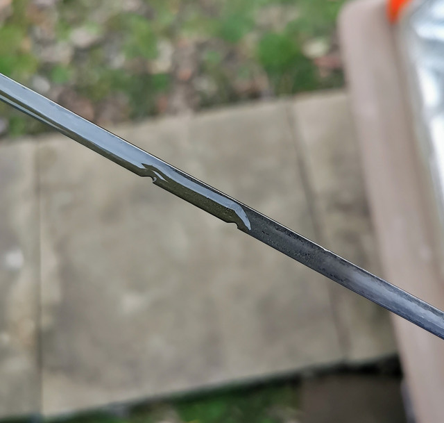

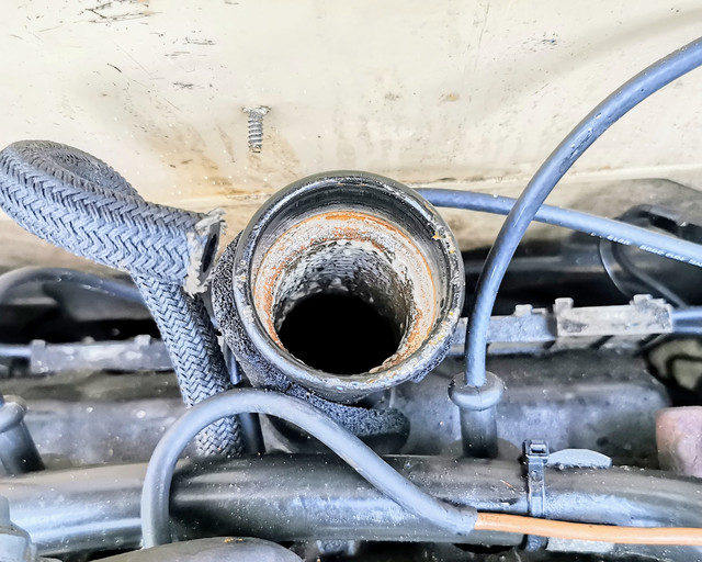

Nothing much today, mainly just got an oil & filter change done on the BX. No more horrible rusty oil filter.
That wasn't the worst filter to get off I've dealt with, but it wasn't far off. I had to get the chain wrench and breaker bar involved.
Pulled out just over seven litres of oil, just under six went back in.
The discoloration on the dipstick shows where the level has been sitting for quite a while, a good inch above max.
Getting the oil filler cap off was a task in itself - get the impression it's not been off in a while, and it's just a friction fit.
Being the coolest point of the engine doesn't surprise me we've got quite a bit of condensation here.
If it's still looking like that after an hour's blat up the A5 or M1 then I'll look more closely, but there doesn't seem to be any pressurisation of the coolant, it looks spotlessly clean and she idles smoothly so reckon it is just old fashioned condensation. Remember this car was last in MOT in 2011...so she's not had a proper run in forever.

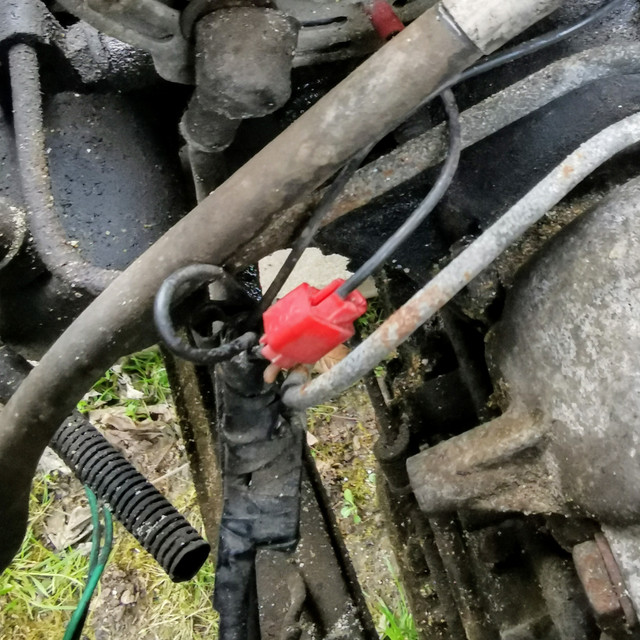

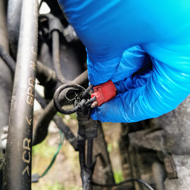

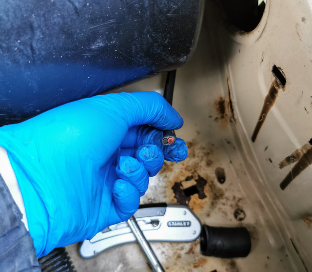

I did spot a couple of electrical things needing immediate attention while I was waiting for the oil to drain. Firstly this Scotchlok on one of the alternator lines.
Note the stub of brown wire...which sits exactly as close to this hydraulic line as it looks like.
Yeah...that's getting soldered and covered with heatshrink ASAP.
I originally thought this was a drain line for some reason...
It appears to vanish down through the bulkhead grommet towards the fuse box. I'll investigate further tomorrow... that's going to be getting removed at the first opportunity.
I can also confirm now that being in the humble RE trim level it doesn't look like this car has an oil level sensor (not sure if the wiring is there, hence if it could be retrofitted easily), unlike the higher trim levels.

Going by the runs of something brown from the holes on the metalwork in this picture, it suggests the car was rustproofed at some point... May account for why it's still with us in good condition
