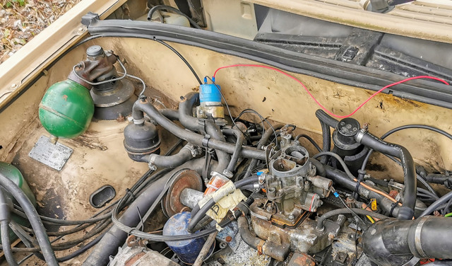

A good few BX14 petrol engines listed on wikipedia. One has a 'dual chamber' carb, and 71bhp...
There are some early BX documents (and I think a parts list) in our Resources library/mechanic's booklets.

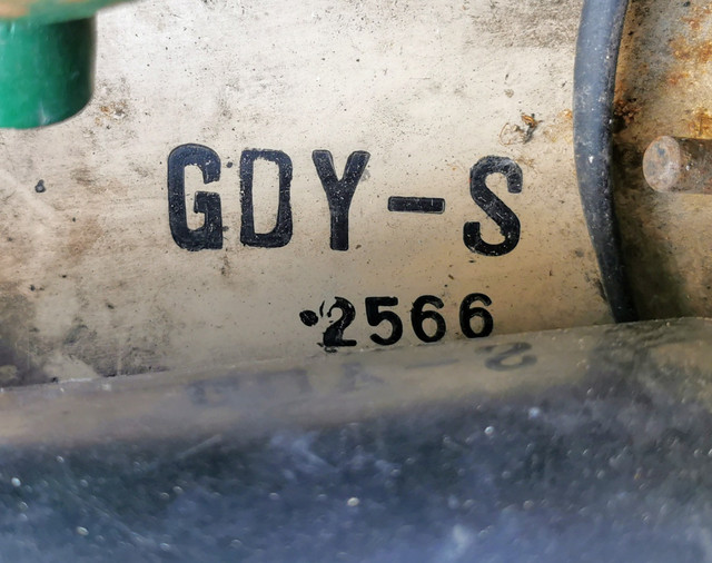

The paint code looks decently legible, behind the air cleaner.

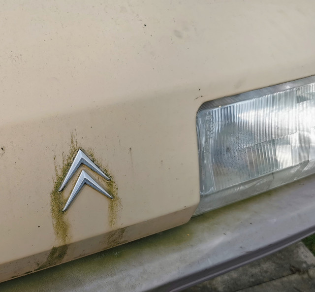

Looks like GDY to me....not Beige Sloughi but Beige Impala

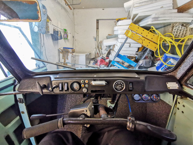

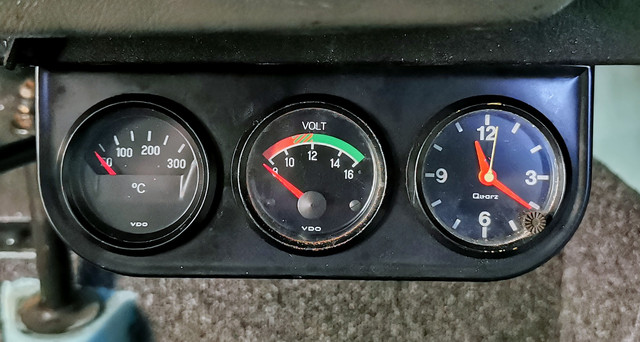

Those controls bring back memories for me, over the years I think I've owned most of the BX range including that model but not that colour, looking at your under bonnet photos I can see that the areas usually most affected by rust appear to be rust free so a good chance that the other areas, boot floor etc. will be likewise.

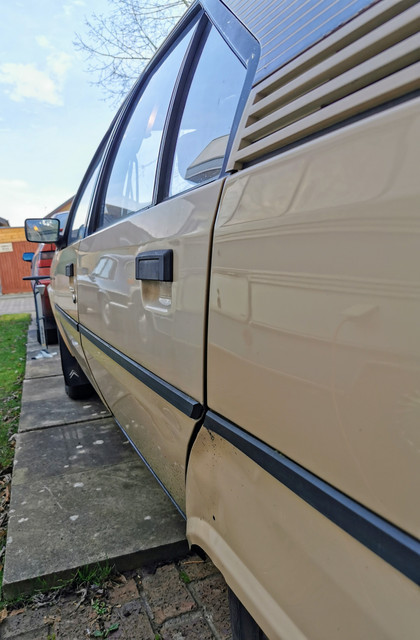

I was surprised at how different the controls were to the BX I had - I like yours better. Mine was an 'E' reg 19RD estate. Wonderfully roomy and comfortable and surprisingly quick.

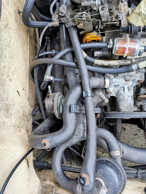

Annoyingly today I had barely any time to look at the cars, though I did drop the last two instruments into their holder on the Invacar when they arrived. Not wired up yet, but they look far better than the cheap modern tat I had previously in there.
Yes I'll clean all the finger prints off once the wiring has been done. I'll need to pull them out again to so that so it would be pointless doing it now.
Location seems a good blend between out of the way and clearly visible.
My garage is about a worst case scenario where reflections are concerned because of the lighting. If I have issues with that on the road I can adjust the angle of the bracket a bit as required.
Once I was finally released from my boring actual responsibilities I really was only left with just over half an hour of usable daylight to look at the BX. Based on yesterday's testing first task was to remove the fuel pump.
Pretty trivial to get to, all of those coolant lines nearby have enough give that you can push them out of the way as needed.
Five minutes later we had the pump off and in bits on the workbench.
Not too dirty actually. The diaphragm isn't as supple as I'd like but I've seen far worse still working. I couldn't actually find any cracks or pinholes in it.
After it was cleaned and put back into the car...absolutely nothing changed.
Best I can tell one of the valves is damaged or the diaphragm has a pinhole I can't detect. It just doesn't seem to be able to generate any decent pressure. I've checked again and can get a solid flow of fuel from the tank under vacuum, so this pump looks to be to blame.
I did note that the oil smells quite strongly of petrol, I had put that down initially to the reported miss and lack of a decent run in forever, but if the pump has been leaking internally that could also explain it.
If I'm not mistaken This looks to be the right part even though the body design is slightly different.
There is at least some electrical oddness going on too. The clock resets every time you turn the ignition off, so looks as though the permanent 12V feed for that has gone walkies somewhere. Also there's no side light position on the switch - first click takes it straight to dipped beam. Would have thought 84 would have been early enough to escape the need for dim/dip devices wouldn't it?

Is your fuel pump the same as this gen-u-wine Citroen one on Fleabay ?
https://www.ebay.co.uk/itm/Citroen-BX-1 ... 1909488000
Edit - cheaper non-genuine one for £18.05 if you get in before close of business tonight ?
https://www.ebay.co.uk/itm/Fuel-Pump-fi ... 3844305997

That's the one.bobins wrote: 19 Feb 2021, 21:42 Is your fuel pump the same as this gen-u-wine Citroen one on Fleabay ?
Have gone for the third party one for now - I've not had great luck with NOS things involving diaphragms in the past so figured we'd try this first.

Back in the distant past we were able to buy repair kits for those pumps, gaskets valves and diaphragm.
Test with a vacuum gauge on the intake side.

I was determined that today the BX was going to run.
Borrowed the fuel pump from the Invacar.
This got a decent amount of fuel flowing through the filter. Still no interest in starting though. I did block off the return line just in case the pump was having issues with the return. No difference.
Pulling the top off the carb revealed we *did* actually have fuel in the float bowl which was progress from yesterday. I was able to blast a bit of gunk out of a few of the passages. There's definitely something amiss with the accelerator pump though... doesn't feel like the plunger is moving at all. So I'll need to pull the carb and do some detective work there. Hopefully I can find a decent exploded diagram so I don't need to reverse engineer it in my head.
Back together and we tried again. Result?
That's progress. Huge progress. She still dies if you give her any real throttle because there's no accelerator pump working, but other than that she seems happy enough. Bit of a miss now and then, but the fuel coming through the filter is the colour of weak black tea, so think we need to put a couple more gallons of fresh fuel in the tank before we read too much into that. No smoke whatsoever, no rattles, she sounds pretty good. Even though that puff from the front to mid exhaust join is going to drive my OCD mad now I've noticed it.

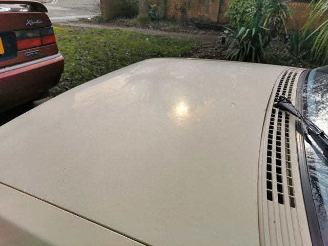

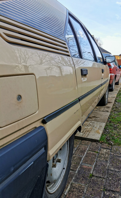

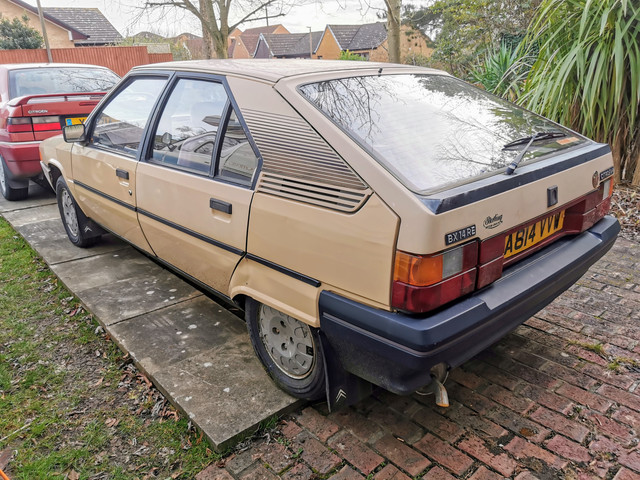

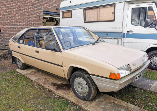

This was the first time I was able in decent weather conditions to have a look at the car.
The bodywork on this car is (aside from the one obvious dent just forward of the nearside rear wheel which looks repairable) is astonishingly straight. Like ridiculously so. The lack of scrapes and dings just blows my mind.

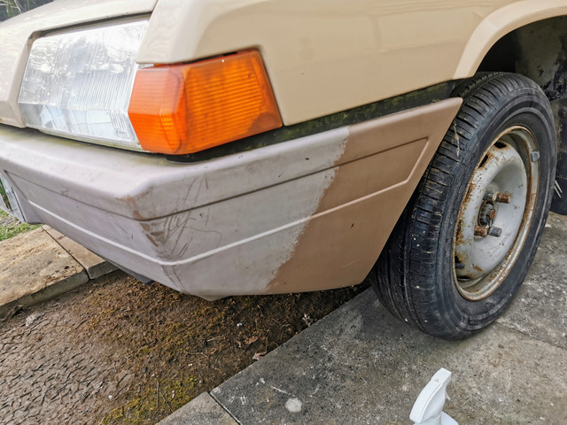

I didn't realise that the front bumper is actually brown rather than beige!
I couldn't resist hitting one tiny bit with the polish. I reckon she's going to look decent once she's had a polish.
The exterior has an appointment with the pressure washer then a load of polish soon.
I knew I wasn't going to have time for that today though, had about an hour of daylight left at that point. That was plenty of time for a first shot at the interior though.

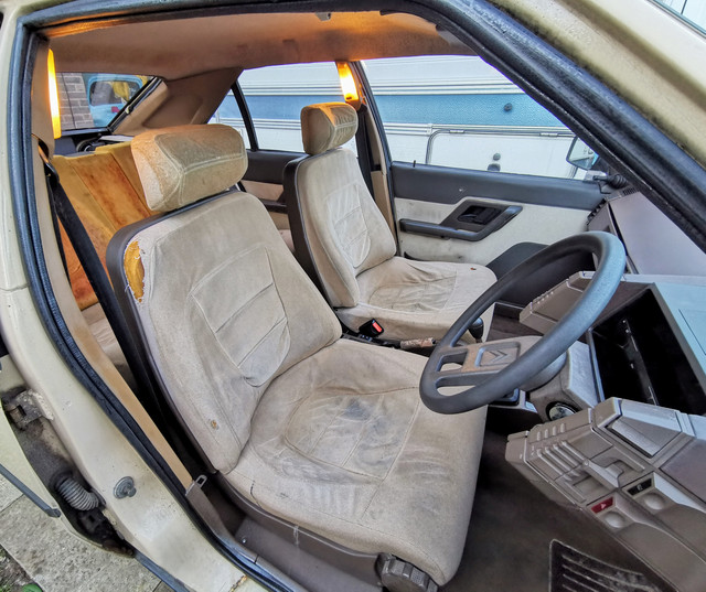

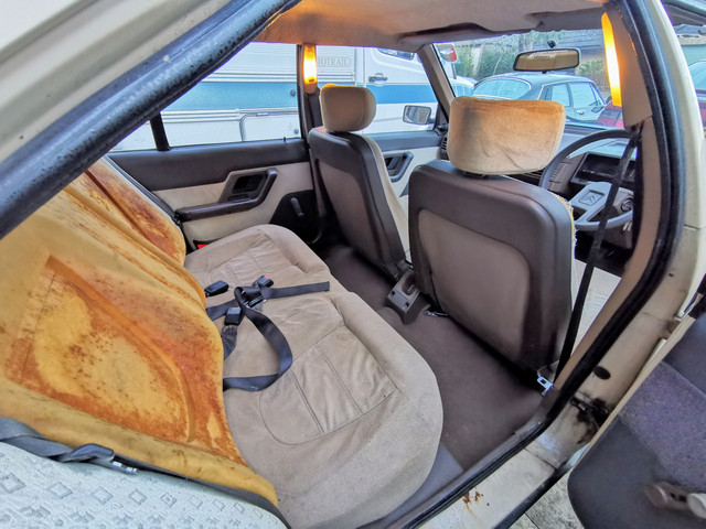

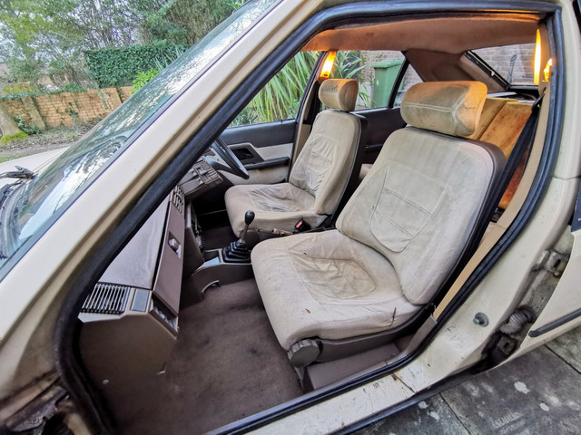

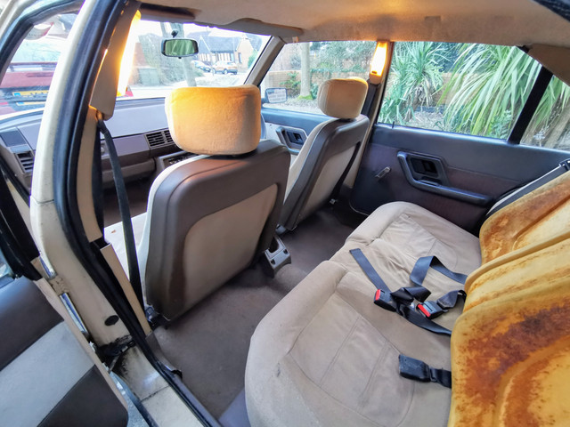

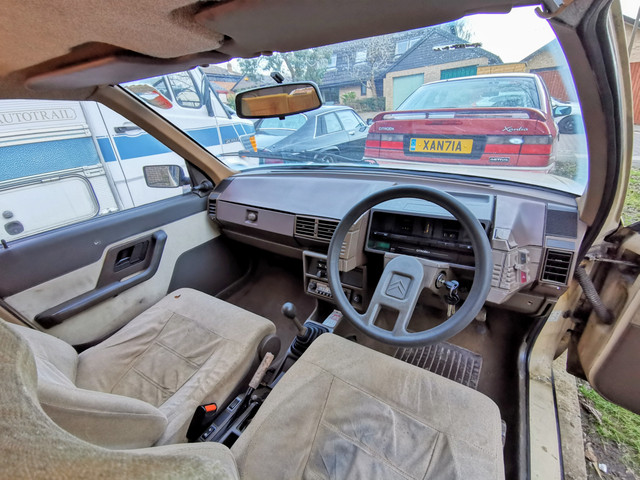

First order of business there was to get rid of the disintegrating slip covers on the seats. Front seats aren't in terrible condition under them, though they're grubby as all hell and the fabric has come away from the foam which is why they look so baggy.
After an hour or so, some attention with the vacuum cleaner and a first wipe down of the plastics this is where we were.
Still a huge amount to do but it's got rid of a lot of grime, and the dash looks so much better.

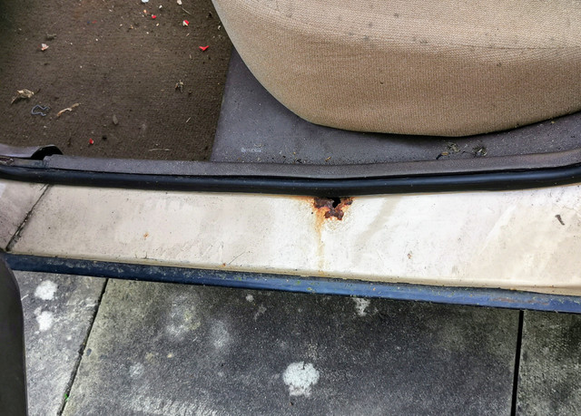

Did spot one area I'll need to break out the welder for though... hardly catastrophic though!

Finally made a point of noting the paint code as well so I can get some made up for touch in purposes.

Also, be careful when ordering Citroen paint by paint code, in the mid 1990s they changed paint supplier and many of the colours changed slightly, but they kept using the same paint codes. For example Meteor grey (early) and Silex (storm) grey (later) are different colours but both have the code ETW.
