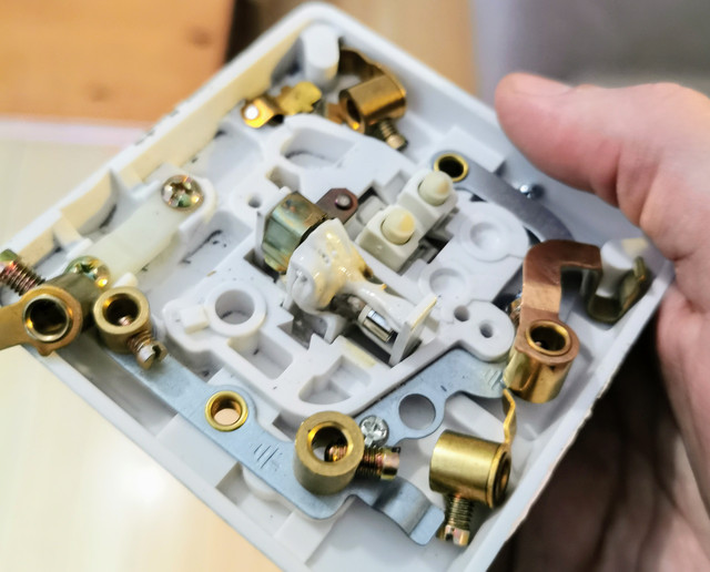

Very little time for cars today annoyingly as literally as I was opening the garage door I got a panicked phone call from a friend informing me that they had lost electrical power to their garage (which contains their washing machine and tumble drier) and they can't get an electrician in before the middle of next week. To be honest the electrics in that house are an absolute nightmare and they know that. They are currently planning later on this year to move out for a few weeks, have the entire place emptied and have crews come in and basically gut and renovate the whole house. Including a *complete* rewire and re-plumb.
Didn't take long to figure out the problem...Tracing the wire heading out of the consumer unit from the garage breaker it immediately disappeared into a junction box and then to a fused switch (which has no maker's name or anything on it anywhere). Which I wasn't able to get the fuse out of to check. Immediate conclusion: It's over a period of years running both a washing machine and a (condensing) drier, has stressed either the fuse and/or holder and has overheated. Quick check showed we had power into the switch but nothing on the way out. What did I find when I pulled it off and took it to bits?
Yep, we have a winner! Exactly what I was expecting to find.
A better quality replacement switch was installed and they've been told to try to stagger use of the appliances in the meantime, if it causes any further issues in the next couple of months we'll arrange a beefier feed to the sockets in the garage. The duct that runs into there being a foot away from the consumer unit makes life a bit easier there. Beyond that the whole place will be getting re-wired anyway.

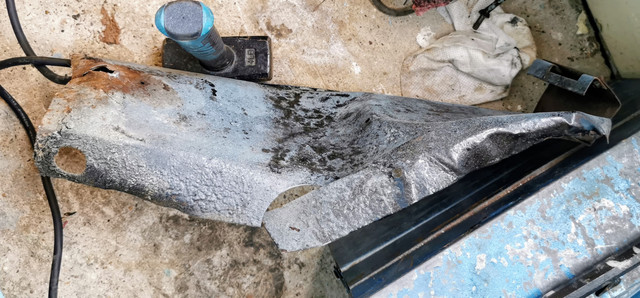

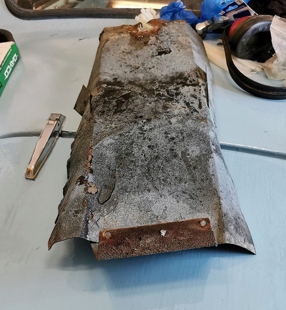

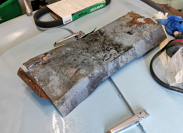

Having resolved that crisis I was left with half an hour or so to get car things done before dinner. Target was to get the front mud guard off the Invacar so I can straighten it out and paint behind it.

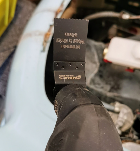

There are two bolts at the front and one at the rear of it - all of which were lumps of rust that were never going to move.
The angle grinder is too much of a blunt instrument for jobs like this, I'd most likely end up damaging the surrounding bodywork. Step forward the reciprocating multi-tool...it's much more of a scalpel than a sledgehammer and is one of those tools I curse myself for not buying about fifteen years earlier. It made light work of the front two bolts in a matter of seconds.
The rear one was a bit more of a hassle as I couldn't get quite far enough in to get to the bolt properly from any angle so I wound up cutting around it a bit. Will mean I need to put a small repair plate on there before it goes in but it won't be a difficult repair. The mudguard as a whole though needs "a little help" I think it's fair to say.
That *should* be pretty much a straight U shaped channel save for the bit that's folded up to form the keeper for the bonnet latch at the right hand end.
I reckon that with a bit of careful application of the hammer pictured there and a large chunk of wood to act as a former we'll be able to get it back to something far closer to the correct shape. It doesn't need to be absolutely perfect after all. I'd have done this a lot sooner but only relatively recently discovered that it could actually be removed.

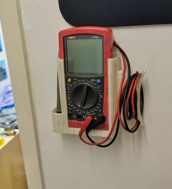

This is the piece of test equipment that I lose in my room by far the most frequently, not least because it's an awkward shape...so I made a little bracket for it to live in. Hopefully it will stop vanishing quite so regularly now. Already planning similar solutions for some of the more awkwardly shaped tools in the garage which frequently vanish because there's nowhere truly out of the way for them to live, especially with my garage having a critical lack of flat surfaces on which things can sit.

That's a great way of storing a multi-meter Zel
Please add me to the list for one
Been after something like that for years

Let me know the dimensions of your meter and I can certainly get one made for you.CitroJim wrote: 01 Feb 2021, 08:07 That's a great way of storing a multi-meter Zel![]()

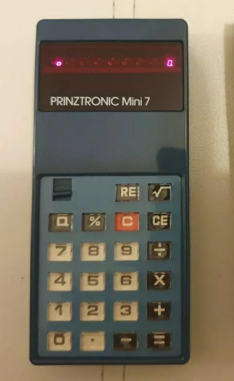

Decided one of that family of calculators was an essential addition to the collection since you showed your one. I'm a sucker for reverse printed clear controls like that so knew I needed one the moment I saw that keypad.

Wow! That's magicZelandeth wrote: 02 Feb 2021, 02:54 Jim, my having just bought this is entirely your fault!

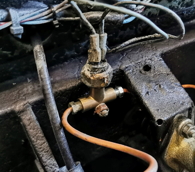

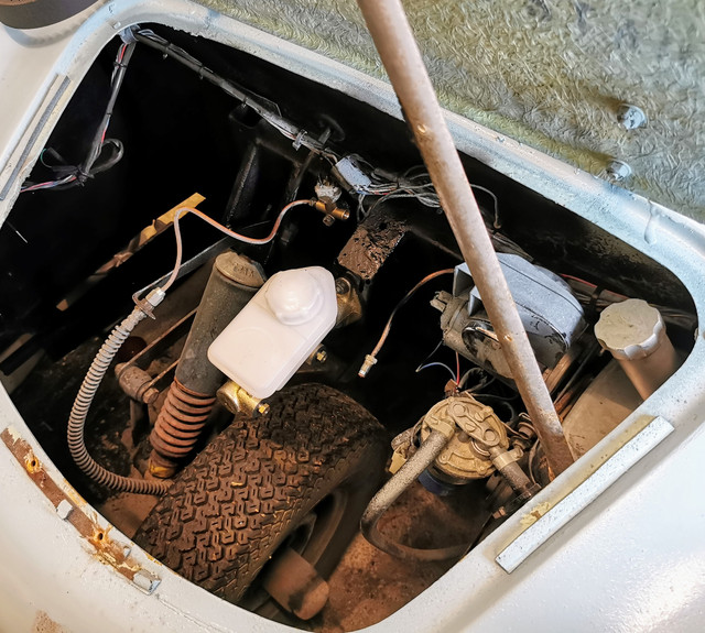

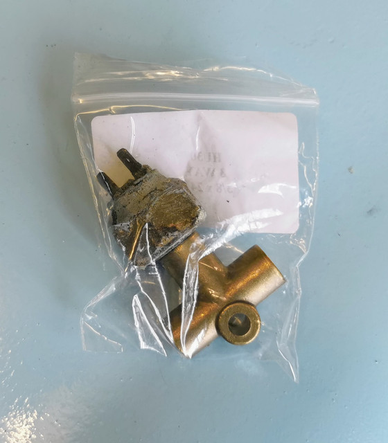

Finally got hold of the last couple of bits I'd been waiting on to allow me to proceed with the brake system upgrade on the Invacar.
Metric unions are needed because the master cylinder is metric, and the T is a replacement so I can replace the 4-way one the brake light switch is currently fitted to - which of course needed to be Imperial because the brake light switch is!
The switch was removed from the car and stored safely in the bag with the union it will be living in from now on while I removed the old T piece.
That's now been loosely refitted to the stud the T-piece lives on.
This has then allowed me to have a think about how I'll be routing the lines, shouldn't require too much plumbing. The line to the rear will be getting extended the couple of inches needed to reach the cylinder. I did think about remaking the whole line to avoid the need for a join...but the run is a single piece all the way to the T at the rear axle and routing it would require me to remove the fuel tank. It's getting extended!
Shouldn't take long to get things in here hooked up.

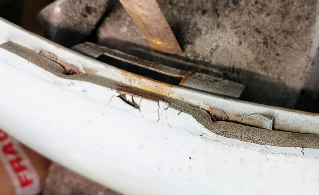

Just ran out of time today.
The mud guard will need a bit of careful attention, but even a couple of minutes has got it looking far closer to the correct shape again.
That was mostly achieved simply by standing on it! Shouldn't be too hard to save it.

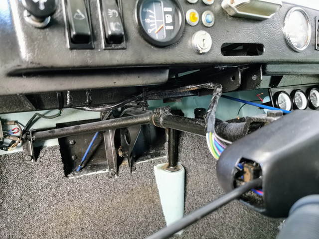

Now we're getting somewhere.
Front circuit is bled through, rear will have to wait till tomorrow. Everything seems fluid tight though, though everything will be given a bit of a tighten once it's sat overnight anyway.
Brake light switch is back in place. I'd have rather had it flipped through 90 degrees to make clearing the master cylinder bracket and speedometer cable less of a hassle. However the switch is just too bulky for that and would foul on the bulkhead.

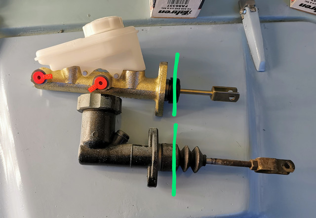

Have encountered one slight snag though. I may need to source a longer pushrod for the master cylinder.
I didn't notice when I swapped it over that the new cylinder has the resting position further forward than the original one. Oops.
This results in the handlebars sitting depressed a couple of inches even when the brakes are fully released.
There is some adjustment available in the pushrod, but probably not enough. One possibility is that I *may* be able to drill an additional hole in the yoke. There are already three or four for different braking systems so one more won't be a problem. Will probably mean taking the whole handlebar assembly apart to gain access though. Won't that be fun...
Hoping this won't be too much of a headache to resolve. Ah, the joys of trying new things out.
