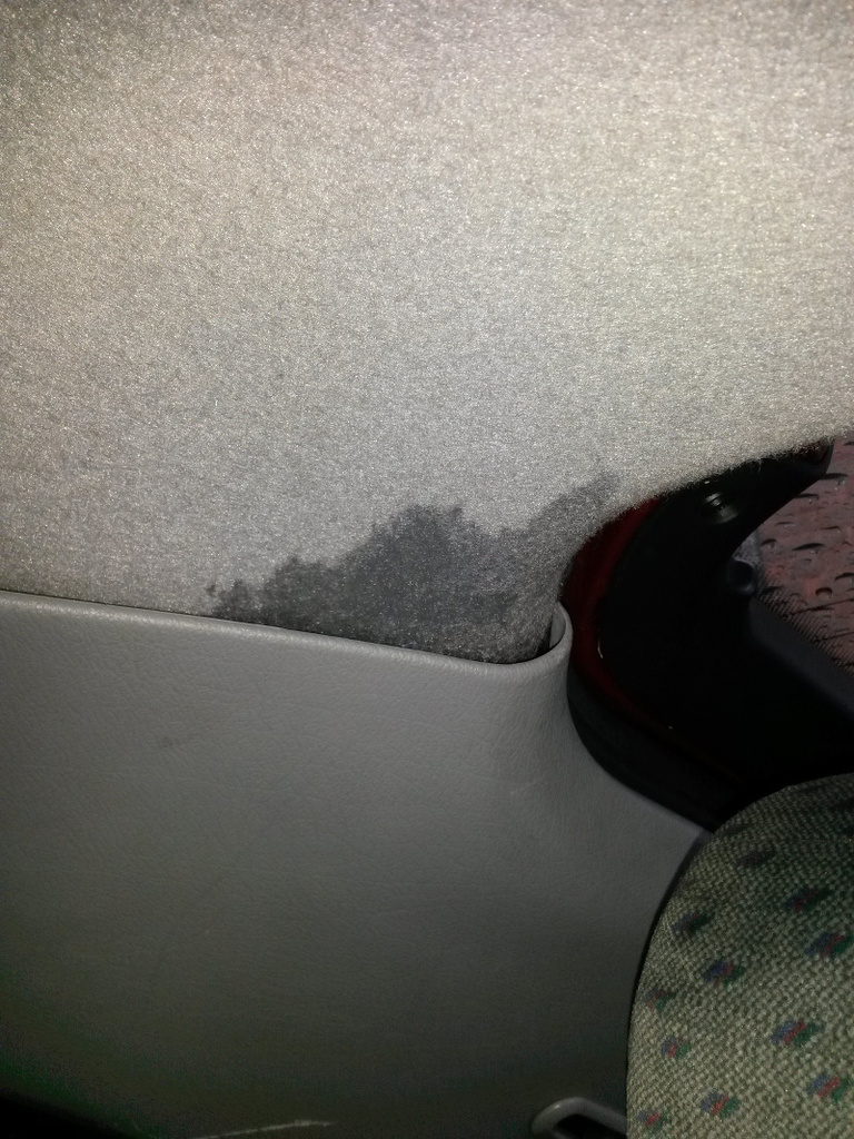

Officially irritated.
It's actively dripping in, but I cannot for the life of me figure out *where* it's getting in. Best guess at this point is the actual line between the B pillar and the roof panel? The paint in there does look a little cracked, so it's not impossible I guess.
Area around the bootlid hinges and the bonded panel joints there has been thoroughly sealed up, so that's out. Gave the area around the cabling from the bootlid a going over too just in case, even though it's so far recessed I can't see it getting wet. The seal itself is in good condition and is properly seated. The water is *not* creeping in under the seal as it might appear in that photo - the area actually under the seal is bone dry. It's not getting in around the washer jet and running along the pipe...so I really can't see anywhere other than the seam mentioned above that it can possibly be getting in from!
This problem is really starting to get on my nerves. Can't really do much about it right now as it's tipping it down out there.

Gonna have to get the headlining out....
I had a similar leak on a BX, that I am pretty sure was the roof to side panel joint. It sealed itself up after I carried a heavy load on the roof rack.....!

I don't know about irritated Zel, more like irrigated...
Check the tops of the rear wheel arches were you may find bungs sealing 9or not) the holes for the sunroof drains if a sunroof was fitted. I know yours hasn't but worth checking all the same...
Rear light cluster seals good?
Hatch seal OK?
Hatch seal OK?

Car hasn't been driven since yesterday (when it was bone dry) so don't see how it could be getting in around wheel arches or anything like that - will check anyhow though, it's definitely dripping in from above (hence the damp patch of headlining you can see). The hatch seal seems to be fine, and the boot area is bone dry - it's getting in some where around the top of that pillar then running down the back of the plastic trim, behind the plastic bit that's behind the rear seat back by the door closure, and appearing under the rear seat.
Because that whole area is double-skinned it's just about impossible to actually track where it's coming from.
The seam between the pillar and the roof panel seems to be about the only possible ingress point left unless the water has figured out some way to actually phase through the metal itself...
Thankfully it hasn't made it as far as the floor, as drying those carpets and the sound deadening out sounds like all manner of fun!
...Not that I'm not considering taking them out anyway as I'd really like to attack them with the pressure washer and some carpet shampoo as the driver and passenger footwells are areas that do look like they've done 200K miles and it bugs me!
The headlining is already pretty mutilated back there, I reckon from the previous owner trying to figure out where the heck the water is coming from...Though it does mean that I can get access to the area above it at the back - and that achieves absolutely nothing as far as figuring this out it turns out.

It would be a bit rough, but maybe worth it to find out, run clear bathroom sealant along the joint and see if that stops it? If it does then find a way of a permanent repair.
