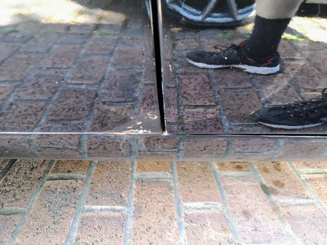

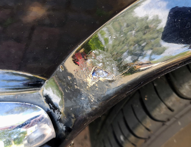

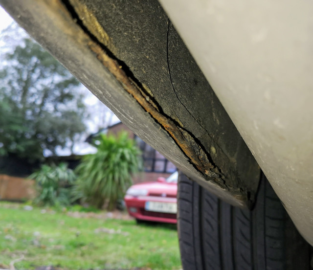

The bodywork list as I know at the moment stands at:
[] Patch needed (I know full well it will be a hole if I poke it) immediately behind the driver's door.
[] Offside rear wheel arch.
[] Usual hole underneath the coolant expansion bottle because Jag put a foam pad underneath it. Will need the wing removing but shouldn't actually be that much of a headache to sort. I've given this a pretty good bashing with a screwdriver and it doesn't extend any further than it looks like it does.
I'll probably do this one myself as being hidden away behind the wing and a cover it's out of sight so my scabby welding won't be visible! I can weld stuff together so it's solid just fine - pretty, not so much!

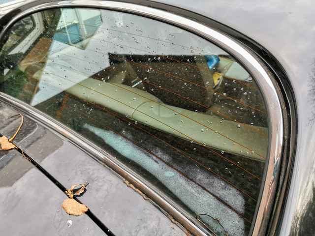

[] Rear screen needs to come out to clean up the mess around the outside. This looks strange because Vactan apparently goes strange and puffy if you don't overcoat it and it gets wet. My bad. Bit of a sand back and paint will make the world of difference here. Doesn't actually look to be much under the seal from peeling and peering under it I've done, but obviously I'd like to get the screen out and make absolutely sure there's not a huge headache for the future hiding there.
[] Manky bit where the seam between the two bits of the sill behind the nearside rear wheel have started to come apart. This actually looks worse than it is - I was expecting this to crumble to nothing once I poked it, but a lot of it looks to be solid.
Then of course there are a laundry list of other jobs too...but bodywork is always the biggie with these cars I reckon! Anything else you can sort with a bit of patience.

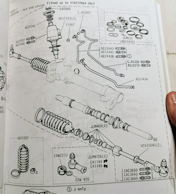

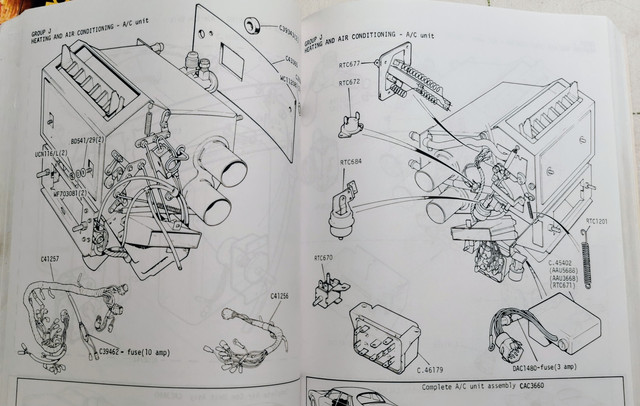

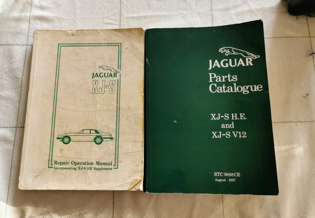

A couple of very useful documents turned up yesterday.
They should be very, very useful. It might seem counterintuitive but the parts catalogue is actually probably going to be the most helpful. The simple reason being that it has nice big, A4 sized, clear diagrams like these.
Given there's so much on this car you can't see because stuff is in the way so you need to assemble or disassemble by touch having these diagrams showing how stuff actually fits together should be really helpful.

Cor! Proper old-school drawings Zel
Huge clarity and rather beautiful
Such magnificent diagrams are a rarity these days

The Jaguar Parts books of the 1970s and early 80s are works of art. They are generally very accurate, I am only aware of about 2 errors in the whole book, one being on the page that shows the transmission mount, which shows the components assembled in the wrong order, and perhaps one spacer completely missing, and I think that there may be a washer missing or too many where the steering arm mounts to the front hub.
The workshop manual itself suffers from poor editing and proof-reading, with some sections copied from earlier models and thus misleading. This is compounded by the decision (by BL) in 1980 not to update the manual any more, other than by the insertion of annual update pages in the back of the manual which are written in a different style, and not really indexed.

I always found that a good parts book with that type illustration was far more useful than a wordy workshop manual.

Agreed, and better than the photos in the Haynes BoL any dayGibbo2286 wrote: 06 Dec 2020, 11:26 I always found that a good parts book with that type illustration was far more useful than a wordy workshop manual.
