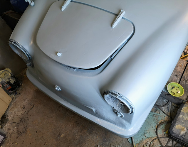

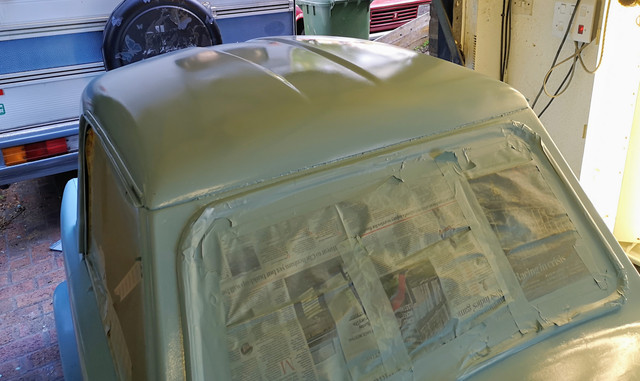

Definitely struggling? with the spray gun a bit. I don't seem to be able to get any sort of a wet edge laid down no matter what I've done wit?h the settings and the paint d?oesn't seem to be atomising all that well, hence the pebbly texture we seem to be getting most of ?th?e ?tim?e?.??
When covering????? other colours (like the grey primer on the roof front edge) it was immediately apparent how thinly the paint was going on too. I did a little experimentation with thinners and found that I could get a decently "wet" spray - but at such a point that the paint was watered down to the exte?nt I wound up with odd effects where the pigment had run...so not really a solutio?n?.
I think the? £18 spray gun may need to be eyed as a possible contributor to these issues...I don't think air supply is an issue as I've verified I've got suitable pressure at the delivery point (not just shown on the regulator).
Every now and then it will sputter for a second then give me a few seconds of actually decent spray...so there are some spots where things are actually glossy.
Bit frustrating? to be honest as so far I've not come close to matching the finish I was getting from rattle cans (admittedly at about ten times the price) beforehand. As demonstrated by the engine cover below, where it caught the rain a little yesterday evening when the back end was sticking out the garage door a bit.
We'll get there??? I'm sure...just going to take some time and experimentation I thin??k?.

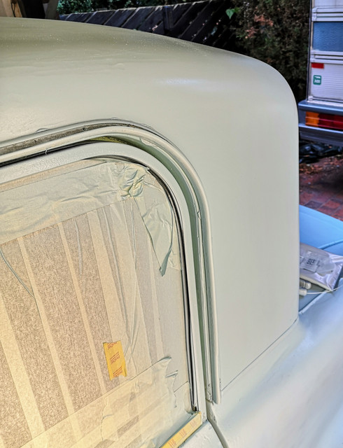

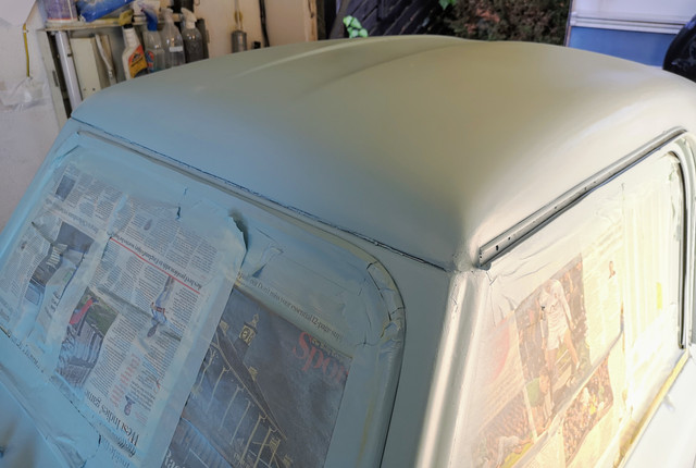

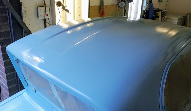

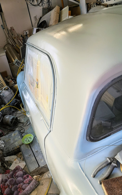

Not a huge amount of progress from yesterday - though the rear of the roof is now the only bit which is now still in primer.
A friend of mine who does quite a bit of painting of commercial vehicles has suggested that based on the type of paint I'm using the 1mm nozzle is likely to be sub optimal for doing full panel spraying. This ties in with my observations to be honest today when I was fiddling around with the settings on the paint gun. I got a nice finish on the little box I was using as my test piece, but turning back to the car it felt like I was puffing paint at the car through a drinking straw again.
About an hour after that conversation someone suggested that on another forum as well.
My friend has also suggested that this paint should behave well if rollered on, especially on a less than stellar surface like this where we want a bit thicker a coat than might normally be expected. So I'm going to give that a try tomorrow. Never tried it before, but curious to try it.
Should quickly be able to get the remaining bits of primer in colour quickly anyhow. I've not discounted the idea of getting it along to the National Microcar Rally next weekend yet...but there are a lot of things which would need to go right before that can happen yet.

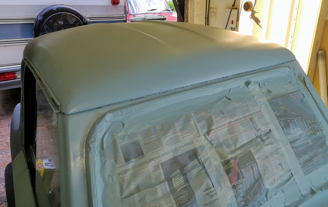

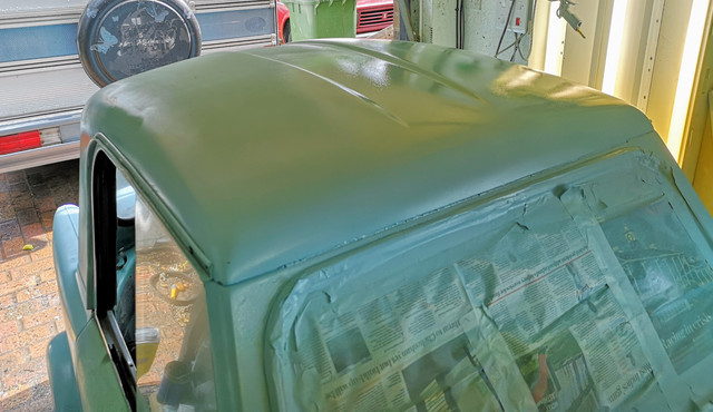

Unless I'm hallucinating, it looks like we might actually? be ?maki?ng prog?ress ?no?w?.
Ten points to everyone who suggested that a 1mm nozzle was smaller than ideal for this paint and application. 1.5mm is working far better. It feels like far more of the paint is now actually ending up on the panel???????? now than just floating around in the garage. I had about 250ml left of the original litre...and it felt like it went way further than two refills of the original spray gun would have. There's probably room to open it up a bit more yet to be fair too. ?
Will get an additional two litres picked up tomorrow, get the last few bits of car masked up, then have another bash at it. It's behaving far closer to what I was expecting with this spray gun though, and is giving a finish which it's actual?ly worth flatting back for the next coat, rather than a finish that is rougher than the abrasive I'd plan to flat it with. ?
??Time will tell if it's a false start...but this feels like progr?es??s???.?

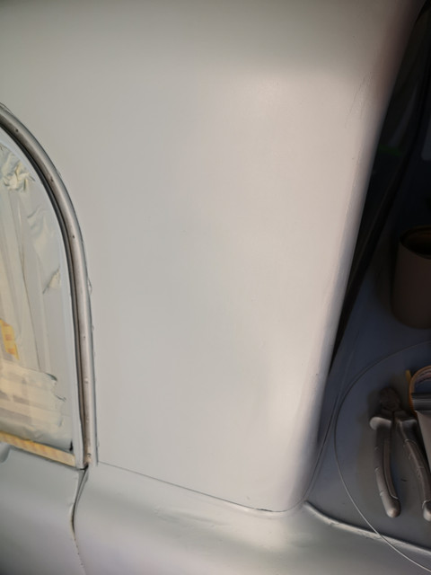

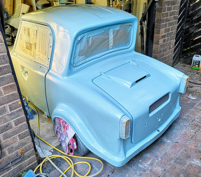

Today was very??? much???? a game of two halves. Also can be read as "discovering the pitfalls you need t?o watch for when pai?ntin?g?."?
Given I was going into this with precisely zero experience, not unexpected that days like this would happen.
Picked up the additional paint, got the gun ready, loaded up with an actually carefully measured 5:1 mix and did a quick test panel. All looked good. Regulator settings still seem well off the mark, but the spray looks good so I'm going ?with the "if it ain't broke don't fix it" approach there. Let's not make myself work. ?
Things were actually going well up until about the 80% mark. Though I REALLY need to tidy my garage up. Trying to mov?e around a car covered in wet paint in there is near impossible just now.

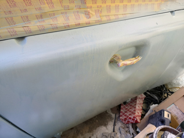

At that point something odd happened... suddenly the volume of paint I got out of the gun increased by a factor of about ten it felt like. It was very visible when that happened from the cloud and the change in sound. ??
Best guess I have (also pointed to fro?m the visible evidence) is that I'd not done a good enough job of mixing the thinners in and I pulled in a pocket that was very thinners rich. Sadly this resulted in it looking like I'd dumped a bottle of thinners over the roof and offside door.
Am I disgruntled? Not really. It's a learning experience and I'd far rather make these mistakes on a car that's this cosmetically challenged with relatively cheap paint rather than respraying the Xantia or something like that where the fina?l finish is far more critical.

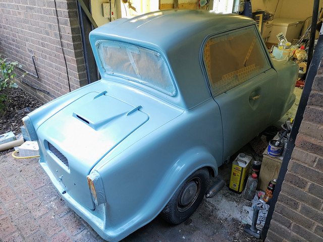

? So I'll definitely need to give some areas? another coat, but we're looking close to a point where I'm going to feel I can call it good enough for now on some areas now.

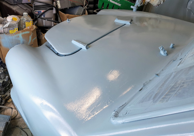

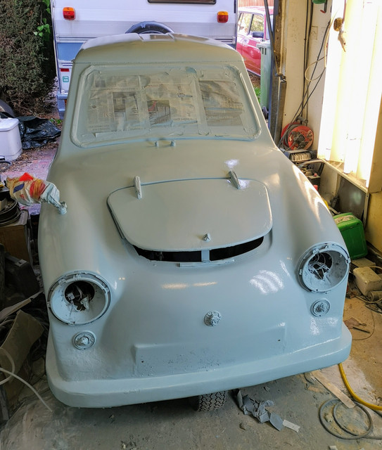

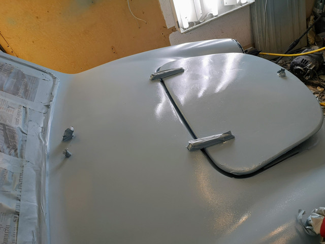

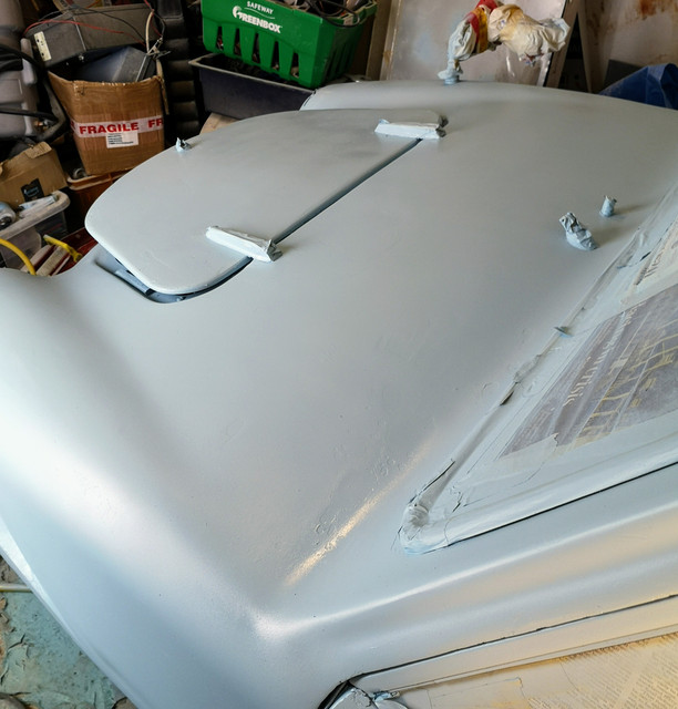

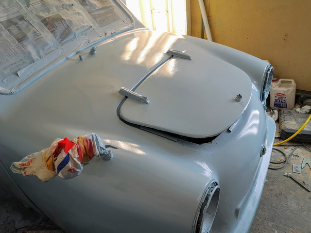

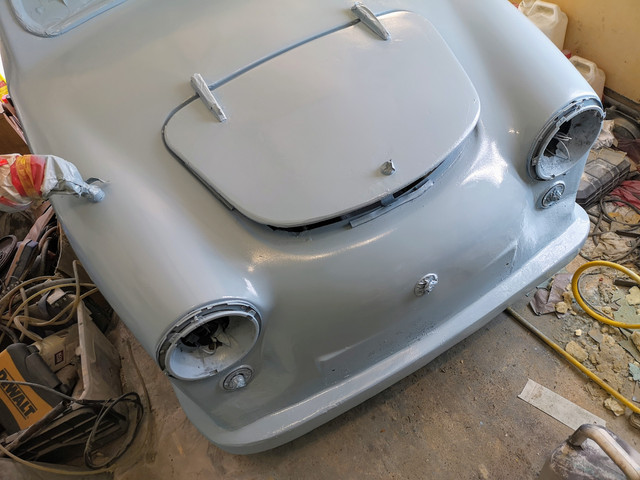

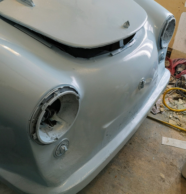

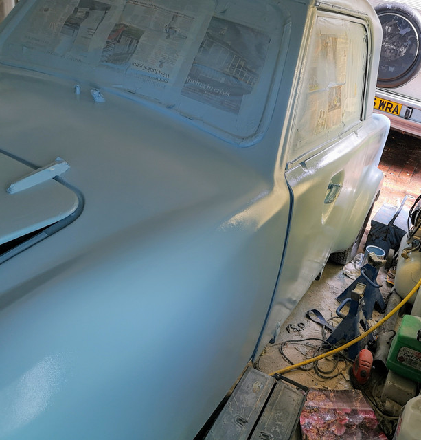

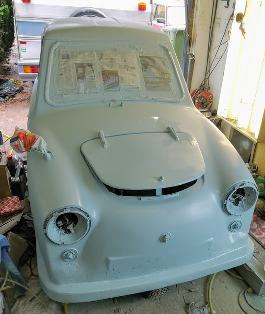

Pictures hopefully speak a thousand word?s.?.??.??
The target here is to get???? to a state which you'd not immediately think looked scruffy if you saw me driving past...and it feels like we're starting to get there??.

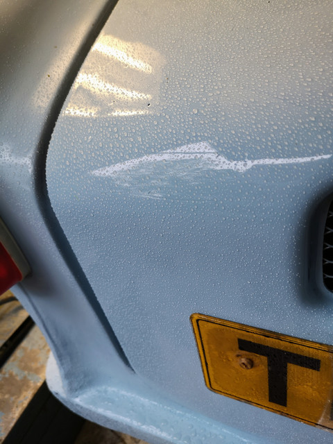

Here's the two shots where???? there's evidence of my "paint flow anomaly" which I'll need to resol?ve???.
Nothing a quick rub down to smooth out the resulting runs and a recoat can't sort though????. Will have done a decent job of sealing the surface at least. ?
I don't think I'm being too forward in saying that I think TPA is looking a heck of a lot better than she did a couple of weeks ago. Just a shame I didn't get this done before the FotU! ?
I've not bothered masking the indicator surrounds up front as they're badly perished and will be replaced shortly. Likewise the lock on the engine cover - it's seized beyond all redemption so will be getting changed. ?
I'll be getting a small brush out and doing a few details by hand. The edges of the door frames yo?u can't see with the doors closed (I can't be bothered taking the doors off or masking the whole interior off!) for one, and applying some "steel wheel silver" to the engine cover hinges and the air intake grill. Wheels will be getting hammered metallic black (one is already done) as well.

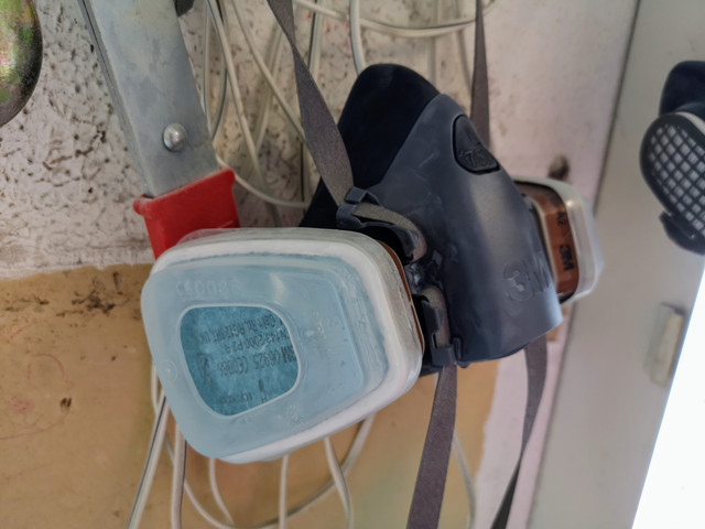

I continue to be very glad I bought the proper mask for this job.
Far prefer that blue paint to be in the filters there than in me!

Then next up will be sorting a few items on the snagging list I think. High on that list is to get the dash out to sort some wiring "repairs" I've seen which I don't like. The screw terminal strip which is carrying the full primary circuit current (including battery charge I believe - so theoretically up to 35A) which I really don't like. The ignition switch gets qu?ite warm too, so I'd really like to get some relays fitted to take the strain off it.
...Or I've been spending too much time work?ing on PSA vehicles with their self destructing ignition switch contacts and it's made me paranoid!
That's obviously the ideal time to get the switch for my heater blower fan wired up as the dash will be out and I'll h?ave the soldering iron and heat shrink out.
Feels like I've made more steps forward today than in a while though. ?
