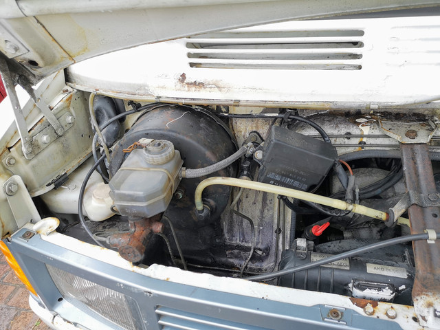

I did consider that, but I know what my time availability is like these days and I can't really afford to have the van off the road while I faff around for weeks trying to find time to get around to rebuilding the cylinder. The fact that it seems to be far worse at one specific point in the pedal to travel does make me wonder if the bore is possibly scored or pitted which is the root cause of the problem.
The fluid in the system when I got the vehicle was truly disgusting (think very slightly cloudy black coffee) which probably hasn't helped anything. I did pull the slave cylinder apart and it turned out that the bore of what was badly pitted.
Apparently both rear brake cylinders had "failed" as well at the MOT - though as I never got the old parts back from the garage in spite of my both asking and leaving written instructions I never got to find whether that meant they had seized or were leaking. Still fizzing about that whole experience...I mean seriously...a garage that primarily deals with HGVs and PCVs shouldn't be doing stupid stuff like failing to tighten wheel bolts...
I'll do a post mortem on the cylinder that comes off, and if it is in a fit state to be rebuilt I may well do so...either keep it as a spare then or possibly throw it at eBay to recoup some of the cost.

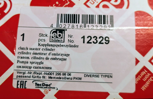

Care package arrived for the van this morning.
Thumbs? up ?for Simply?? Car Parts...I on?ly ordered this on Monday evenin?g, so having it on my doorstep on Wednesday morning is pretty good going.
Here are the part numbers for those of you playing along at home.
You may be wondering why I didn't just get it from Mercedes themselves...as I've tended to use them before because their parts supply has always been so seamless and not usually much more expensive than eBay etc. This has been one of the stand out things about owning a Mercedes...that the dealers actually want to help, and at least the reception I've had in our branch has had me believe that they don't care if you're in a car that's 29 days old or 29 years. I was staggered when I walked in a couple of weeks into ownership and they in moments had managed to track down several normal service items and even a replacement lens for the indicator light on the dashboard to replace the cracked one I had.
The last couple of times I've been in though we've had some issues. I have to make it abundantly clear though, not issues with the gent on the parts desk, he's a legend and has gone above and beyond to the call of duty to be helpful.
The issue is due to instructions from corporate somewhere within Mercedes-Benz that the dealers are not allowed to have anything to do with parts supply for anything other than passenger cars - totally irrespective of what it's registered as, it's actually down to the vehicle platform...so being based on the 601 platform I'm out of luck. Instead of being able to sell me the parts, they instead refer me to a nearby commercial vehicle specialist who apparently they partner with.
Slight issue there: said specialist doesn't deal with non-trade customers. Even before we realised that, they literally laughed in my face when I went in looking for parts for a 29 year old van. Apparently I'm far from the only person to have been less than impressed with them, even in the trade.
The last couple of trips the gent on the parts desk managed to cross reference things and trick the system into letting him order parts for other models of passenger car...however we struck out on this occasion, so I had to pick it up myself. Credit to the parts manager though, he still printed off all the part numbers for me.
He also believes it's an utterly daft situation. Sure if someone comes in looking for parts for a Tourismo or Actros (coach and artic lorry respectively), then send them on to the relevant specialist...but where it's a light van clearly registered as a motor caravan...C'mon folks, use some common sense. Especially as heritage vehicles like this running around can surely only be a good advertisement for the longevity of your products...and let's face it the Merc T1 van is something of a design icon. Or is that just in my head? I know if when I was a kid if you'd asked me to draw a van you'd have ended up with something that looked far more like a Merc T1 than a Transit...
Not going to???? let? it spoil things though...doesn't mean I won't? rant about it however! Just a shame as the excellent heritage parts support was one of the big plus sides of Mercedes ownership (and I don't doubt it still is if you own a passenger car).

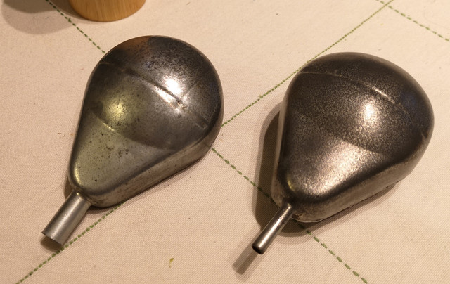

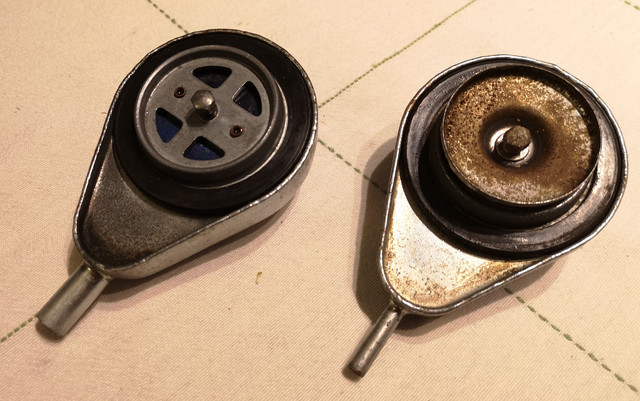

Nothing? massive to report other that than with use TPA seems to just keep running better. Had her out this afternoon to run a few errands, rubbing shoulders with rush hour traffic. No bother. ?
Have finally brought the PCV valves picked up last week inside for a clean up and fitting when I next get a chance. They're used examples but in a lot better state than the ones on the car currently?.?
No idea? whether I should expect this to make any difference to running, but it certainly can't hurt I figure.
Should rid me of a minor oil leak though - the seal on the lower one on the car is perished so the join "sweats" at the moment. The seal on this one is in good shape so this should put an end to that leak.

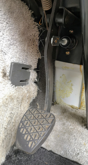

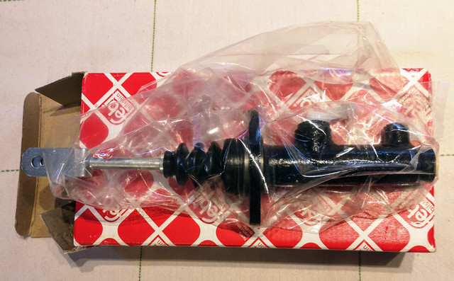

That was pretty?????? pai?nless.
New clutch master cylinder is now fitted ?to the v??a??n???.
Only slight??? headache was discovering that the hose clip had cut into the hose to the reservoir meaning I had to trim the end back a little, so the hose is now a little too short. Not a major issue in the grand scheme of things, hose looks pretty crusty anyway so probably not a bad idea to change it anyway. ?
The test drive revealed quite how bad it had become. The gearchange is considerably more slick now which leads me to believe that we weren't seeing the full range of motion actually at the clutch end. The pedal is also a good deal lighter which is surprising given it was already surprisingly light for a design this old.
Next task there is probably going to be getting hold of some more fuel line and swapping out the tails which connect the rigid vacuum lines around the fuel pum?p together (I'm assuming they're something to do with the system which raises the idle speed slightly when the engine is cold) as they have perished a bit, and I figure it just makes sense to get them dealt with while I'm thinking of it??.?
Edit: Nearly forgot...need to have a poke around under the Activa tomorrow as the exhaust has started knocking loudly on something when the engine starts or stops today. To be fair, Jim was apologetic about how crusty the exhaust looked even when I got the car, and that was the best part of two years ago...so if it's finally actually starting to fail I've no complaints! Will be time to make a trip back over to Fusion Fabs if that's the case though as I'll be having them make me up a system in stainless.

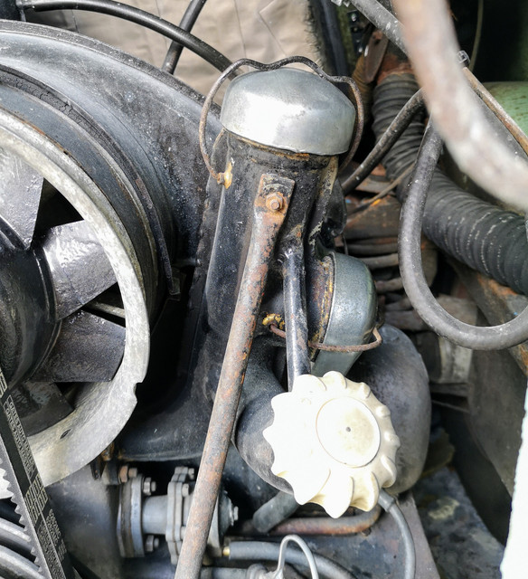

Oh...forgot that the new PCV hardware has now been fitted to the Invacar.
Looking into the vapour separator now it's obvious that now she's had a few good runs that the moisture issue has been largely resolved. This was full of mayo like you'd expect on a water cooled engine with a stuffed head gasket when I first got it.
I'd like to get the whole tower off the engine for a good scrub (it's brass, so should clean up nicely) though from what I've heard it's virtually unheard of for the join between the oil filler and the block to be oil tight on these engines...and mine is completely free of leaks from the oil filler so I'm not going to tempt fate by messing with it.
Haven't had a chance to look at it yet as energy has been seriously lacking today. Hoping I might actually get something useful done tomorrow.
