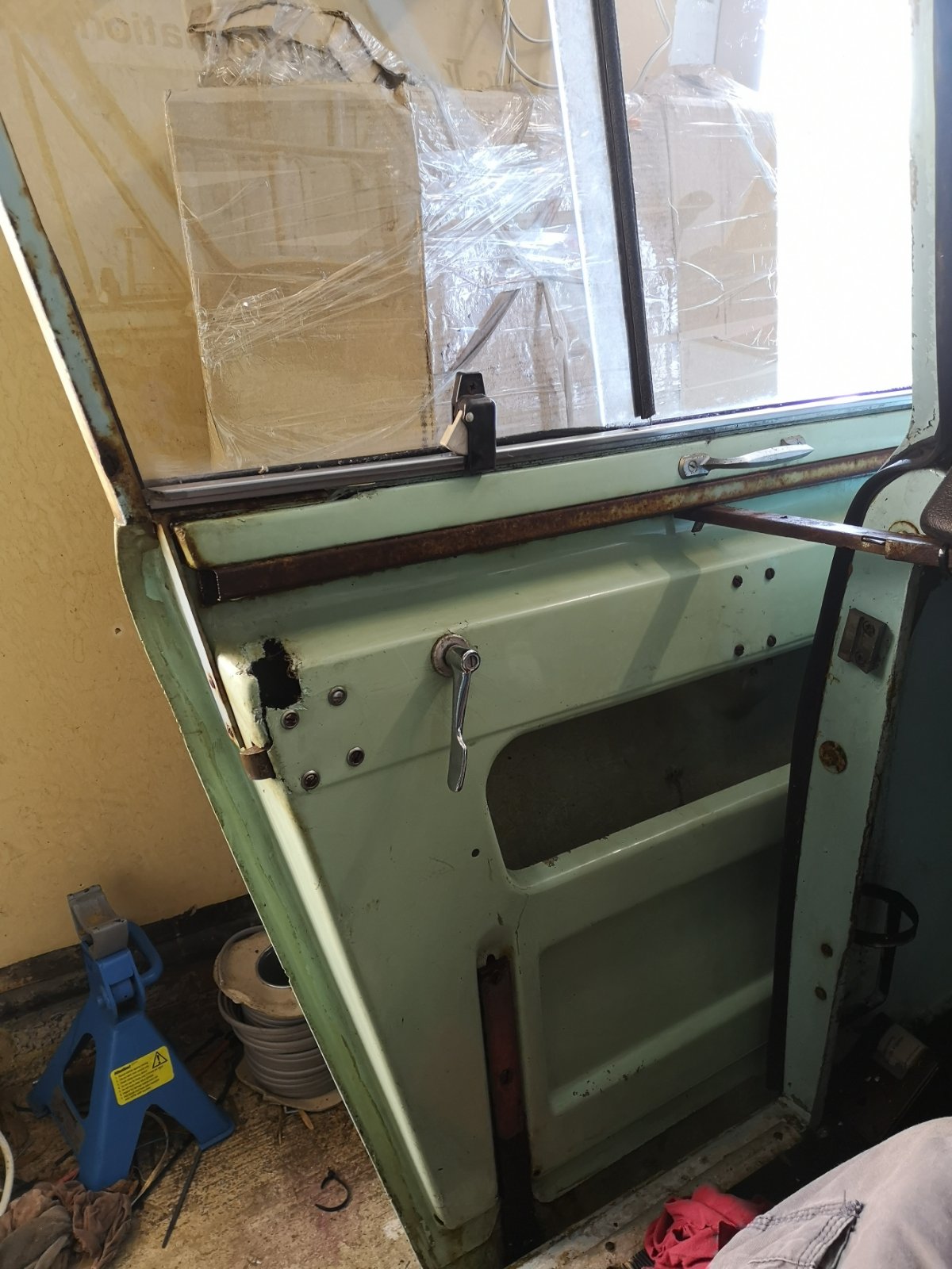

[] Sort out enough bodywork so there are no sharp edges.

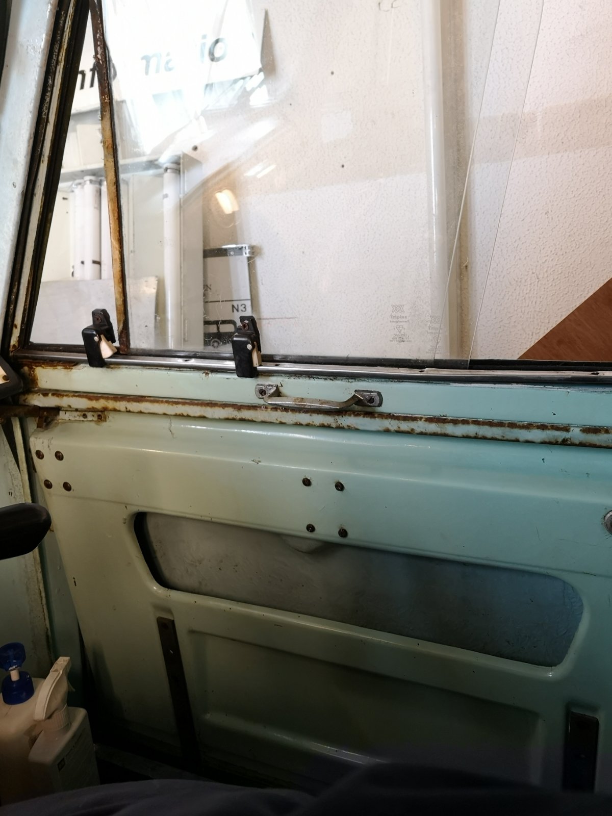

[] Reattach offside interior door handle so it can be opened from inside.
[] Reattach front service cover.

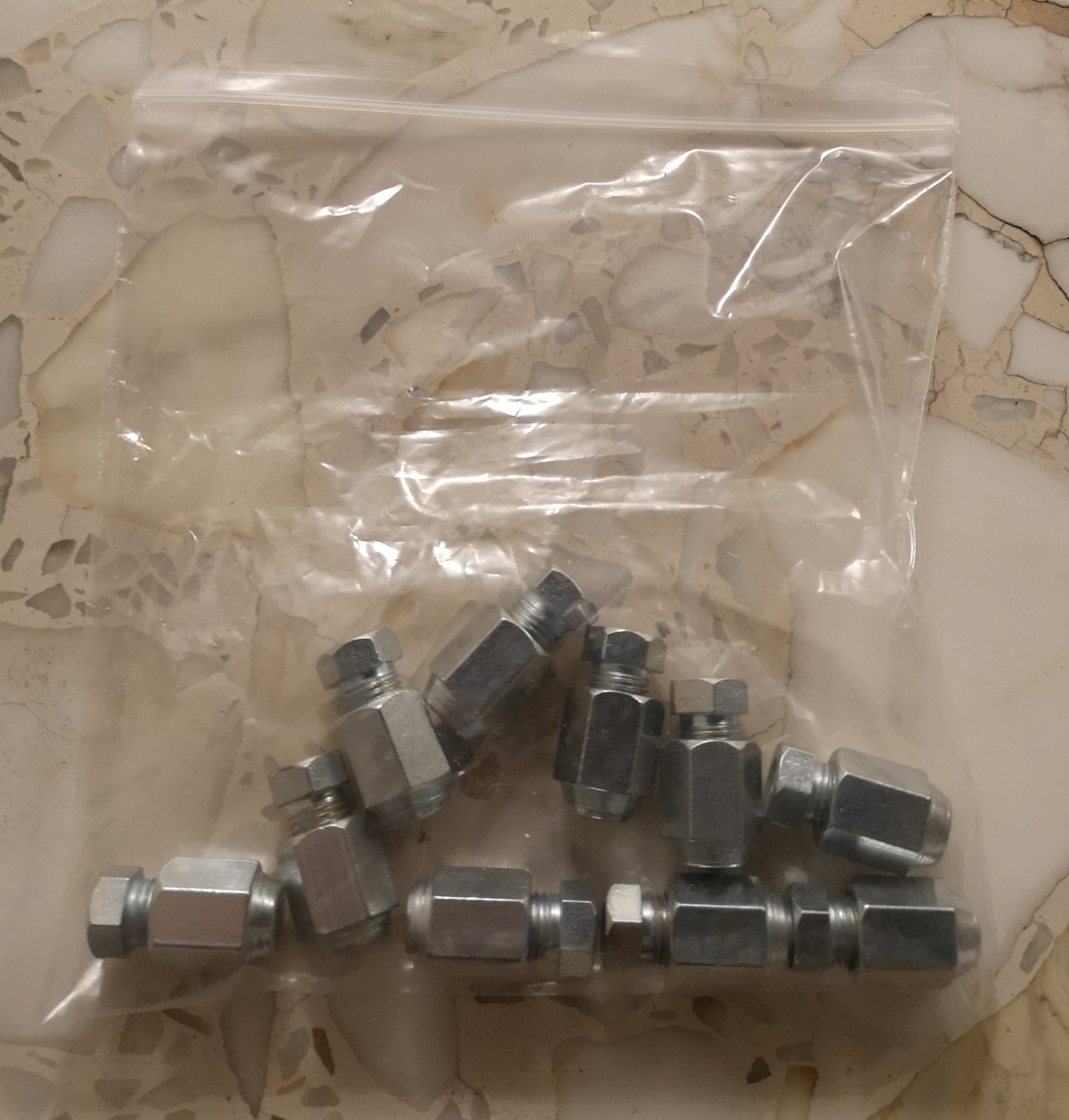

Speaking of brakes, this arrived today.
Should be able to get the brakes tidied up now at least. The original brake line from front to rear is a bit of a pain...the line from the front T goes down to the front of the chassis, and has a join buried right under the connection between the floor pan and front bulkhead. I changed this on KP, and it was a gigantic pain to get to even without the floor in place. The rear T piece is bolted to the chassis crossmember just behind the rear bulkhead...directly above the gear linkage.
Having more pipe unions on hand means I can do quite a bit of rerouting. Plan is to have the actual joins more accessible. It's funny that you tend to make a better job of things when you can actually see what you're doing. Also see the comment earlier about single circuit brakes - any leaks are most likely to be at the unions, so I'd like them to be easier to inspect in future.
Plus I'm kinda thinking this car is going to be a keeper, so making my life easier for the future.

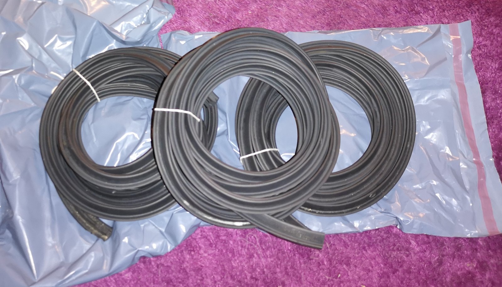

On the subject of comfort, the package which arrived yesterday was this...
Nice new old stock door seals. These probably won't be going on for a while yet though, probably after I've done any paintwork that's needed. They're glued on, so makes sense to leave them until after work that requires the seals to be removed is all done.

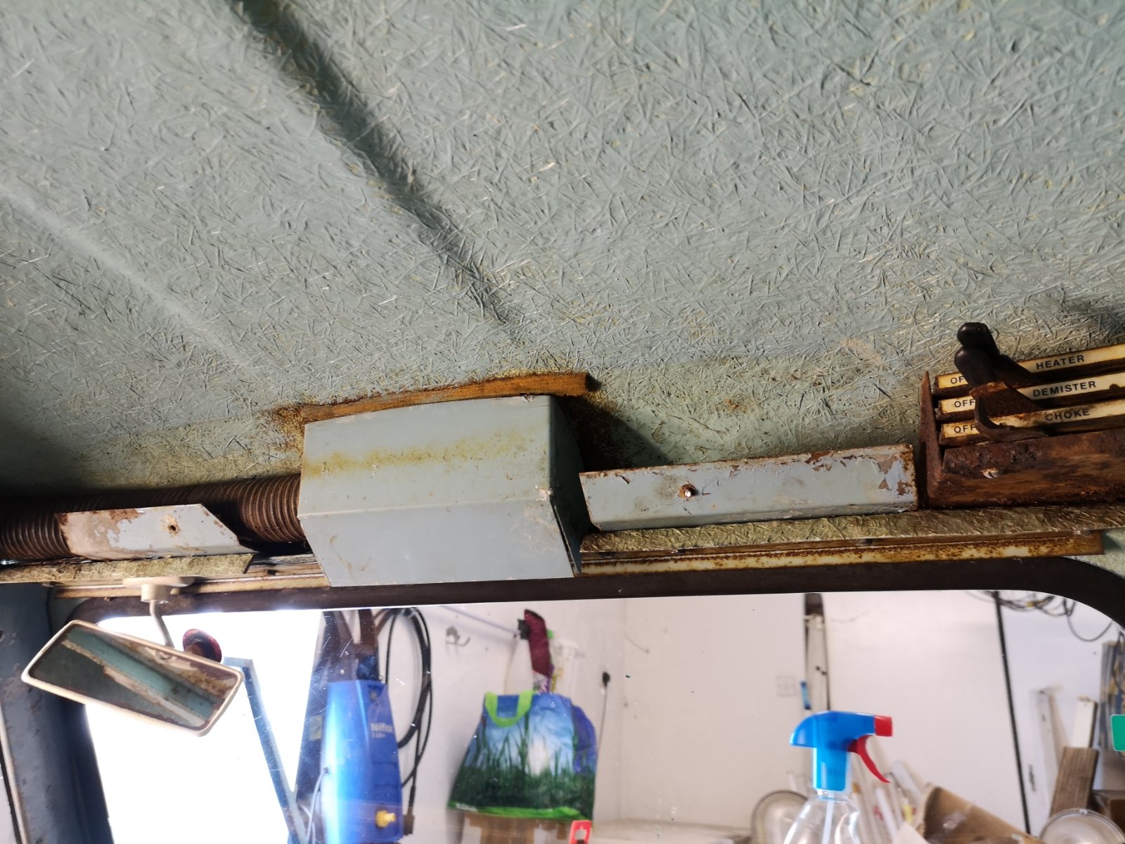

Just a quick update for today.

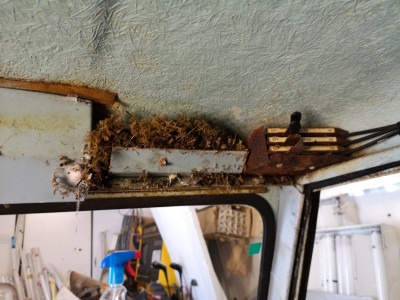

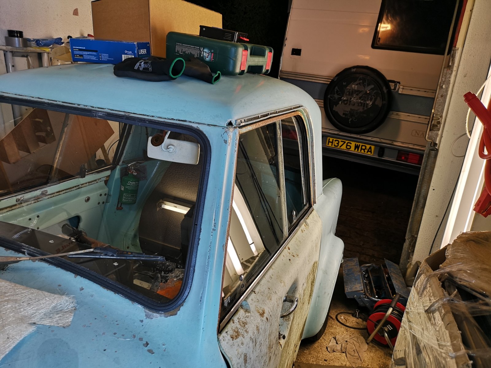

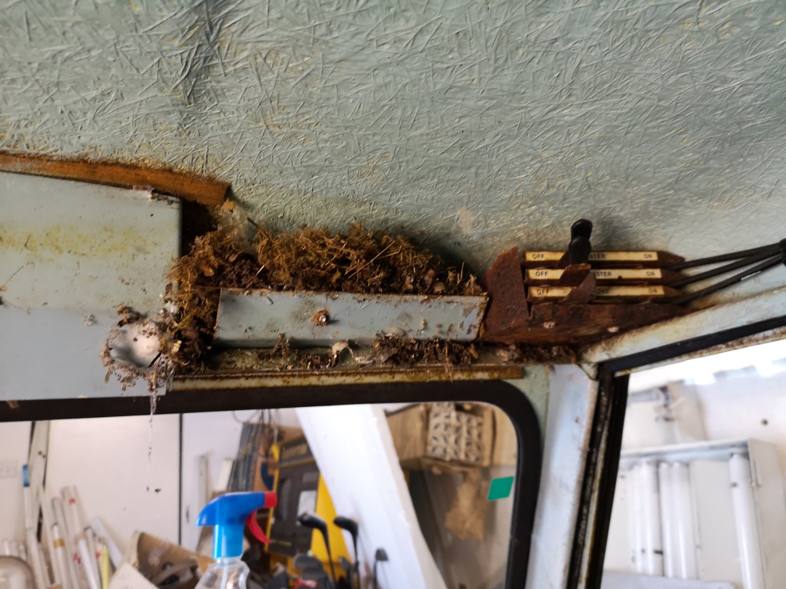

One of the relatively few places I'd seen evidence of water ingress in the van was from the holes left when the high level tail lights had been removed for some reason in the past. I do intented to refit these at some point, so just stuck some tape over it for now to keep the weather out.

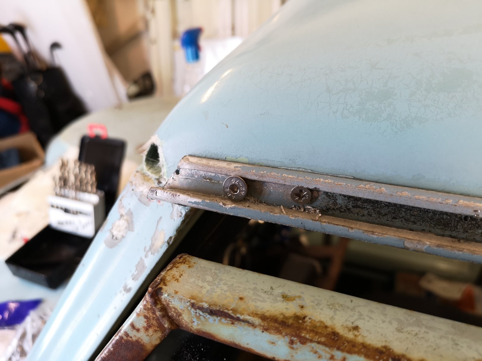

On the subject of weather proofing, I decided it was time to replace the mangled nearside gutter on the Invacar (which will also remove one of the pointy edges that Mr. MOT Tester would object to). Given that these stop rain water running from the roof into the door apeture, they're quite important in terms of weather proofing.
After drilling out another fifty or so (fine...six) screws, had the mangled old trim off and cleaned up the area ready for fitment of the new one.
Which is as far as I got with this job as it was at this point I discovered that I couldn't find the dispenser anywhere to lay a new bed ot sealant for the gutter. Of course being New Year's day nowhere is open so I couldn't just go and get a new one...Maybe a job for tomorrow then.
Somewhat ticked off at having to abandon that job halfway through instead I reverted to type and started cleaning things.

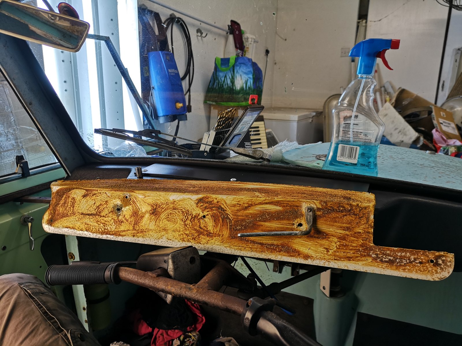

Windscreen had never been properly cleaned since I got the car and scrubbed up surprisingly well (especially given the battered state of most of the body).
Have also continued the rather slow process of removing the ingrained dirt from the inside of the doors. This is quite a slow process as they've been outside for years but I'm starting to get there.
Will see what totally random task I pick to work on tomorrow...

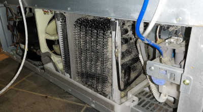

Looks like our fridge is back up and running. Still think the condenser is an utterly stupid design. This is obviously pre-clean...but you can see that thanks to it being essentially a cubular structure of finned tubing there's essentially no way to get what's trapped in there out without an industrial grade compressed air line. Why they couldn't just have used a "car radiator" style condenser like any commercial fridge would have I've no idea. That would take thirty seconds with the brush attachment on the vacuum cleaner, rather than this nonsense...
You also can't run it without the cover in place as it's an essential part of the air channeling and the airflow from the fan will totally bypass the condenser if the cover is off. Really service engineer friendly.
This was last cleared out (as best I could) probably three months ago. When I first checked it out when we moved in the entire condenser and about 2" to the right of it were a solid block of dust. This is all hidden behind a cover covered in dire warnings of what demons from the seventh circle of Hell will come and hunt you down if you remove it. Oh, if you've got the security Allen bits you need to remove it as well...nice design Samsung.
Ridiculous that a £2 component would likely have scrapped this in most houses. Yes, that's the offending relay sitting on the water dispenser.

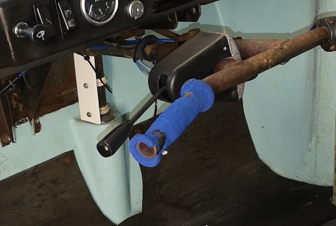

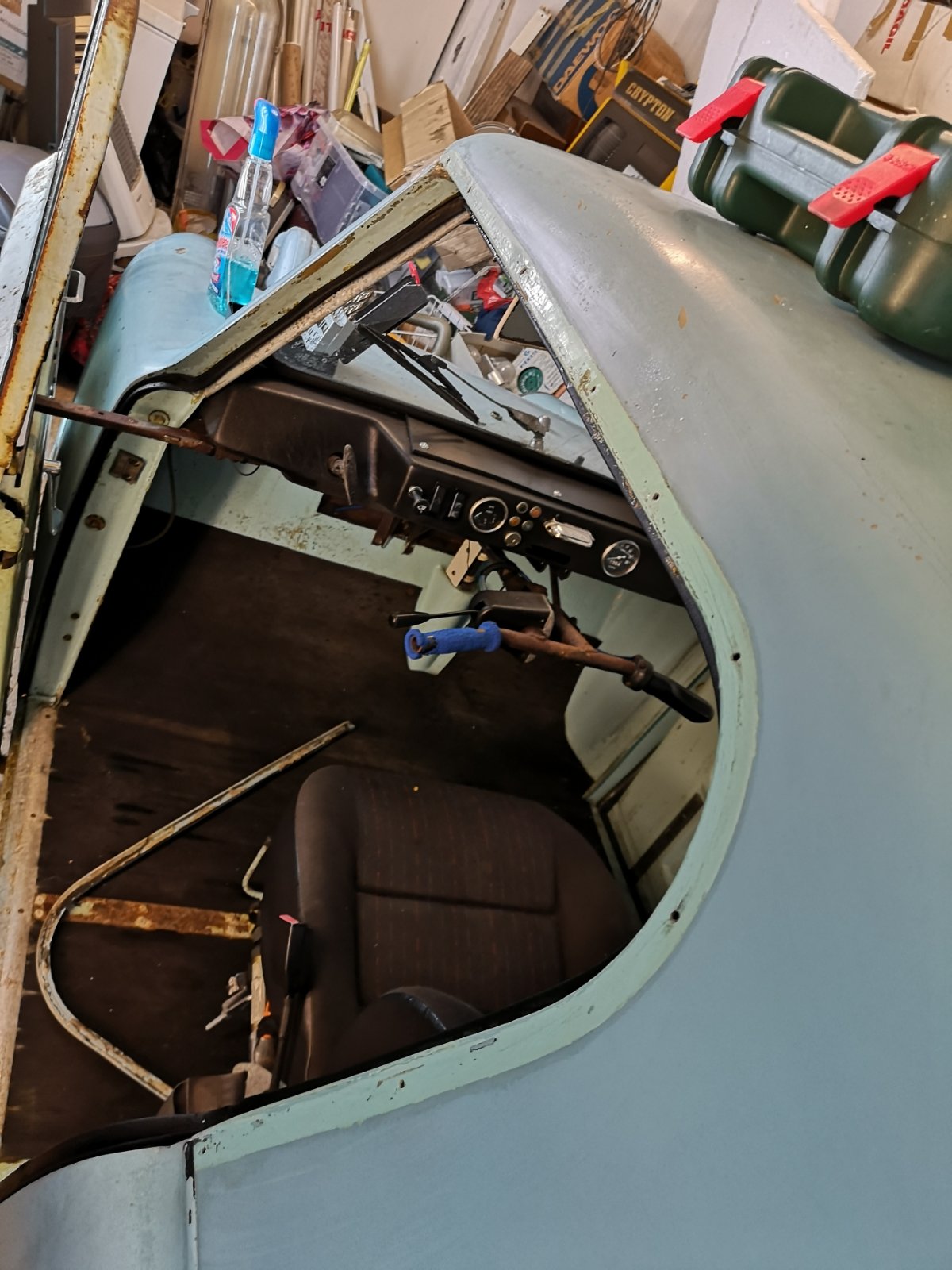

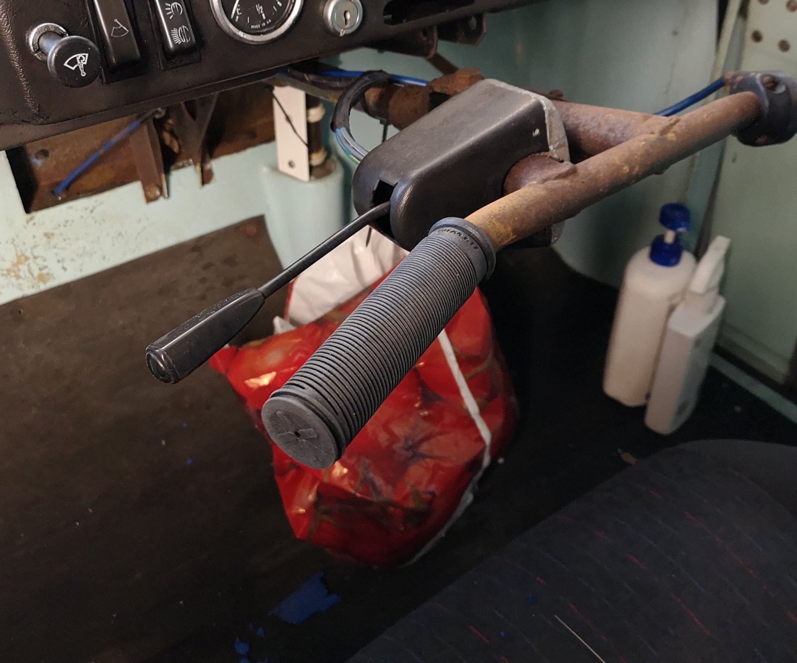

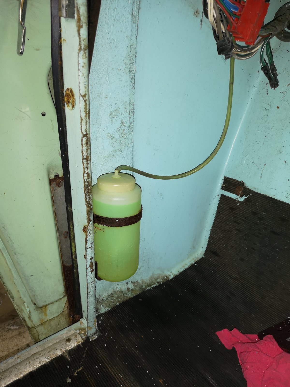

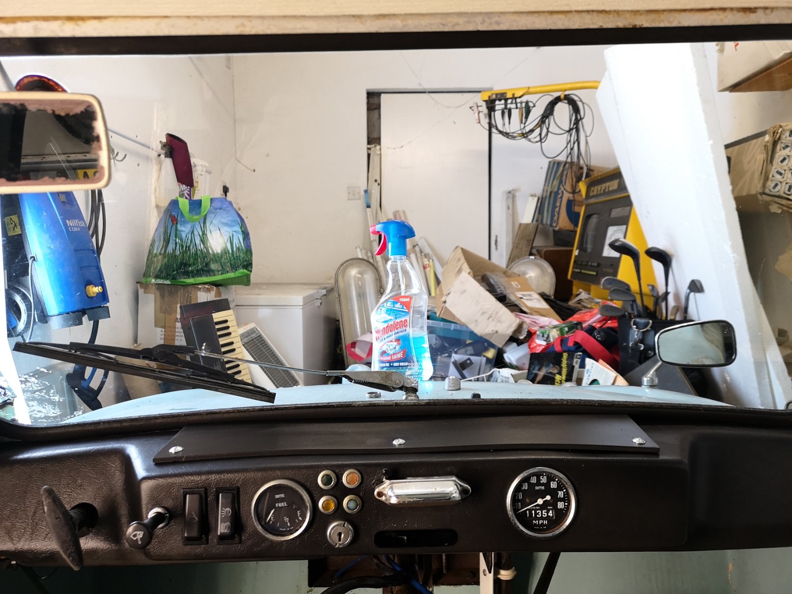

The windscreen washer bottle from the Invacar was given a darn good clean before being refitted. Some of the rust staining won't come off, but it's better than it was and internally it's clean and free of organic gunk waiting to clog up the works.
This was also one of the most annoying features of the car as it tended to shed bits of blue foam everywhere whenever you went near it.
Think you'll agree this is an improvement.
Thankfully the bars are the same size as normal bike bars so I was able to just grab a set from Decathlon rather than having to spend forever hunting down something obscure. A lick of paint is obviously on the list for the future as well, black hammered finish will be used so it matches the dash pretty well.
This seems to have made a disproportionately large difference to how much closer to a working vehicle it feels from in the driver's seat. The brain is a funny old thing!

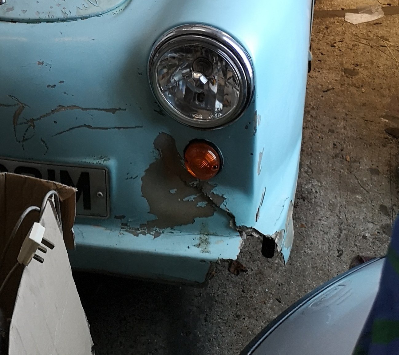

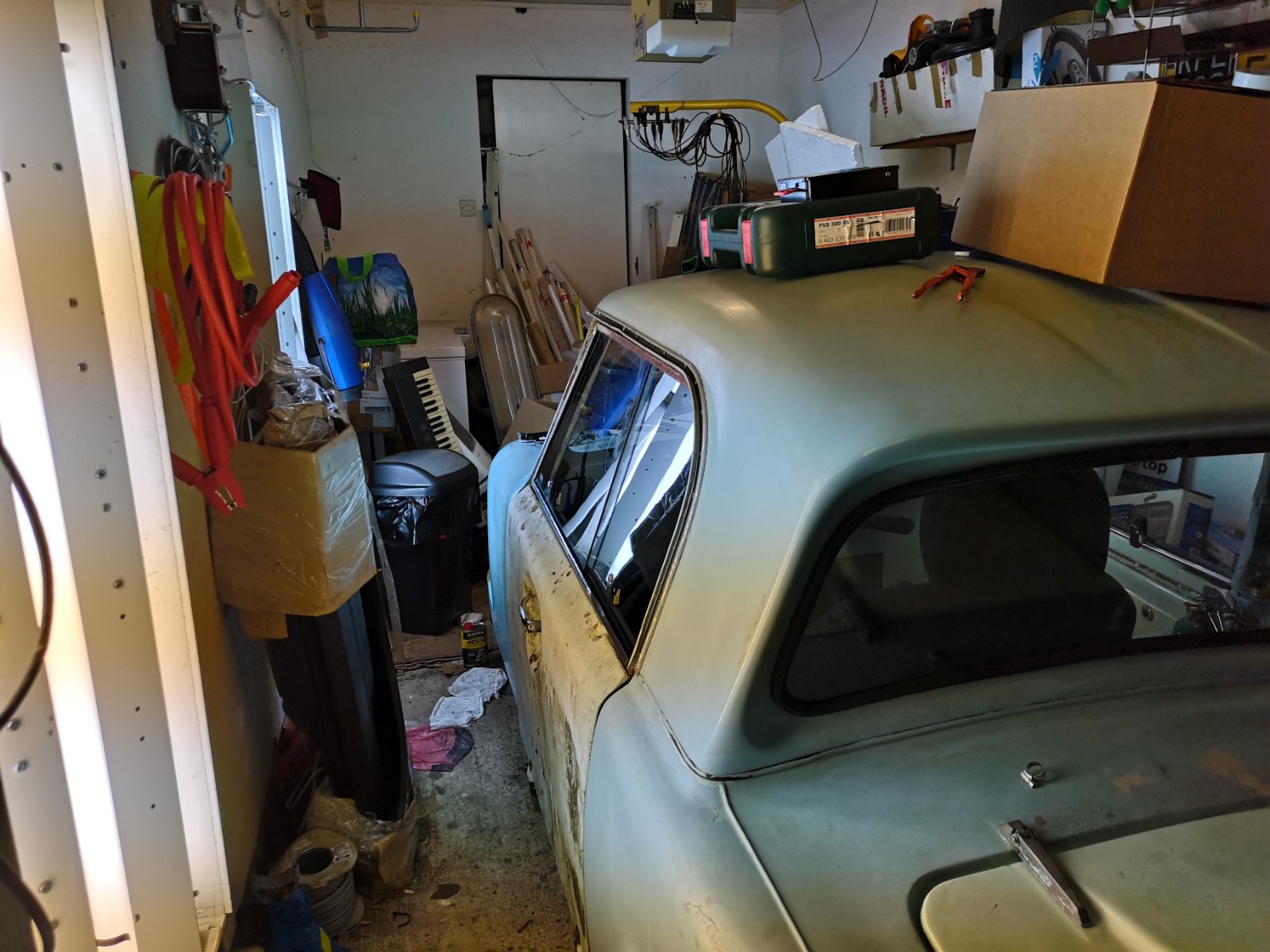

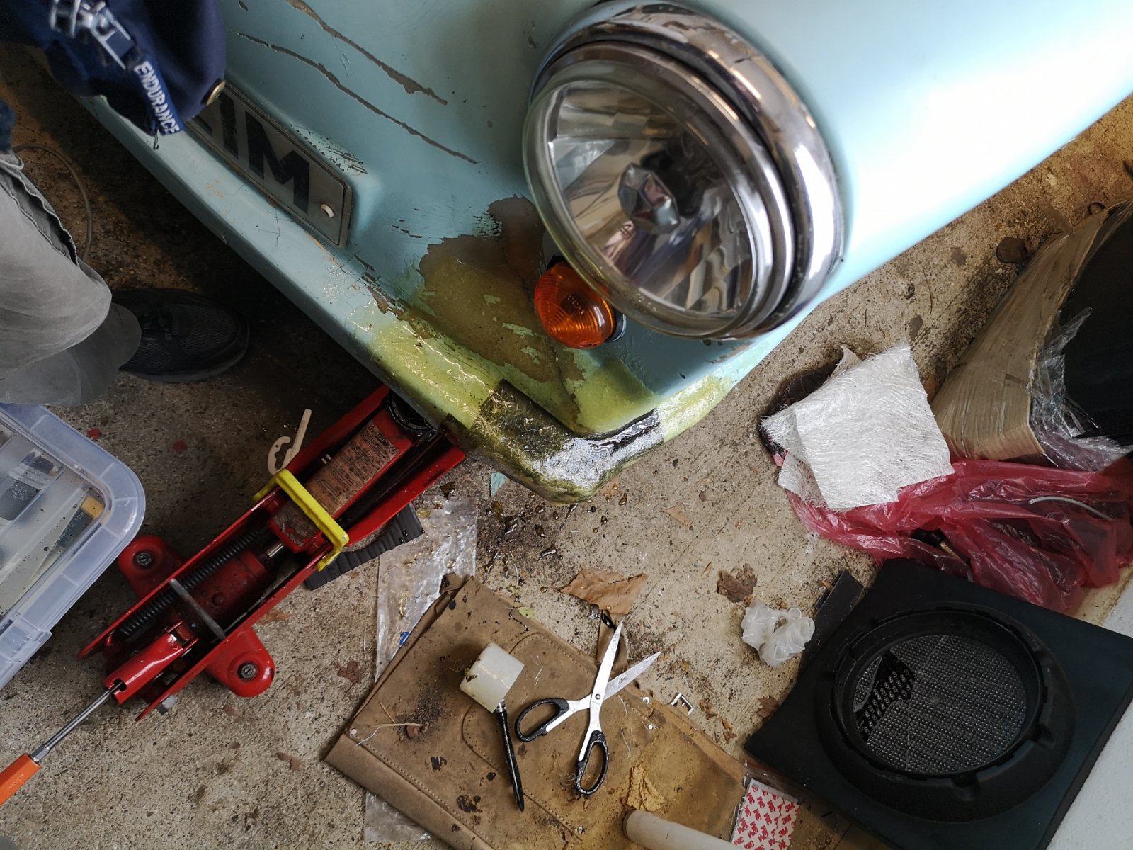

So we've made a start on the bodywork.
I've not done any real work with fibreglass like this before so it's an exercise in experimentation. Main target at this stage is "presentable at twenty paces and acceptable at the MOT.". I'm under no illusions that I won't wind up reworking this at some point in the future. Someone is currently looking at the possibility of making some moulds as well so it's entirely possible that repair sections may become available a year or two down the line too.
We started with this.
Which when I left the garage this evening looked like this.
Still scruffy by any standards, but scruffy is preferable to missing, so feels like progress.
Definitely reverting to the application method I've seen a friend using though (wetting the mat in a tray then applying that to the bodywork rather than holding the mat in place and "painting" over it) as doing it the way illustrated on the tin was a gigantic pain in the tail as the mat even when properly wetted through was far more interested in sticking to the brush than the bodywork.
Also highlighted how well insulated from the house our garage isn't. The whole house now stinks to high heaven of resin.

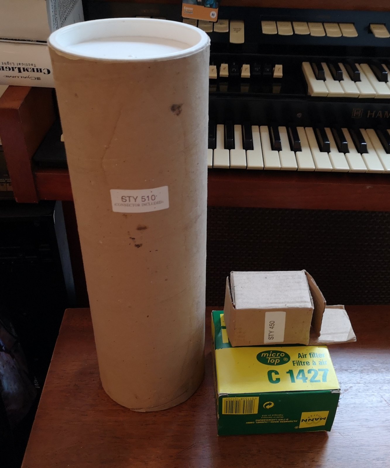

I've also got a fuel gauge sender, air filter element and a different type of fuel gauge (in case the sender is for a different type - at least three were used), so the tank should be pretty immediately ready to go in hopefully when it arrives. Will be dropping off the sender at the fabricator most likely so they can take measurements from it, they're less than an hour's drive away at least.

Simply put, the interior trim panel above the windscreen was really bugging me.
One of the screws did eventually relent and come undone with me hanging on the end of a really decent screwdriver. The other however just stripped the head. Fine...Out with the drill. As with most of the screws I've had to drill out on this car, it appeared to be made of titanium, but did eventually relent...and the panel came away. Showering me with the remains of a (thankfully vacant) mouse nest.
I feel slightly more vindicated for being determined to get it off now. Does explain why bits of finely atomised foam kept falling out from back there too. Five minutes with the vacuum cleaner dealt with that mess.
Unfortunately I can't get the windscreen demister vent assembly or the heater control box off as the bolts in question are 1/8" Whitworth...and I have a grand total of *one* spanner in that size - and I need two to get anything apart as the nuts used here are - as it seems with any on this car - aren't captive, so just start spinning as soon as you try to unbolt anything.
I want to get the heater control box off to clean and paint it, because it's horrible. I want to get the vent assembly out to confirm that it's not full of rodent nests and to properly seal it to ensure that as much air as possible actually finds its way onto the windscreen where it's needed.
My plan for the panel itself is - once I've figured out how to remove the remains of the adhesive...
...Will be to give it a nice coat of black hammered finish paint. I reckon that should look like it had left the factory that way. Will be interesting to see if I can find anything that will dissolve that adhesive, failing that I reckon five minutes with the carbide polishing mop on the grinder will sort it.
Annoyingly the bolts I'd planned to sort the gutter with are no good. The heads are too big to fit in the channel.
Fine, I'll run by Screwfix tomorrow and pick up something more sensibly sized.
Glad to report that a little package of goodies arrived this morning.
This contains a fuel gauge sender unit, a new air filter (finally!) and one of the later style Curtis/Veglia fuel gauges. So irrespective of which variant of gauge sender I've got I should be able to make it work.
Plenty to be keeping me busy!
