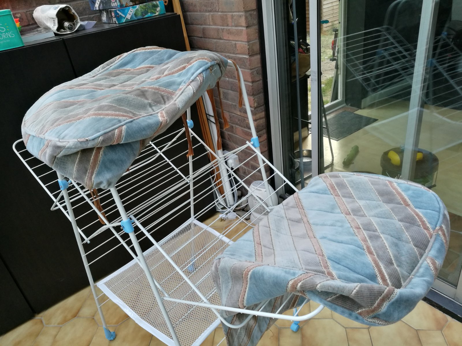

Discovered yesterday that the seats in the cab of the Merc aren't actually velour... they're covers. Just very convincing covers. Bonus of this is that they can easily removed to be cleaned. Especially given that the driver's seat was quite grubby.
Quite visible how much they've faded, though after 28 years you can't complain!
Removing the cover revealed the sort of plaid pattern with such colour clash as could only come out of a German carmaker in the 80s.

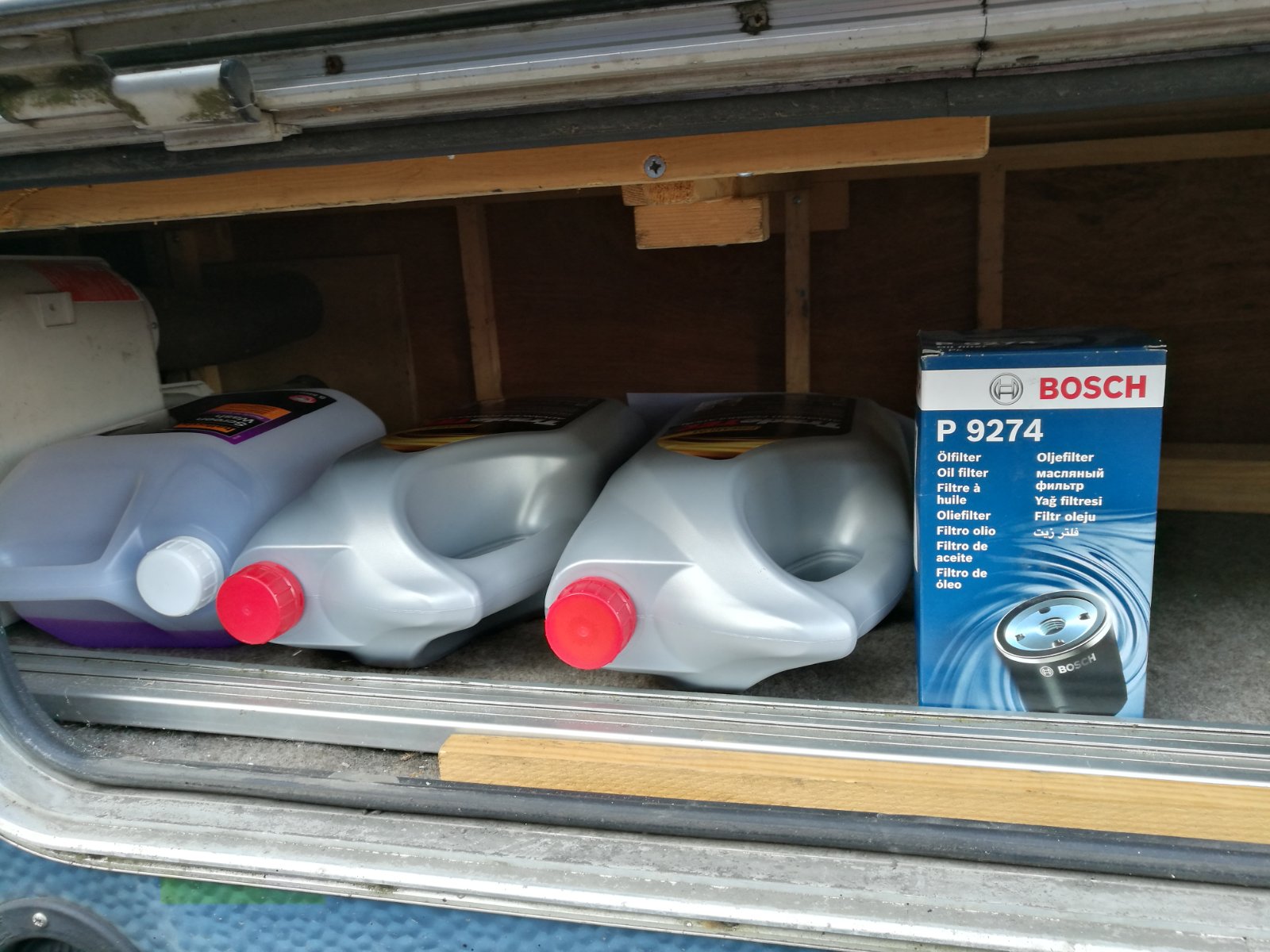

Also picked up some oil and a filter so it can get a service soon.

Seat covers look to have survived their wash...looks to have removed a good chunk of the grime, and at a glance the colours look a bit more vibrant.
Will see if there's a visible difference once it's back in the van.

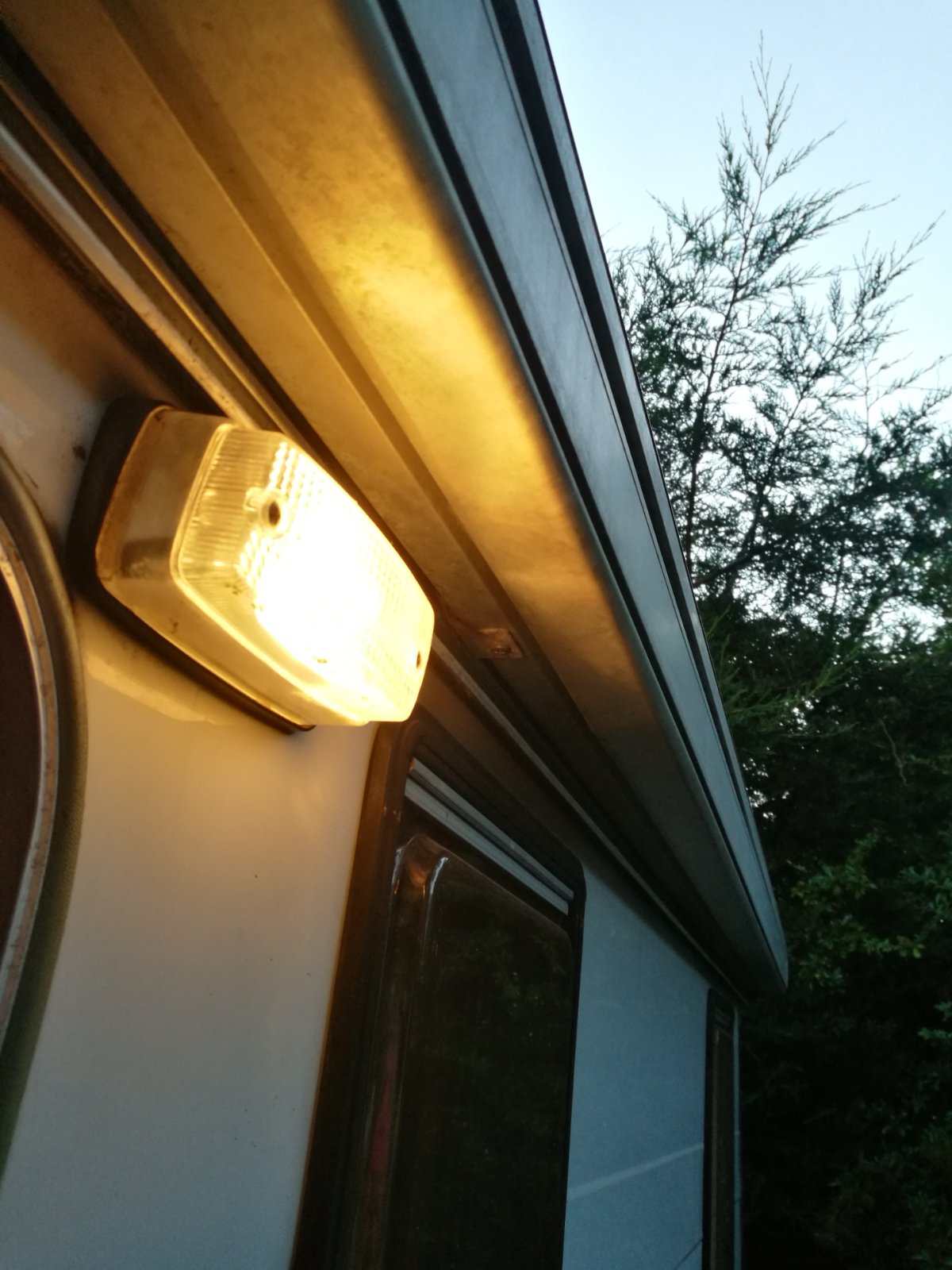

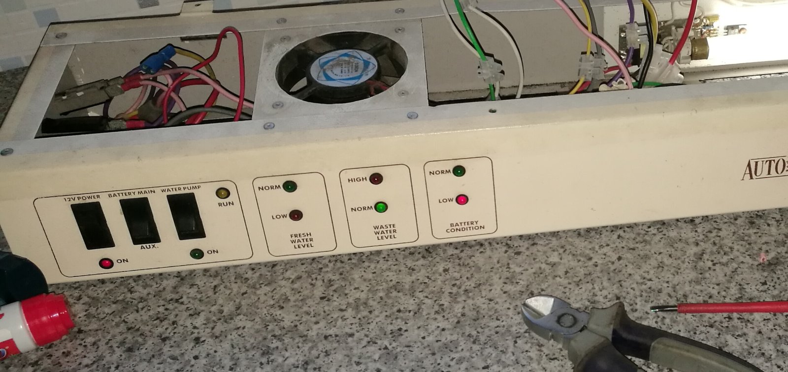

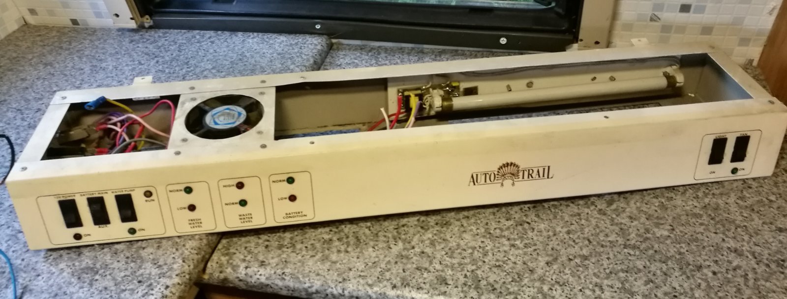

I noticed while out today that the nearside front indicator wasn't working. This was quickly traced to the fact that the lampholder was rolling around in the inner wing, lighting up the engine bay rather than the indicator. Solved by stuffing it back into the lamp housing where it belonged. Have also noticed that the wing repeater on the offside isn't working - it's taped up though due to a cracked lens so is a task for another day. Also need to poke the internet to see if I can find a replacement lens.

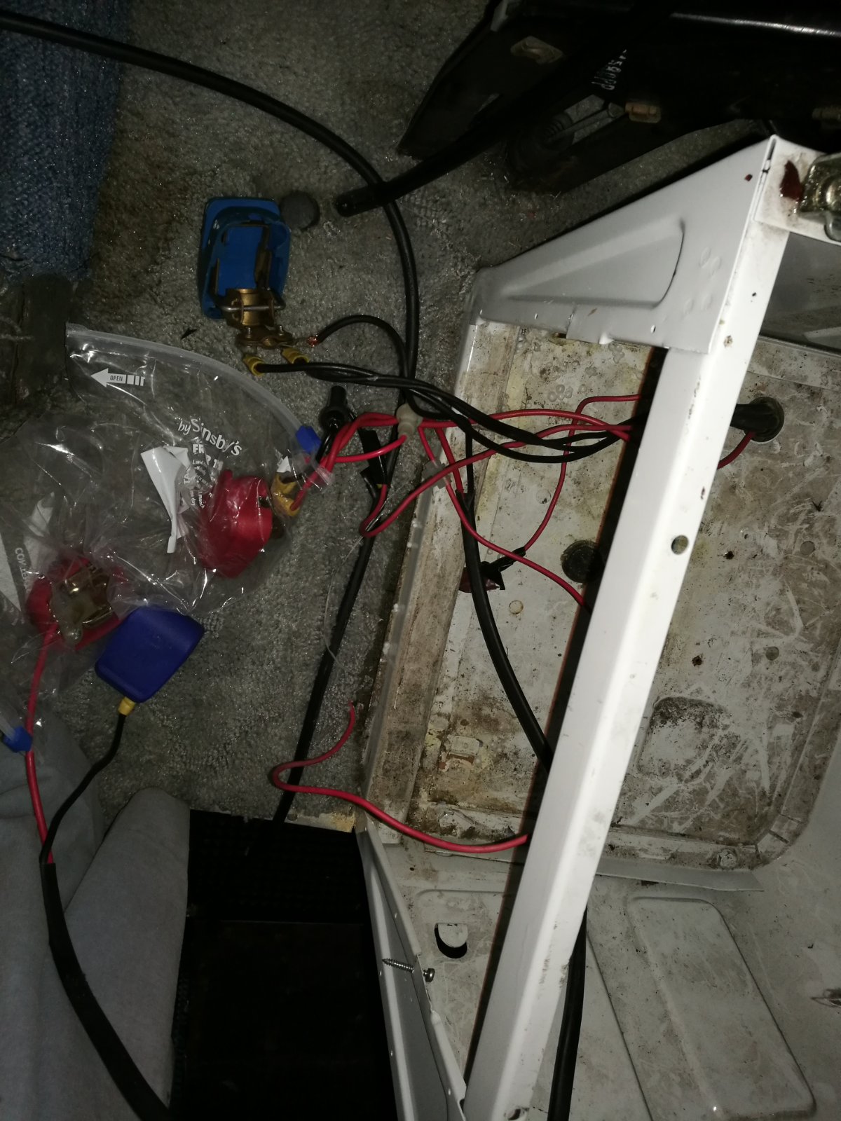

In a random moment of "hey, there's a hinge there, I wonder what's under it..." I stumbled across the electrical nerve centre.
Oh... it's been got at too...
No surprises there then. Seems my decision not to let it anywhere near mains power any time soon was wise. The random wire heading out of the fuse box I reckon would be the feed to the fridge (it's about the only thing using mains).
I'm still missing a huge chunk of DC wiring though. I've found one bundle of chopped wires in the corner of the kitchen, but have yet to work out where on earth the other end originally connected to!
If we do wind up keeping it longer term, I reckon a modern battery management system will be invested in, so the leisure battery is automatically kept topped up whenever either the engine is running or the mains hookup is connected.

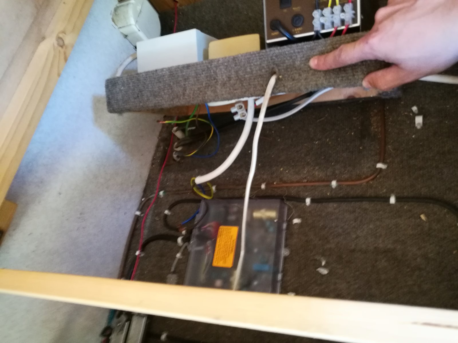

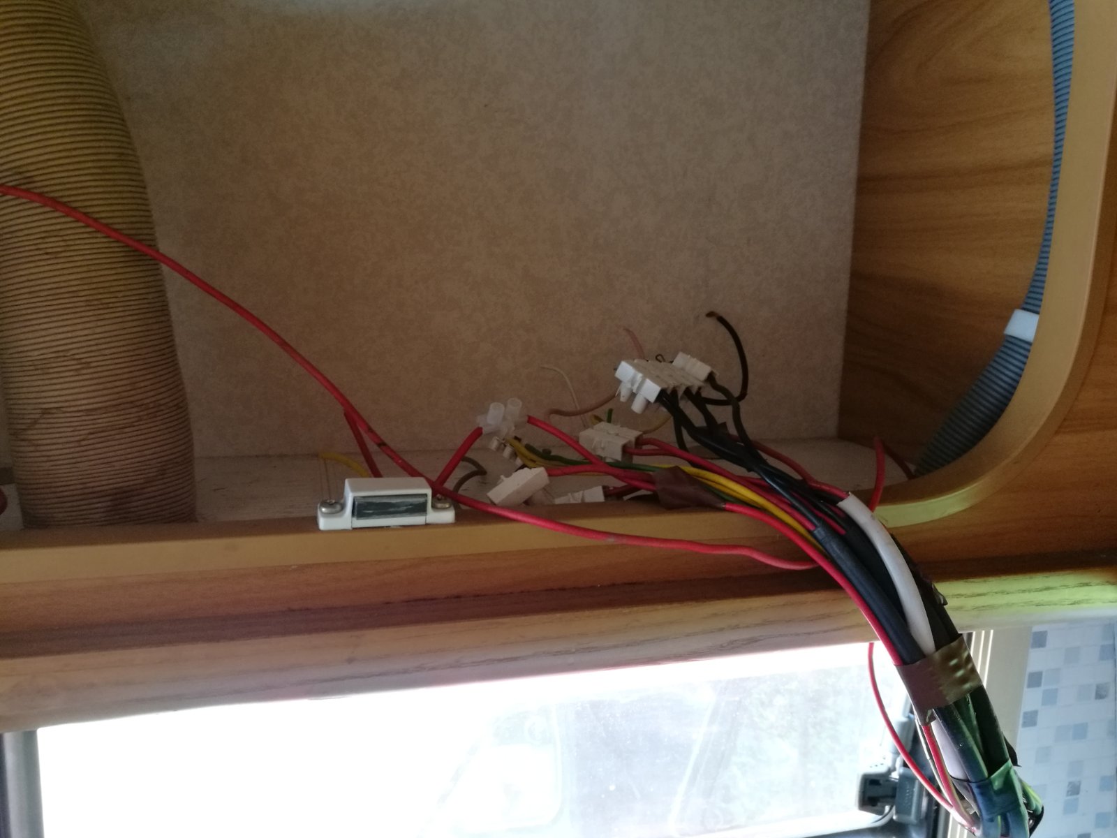

The bundle of spaghetti dangling out of the ceiling was bugging me, and I was bored. So decided to go see if I could make any sense of it.

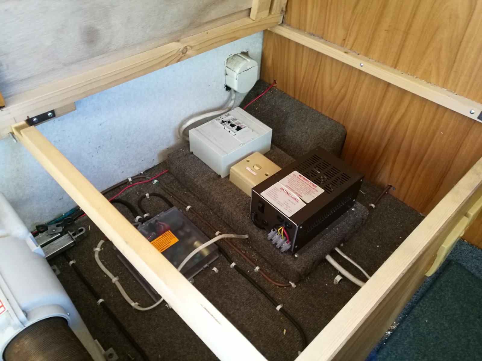

While rummaging around in the rear locker, I decided to pull out the extractor hood that was stored in there, cue discovering a major bit of information I'd been missing.
This ain't no ordinary cooker hood...
It also happens to contain the main control system for all the DC electrical stuff in the living area. The reason I'd not been able to find the other wires that connected to that lot is there weren't any - it was a control panel I was missing.
Cue a quick rewiring session (once everything's working I'll go back and use crimps and heat shrink) to reconnect it to the vehicle.
Hey look, life!

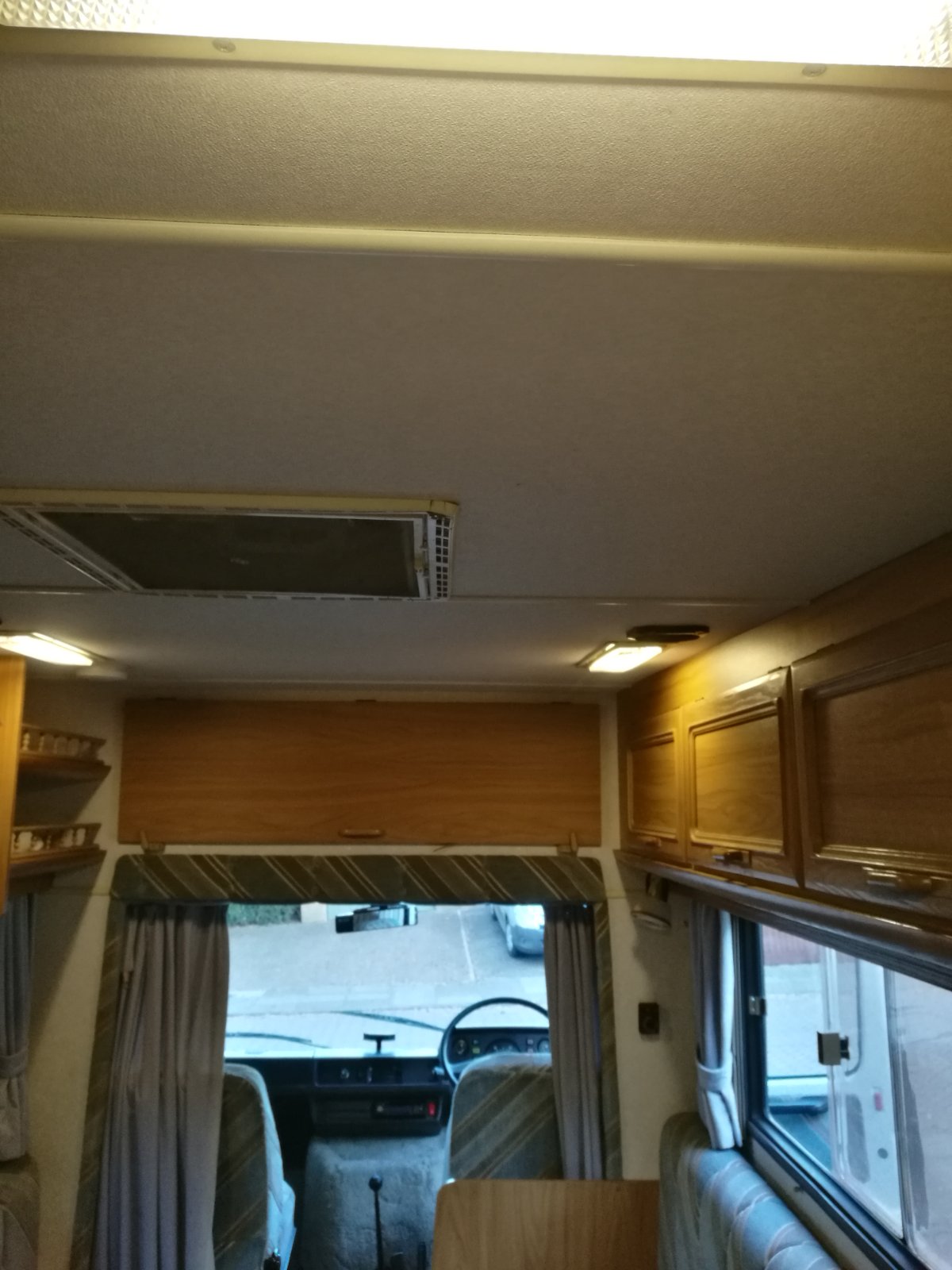

Let's see what else works now...

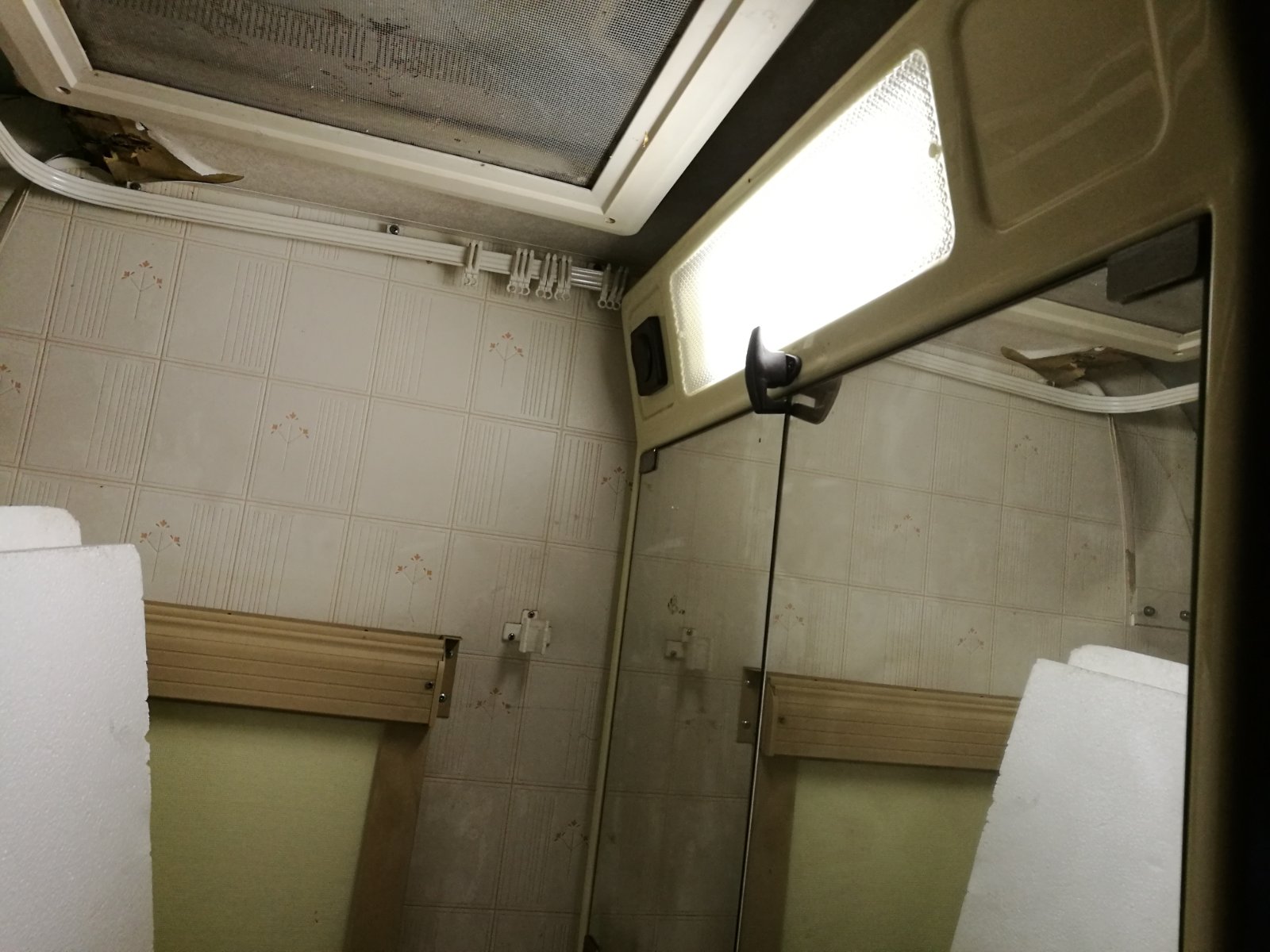

Main saloon lights...
The light outside the side door...
Bathroom lighting...once I'd forced my way far enough in to reach the switch anyway...
Heater...
Fan runs at least...the heating bit I can't really test until I have a gas supply, that was also crudely hacked off so needs to be remade.
Also proved the water pump runs and the TV works.
I couldn't initially get it to work off the aux battery though. Working on a hunch I returned my attention to the one random red wire that had obviously been added after the van left the factory. I swapped that out for the original aux battery feed, and suddenly it would work off either the vehicle or aux battery. Lovely!
So it seems there's a break in the original wiring, I'll investigate that further later on.
The rat's nest under the driver's seat stalled play though. It looks like the original aux battery harness has suffered from some rewiring at some point. Sadly said wiring looks to have been done by Homer Simpson...I ended up having to disconnect everything I found there just to convince myself that the van wouldn't spontaneously combust overnight.
They appear to have at some point needed to add more live lines at some point, but didn't have space on the original wiring, which is also awkwardly short. The solution? Daisy chain battery terminals! Just leave the original pair floating around in the (metal) battery box, still connected, they'll be fine, surely?
Plastic bags added by me to stop things shorting out while I tried to make sense of the mess.
Yeah...I didn't have time to rewire that lot tonight, but unceremoniously snipped the positive lines all off and terminated them in some screw terminals (which I then also stuffed in a ziplock bag) so they're safe and won't cause any issues until I can sort it out. Not sure what the mystery red wire emerging from the floor is yet either, that wasn't connected to anything when I started out, it was just dangling in mid air.
Seriously, if you don't know what you're doing with electrical stuff... don't go there!
Hey look, life!
Heater...
