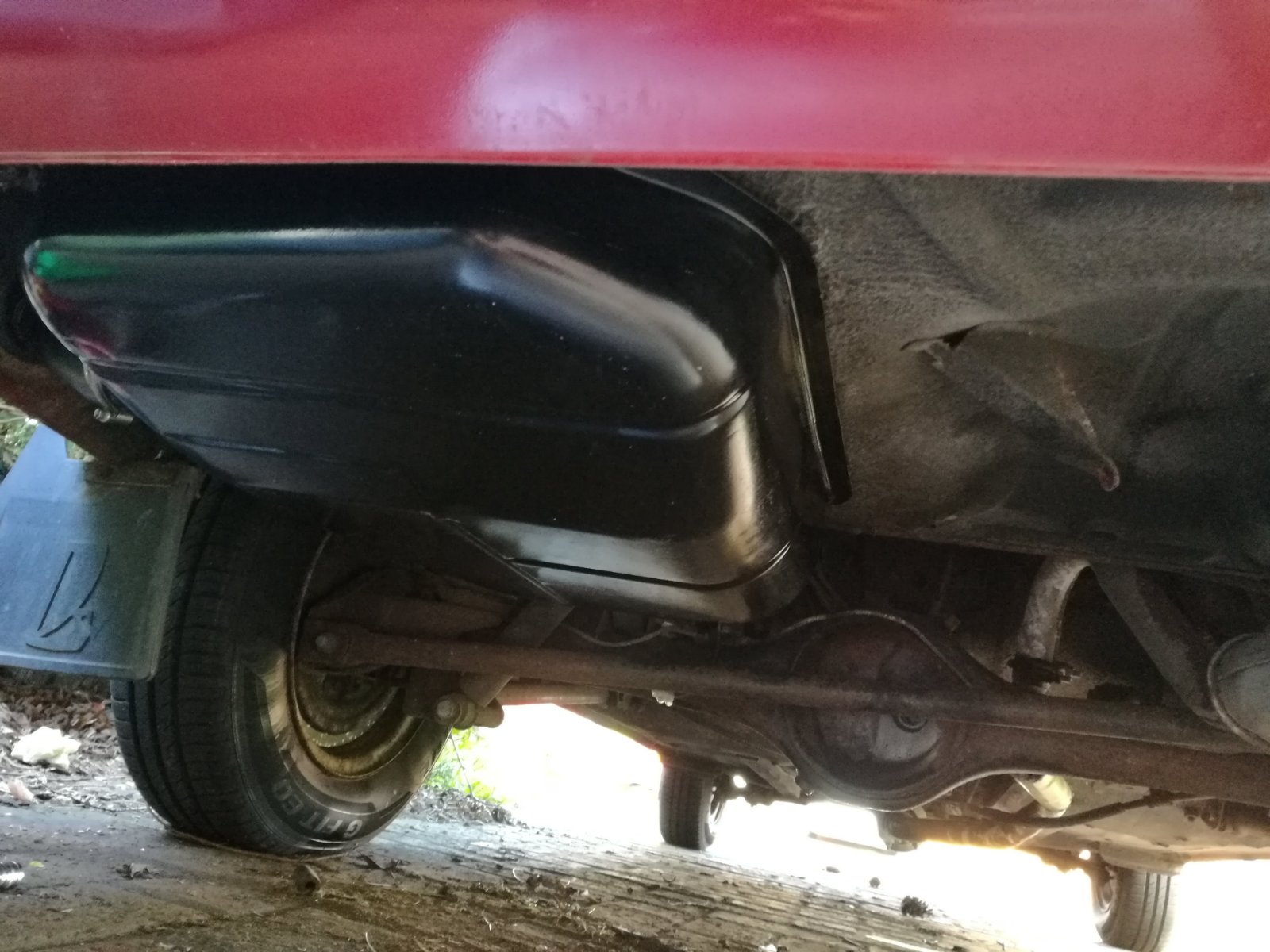

Today's task - swap the fuel tank out for the injection spec one with the internal pump.
Rough sequence of events...
[] Drain down the tank. It was already showing as near empty (light just about on), so I grabbed a fuel can, pulled the feed line off the throttle body and stuck a jumper wire into the socket for the fuel pump relay.
The fuel gauge lies...there was nearly 20 litres of fuel left in there!

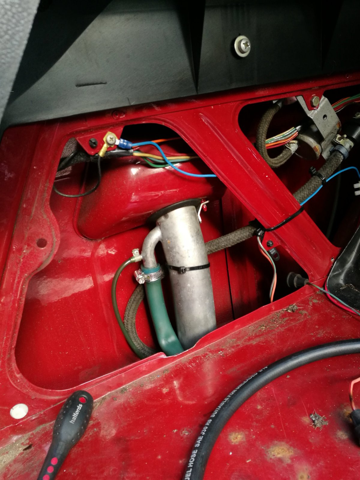

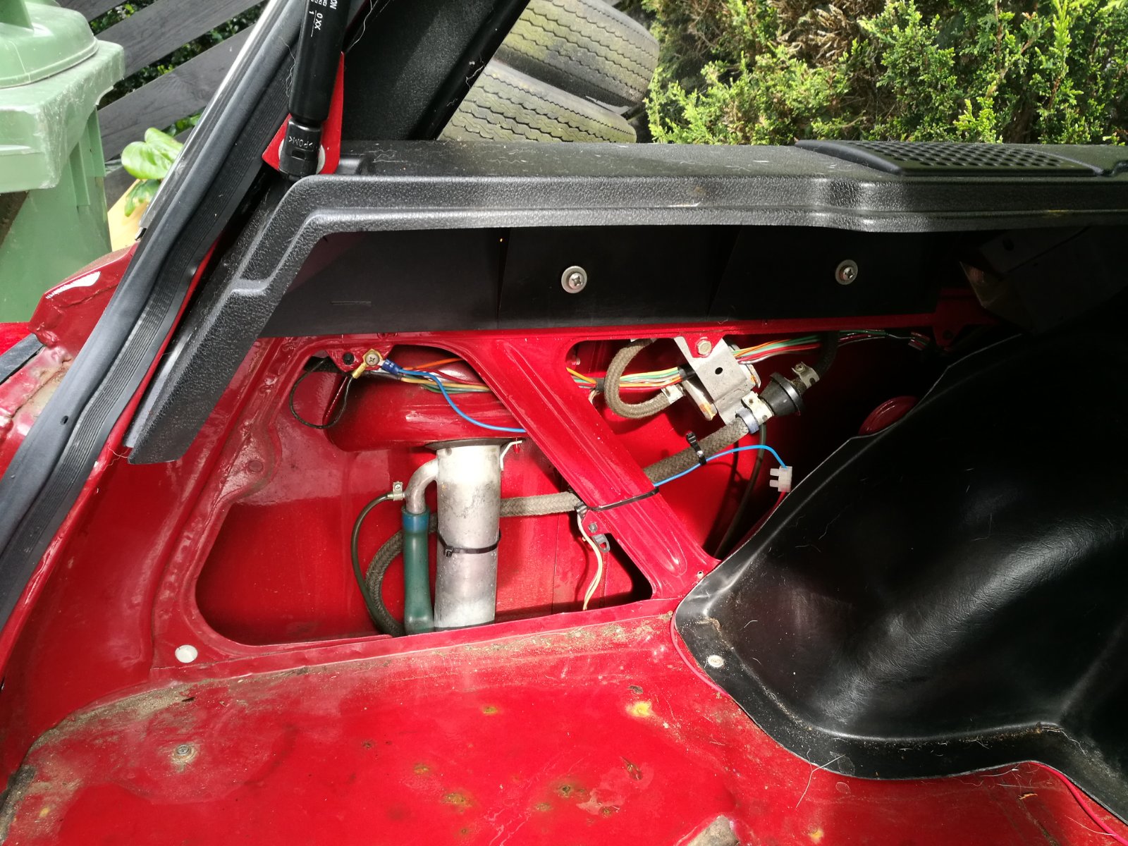

[] The side trim panel in the boot is only held on by a couple of screws. This hides possibly the most convoluted tank breather system I've ever seen.
The large blue hose goes to the top of the tank, so I pulled it off here so it wouldn't impede removal of the tank. Sure there should have been a hose clip on there, no sign of there ever having been one though...not that this necessarily means anything on a Lada!

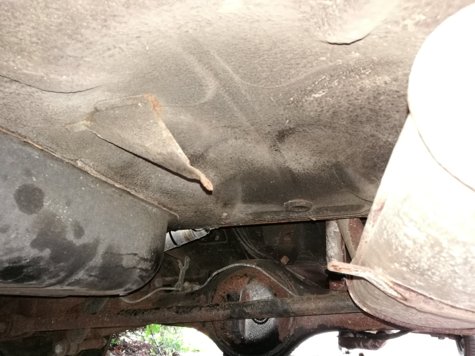

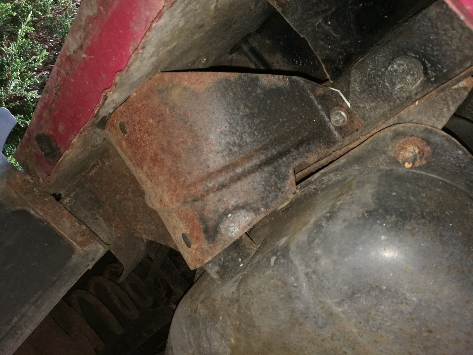

[] The filler neck to tank connection is behind a guard plate that's thick enough you could probably jack the car up with it...
There's a trio of bolts holding it on, one visible here and a pair in the wheel arch. Once it's removed you have easy access to the filler neck.
Interestingly I think someone has been in here before, one of the rubber sections has a VW/Audi logo on it. The later cars did away with the rigid section in the middle, instead using a longer bit of tube on the tank and a single piece rubber flex joint - so this whole lot had to come off.

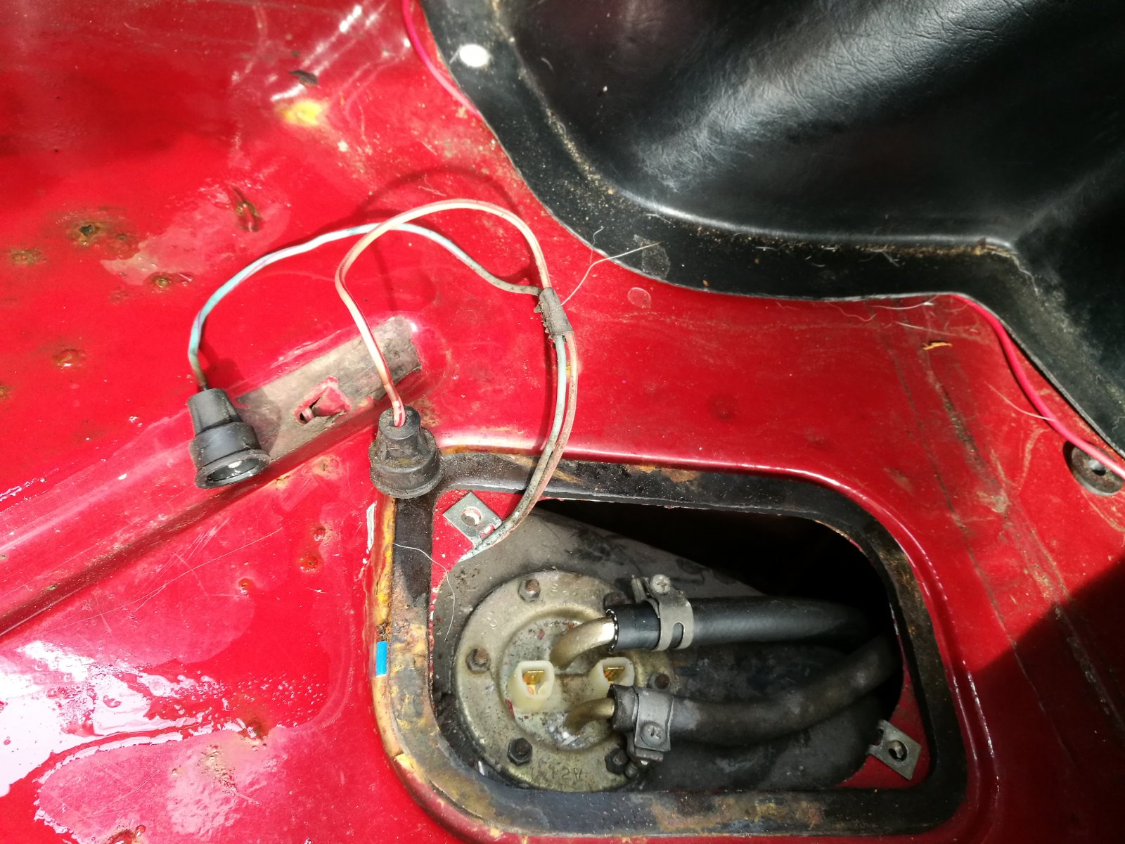

[] Last thing to do was to disconnect the fuel gauge and fuel lines from the top of the tank, there's a little access panel allowing access to this through the boot floor.
Once that's all done, a 13mm but and a couple of washers at each corner are all that holds the tank in (no straps to faff about with!), and once they were removed it smoothly dropped out. There's just enough friction from the filler neck even with the clips loosened that it slowly and smoothly lowered to the ground.

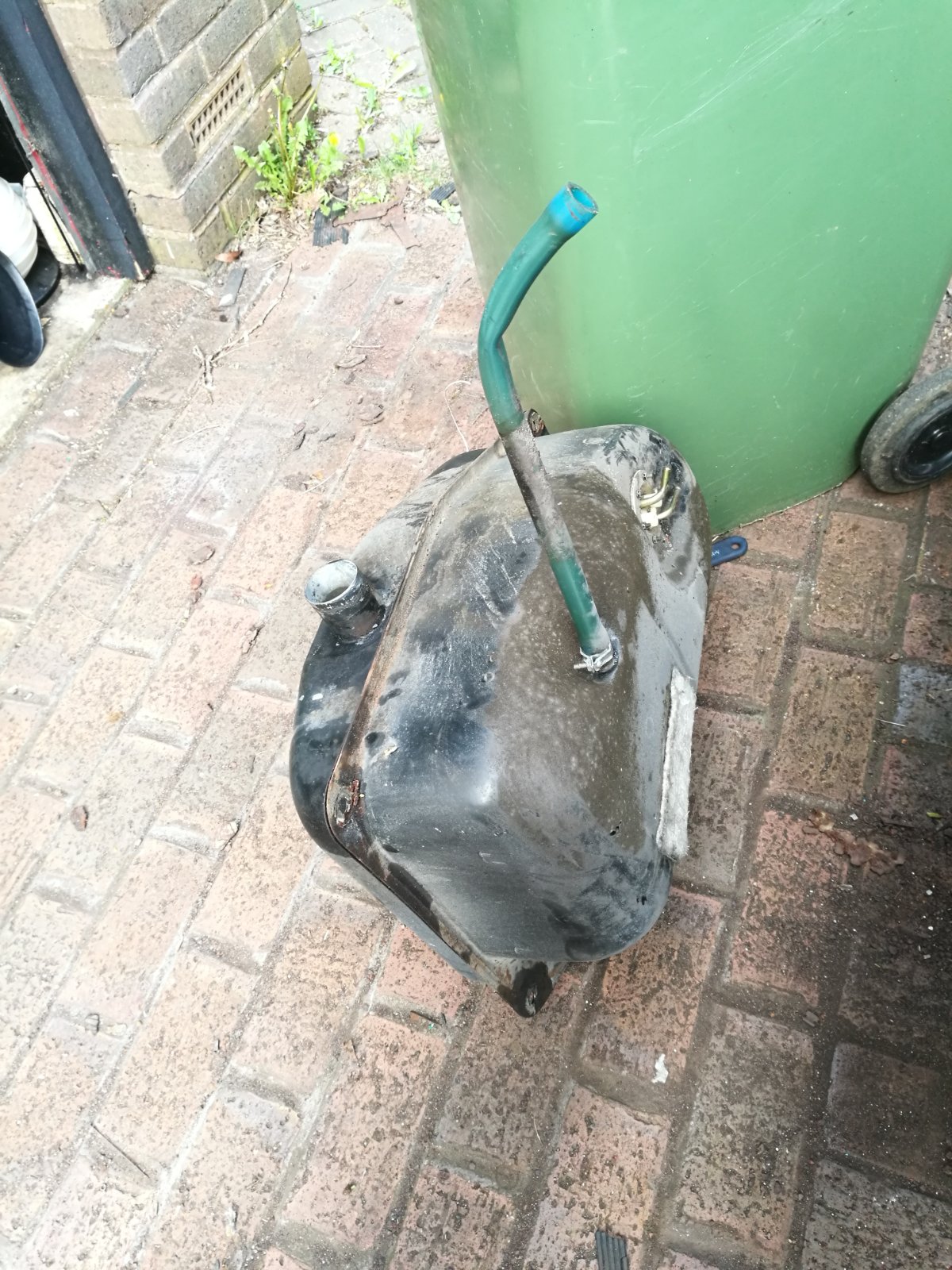

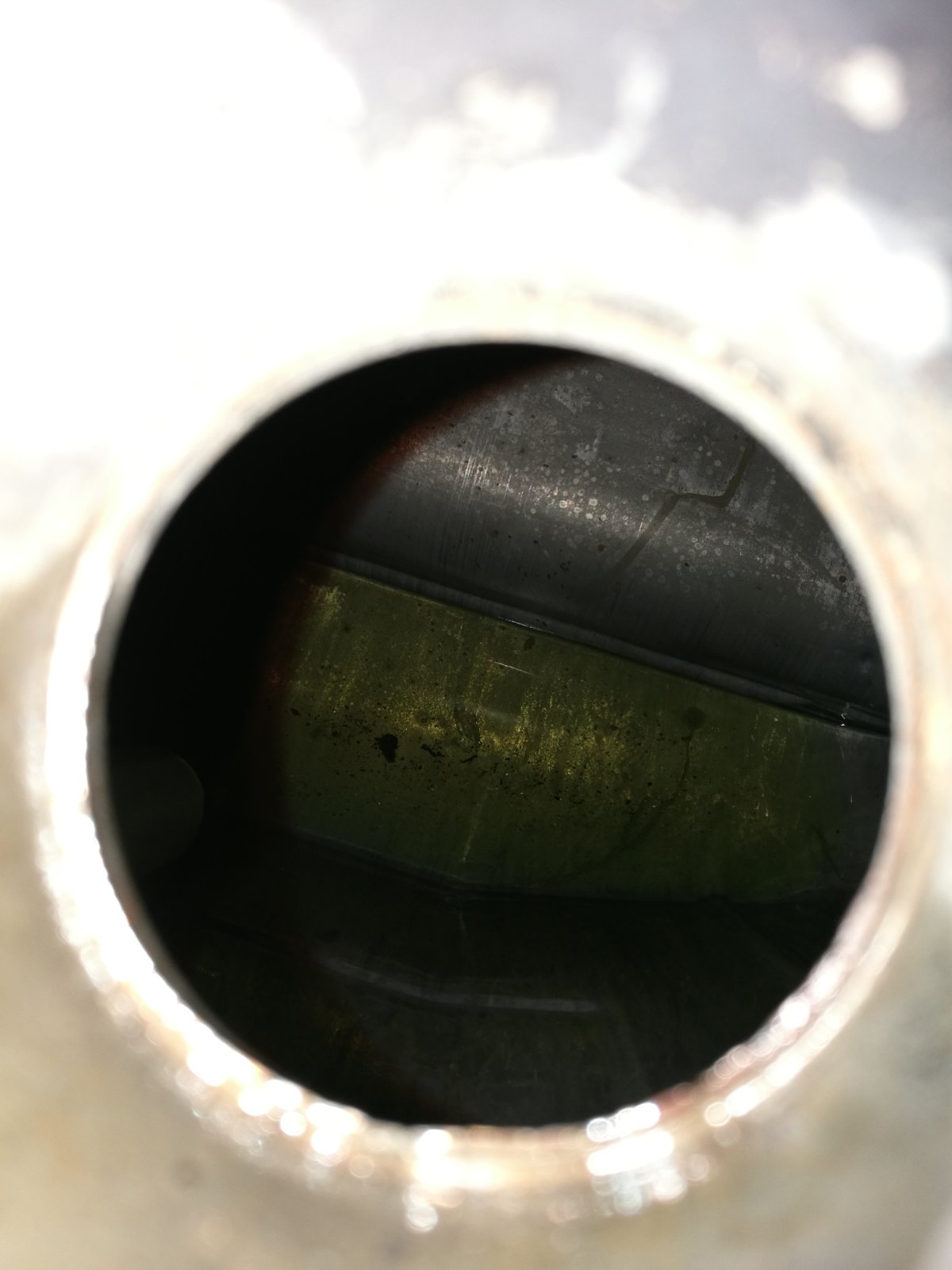

Not looking bad in here for a tank from 1993.
This will definitely be kept as a spare or offered to someone who's needing one as aside from a little external grime, it's in fine shape.
The breather is that odd hard but slightly flexible plastic that always seems to be found somewhere on cars from the Communist countries (Skoda used it for the crankcase breather on the Estelle), it's really odd stuff.
The kink in that I reckon goes a long way to explain why it was impossible to fill the tank at a sensible rate - I'll see if I can get a spring inserted in the pipe to stop it doing that where it does a 90 degree bend in the wing.
I took the opportunity at this point to also pull out the massively over-long fuel pump wiring, the temporary fuel pump and associated plumbing. The tank being out the way made it a lot easier.

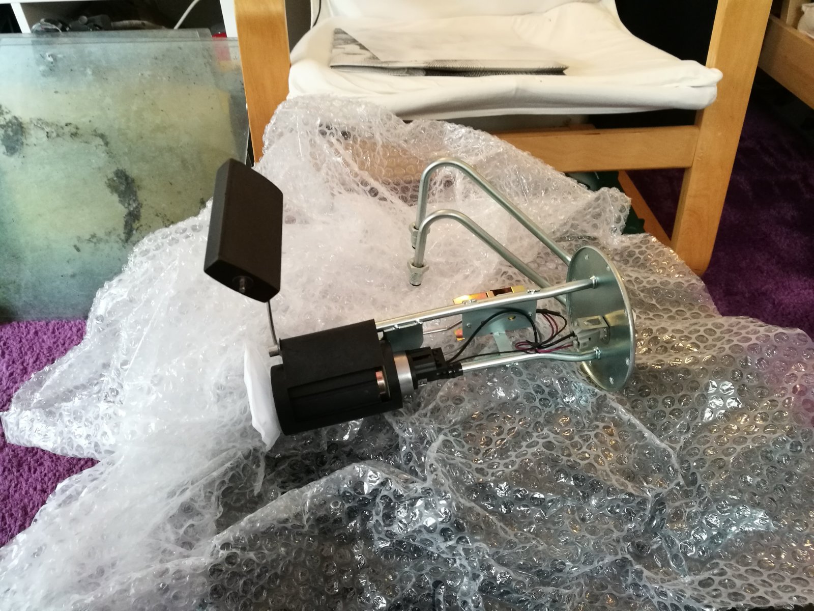

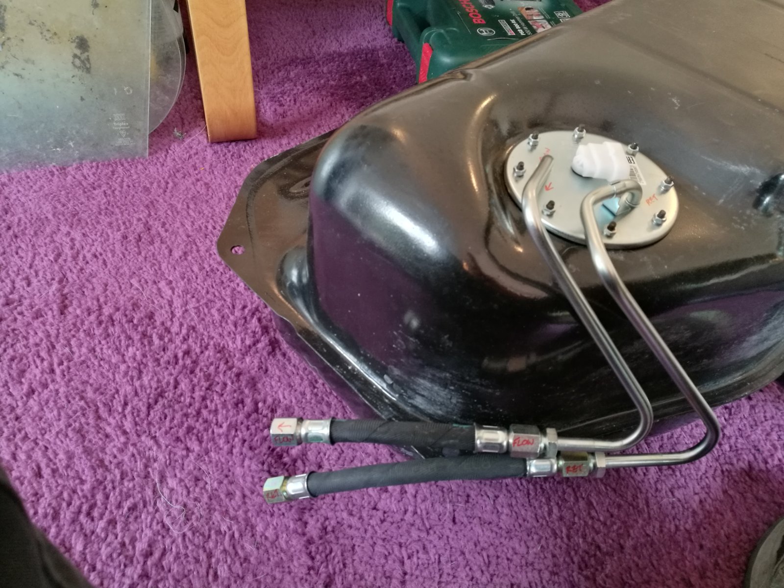

[] New fuel pump unwrapped...
[] ...Then fitted to the new tank, the relevant flexible hoses attached, and labelled...as I know otherwise I'd wind up forgetting which was which while crawling around under the car.

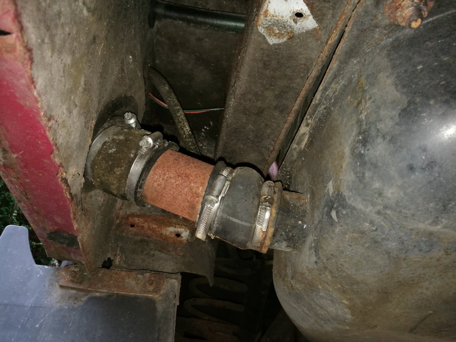

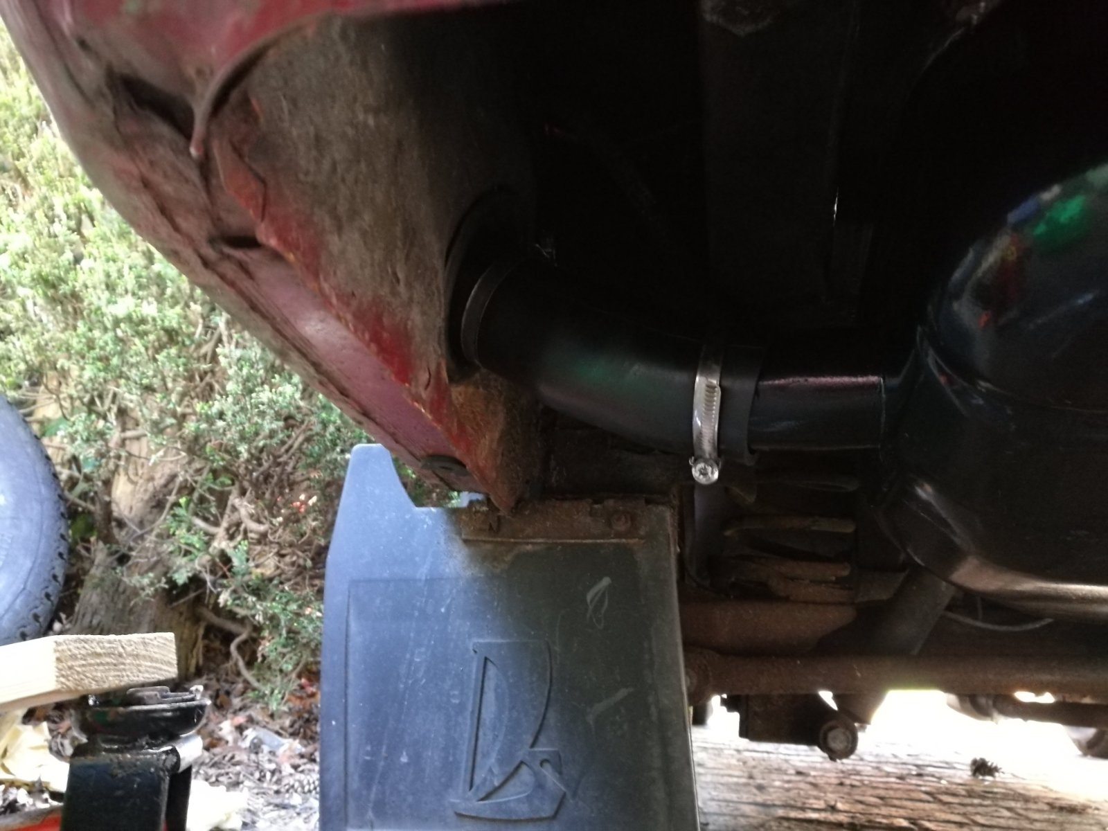

So I left the Lada with the new fuel tank half hanging out the back end of it propped up by an empty fuel can. Less than ideal.
I spent about half an hour today fighting with various different configurations until eventually giving in and sticking the original kinked breather hose back in place (figure I'll cut it in the future and stick a metal elbow in), as at least I knew that was the right shape! It only took another hour or so of swearing at it until I eventually managed to get both the breather and the filler neck to behave and let me slot the tank properly into place.
Filler neck hose clips put in place...
...I definitely reckon that the older style three-piece joint here is *far* easier to work with. I really hope the rubber piece there is made of better stuff than the similar part I bought for my VW T25 a few years ago which turned to powder after about six months.
I did however stick a hose clip on the breather hose inside the car. Hoping that this resolves the occasional stink of petrol in the cabin on hot days...as I honestly don't know where else it can be coming from.
Connecting the lines up was downright child's play compared to trying to convince the breather hose to go where it belonged...Let's hope I'm still saying that when I've got the pump running! Haven't bothered with the cable ties yet (to keep them clear of the brake bias control actuator rod and the nearside shock absorber), want to make sure we don't have any leaks first.

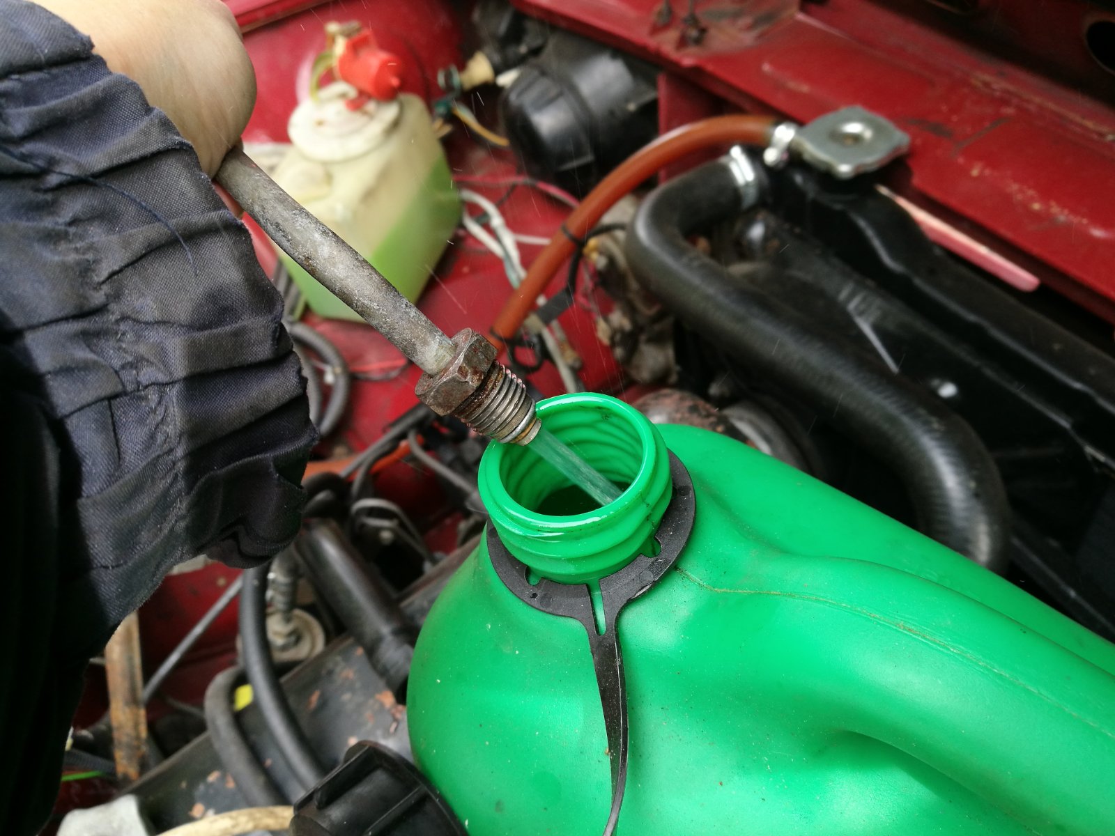

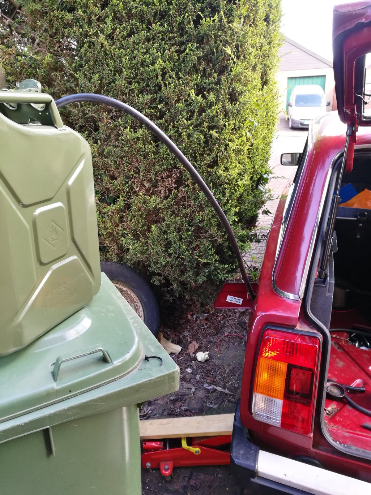

Then discovered one slight hiccup when I came to put the petrol back in it...in that I couldn't track down the spout to the fuel can.
Not one to be discouraged I improvised.
Worked like a charm...even managed to avoid getting a mouth full of petrol this time!
No leaks from the filler (thank goodness) in evidence at least with about 20 litres of fuel in. I'll need to figure out the connections to the fuel pump and sender tomorrow, tidy stuff up in the engine bay a bit, then hopefully wind up with a car that still works at the end of the day...
Actual technical difficulty of that job? At worse a 2/10. Sheer awkwardness: 8/10.
What a faff that was for such a simple job...If only the breather was accessible with the tank in place it would have been child's play.
In the saloon it's dead simple as the tank just sits in the boot held in place by a couple of straps.
