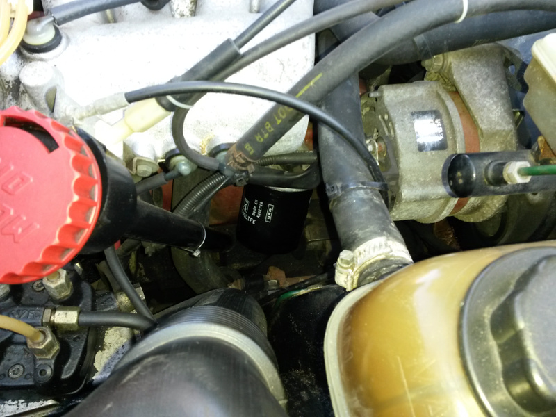

Oil and filter changed without incident (or any spillage thankfully), the filter on the 900 is in such a location that if it decides to come off it's dead easy - if it wants to put up a fight however it's a real pig as really difficult to get a strap wrench or anything on and turn.
Getting your hand onto it isn't difficult, but tools are always harder.

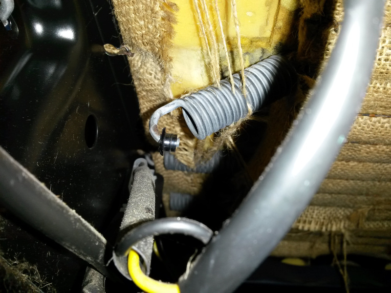

After taking it out for a test run after doing the oil, just as I turned back into the driveway I hear an almighty *ping* and I found myself sitting an inch or two lower - it appears that one of the supports in the driver's seat has collapsed. Will investigate that further soon...

Gosh, that oil filter is really in a fun place Zel...
Has nobody created a special tool for shifting recalcitrant ones? Something along the lines of a Pleiades sphere tool?

It's easier on the 16 valve cars as the air intake "snorkel" is in a different place (I think the inlet manifold is shorter as well so gets in the way less too). Being honest it's really not too bad provided the filter is co-operative. You can just about get a strap wrench onto it (taking up the slack in that is usually the hard bit - careful not to short out the terminals on the back of the alternator...that's a good way to wake yourself up...), so no specials really necessary. Only ever had one I couldn't shift with a bit of a faff, and that was when I just said sod it and punched a screw driver through it. Made a mess, but problem solved. Sadly you can't really do that with spheres!

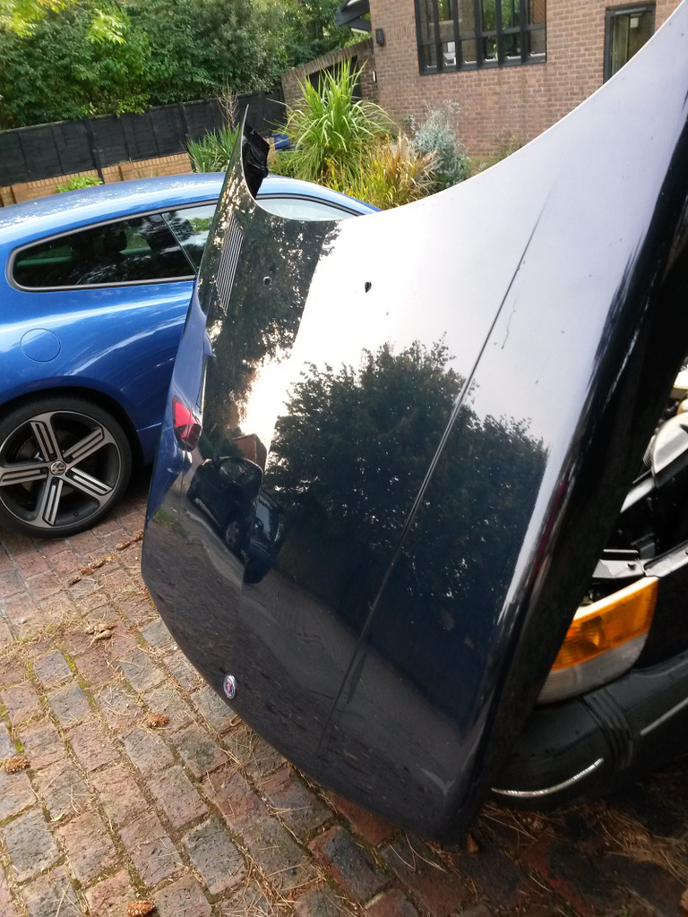

Okay, it's taken me at least four or five afternoons of wrist-cramping scrubbing, but the Saab is *finally* clear of tree-sap. There will always be slight blemishes where it's been, but I'll just have to deal with that. At least it's not obvious unless you're really looking at them. Will definitely be getting a cover for the car soon so I don't have this game again next summer.
So that's where we are now. Has been washed down and clay-mitted. Will give a skim of polish then as many coats of wax as I can fit in through the day tomorrow, hopefully give the plastics a skim over as well.

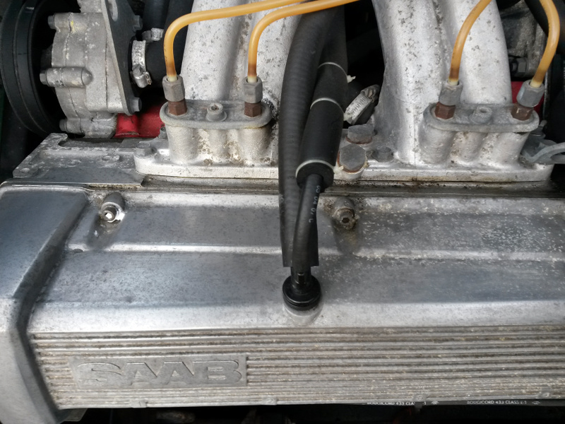

Also discovered a tube of metal polish randomly in the box, so decided to poke the cam cover with it, as it's oxidised quite heavily while the car was out of use. Looks like it will scrub up not too bad really.
Won't do anything about all the oil leaks mind you...but I do have a new crankshaft oil seal in the glove box which I'll hopefully get done soon (though I think that has actually stopped leaking since the oil change!), and keep promising to get a new seal for the cam cover ordered...will be getting some stuff from Parts for Saabs to service the ignition system shortly, so might include that then...I reckon that's where at least 80% of the oil leakage comes from...

That's looking lovely Zel

Had a ten second window to have a look at the seat on the Saab this evening before heading out to the shops.
Quite clear what's happened here!
Easy enough fix though. Will drill another couple of holes and bolt a plate on there to re-attach the spring to, problem sorted.
