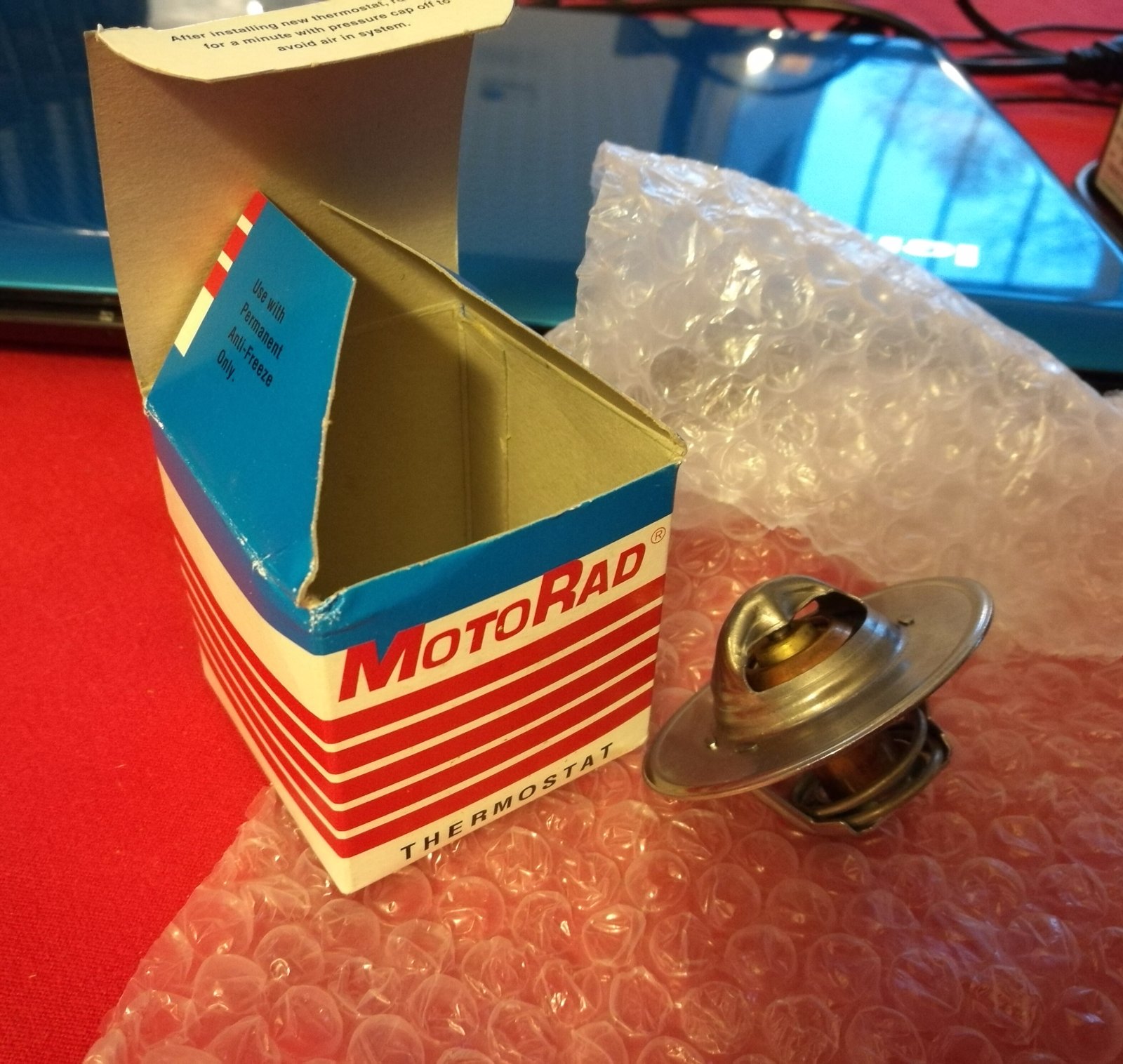

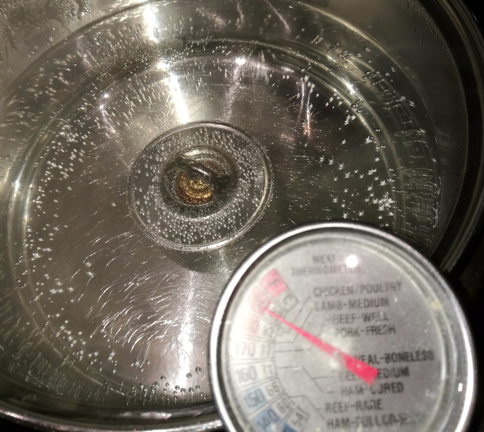

New (82C) thermostat for the Skoda has now arrived.
I shall be testing this momentarily to ensure it opens at the specified temperature, and all being well will get it fitted tomorrow, once that's done I'll ring up and get it booked in for a test.
I'll thoroughly reverse flush everything while I've got the system drained down to change the thermostat as I'd be daft not to. Surely I'll have dislodged some crud while doing the head gasket.
Edit: New stat tested and okay. Starts to open right at the stated temp, and opens smoothly without and sticking. Seats properly when closed too, unlike the last replacement one I got for the Saab. ...if anyone hears loud swearing from the vicinity of my place tomorrow, you know fitting went as easily as expected! ...should be a five minute job.
