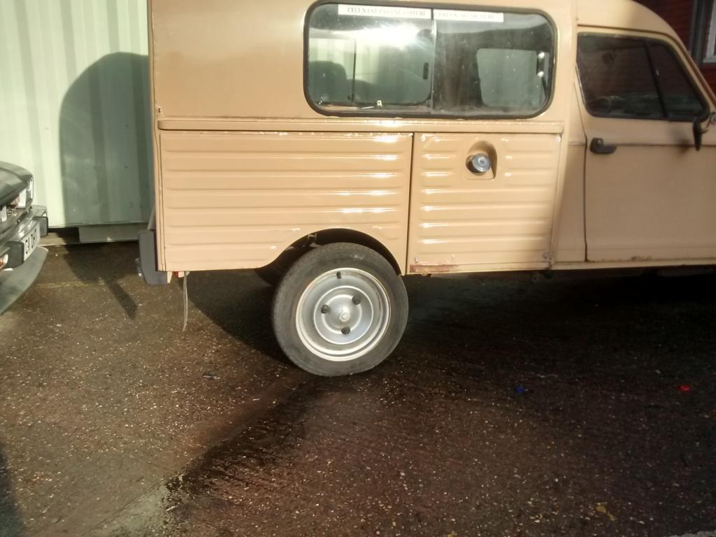

holy thread resurrection Batman...... we got a Acoffeeadiane yet?
spotted mine today :lol: first time for, well, months!!
this is empty apart from a few odds and ends
