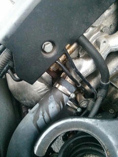

A little more progress was made yesterday with the hydraulic leak. I took the air box and its bracket off so I could see better. It turns out Mikes suspicions are correct and I have a second leak on the accumulator block. Both leaks had enough of a puddle around them to mask the sources. I decided to give them both a good clean and look again today so I have a good chance of fiddling with the right bit. I also noticed the pump is leaking and so so is the sump. The N/S strut return pipe was damp too so I nipped up the connector. I also noticed that the oil filter looks quite aged so an oil change and resealing tthe sump is pencilled in for next weekend along with the coolant bottle and coolant.
That probably isn't much progress for a whole day but the Scenic had a little overhaul as well. It was treated to an oil change, new cabin filter and a new air filter. It had a wash, the drivers window switch was repaired and then it went for its mot, which it passed. One advisory on the n/s track rod end and they tried to sell me 2 tyres as the fronts have feathered the outside edges. The Scenic just needs spark plugs, the rocker cover sealing (got new inlet manifold gasket but waiting for blue hylomar at to arrive) and front brake pads. I need to put the speaker grill and a few screws back in the drivers door card. Then finally that track rod end and tracking will see it in top order for the winter.
Today I plan to tackle the 2 central Lhm leaks on the Xantia and clean up the pump to find the other one. I need to check if the headlights have the rear covers and strip down the o/s one which is filling with condensation. I've found a spare central locking receiver to try as the remote locking isn't working. I shall buy oil and a filter ready for next weekend and order some loctite to seal the sump. I need to look up the sump washer size, no idea what condition it will be in. I shall also be ordering a coolant bottle, night breaker bulbs and coolant. I didn't get round to measuring the bottle yesterday so am still unsure which. I have decided to go with the cheapest alloy option that fits. I will get the welding guy at work to tig an alteration to fit the original level sensor one day, after I have added the missing wire to the sensor.
If there is any time left I will be jacking it up to inspect the front suspension and brakes. The suspension definitely isn't right on the n/s. Feels like either the p bush, the track rod end or both. The tracking seems way out as well but not worth doing until the suspension components are healthy. Brake wise they need bleeding badly and they rub. Can't see much through the exclusive wheels so a lot to be revealed. Is there a preferred brand of spark plugs for these engines, I'd like to do the plugs and fuel filter as soon as I can.

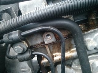

This wouldn't be a leaky cam box would it? I'm hoping for rocker gasket.CitroJim wrote:
Main thing is, you don't have leaky camboxes - yet! They're fun
Very little progress are on leaks today, the accumulator looks like a pipe that I can't reach the jubilee on an need to try from underneath. The hydractive block one is hard to tell but looking like the solenoid itself and scared me so I left it alone.

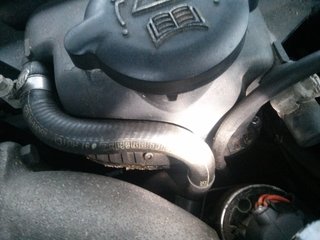

I hadn't noticed before but my coolant bottle has some bolts in to try to repair it.
I've basically chosen this as my coolant tank. It's £20 more than Citroen but will last and should fit. It will need tig welding to add the low level sensor. I'm going to flush and then change the coolant tomorrow to see that the bottle actually does leak. I'd hate to find out that the leak was elsewhere having paid that much for a bottle.

Yes, that's the beginning of cambox weeps James but not yet serious. It's when oil drips onto the exhaust manifolds it becomes a problem...
Hydraulic pump leak will be from the O ring on the 19mm hex below the delivery pipe, the one I changed in Gabriel yesterday. It can be done in-situ. If on the other hexagon then the pump needs removing. Not as hard as it looks.
It's a good idea to whip out the alternator if it's wet with LHM and give it a good clean....
Again, easier than it looks...

It seems a shame that I have the cam box leak but thankfully I'm ordering the loctite sealer for the sump so it will just take extra time. I'm trying hard to have it ready to mot on the 20th so the cam box will go on the "less important" list for after the mot.

Cambox seals are only a problem when the oil drips on the exhaust manifolds and starts smoking James
It won't affect the MOT...
Best to do them when you do the cambelt as the cams need to come out as both top and bottom sides of the cam bearing ladders need to be resealed with the same goo as you'll use on the sump...
